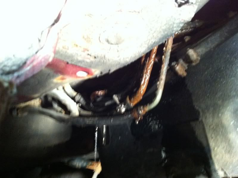

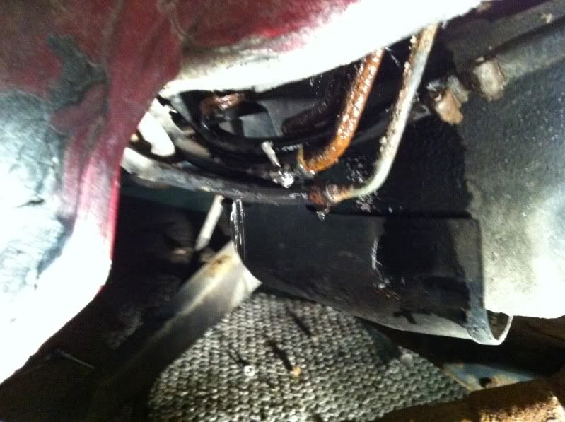

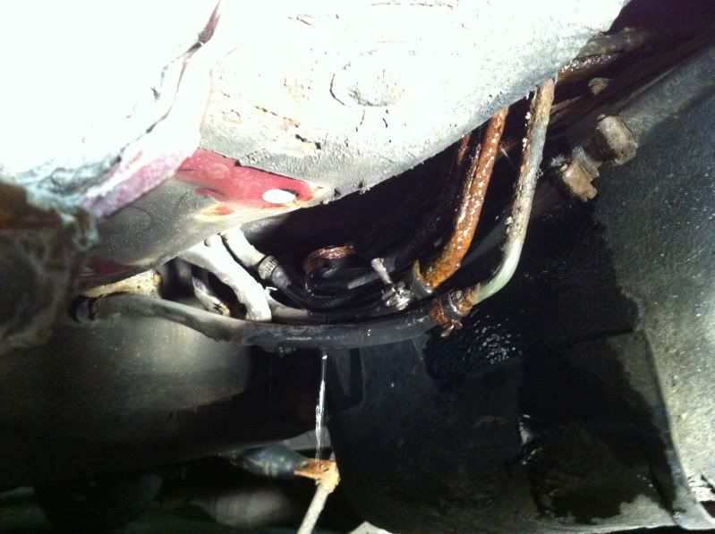

So today when I was driving away in my car from the parking spot I noticed a black spot on the ground thought nothing of it. As i drove away from running errands I saw the same spot and knew i had a leak of some sort. Turns out I am leaking gas, and no not from the filler neck i had that issue in my wagon. Although most of our legacies are plauged with the leak on the filler neck due to the plastic covering up the bottom of the metal and allowing it to rust out i saved myself the trouble by cutting the plastic down and undercoating the crap out of that filler neck. Driving around on a half full tank makes for very short trips. But this time I am leaking from the drivers side and after looking underneath the fuel return line and feed lines are rusted out to the point where they crumbled in my hand. Luckily i dont have to replace the whole line going all the way to the fuel filter. Why because the fuel lines underneath the car and the ones on the fuel tank are seperated by rubber hoses. Thank GOD SOA did it that way. I dont want to buy new fuel lines but I need to replace them. along with the hoses to stop this leak before it gets to big to where my fuel pump is dumping fuel onto the street.

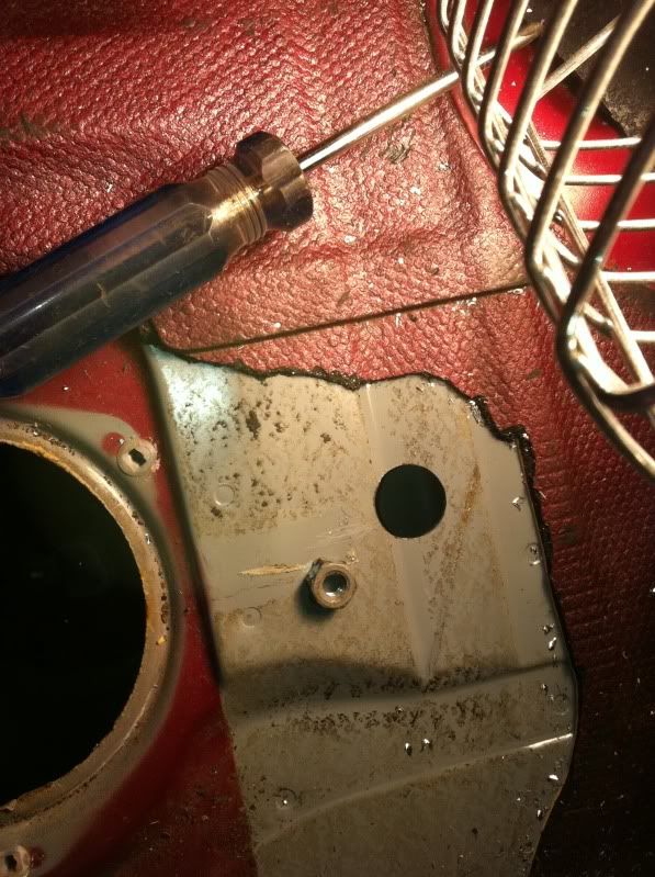

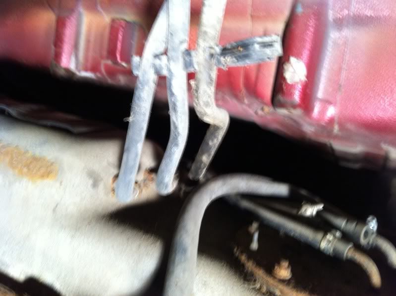

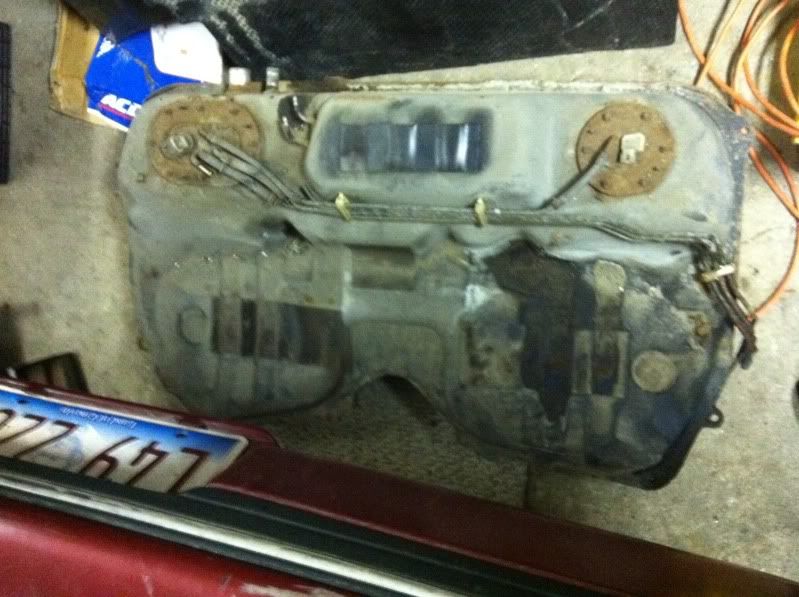

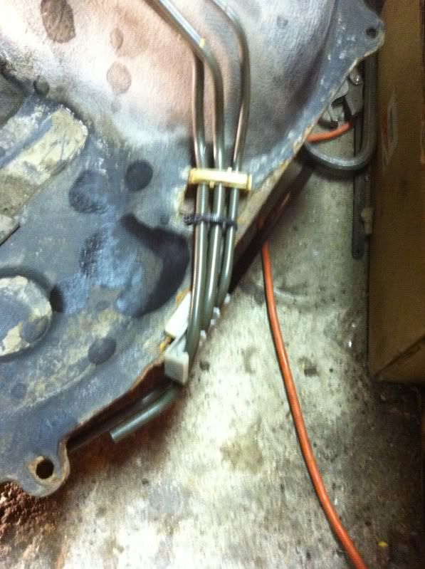

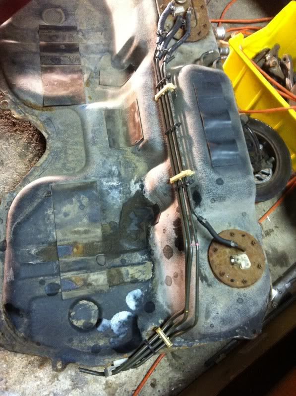

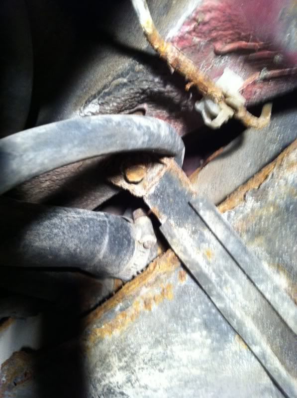

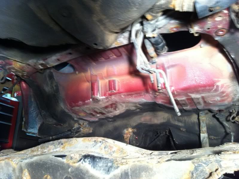

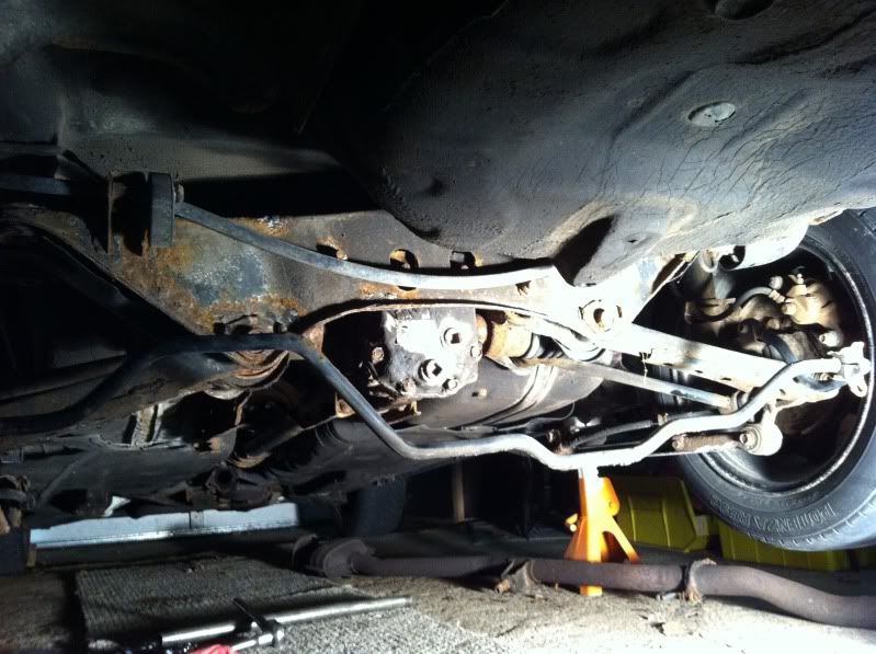

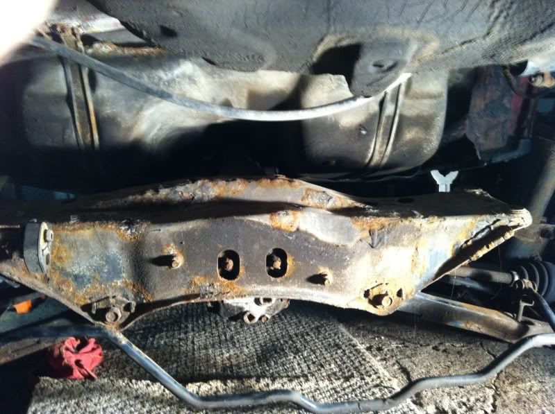

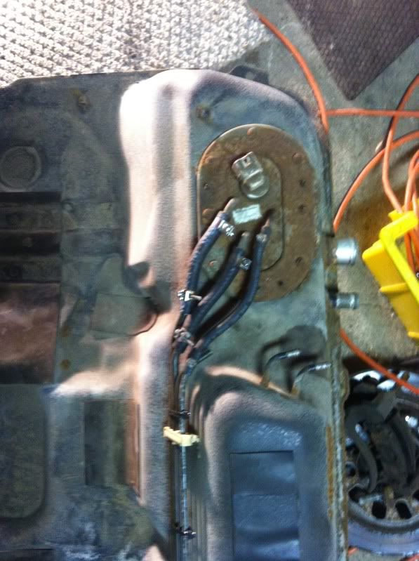

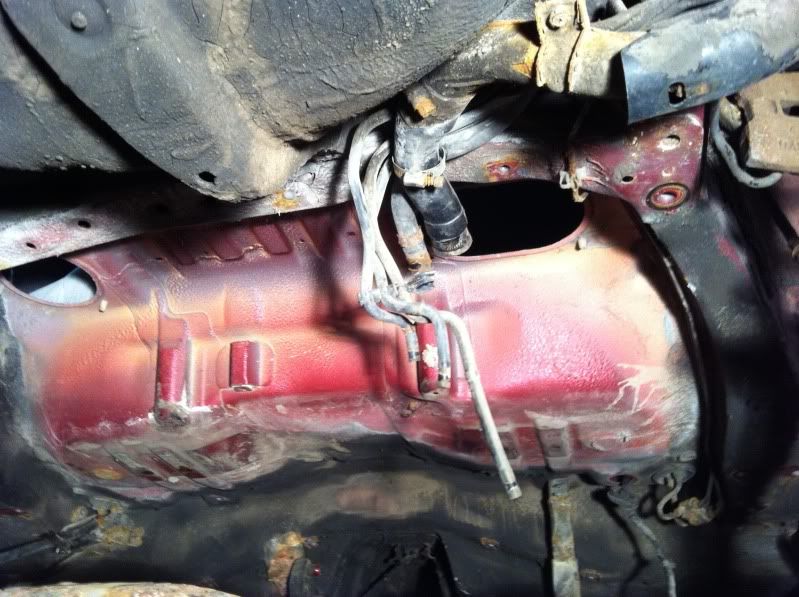

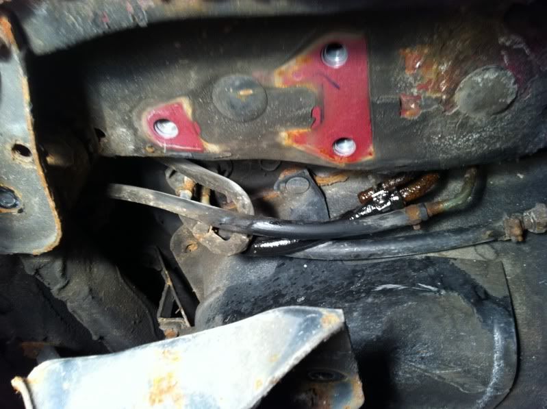

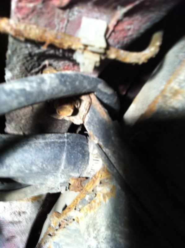

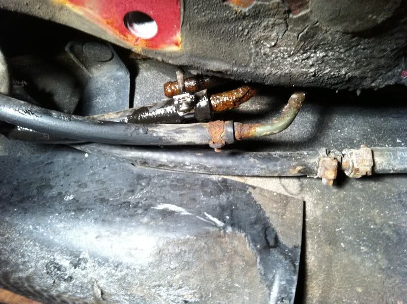

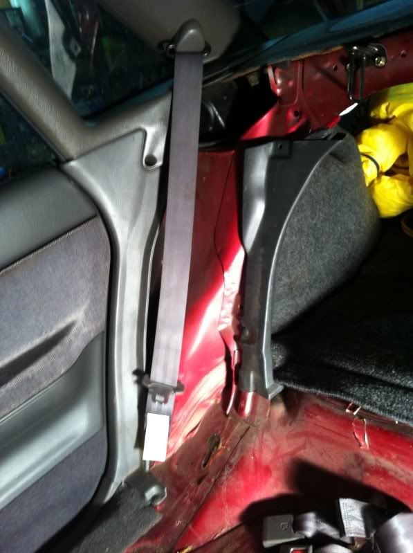

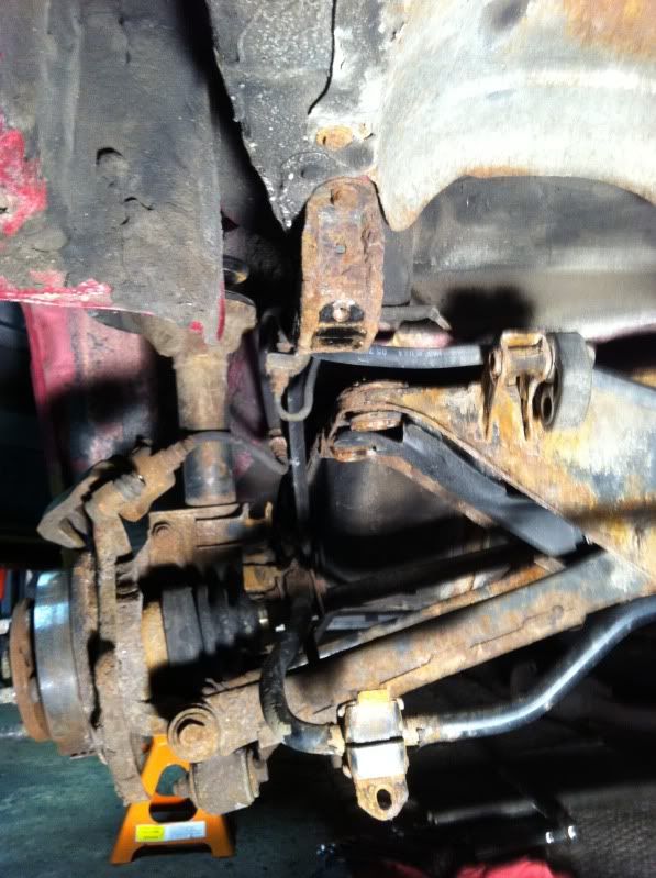

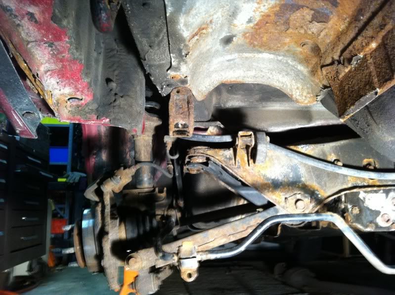

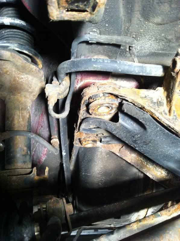

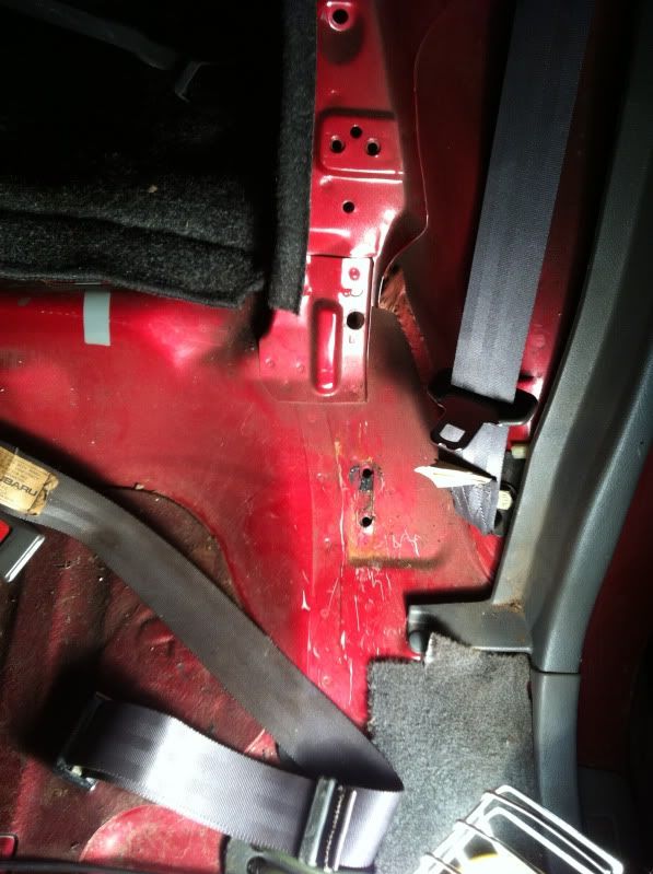

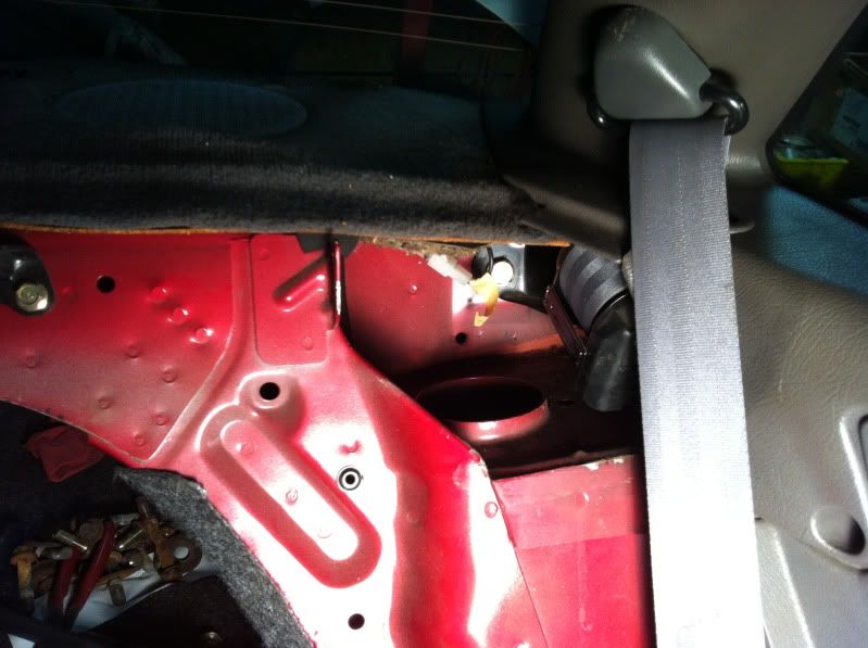

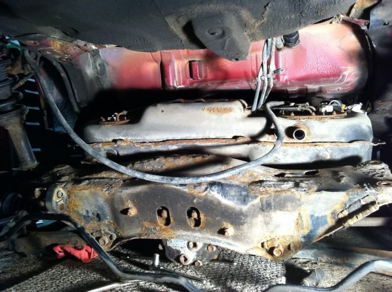

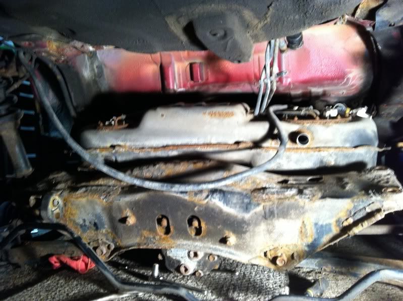

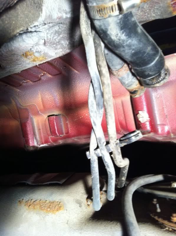

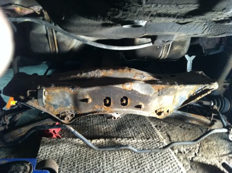

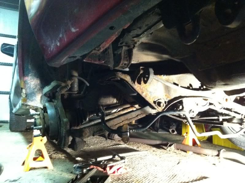

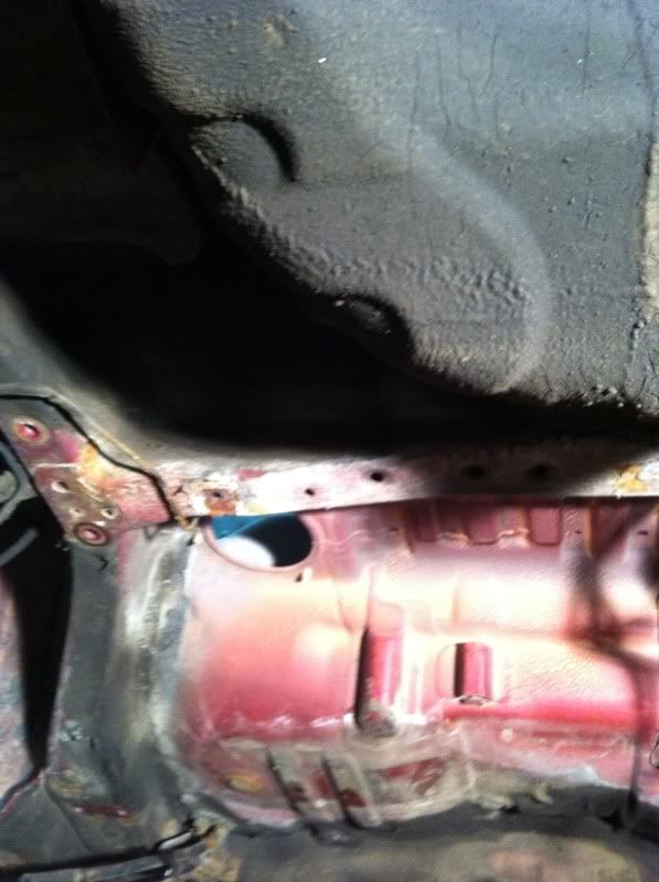

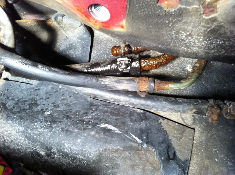

Okay here it is the pictures as I removed the tank and fixed the lines. I also broke one line which was my luck thats how I found more rusty gold but I did not get any pictures of it.
Ohh and excuse the shitty cell phone pics

Re: Fuel Tank and Fuel lines Thread of Help
That's some pretty rusty parts under there!!!
You should have seen the pile of rust I swept off the garage floor

I did this by myself in a crammed garage because it was cold in one full day about 18 hours the part that was the worst by myself was getting the tank back in and bolting up thankfully mine was nearly empty. Prepare to spend a whole day underneath the car. The air tools might be helpful but don't strip anything like I did.
