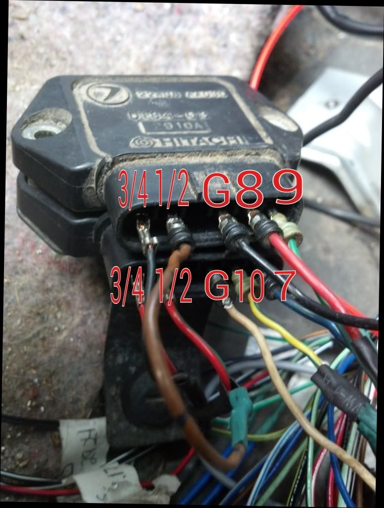

When I get home later I will take a pic off my configuration. Its pins 7 & 10 that are incorrect in the diagram and I understood that.

ECU pin:
47.7 to ignitor 2, pin 1
47.8 to ignitor 1, pin 2
47.9 to ignitor 1, pin 1
47.10 to ignitor 2, pin 2
Ignitor 1(top)
Ignitor 2(bottom)
Ignitor 1 out :
pin 5, 3/4 ignition
pin 6, 1/2 ignition
Ignitor 2 out:
pin 5, 3/4 ignition
pin 6, 1/2 ignition

id swap your 1/2 and 3/4 wires and try it

I think the diagram is incorrect. You should be pairing signals from ECU pins 10/8 and 9/7. The diagram shows pairing 10/9 and 8/7. To fix, just swap #8 and #9.
Here is the installation picture for my 4to2 converter if it helps.
-Rob
-Rob

Well I'm not haven much luck.
Here's what I've kinda figured out, if I leave my wires how had in my picture configuration, I only get spark on two cylinders. However if I flip the outputs on a single ingnitor(not to be confused with both ignitors) I can get spark on all four. I can do it to either ignitor but not both at the same time. Showing that their is only two options to gain spark on all four by changing outputs.
Now,
If I take Robs input configuration 7/9 to one ignitor and 8/10 to the other ignitor, and leave the outputs how they are in my picture, I only get spark on two cylinders, however if I switch the outputs on a single ignitor I can get spark on all four.
Car still doesn't start. When all four spark I can hear and see the intake backfire, despite flipping the outputs.
Now,

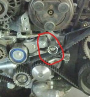

Update** noticing possible problems with my timing belt tensioner, decided to check timing a third time and I noticed the belt seemed too loose, going to take it out and see what's up..
OK, this is crazy, on this last timing check I found the crank to be 180°
off and my belt seems very loose, I'm totally confused how this has happened. I was using an older style tensioner(brand new) but I'm going to pick up a newer style tensioner and see if it helps. More updates soon..

Re: Car will not start/RobTune ECU
I think you misunderstood what I was saying. The outputs of the two igniters need to combine signals from 10/8 and 7/9. That does not mean, route 10 and 8 to the same igniter.dankberries wrote:Well I'm not haven much luck.
Now,
From the original diagram, swap the inputs to igniter #1 ( bottom of the diagram, top in your picture); so from ECU-9 to igniter#1 pin-2 and ECU-8 to igniter#1 pin-1.
Or, to show the change compared to your previous listing;
ECU pin:
47.8 to ignitor 1, pin 1
47.9 to ignitor 1, pin 2
Ignitor 1(top)
Ignitor 2(bottom)
Ignitor 1 out :
pin 5, 3/4 ignition
pin 6, 1/2 ignition
Ignitor 2 out:
pin 5, 3/4 ignition
pin 6, 1/2 ignition
From this you should see 4 spark events. If it still spits back then swap the outputs.
You have to get the input pairing right first, then you need to get the output matching the coil banks.
I am also going to guess you have fouled your plugs by now, so might as well pick up an extra set.

Update:
Car is running again!
How this all happened so abruptly I have no idea.
Some how my crank timing came off substantially and my ignitor failed.
I put in a new style tensioner and seems to hold a little tighter. Not sure if anyone doing dual cam swaps has had issues with older style tensioners but I think its better to just upgrade to the new one, although their pricey at 150$.

Good news. Can you confirm your final igniter wiring?
-Rob
-Rob

Just put another 60 miles on the car, everything running great, pull up to the liquor store, turn the car off, run in, come out, go to start the car, and its having a hell of a time, finally it starts, but sounds like shit! Like my timing/ignition has gone wack again!
Smh..nothing like a little Murphy's law.
I'm going to have get a tow back home and start this process all over again. If I do in fact find my timing or ignition is out again, I really don't know how or why its happening or of a solution to fix it at this time..
Morning Update: after diagnosing I've found the ignition is still working but my crank timing has come off again! I'm having some sort of issue with jumping timing..
I did some research and noticed on usdm WRX's they have an extra little pulley on the tensioner bracket, maybe I need to convert to something like that? Why would I be jumping timing?
Seems like it occurs when starting the car..

I would be suspicious of the tensioner you have in there. I would also be worried about your valves since you have an interference engine.
One thing I do after putting the timing belt on and tightening up all the pulleys & etc. Is rotate the crank forward about half a revolution, then counter-clockwise half a turn, then forward again several full revolutions till I see that the timing marks line up. A mechanic told me about rotating the crank backwards for half a turn or so - said that the back and forth movement makes the tensioner "tensioned" properly from the get go.

MikeyMeyagi
- Posts: 454
- Joined: Thu Nov 23, 2006 1:07 am
- Location: Maine
ive run both styles on 22t/25d hybrids with no issues ever on jumping timing.

Correct order -rob wrote:Good news. Can you confirm your final igniter wiring?
-Rob
Top Ignitor :
Pin 1 - ECU pin F47.9
Pin 2 - ECU pin F47.8
Pin 3 - Ground
Pin 5 - Out signal 1/2
Pin 6 - Out signal 3/4
Bottom Ignitor :
Pin 1 - ECU pin F47.7
Pin 2 - ECU pin F47.10
Pin 3 - Ground
