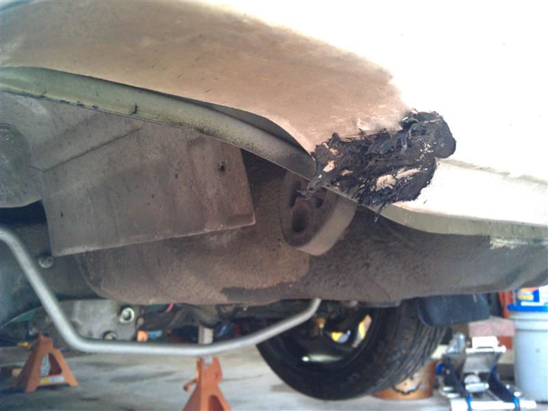

Anybody know where I can buy that neat little metal plate that the STI guys put on their bumpers to protect the plastic from melting with their exhaust so close?

You can fab one out of aluminum. You can buy a flanging tool to form the metal around the outer curve of the bumper to cover that melted part or you can clean that up decently if you have a soldering iron and a wide tip (or a plastic welder). It's polypropylene, so it's not bad to work with. It kind of smears as you melt it, but it's fairly forgiving and you can get it pretty smooth. If you have a plastic welder and some PP rod, you could even fill in the parts that have melted off and get it back to near perfect, otherwise you'll need some body filler if you care to bother fixing it.

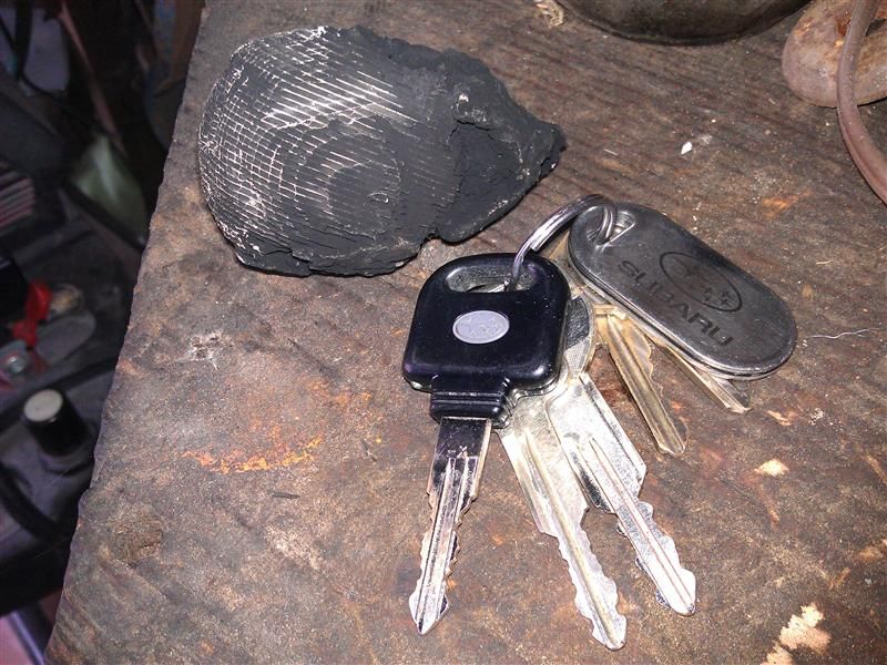

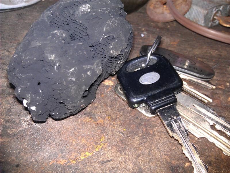

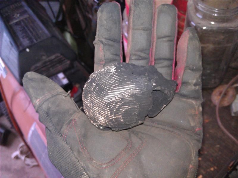

I always knew cats were bad news haha

Kartboy extra long exhaust hangers?

kimokalihi wrote:I'm completely blown away at how effective that coating is. IF you get it done at the right place that actually uses quality ceramic coating and now just some shitty rattle can job like I swear grimmspeed does.
Yup, if you've got good ceramic coating, it goes a long way to keep the heat in.
And it's only ceramic coated on the outside! Normally they do both inside and out but since I had that STUPID cat they couldn't do the inside or it would probably be even more affective than it is.
I don't want to move the muffler anywhere. I like it the way it is and it hasn't melted the bumper until this happened. The plate I was asking about was just to cover up the damage to the bumper. Although it's hardly even noticeable since it's so low and on the underside. You have to get your head down there to see it really.
Steve, one of these days I'm gonna buy a plastic welder. So many neat uses for it. And a rivet gun.

Plastic welder = solder gun.

If you can fit a weder tip to put rod through to a solder iron, but otherwise it's not a good way to try to weld with rod and you'd want with an adjustable temp. It could definitely be used to clean that area up by just melting what's there back into place so that it looks OK, but so could sandpaper. A plastic welder is nice to have, but kind of pricey if you rarely use it. I'd let you borrow mine if you lived around here. Rivet guns are a lot easier to justify expense-wise.

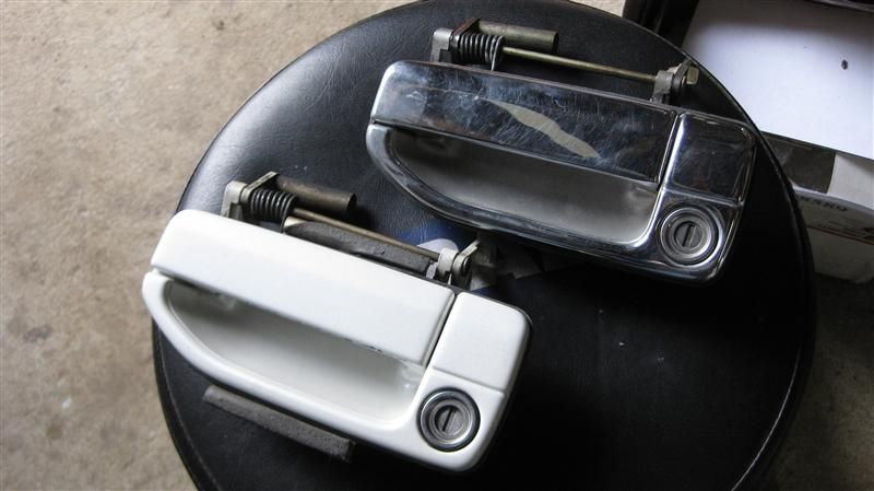

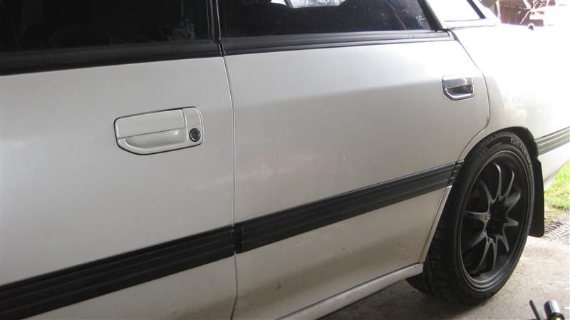

I finally got my hands on some pearl white door handles! Been a long search. Can't tell from these pictures but they are a bit lighter than the doors so that sucks but they look a hell of a lot better than chrome. That was the last of the chrome on my car too. :) Good riddance.

Looking GooD!!!
--- crisco --- 2005 Saab 9-2X Aero---
Thanks. I'd like to raise the front a half inch or so though. Pretty tired of the rubbing. It's rubbing on the frame of the car on the inside of the fender wells.

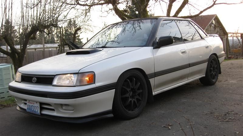

looks awesome Kimo, you going to keep the mirrors and the scoop black?

Good looking 1st gen.

The scoop is only there until I go 257/tmic. I have an na hood waiting for that. I hate the scoop. Looks tacky and ricey.

where did you get the door handles from?

prodrive wrote:where did you get the door handles from?
fngearhead found them on a pearl white wagon at a junkyard and sold them to me.

The hood scoop is only ricer when it is taped onto the hood with no hole in the hood under it. Since it is pre-facelift I do vote for scoopless once you get a FMIC though, would look nice and clean!

Thanks. It will be a vast improvement to ditch that scoop. It also kind of gives me away. To cops and people that want to race. I think a lot of people wouldn't notice my car without it unless they heard my exhaust which isn't very loud either.
