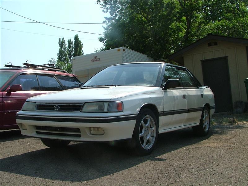

I've been working on my own Subies for many years, and always wanted to play with a 1st Gen Legacy Turbo. I was looking for a cheap, fun commuter back in early 2008, when a White 1991 SS 5MT happened along on Craigslist for a sweet price. It was a little worn inside and out, but straight for the large part. Noisy too, but only under load. I bought it expecting to do an immediate tranny change and then the plan was to slowly upgrade it while I used it for daily driving.

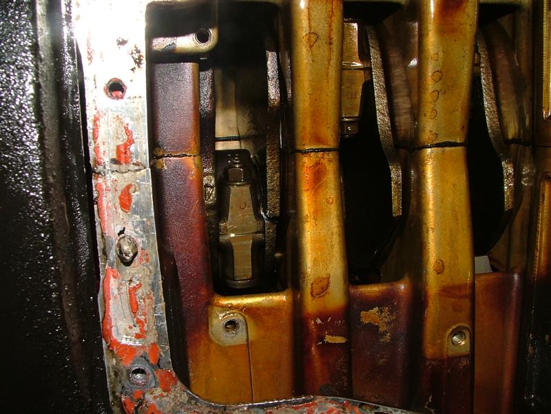

As soon as I had put in a new cable-clutch tranny (thinking cheap swaps in the future), the crankshaft separated, revealing at last the true problem with the car. Being somewhat frustrated with myself for getting suckered into a bad deal and spending so much time on it, I let the car sit for a couple months while I decided what to do.

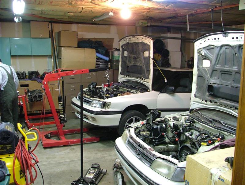

Then, a member of our local club who lives in Sacramento posted up his White 1991 SS 5MT for cheap, as both sides had been killed by guardrails. We put temporary wheels and suspension on the car, and I drove it over the Sierra to my place, noting that the drivetrain felt perfect.
I swapped over the whole motor, exhaust, and other mods, keeping my tranny and diff. Since then, I have been slowly upgrading and fixing all the little problems that nearly 20 years of use (and abuse) will give a car.

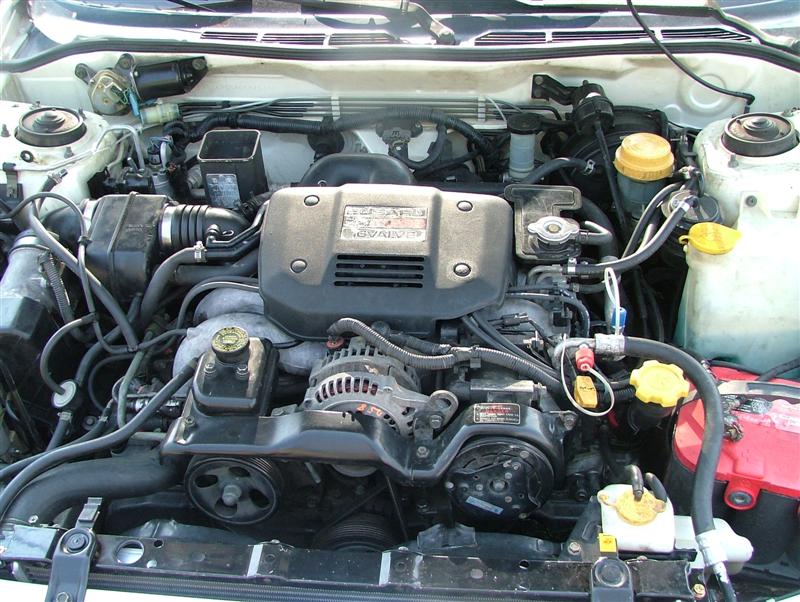

Engine
EJ22T long block refreshed with rings/bearings/hone
JDM 440 injectors (tested 440cc and 444cc by Witchhunter) in stock rails
JECS MAF
Robtune EJ20G ECU and spark adapter
Cheap ball/spring MBC @ 16psi
Custom in-fender cone filter intake (made out of two AEM/generic intake parts)
'02 WRX TD-04 turbo
'06 WRX TMIC with stock BPV
STi coolant tank
Diamond Coil Pack
6ga ground wires to coil, alt, MAF, batt, and both strut tower points
New and re-routed hoses all around
STi engine mounts
Kartboy battery tie-down
3" catless bellmouth DP
OEM '05 STi catback, length and hangers modified
Walbro 255 fuel pump and anti-slosh in-tank mod completed

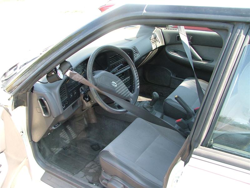

Interior
'03 WRX front seats with lowered driver brackets
Canadian manual seat belts
JDM Momo early Legacy wheel
Momo shift knob
Rear poly shifter bushing
LC-1 Wideband AFR (gage stolen, LC-1 still installed)
Boost/Vac gauge (now mounted on steering column)
35% tint all-around
