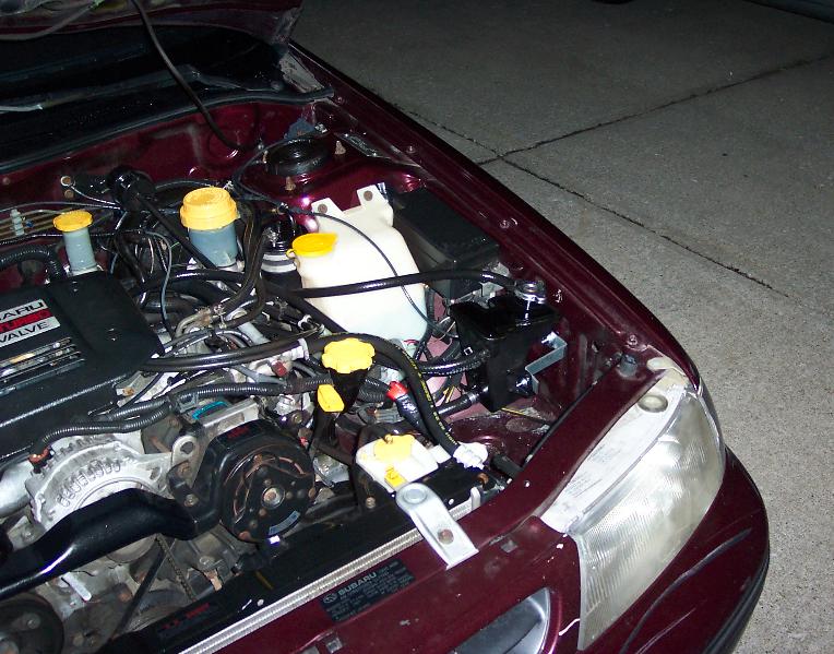

There are many different places to put the coolant tank, here is one idea just as food for thought.
I had plenty of room after moving my battery to the trunk. :)
I was also going to install my AWIC pump there also before I ended up selling it all.
