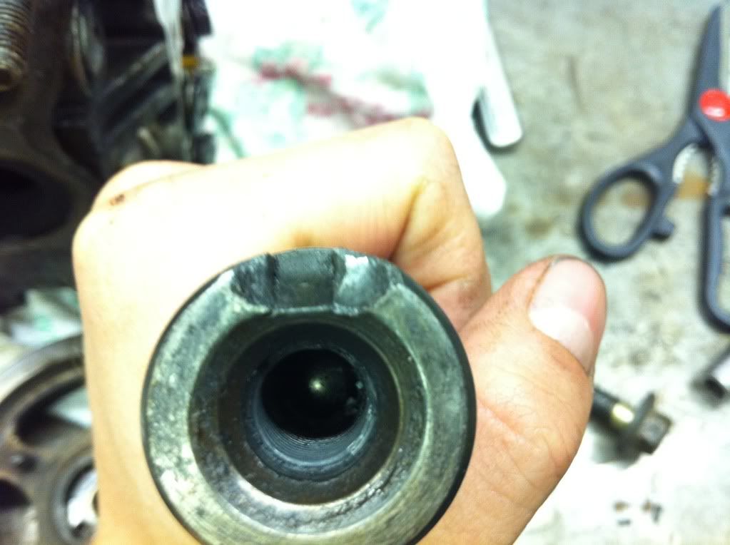

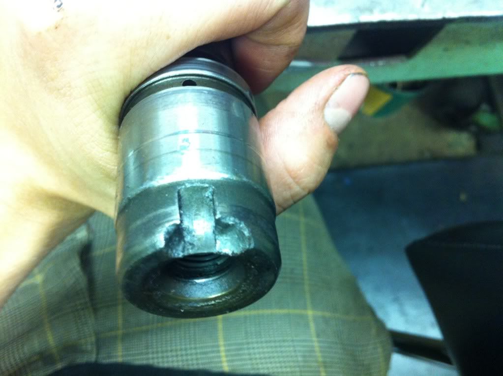

Well after 3 months of sitting I have finally found the problem.
The center bolt on the sprocket was by no means loose. This would explain the random computer codes since the cam angle sensor is on the drivers side (This cam is from the passenger head). I tore the engine completely down and found no major wear. This was the only problem I found and it is in correlation to the area the knock was coming from. I could rebuild my engine or I could go with a EJ20G STI drive train swap, which is what I will most likely do.

Well that sucks about the cam, but glad you found the problem!
