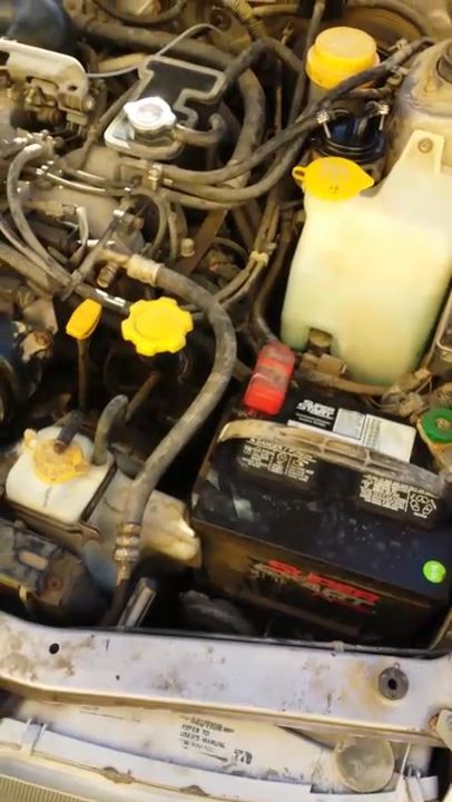

I'm now kinda leaning towards this latest suggestion, as the compressor is indeed caked with oily substances. Also, that's what it looks like - I took a video, anyone think this is anything other than caked-on oily residue burning off from years of not having used the compressor...?
In this video: A/C is engaged in the first ~10-20 seconds, runs for a bit, and begins smoking almost immediately - but you can't really tell since the A/C fan is also on, blowing all that smoke away quickly. Then, at about the 1:00 mark, I give the signal to turn off the A/C compressor and it becomes clear that it was smoking quite badly, It then continues to smoke for a couple mins after shutdown, presumably until the oil caked on it cools down enough to stop burning...?
Thoughts? Suggestions? Should I just run it as-is and see if it burns off all the residue, should I run it and see if it actually gets the air cold, etc...?

Ok.....that actually looks like the AC clutch.
The very front part of the AC pulley is not moving at any time. It should move. With the engine off try rotating it with your hand. It should rotate pretty easily by hand. If it moves freely then the clutch is probably toast. If it doesn't move at all, the compressor is seazed up and that is why the clutch is smoking.
Either way, you will likely need a new/another compressor. Some shops may be able to replace the clutch, however I tried doing that at one time and it didn't really work well. Also, you can try using a used compressor. I didn't have the greatest luck, but I think that may have been due to the oil I used on my conversion. After two failed compressors I went with PAG oil vs. esther when I converted to r134a.

And...undone. alternator is no longer charging my battery. Plugged in a 100w peak inverter to the lighter adapter to charge my jump starter and noticed the battery voltage is under 13v when the car is running. Ugh. Maybe ive got a bad / loose wire somewhere I gotta track down. Rats.

Bum alternator.... starts out with 15v when cold but heats up quick. Then it can only keep 10v on the battery while the headlights and ac are on.
