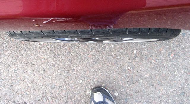

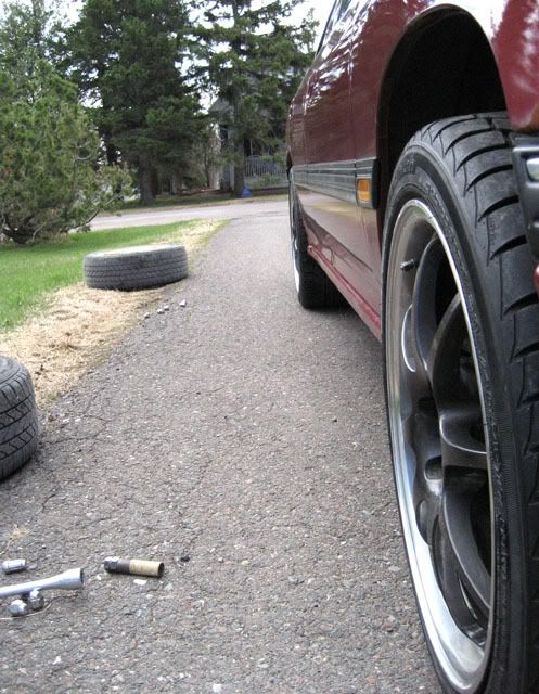

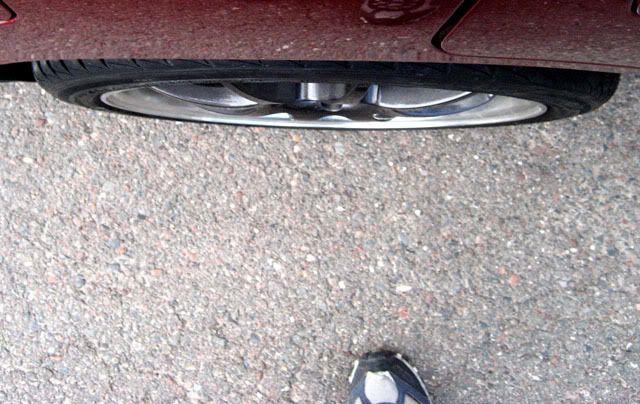

Since I was putting the summers on the Impreza today I figured I'd test fit them on the Legacy just to check the clearance. They fit, but I don't think I'd drive it without a lot of fender rolling. Here's some horrible quality pics, I was in a hurry.
Here's one from above on the back

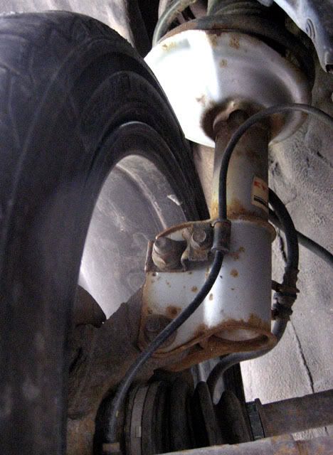

and one from above on the front

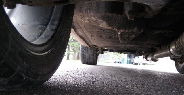

clearance under the front, loads of room

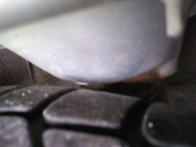

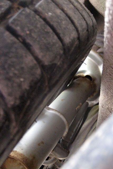

and the rear is SOOOO close to touching my GR2's
The wheels are 17x8 Rota Rev's +48 offset, tires 235/40/ZR17 BFG GeForce Sports. I'm running KYB GR2's on stock springs. Hope this helps you guys with fitment information.

I bet I could fit some 225's easy with a 7.5 wide wheel at a 50-53 offset. too late now, heh

93forestpearl wrote:I bet I could fit some 225's easy with a 7.5 wide wheel at a 50-53 offset. too late now, heh
I did on a 7.5" wide ET48.
