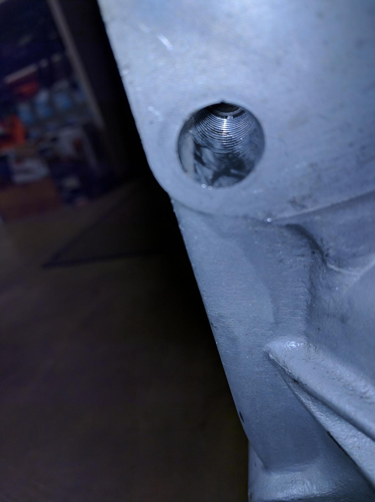

Well I worked on the starter bolt hole yesterday, and it came out good. The tap may have not be perfectly square with the hole, but the bolt threads and everything is good.
I used a 1/2" drill for the M14x1.5 tap and then used a 9/16" drill bit to drill out the lower starter bolt hole. I chamfered the holes with a step bit, which worked really good. However, in the process I broke one of the studs on the starter solenoid. So I've got to find a used solenoid or if it's not too expensive buy a new one.
Here are the pictures from the work:
