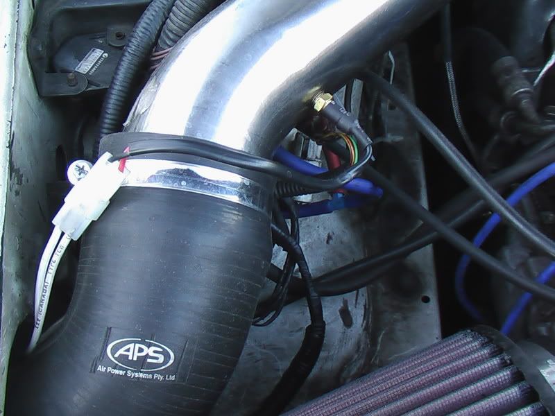

well i just installed my autronic plug an play ecu board, wow its amazing so many things can be changed. just with the base settings it runs perfect.
wired in a air temp sensor so maf delete, and a vacum line and its running like a dream.
just needs a good tune an all is well.

you need both like splinter siad, but wow ever one should get one just amazing how these thing work.
i was thinking its going to be crazy to make work and this and that, man i wired the air temp in and the vacum line and the thing runs perfect.
the only thing is our ecu caseing is diffrent, i had to cut the case a bit to make it work.

splinter i get you pics of everything, the air temp came with the kit from autronic.
guys there is a map sensor built in on the board as well.

The autronic MAP sensor is on the board. You just run a vacuum line to the box.
Maybe Nico is saying when he removed the MAF he lost the stock IAT sensor because it's part of the MAF, so he is using the one that comes with the Autronic instead.

map sensor on board
air temp sensor
and no more MAF

^^ look really close at the first pic i cut the sides out so the board would fit see wahts missing, saw file and its in.
