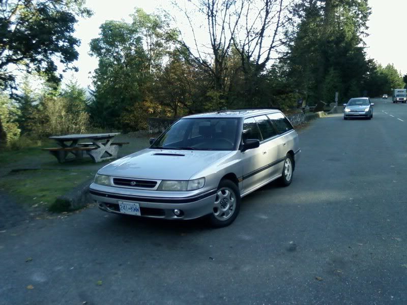

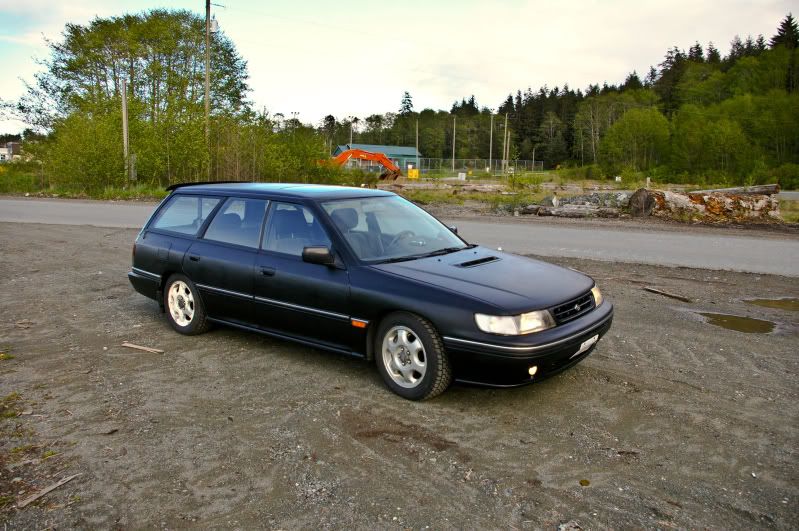

well i think its time to start a build thread

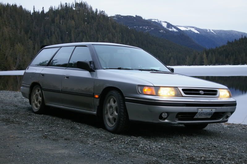

bought my wagon back in november off a guy in victoria
bone stock 332,000km when i bought it
since then i havent done alot to it
modded the air box
aem truboost running 9.5 psi
swapped in a 5speed tranny on march 7th
running scotty's cocktail fluid
lowed on kyb agx struts with intrax springs
running logans's (bmxkelowna) old painted headlights

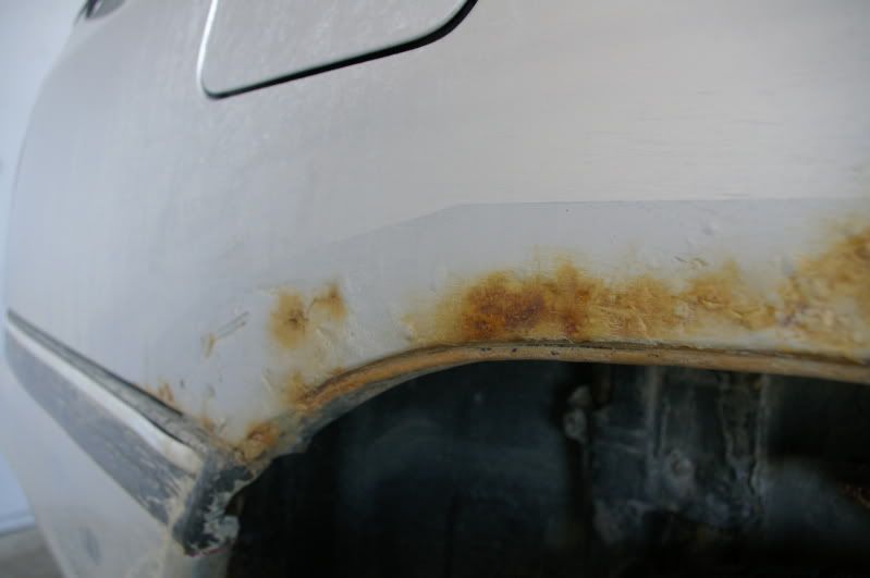

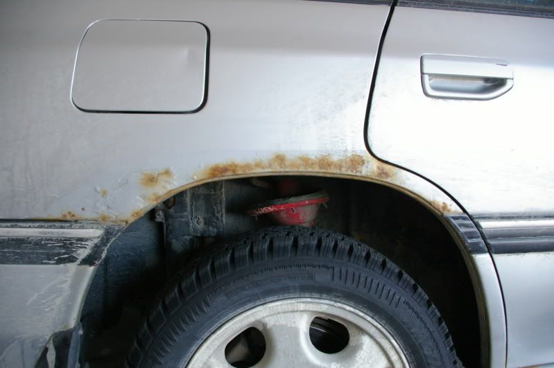

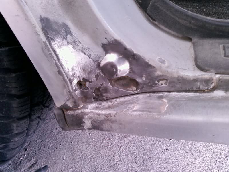

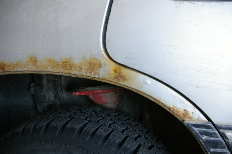

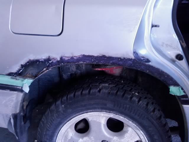

i am attacking the rust around the rear fender and behind the mudflaps
when i bought it
after the suspension
most recent
want to get a set of silver WRX wheels for it and new rubber
also want to get a top mount intercooler and exhaust
edit new hi-res pics after body work
newest pic of car with new wheels

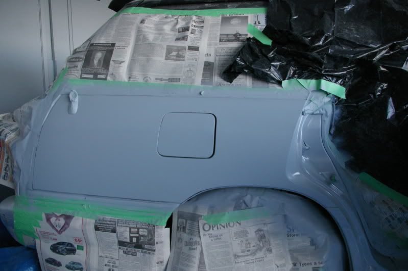

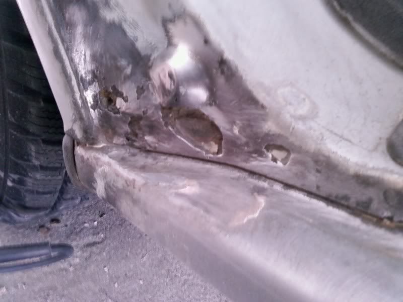

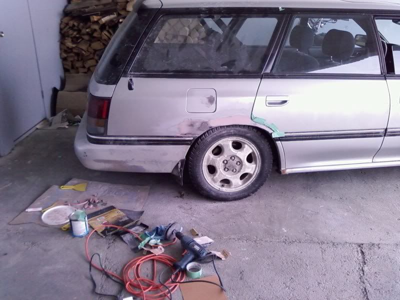

update on body work

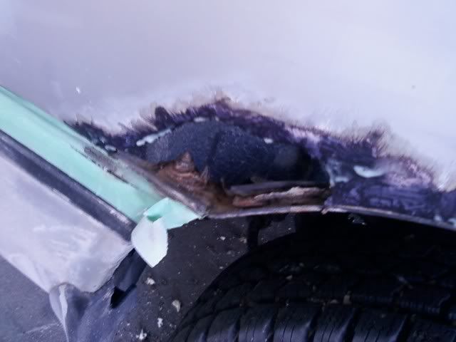

more surprises

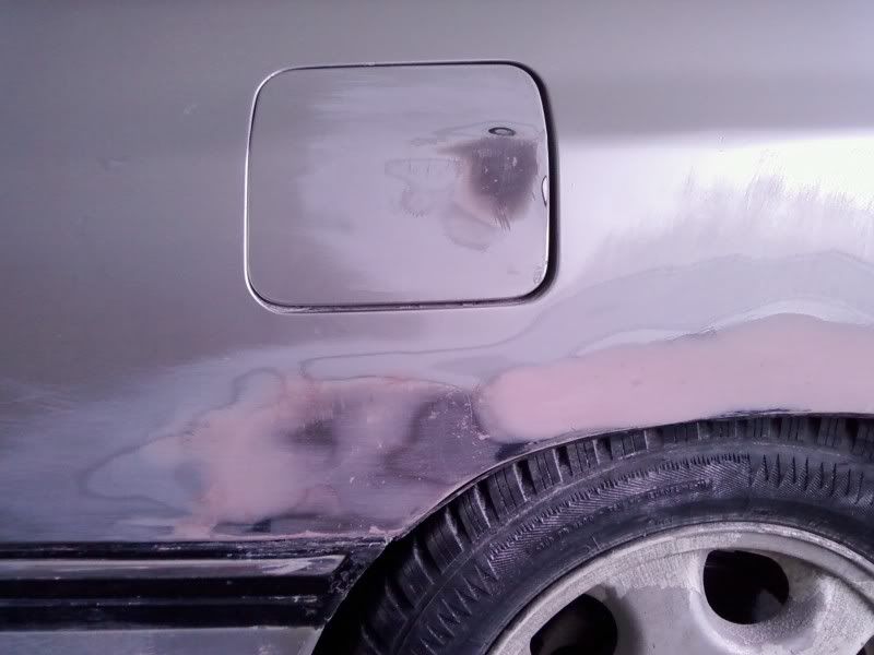

some pictures to show you what i had to look at every day before hand
and some high res pics of the work done so far

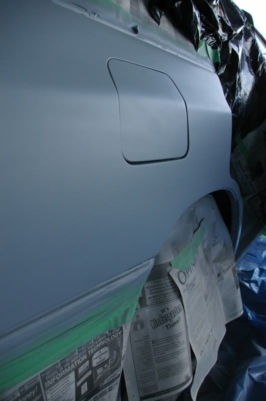

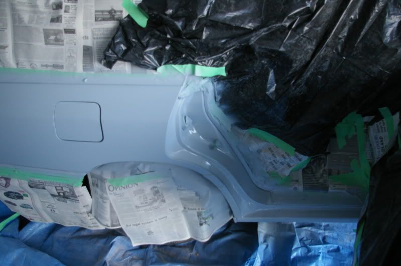

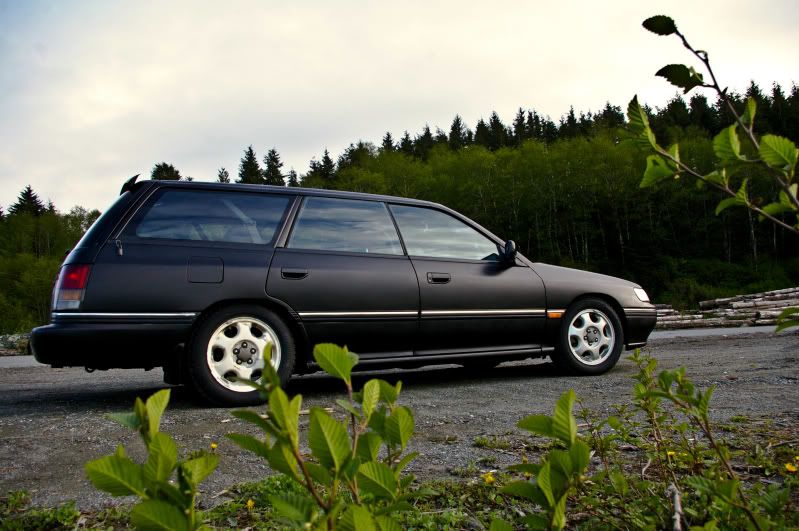

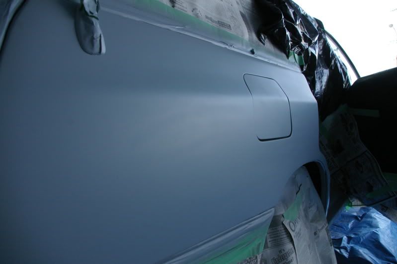

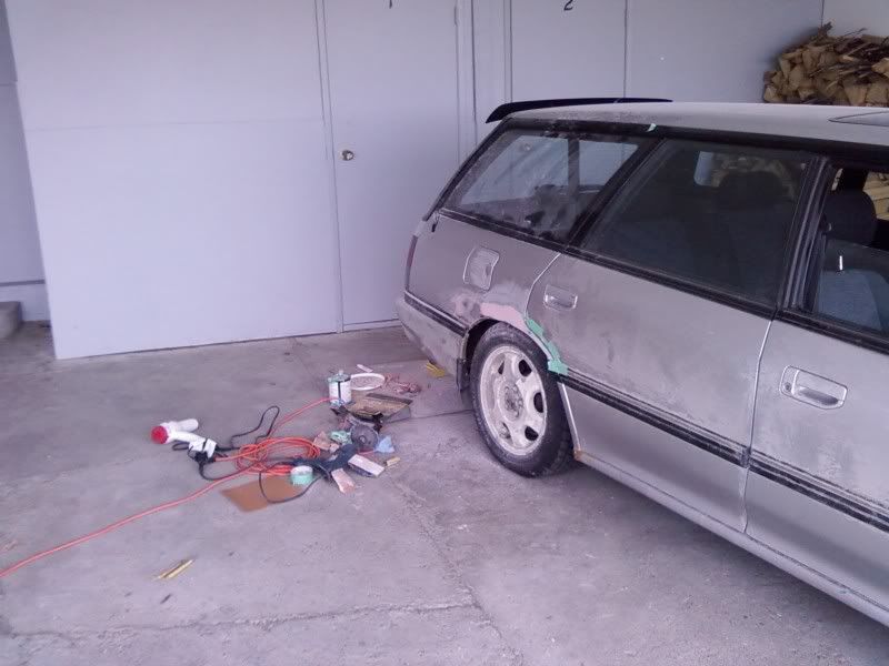

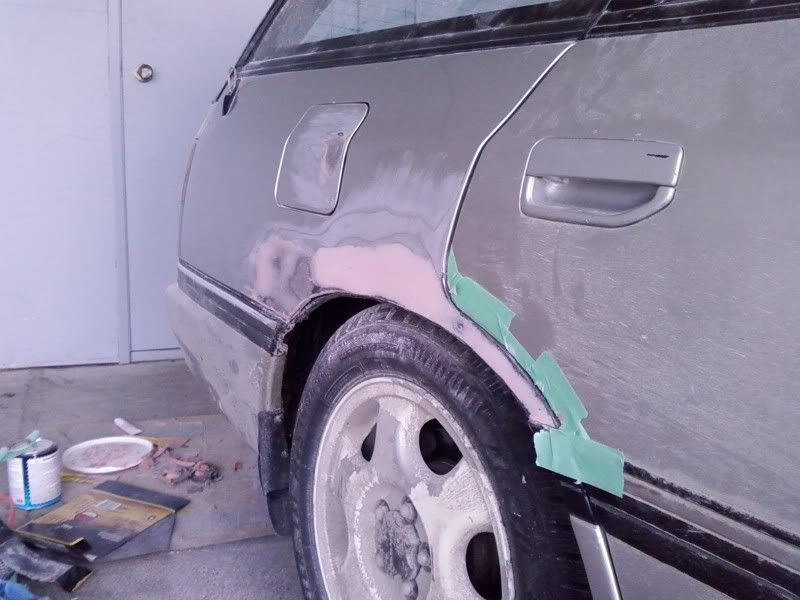

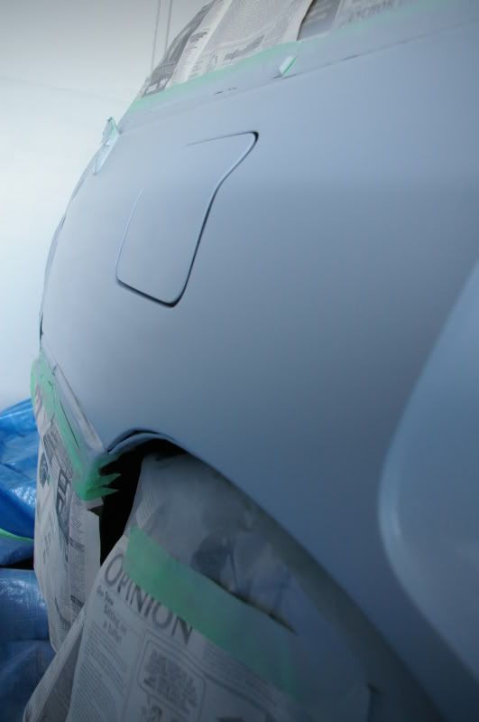

thanks man the fender is now painted and yesterday and today i repaired all the rust on the rear hatch and laid first coat of primer on the hatch/bumper today
not too much more left to do im going to be looking into buying new front fenders as they are pretty rotten from the mudflaps

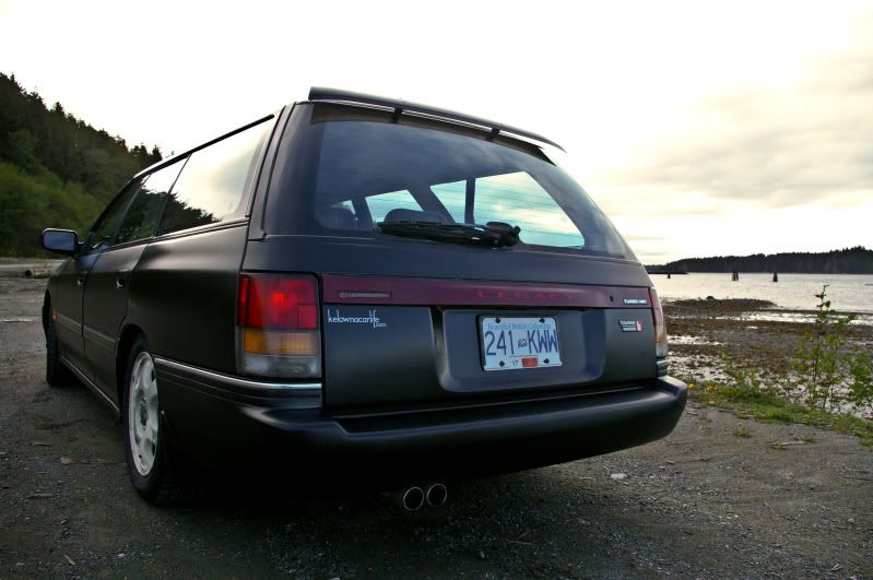

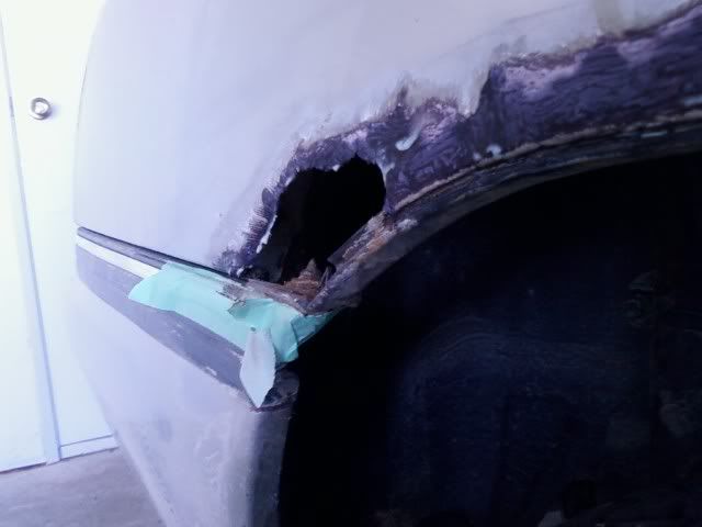

got the rear hatch and bumper painted as well as the drivers side rear fender priced out fenders today so ill be ordering them on monday
Awesome job. What are you putting over the rust and in holes?
nosyt
Posts: 295
Joined: Wed Nov 19, 2008 6:31 am
Location: Otsego, Minnesota
Post by nosyt »
process is basically grinding all the rust away then using platikote rust converter (2 coats) then the large hole i used 6 layers of fiberglass (2 thick high quality stuff, 4 cheap bondo kit stuff) then used fiberglass reinforced body filler to make up the right shape then finished with light weight body filler sanding with 120 grit then plastikote high build primer sanding with 800 grit then paint

Nice black =) Next you need to paint the rims!

haha if i was to redo i wouldn't just spray bomb it
it feels like i sprained my finger from spraying so much i went through 9 cans of primer and 12 cans of satin black

Hahaha. How'd you do the paint? Brand?
nosyt
Posts: 295
Post by nosyt »
paint was all spray bomb
plasti-kote - grey spot fill primer 466
plasti-kote - satin black T-8
i love the colour and how it turned out for being spray canned
walking out of work seeing it there brings a smile to my face
