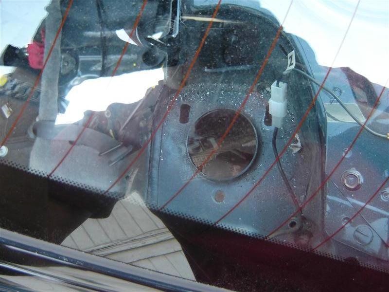

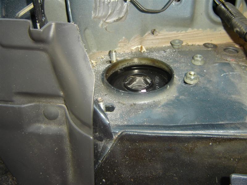

if you only slot the inner holes, the tops won't physically fit in the strut towers, so you have to also slot the outer hole out.
what year wrx suspension did you get? if it's 02-03 you should be able to use your stock tops.

im thinking i will do the same but maybe drill separate holes instead of slotting... if its feasible. im sure the back glass doesnt make things any easier to machine it out lol.

well, those are wedged in as far as possible, I don't think there's enough room to actually drill new holes, unless maybe you only did it to the outer one. But then you would end up with even worse camber. I ended up putting a strut tower brace in there after the fact and it worked out okay.

ok then slots will be fine. i have a GC rear strut bar but '05 WRX struts so im thinking swap the GC bar for a GD one and slot the holes and bolt them up!
