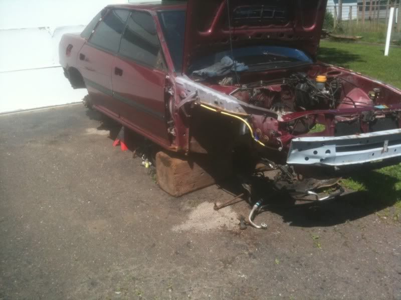

Finally got the correct intake manifold wiring harness (engine harness) from Damon, so I can get back to business on this thing. I *should* have it running this weekend. The 94 just needs the gas tank pulled and maybe some rear suspension bits like sway bar and lateral links and its ready for the scrapper.
Poor 94, sorry for the cellphone pic.

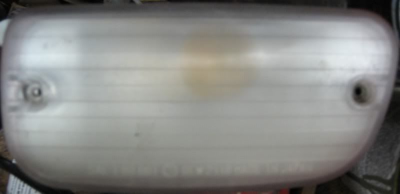

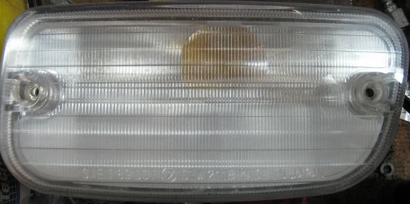

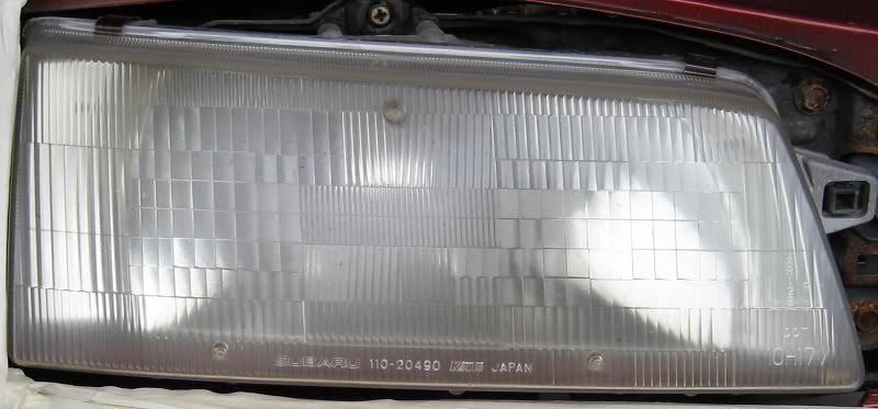

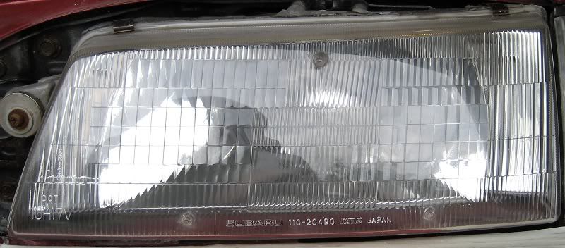

Saw the result of Kimo's 3M headlight job and remembered how much Piddster liked the 3M kit so I decided to try it myself. I work in an auto body shop so I could have easily done it at work with our industrial grade 3M stuff. I wanted to find out how good this kit was from the auto parts stores so I picked it up for $18 with my discount.
Left Side Before
Right Side After
Turn Signal Before
Turn Signal After
I was quite amazed with the kit. All of the sand paper was industrial grade auto body stuff and not the cheap parts store shit. The buffing pad was the same too, everything was just smaller. To put it in perspective, each sheet of sand paper we use at the shop costs us $1 or more, the 3000 grit trizact sheets cost $6 per sheet. The rubbing compound is more than $100 per gallon. So this $20 retail kit is well worth the money, and it actually makes the process quicker having a smaller buffing pad on the old ass 91 headlights with the nipples on them. It took me ~2 hours and 3 beers to do both headlights and the turn signals. I went through 2 charges on my non-lithium battery on my drill and 1 charge on a lithium battery to finish them. (charging time is included in the 2 hours)

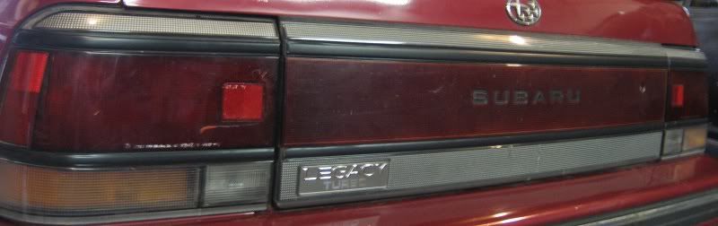

I also covered the 2 chrome strips on the tail lights with electrical tape, still gotta do the bumper chrome but I like the tail lights a lot better now.

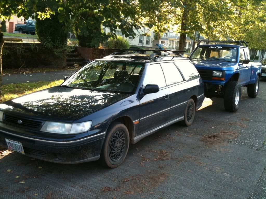

My buddy's are jeep xj guys, like big ones. Nice ones with the toughest run ing gear. I'm a more of a ford guy. I just traded my 6th ranger for my subaru. But still have another for the snow. But those jeeps are made for offroad.

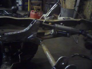

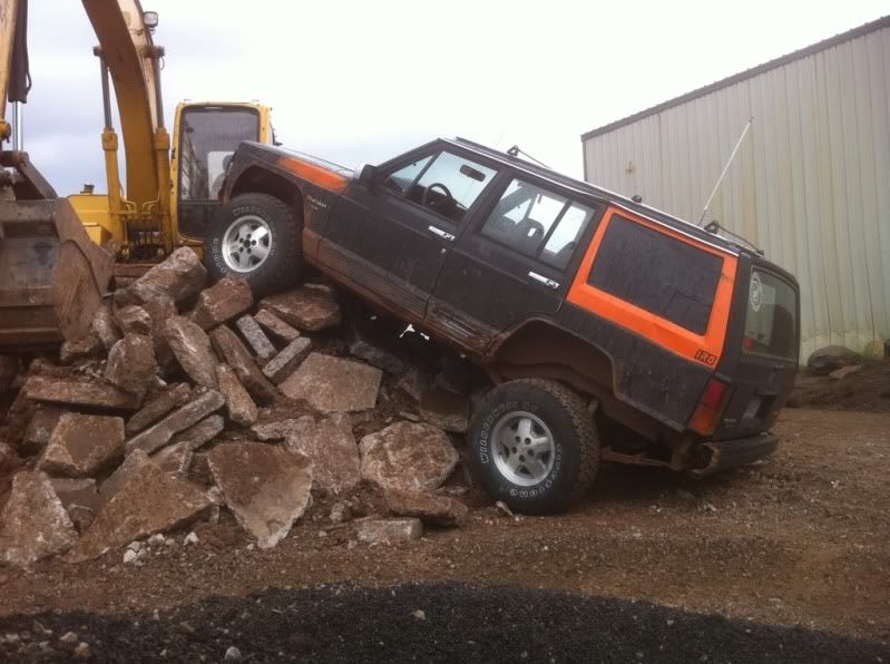

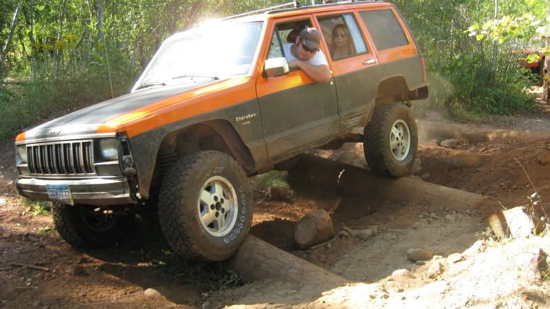

Well his car is sold, so I might as well thread jack a bit and I love pic whoring my jeep, and riding with me is the main reason deride had to get one
haha
Mine is the little jeep that could. I've only got about $1500-2000 into it (with buying it)
-5" in front
-7" rear lift
-relocated/raised fuel tank
-31's (until I feel like dropping the $ on 285's)
- lots of other little things(cutting here, welding there)
- appreciation for body damage (most important mod
-5" in front
-7" rear lift

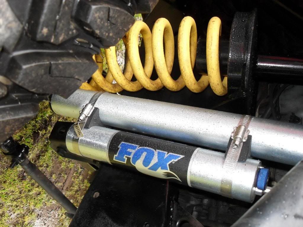

nice nice. looke like fun. bout do for some meat on those tires.
we did a cantilever rear suspension on mine. we got 14' out of a 9.5 shock.
shes alot of fun.
shes alot of fun.
