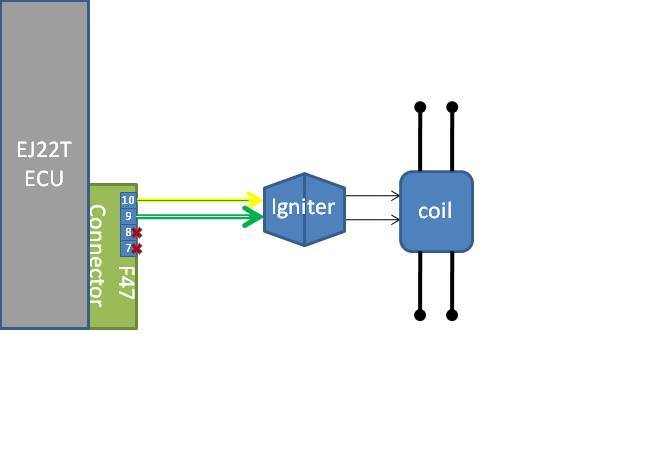

INSTALLATION
Installation is pretty straight forward. Use this connector pinout as reference. The color of the circle represents the color of the wire from the converter box.
1) De-pin the original two wires that go to the igniter. These are on connector F47.10 (yellow-green) and F47.9 (green-white)
2) Insert the pre-pinned wires from the converter; F47.10 (yellow), F47.9 (green), F47.8 (yellow), F47.7 (green). The pinned yellow wires are interchangeable with each other as well are the pinned green wires with each other.
3) Tap or solder the non pinned yellow wire to the yellow-green wire removed from F47.10. Do the same for the green wire to the green-white wire depinned from F47.9
4) Tap or solder the black ground wire to F47.14 (black-white)
5) Tap or solder the red power wire to F48.2 (yellow-blue)
This picture represents the stock setup before adding the converter.
Here is what it will look with the ignition converter in place after adding the EJ20G ECU.
Here is a picture that shows all connections to the F47 plug. You can see in step 3 that I soldered directly to the pins of the factory wires.
