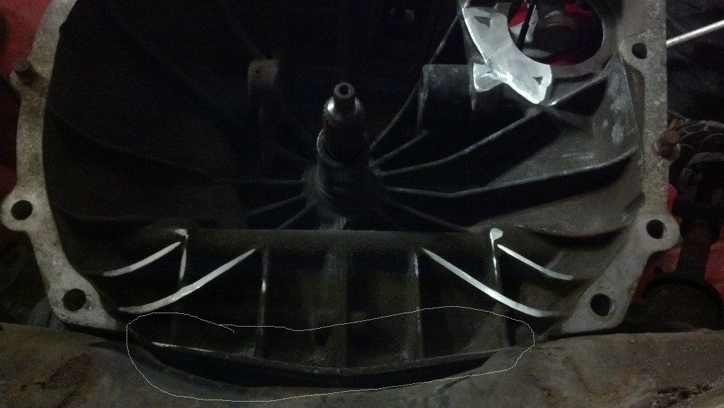

I cobbled together a 6mt clutch setup, all stock, hoping all goes in well.
- Posts: 5000
- Location: Des Moines, Wa
Re: Mike's 1991 Subaru Legacy SS
Stock 5mt vs 6mt clutch. The 6mt pressure plate takes 9 bolts vs 6 on the 5mt. All the bolts are the same, however. You reuse the 5mt clutch fork, and the TOB and pilot bearings are interchangeable as well. Since I have a phase II tranny now (swapped in an 04 FXT), I had to use a phase II manual starter. I'm not sure if this is because of the new tranny, or the new 6mt flywheel.
You grind down several ribs on the 5mt transmission, nothing too crazy. I'll upload a pic of that later.
Here's what it looks like:
(My tranny doesn't look as pretty). Make sure to cut the bottom out (where the guy circled) as well.
from: http://forums.nasioc.com/forums/showthr ... 150&page=2

Yeah It is running in the car now. The pressure plate was aftermarket unfortunately, so pedal is stuff, or stiffer than the previous oem exedy. But it engages so smoothly.Legacy777 wrote:That's interesting Mike about using the 6spd clutch setup on the 5spd......do you have it in the car?
4.44 gears are the bomb! Im not sure how far off my speedo is now but it accelerates noticeably harder. You do shift more frequently though. Oh well.
My rpm's are lower in 5th gear, but that might be because the speedo is possibly way off with the fxt tranny? Not sure.
One change to make to above: I actually used a WRX starter as my older phase I one didn't fit.
