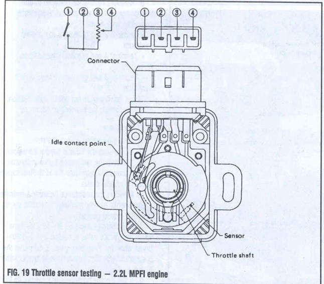

IF your using a 4-plug ECU (you are)
and
IF your using the EJ22T TPS (you are)
and
IF everything is still pinned correctly at the ECU and the TPS (I assume you checked)
then, your TPS voltage should not need to be swapped.
However, if you feel like you need to try then you can swap the "ends" of the resistor in the diagram. swapping 2 with 3 will reverse your TPS voltage from low to high. It will likely throw off your idle switch too.
EDIT: typoed the wire numbers on the first round.

If you want to reverse the OPERATION of that resistor, you need to swap 2 and 3.. the centre contact will start with it's contact at the reverse polarity then, and move in the right voltage direction... As you say though, the switch will then be a problem.. not unsurmountable...
By the sound of it though, you are certain that he has the right bits..
