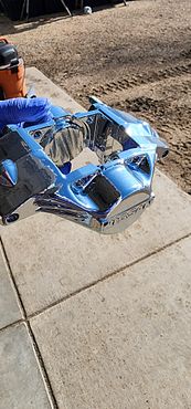

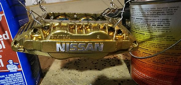

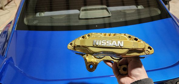

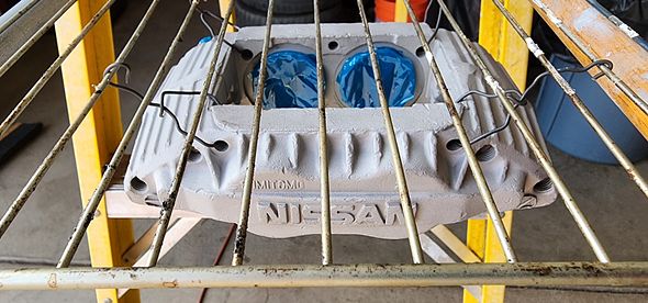

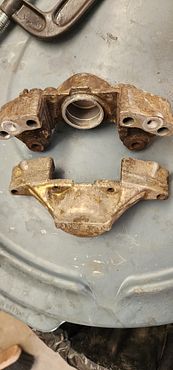

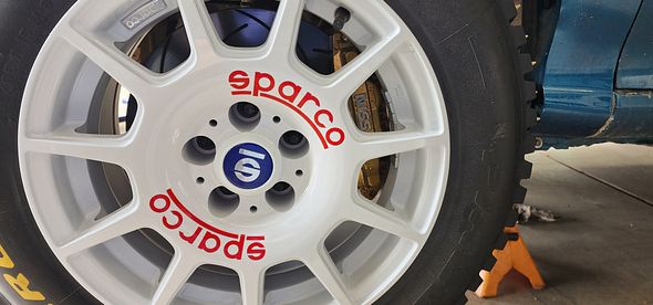

But.. to highlight this long time posting, I've been having some issues with the brakes. It seems the long durations of the car living outside when not in use is taking a toll on caliper pistons.
After a thorough look through I discovered that 3 of 4 calipers had atleast one piston froze up. Basically looks like water has made its way in past the seals, probably from freezing in the winter.
Decided to do an over haul on all 4. Purchased new pistons and seals, and while had them out I decided to recoat them, the spray paint I used years ago was all but gone and some..

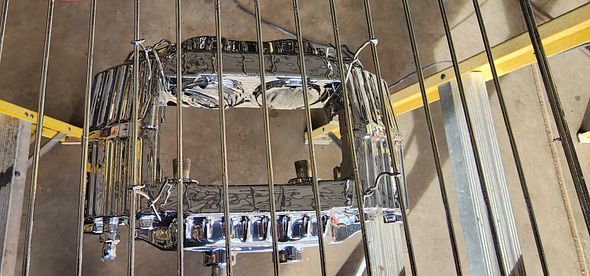

Rather than spray paint I opted to powder coat. Never done powder coat before so it was a learning curve. I purchased an eastwood gun and powder from prismatic powders and went to town. Picked a gold color, since that followed the previous theme.
Media blasted the past away...
The gold powder coat requires a base coat of super chrome, which is pretty amazing I've got to say:

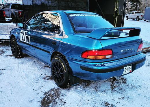

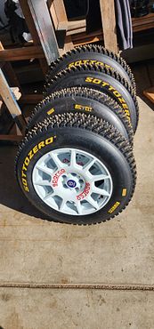

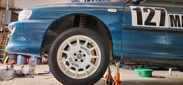

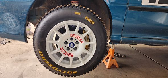

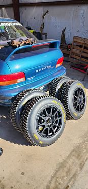

I've been competing in a bit more ice racing lately and picked up some WRC ice/snow tires. They only come in 15's and successfully fit them under the nissan calipers.
This first pic is under the 16's I use:
Then the 15's :

Those calipers look awesome!
I have set of 4-pot & 2-pots I have been needing to do the same thing. Don't know that I will powder coat, but need to clean up and paint. If i had a media blaster it would be a lot better/easier job. Plus time....I need time
