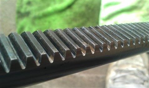

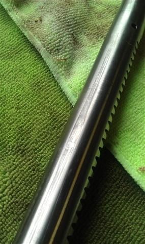

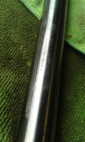

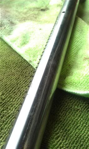

Got my rack broken down and cleaned. Need to buy some sandpaper to sand the scratches off the rack and then it'll go back together.
