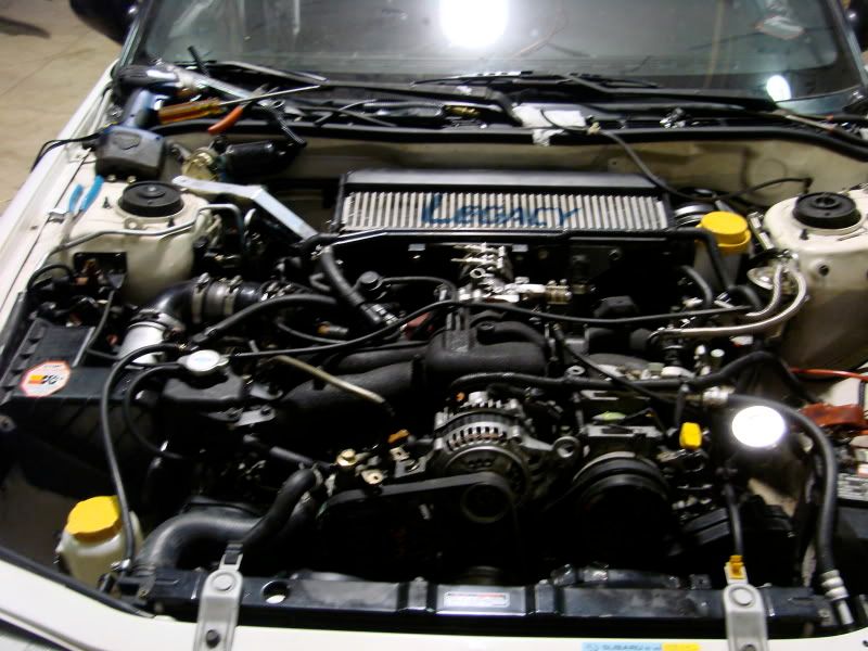

Got some done so far... Timing Belt on... Engine in... Accessory all on...
Finish bolting everything down, put the exhaust on, fix wiring and she'll run!
Headin out to do more right now.

So at the end of the day what got done today...
Timing Belt...
Installed Engine...
Modified the WRX Coolant Tank and made some little brackets for them
Put in the WRX Power Steering Pump
Pulled the stereo from the old car
Rewired the harness on the old stereo
Cleaned parts of the engine bay
Figured out which wires are the MAP and which are the MAF from the heap of cut wires
Cut down the clutch resevoir to clear the TMIC
Set Grill in
Pics tomorrow... Left my Camera in the shop

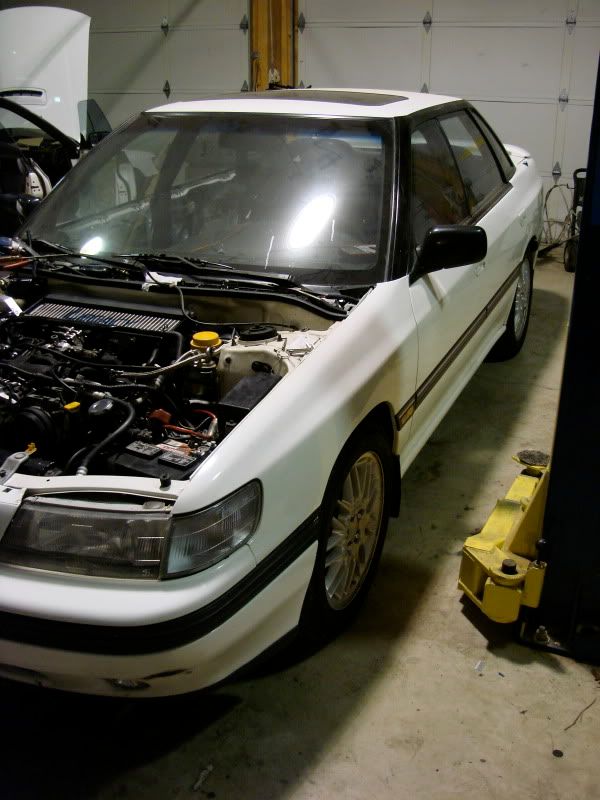

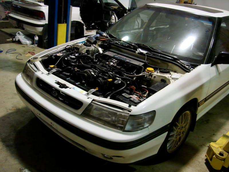

Some shots today...
Got most of the stereo done...
Fixed the alignement enough to drive to get it aligned lol

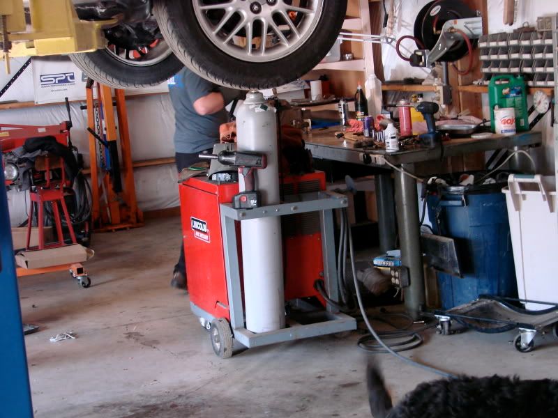

Welded up a new steering knuckle... errrr... dave did that... lol
Got the clutch all done
Steering is just about 3 turns lock to lock... Which seems shorter than the old legacy rack.
I'm excited that its almost done :D
Will be done tomorrow for sure!

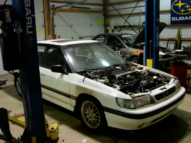

Got everything all done today minus the brake bleeding, hood, and windshield washer tank...
Started and ran... kinda...
Check Engine Light... 23 and 45
Hrms... This is gonna be a bitch... I hate wiring gremlins...
I'm not sure if this project is moving fast enough :shock:
