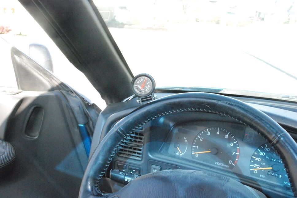

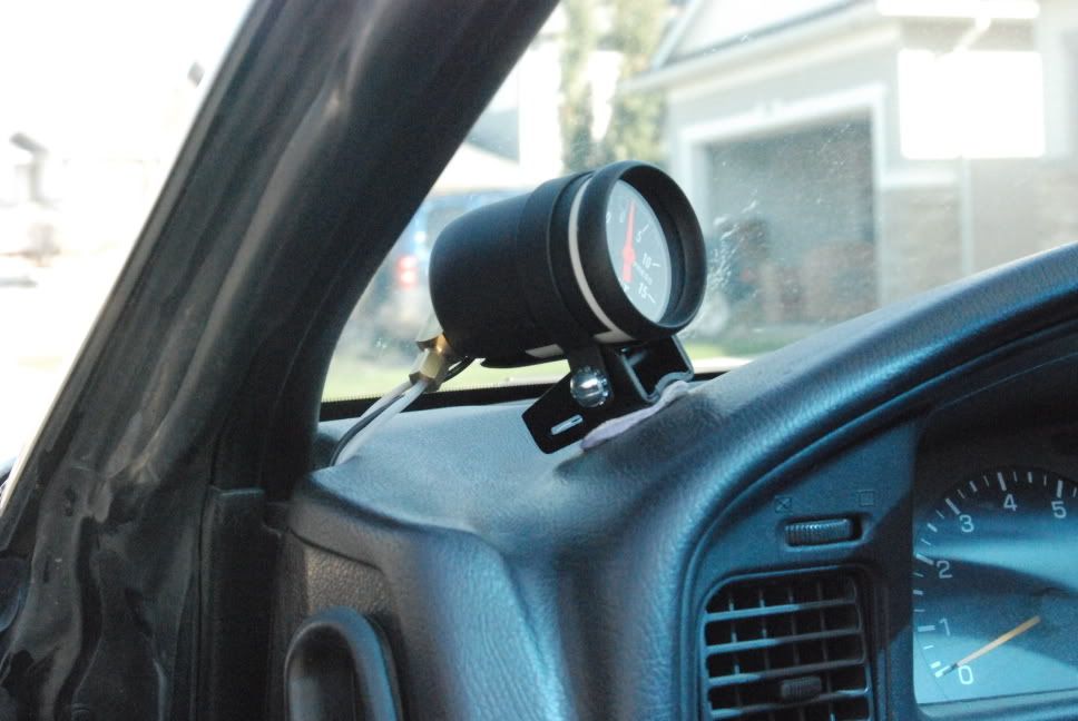

Post by 94SS_Canada »
Here are some pictures of the boost gauge, they kinda suck, but you get the point!
