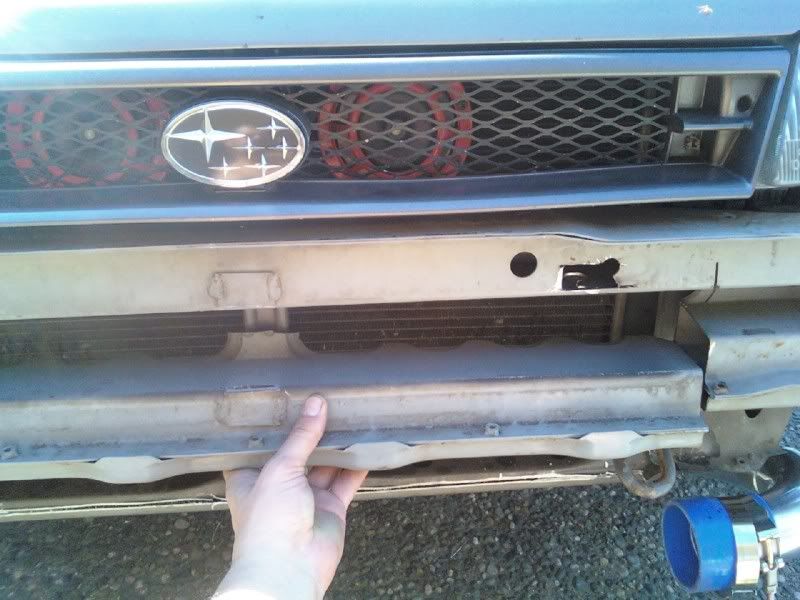

Got a CX racing FMIC kit.
Cut out half of the bumper beam.
Mock up.
Finished.
More finished.
Only mod i had to do, was cut the "cold side" pipe, where it curves around the oil fill tube. The angle didn't work. Luckily i had a coupler with a flex part in the middle.
Mock up.
Finished.
More finished.

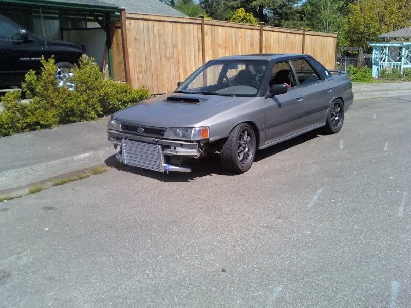

Re: Florin's 91ss w/ a little MAKEOVER ==> Now Build Thread
Hurry up and post a pic of it with the bumper back on! I like the stealth black rattle job. Now you should get an NA hood. I've got one for my car waiting for me to go FMIC. But I think I will look for a smaller core that will allow me to mount it without cutting the beam. I figure if it's 2-2.5 inches less in height it will fit without cutting and it will still be larger than my TMIC and certainly more functional.
- Posts: 6322
damn dude, that thing is huge
tuck those pipes up too man cant have them hanging below the bumper!
Don't you have the same kit?cj91legss wrote:damn dude, that thing is huge
- Posts: 6322
no, the piping on my hotside is all greddy stuff, and the piping on the cold side is parts from one of CX Racing's universal 2.75" intercooler piping kit. my core is a no-namer. but it's a nice size.
Logan, I dont have Tig skills. lol. I'll see how they hang once i put my cover back on. Trying to figure out wtf im running 9:1 afr's... The FMIC kit wouldn't have affected that, would it? <-- this ? is for anyone who can chime in.
