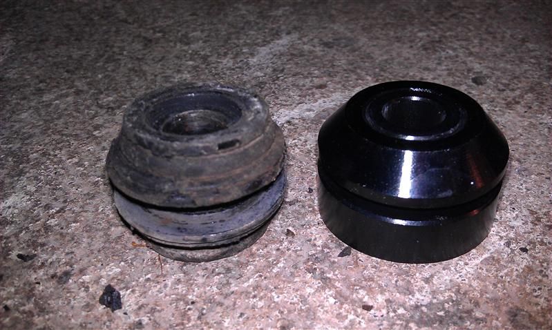

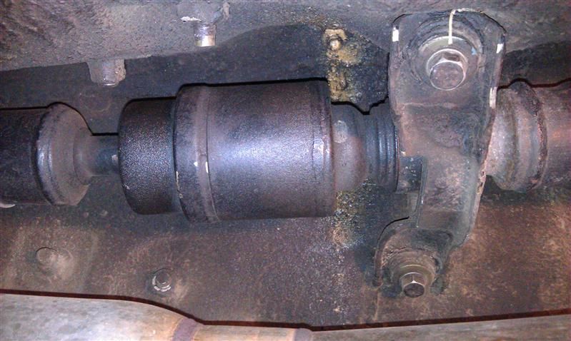

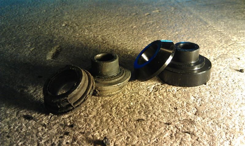

I just replaced my driveshaft carrier bearing mount bushings with Torque Solutions anodized aluminum bushings. Didn't notice any difference but they were pretty easy to do. 30 mins job. I'm about to order the rear diff bushings, subframe locking bolts and trans crossmember bushings. Got a horrible clunk on hard shifts and I can't stand it.

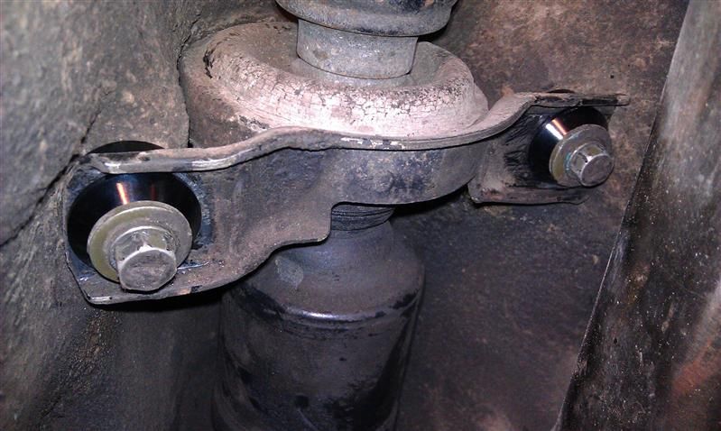

The mounting bracket that holds the studs on the diff cover to the rear cross member is different. Back when 93forestpearl did his bushings I inherited his diff bushings for my 02 because they didn't fit.
This is the impreza bracket with the new bushings installed.

Don't think you can use the WRX bracket and the bushings were too small I think to put into the tleg bracket. If I remember correctly the tleg bracket one end sits high one sits low its not straight across.

Yes, the legacy rear diff bracket is different, and yeah it does have one mount high and one low. I think you can still get some bushings to fit it though. Just need to figure out which ones.
I was going to replace them a while back, but never got around to it.
Any idea where to get the proper bushings? I haven't seen any aftermarket ones so they'd have to be factory bushings which probably won't be very stiff and possibly not worth the money to replace?
Not any more. Here's a blurb from my AWD & Swap write up.
The first main issue I had was with the rear differential member or mount. I had ordered an STi differential mount for a 2002+ WRX. It turns out that the mount is different. The WRX mount is wider and the mount points are horizontal with the mount. The rear differential mount for the 1990-1994 Legacies is smaller in width, and the mount itself is mounted in the rear crossmember at an angle. I talked with Rallispec about the issue. There are apparently three different types of rear differential bushings. For the 1990-1994 Legacies & 1993-1994 Imprezas Subaru used a bracket that mounted to the differential and crossmember. From 1995-2001 the bushings were in the crossmember itself. In 2002 Subaru went back to the bracket, however as mentioned above, it's a different size and shape then the old bracket.

From my experience that is correct. My 02 Impreza is the horizontal bracket, my 96 outback has no bracket, and my t-legs have the offset bracket.

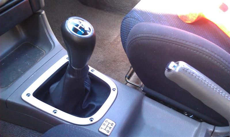

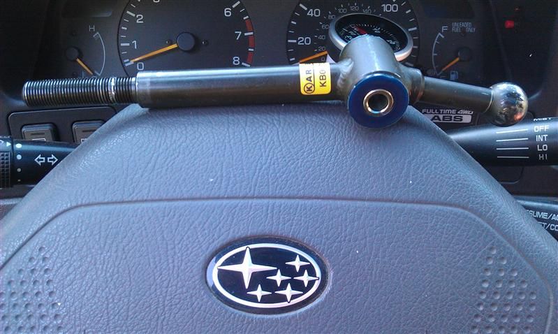

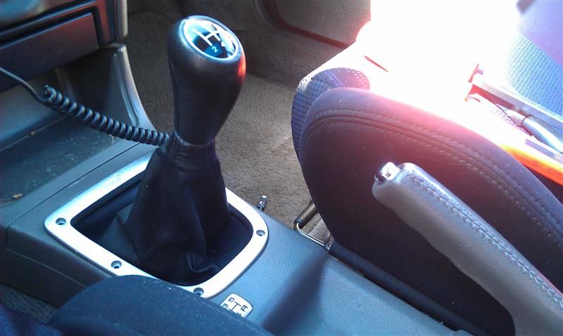

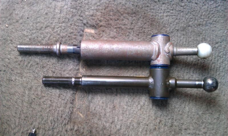

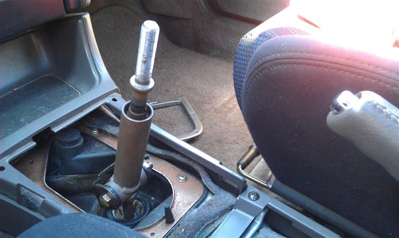

Installed my Kartboy WRX shortshifter today. It...is...AWESOME! Nice short shifts and the knob is probably sitting at the perfect height now. Not honda-low and not space-needle-high. Feels great and well worth the $40 I spent on it.
NOTE: If you buy the Kartboy SS for your 1st gen legacy and you have the stock shift linkage still you need to buy the 97-01 RS (pretty sure, might want to contact them first) shifter because the width of the bearing housing is not as wide as the WRX shifter is. I already have a WRX shift linkage in my car so I was able to find a used WRX shifter on the cheap.

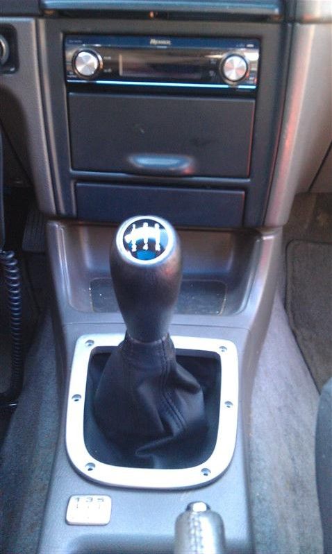

I also installed my new-to-me 1.5 DIN compartment below my stereo and it looks much better now. Thanks Originalcyn!
Before and After

Looks good! My pleasure Kimo, I'm glad you finally got a 1.5 din.
Kijan
1993 Legacy LS | PBM 227
Me too. No more ghetto looking huge gap.
I need to do that shifter surround like you have it setup. I like it!
Regarding the rear diff bushings.....I'd keep searching. Honestly....I doubt you'll notice a difference. The main clunks come from the bushings on the front part of the crossmember T. If you do those and the rear subframe locks, you should be good.
Thanks Josh. I think it looks swell too. LGT knob and boot I think with 04-07 sti trim piece.
