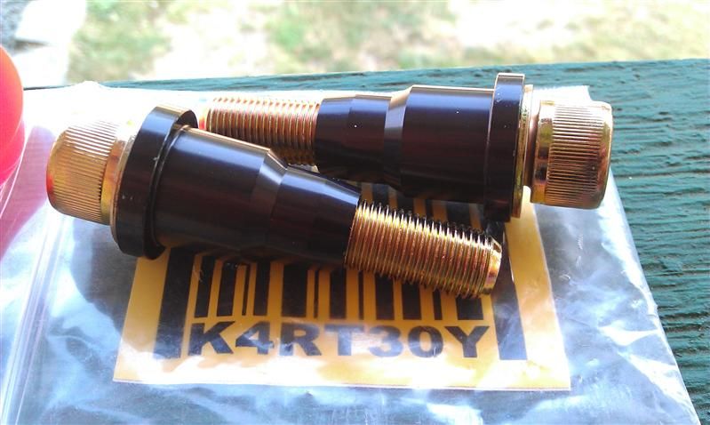

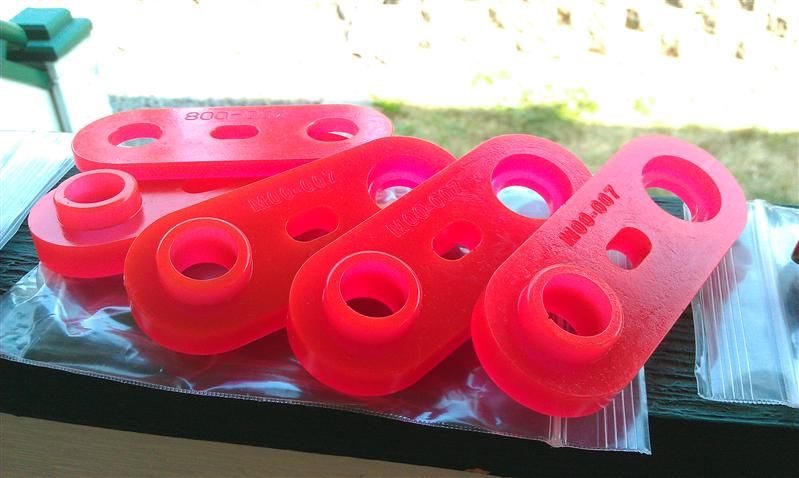

Today I got some goodies in the mail and maybe I can get them on the car today and see if it fixes the loose drivetrain clunks.
Turn-In-Concepts trans crossmember bushings in pinkish red, Kartboy rear diff outrigger bushings and kartboy subframe locking bolts.

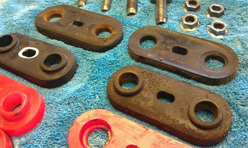

Which bushings are you referring to? The ones in the pic for the front T part of the rear crossmember?kimokalihi wrote:I ended up having them remove the rear diff bushings because they don't fit our cars I guess. Pretty bummed about that because I think those would make a world of difference in both the clunk issue and response. I'm sure that's where a lot of the snappyness is being sapped out of the car since that's where the diff would pivot at.
^^ I think he means he removed them from his initial order for the bushings. After the discussion about them not fitting our cars.
No the actual rear differential bushings. The two that go in the rear diff bracket.Legacy777 wrote:Which bushings are you referring to? The ones in the pic for the front T part of the rear crossmember?kimokalihi wrote:I ended up having them remove the rear diff bushings because they don't fit our cars I guess. Pretty bummed about that because I think those would make a world of difference in both the clunk issue and response. I'm sure that's where a lot of the snappyness is being sapped out of the car since that's where the diff would pivot at.
Got them installed. Took it for a quick drive after the trans crossmember bushings were in and it felt a tiny bit better I think but that could be placebo. Then I installed the subframe locking bolts and rear diff outrigger bushings using the thin bushings and not the thick ones. Seemed to fit much better than the thicker ones which I think are for WRX and newer cars.
Initial thoughts are that those subframe locking bolts sure made things a hell of a lot more audible. Not only can I hear my diff now (more so in 1st and 2nd gear) but I can also hear the road louder now. So if you drive your car daily and don't really like noise, don't install these bolts. I don't drive this too often and for this car I could care less. I just want performance and responsiveness and no clunks or creaking. Still have a stupid creaking noise up front on the left side that sounds like it's coming from right around where the simply subie fender braces are installed. I thought the bolts might have come loose a bit but I checked them the other day and they're tighter than a nun's cunt so it's not that but I bet it's a result of installing them. Makes a cracking sound every time I hit a bump. It didn't initially do that when I installed them but it does it constantly now and it drives me nuts.

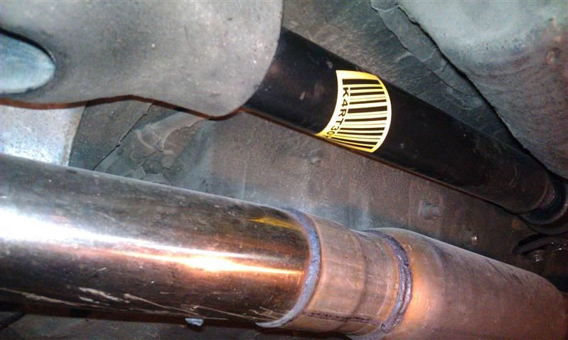

Back to the bushings and stuff. It definitely took away some of the slack in the drivetrain and I think if I replaced those rear diff bushings it would be great and pretty much all that would be left would be the driveshaft itself?

Meh, I work at a slow pace and taking pictures doesn't help. Plus I like to take all the bolts and nuts that I remove and clean them up with the wire wheel on my grinder and then hit them with some anti-seize spray before putting them back on the car so if I ever have to do them again they're nice and clean and come right out.
Took me 4 hours to do it all but you could easily do it in 1 if you weren't taking pictures and didn't care about cleaning the parts. I also had to drive over to a friend's house right down the street to borrow a 10mm allen socket for the subframe bolts. Don't know why you would make an allen bolt on a car but whatever. How many people are going to have a 10mm allen socket? Not a lot. Pissed me off that it wasn't a standard bolt head. Added 20 mins to my install time.

Yes the sub-frame lock bolts do add a bit to the noise of the car. You get used to it. I drove from Houston to San Francisico with pretty much all hardened bushings in the car
