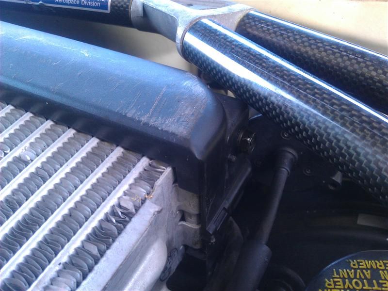

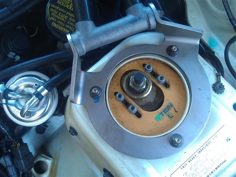

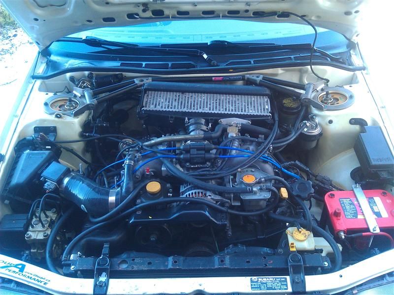

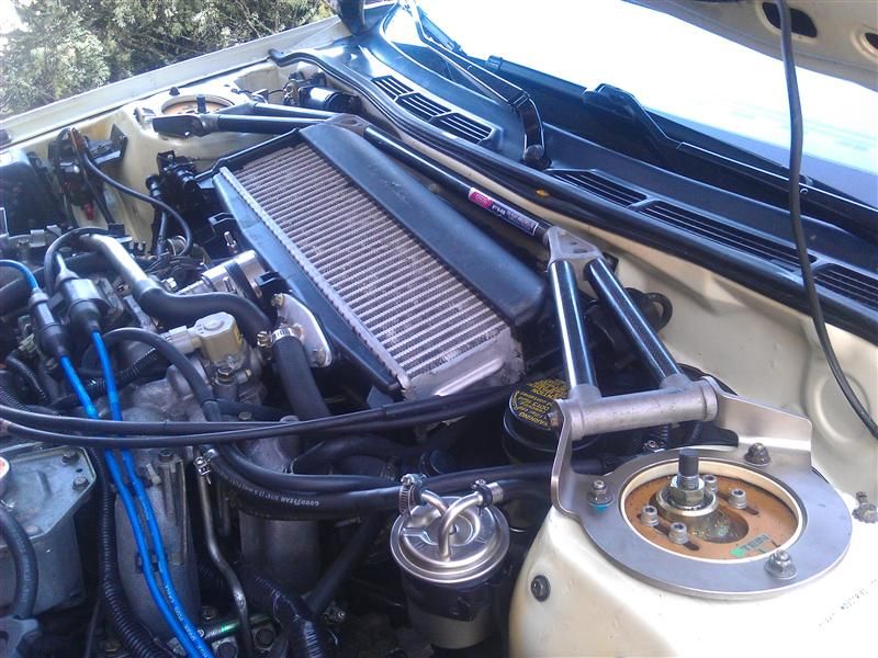

GC STI Carbon strut brace to stiffen things up a touch. Looks really good and fitment is excellent like it was made for this car.

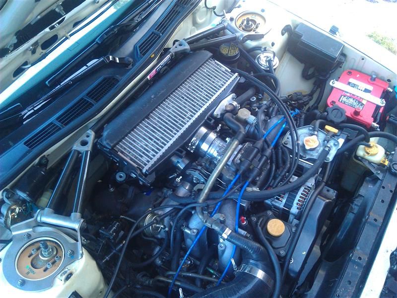

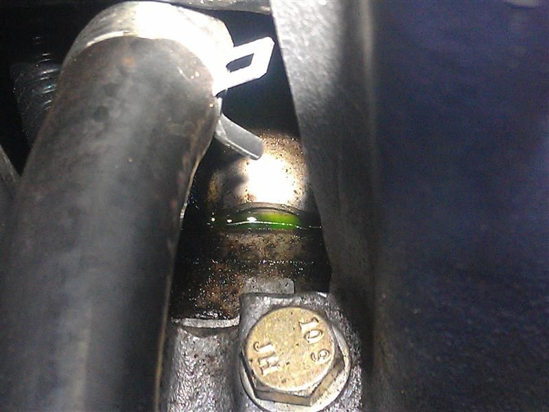

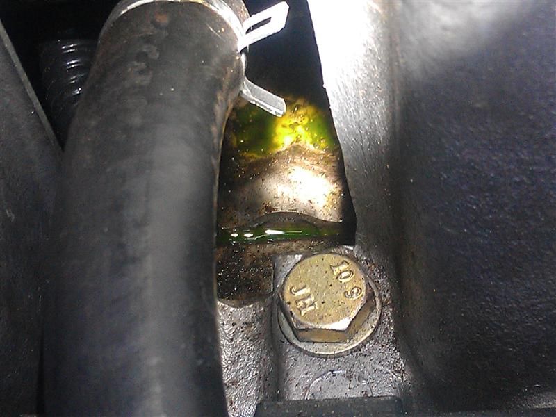

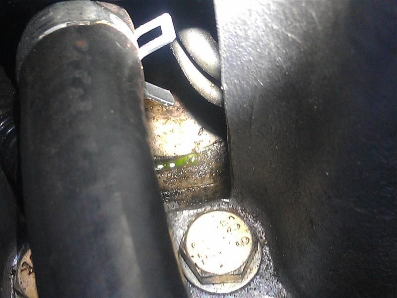

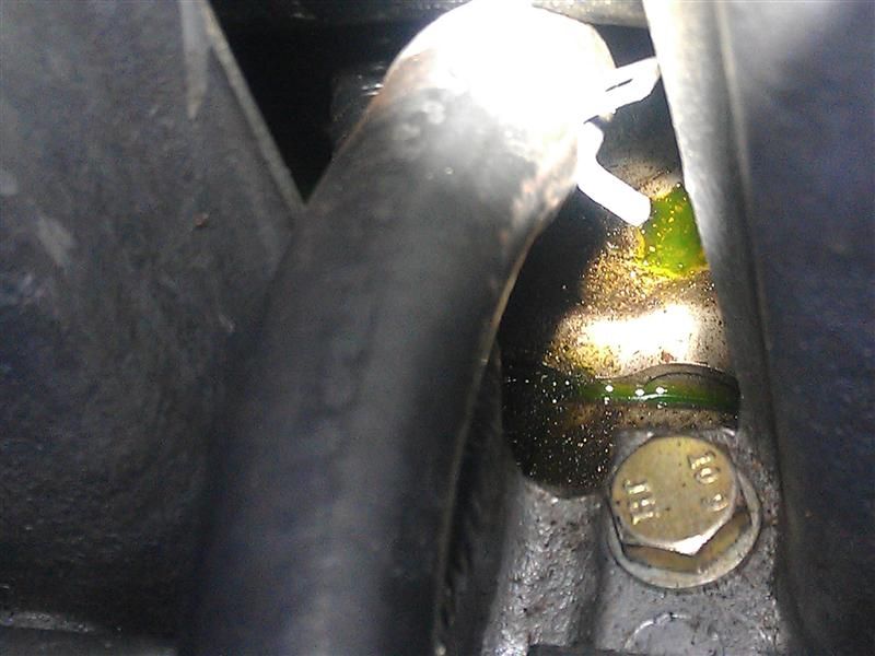

I think this has to be my coolant leak. Blown head gasket on passenger side. Not shown in the pics but further back towards the firewall you can clearly see the head gasket protruding out from between the head and the block. Then there's the huge gap in these pics where no gasket is visible. I can't find any leaking hoses and so it has to be a blown gasket or the coolant crossover pipe somehow leaking which is unlikely.
Thoughts? This may be a stupid question but would it be worth trying to vacuum out all the coolant from that gap and filling it with gasket sealant? I don't want to remove the engine again. :(

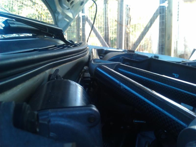

nice strut bar, i have the same one. where did your washer bottle go??
as per the HG. just sucks to hear this happened now. especially during winter.
Washer bottle is relocated in the driver's side fender.
sqc151
Posts: 1199
Location: NY, NJ
Post by sqc151 »
ahh... slick... :smt023
its down in front behind the bumper cover?
how do u fill it?
Yeah it's directly in front of my driver's side tire. Freed up a lot of room in my engine bay. Can't wait to ditch the ABS and free up some more space.

Try cleaning the coolant so you can determine with more certainty where it's coming from. If it is the headgasket you could try some rtv silicone, but I doubt it will last long.

That strut bar is a great addition from both a functional and aesthetic standpoint. I regret selling mine every time I see one.
Got it from a gent on SLI for $175 shipped from Japan. I believe he's moving so I don't think he's got the hook up on JDM parts anymore. I like it. I wish I could still use my strut covers but alas they do not snap on with the brace being too thick.
