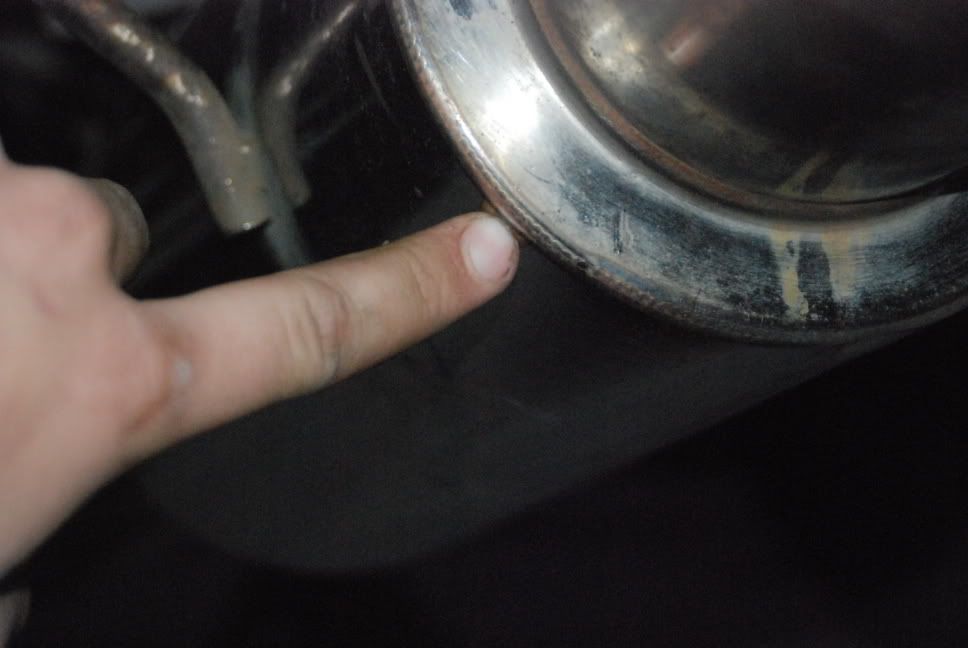

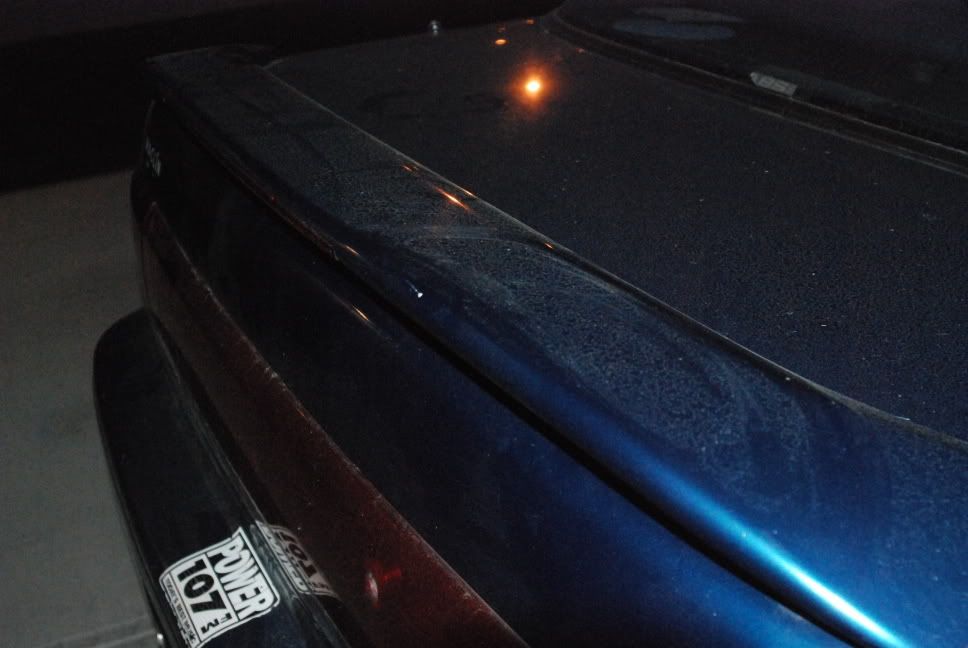

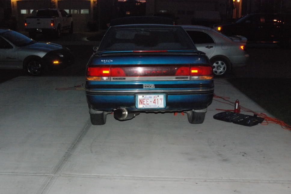

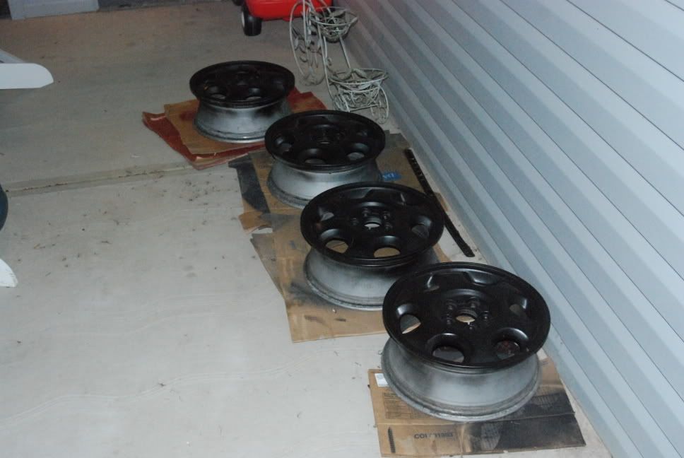

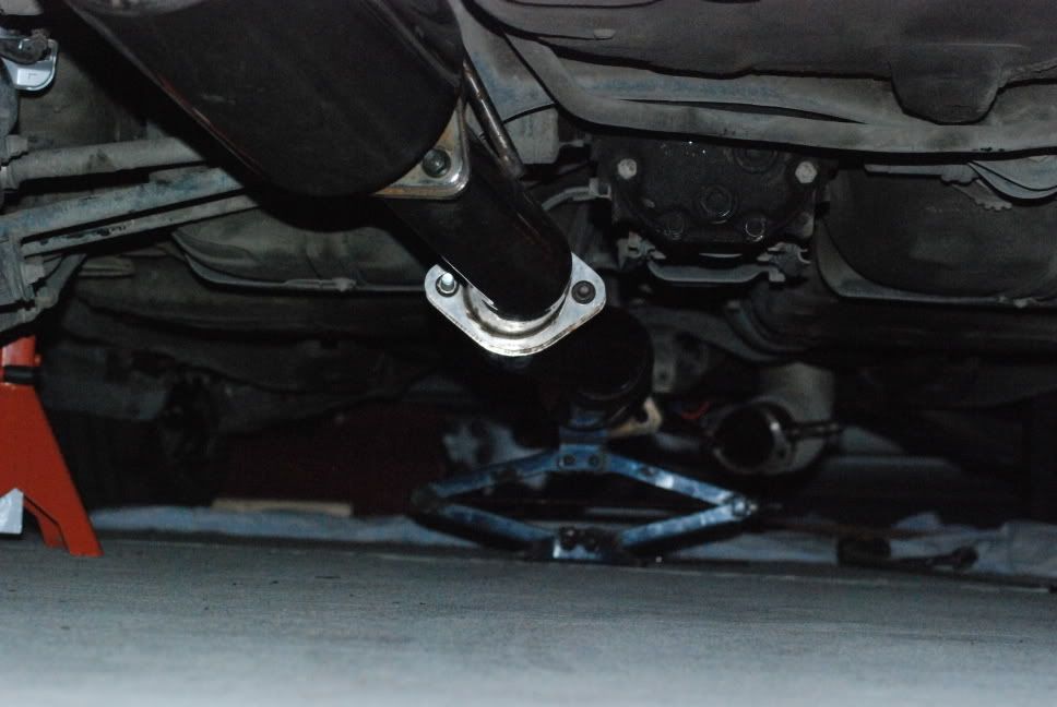

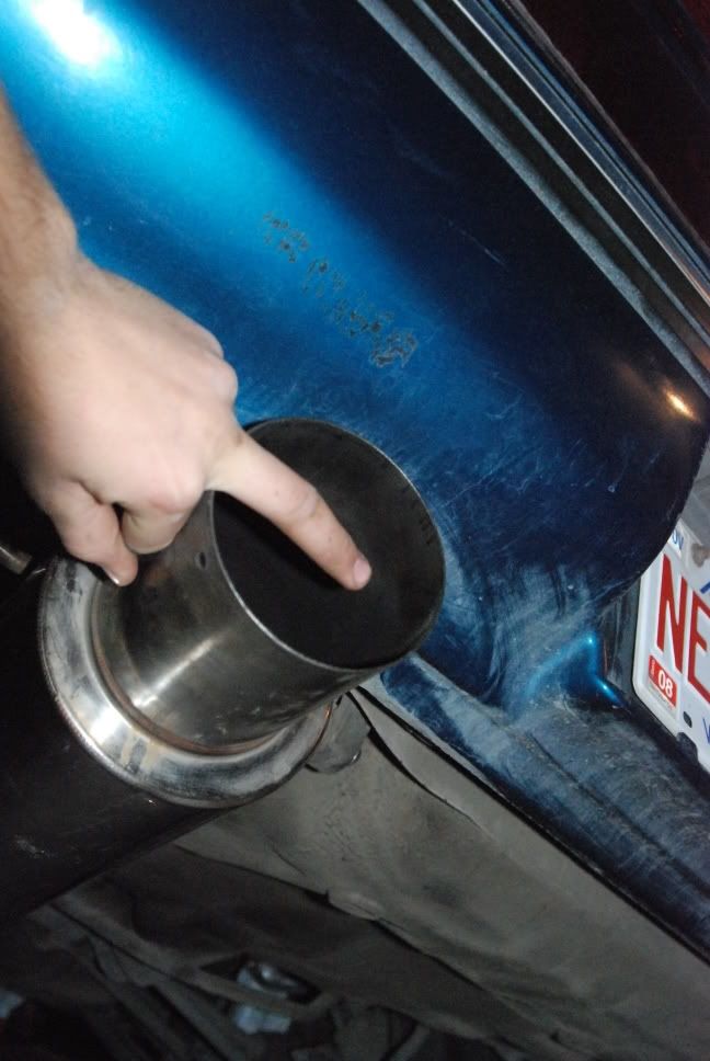

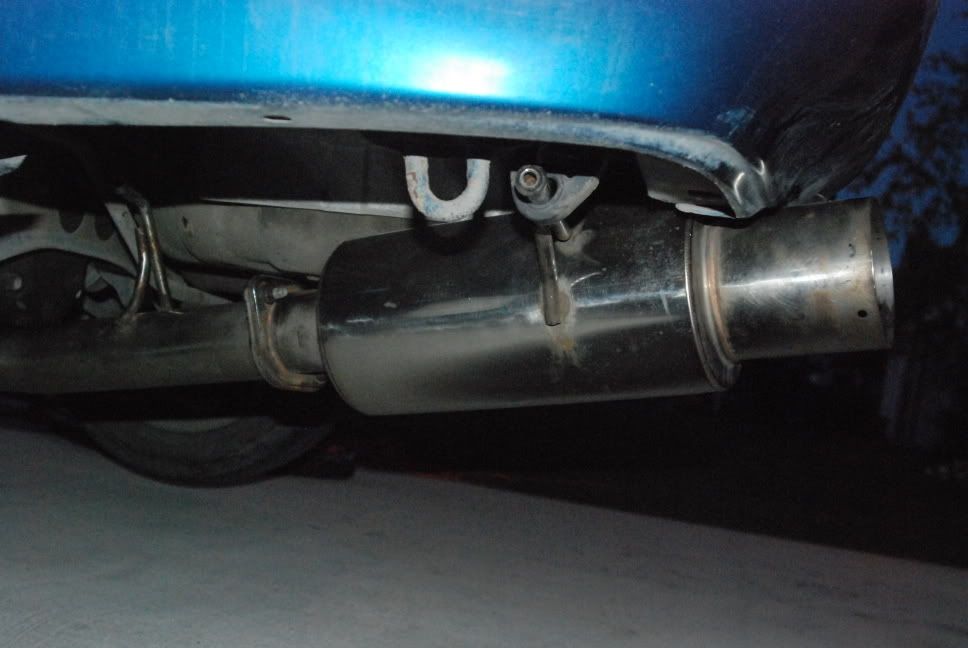

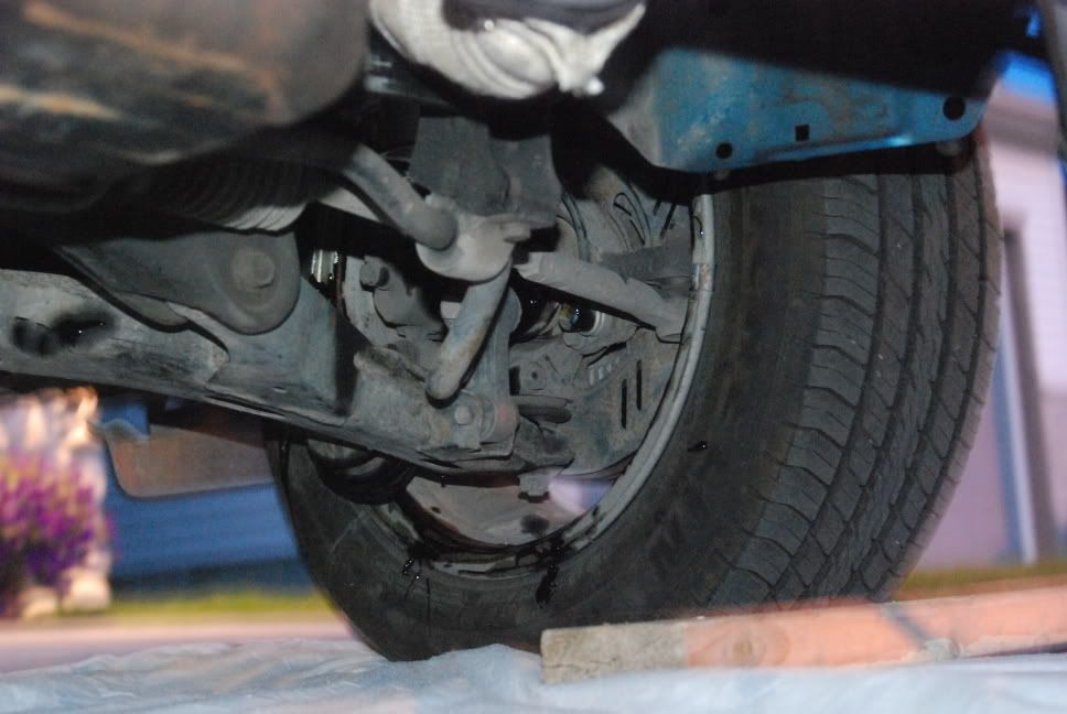

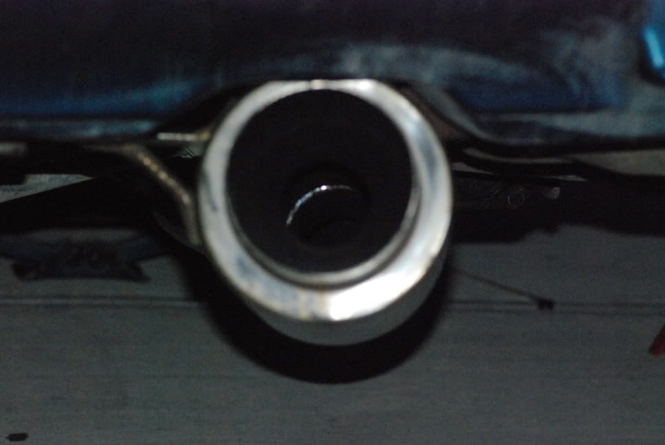

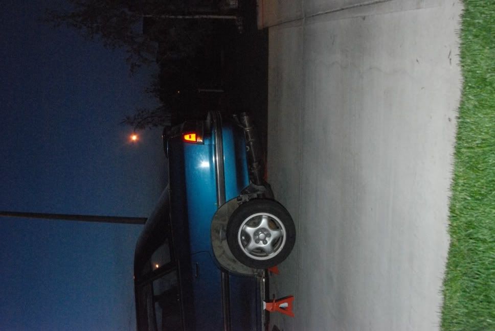

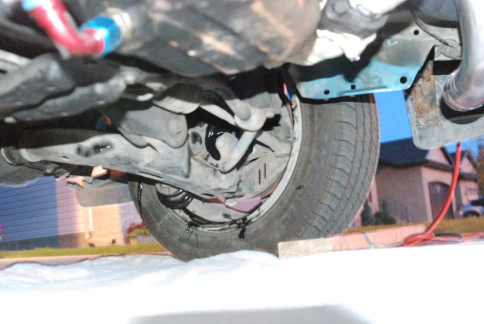

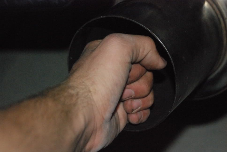

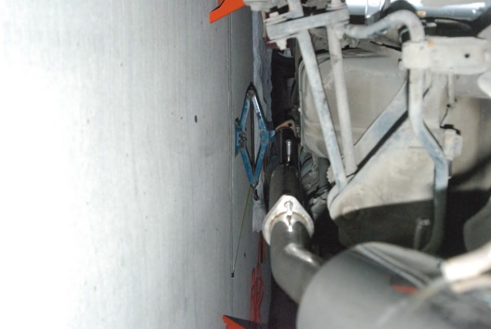

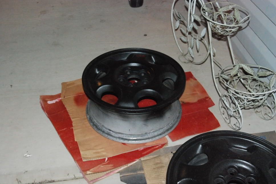

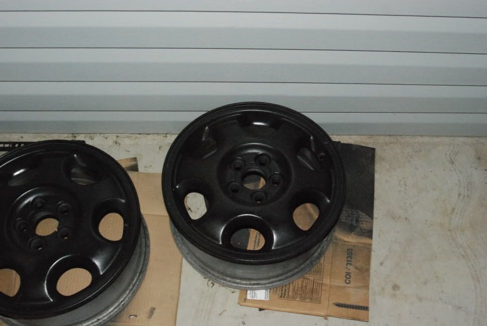

Here are some pics, The exhaust looks alot better in person than what it does in the pictures.Enjoy!

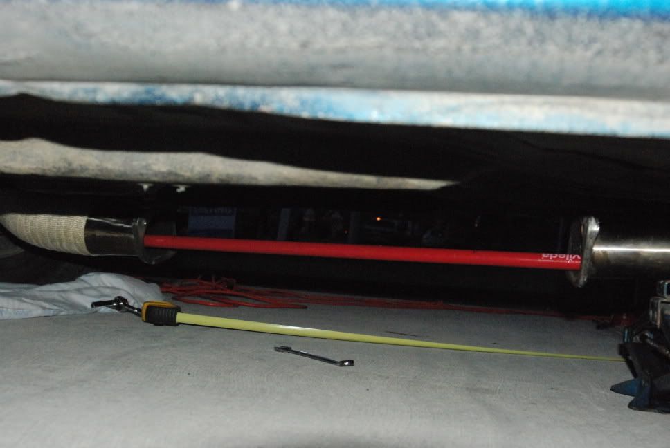

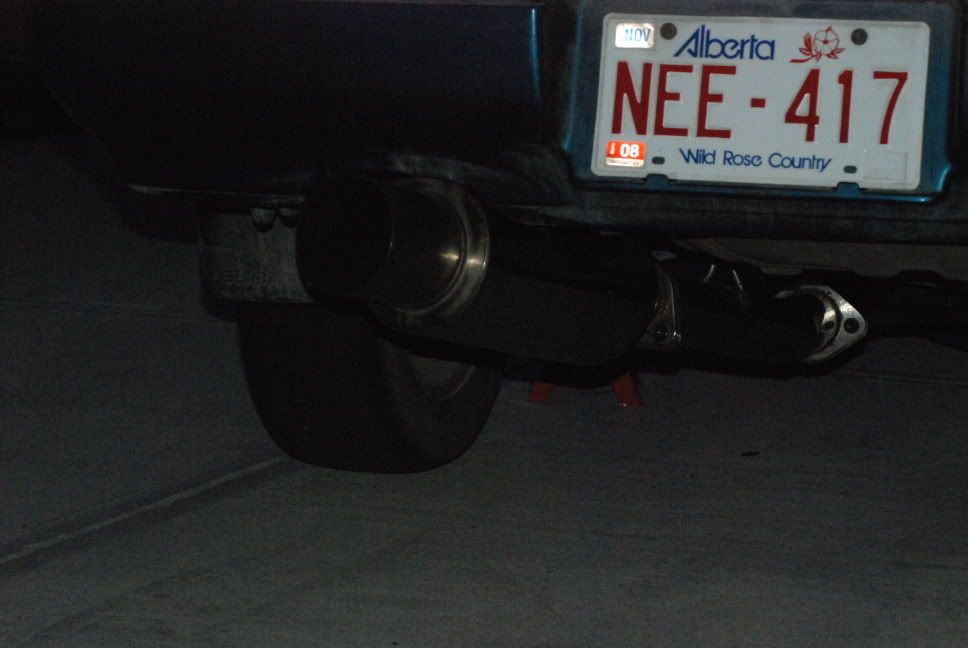

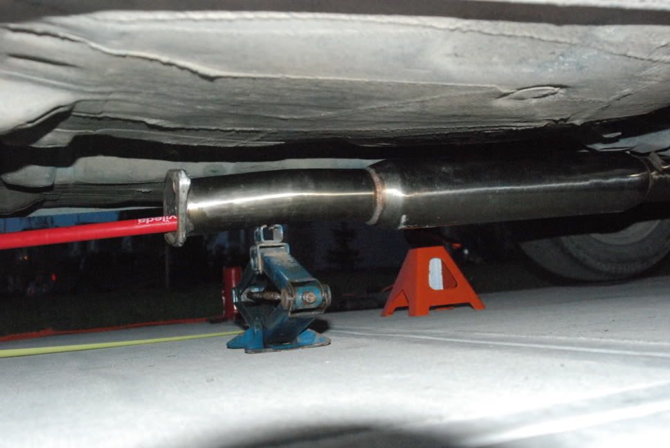

I knew the Exhaust would be short, didnt know it would be this short....
Ghetto
In case youre wondering yes that is a very, very rare jack from a 1985 subaru GL
Ya, its big

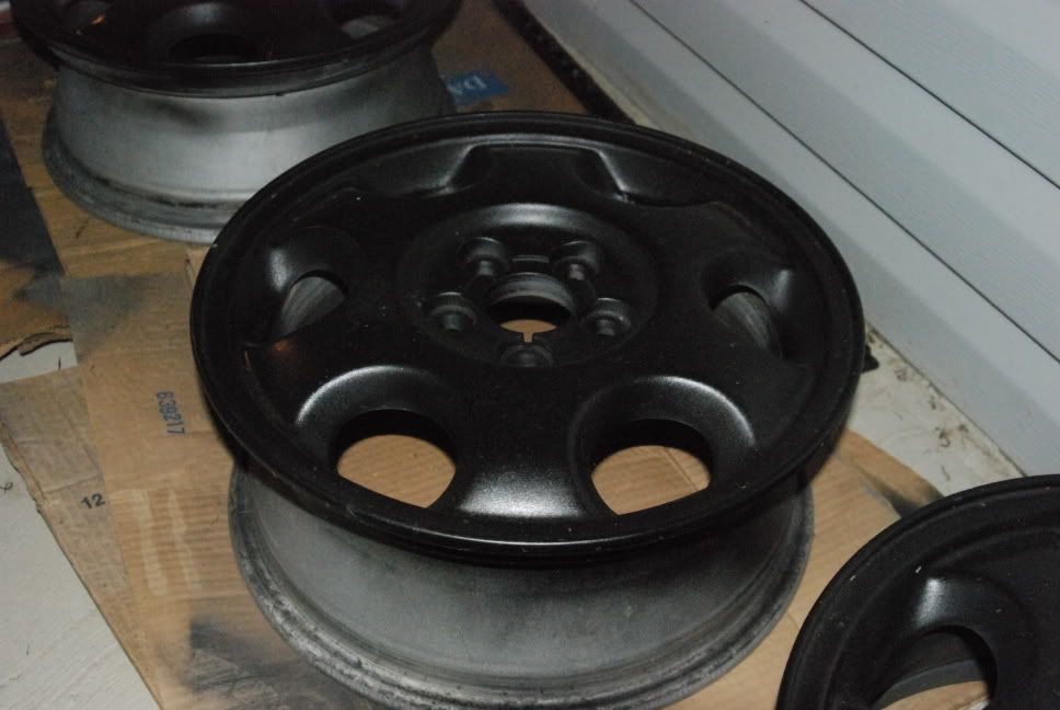

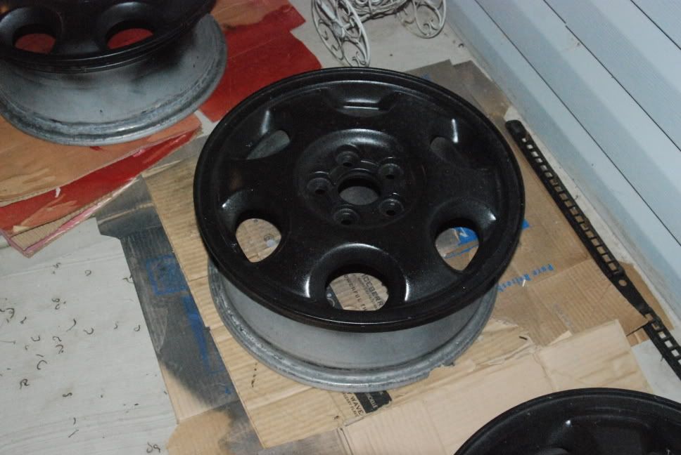

Oh ya, painted a set of Outback wheels of of my brothers old outback (Same as RS)
For so much rust, the spoiler dosent have the infamous chipping.
When i get it running, it will be cleaned.....

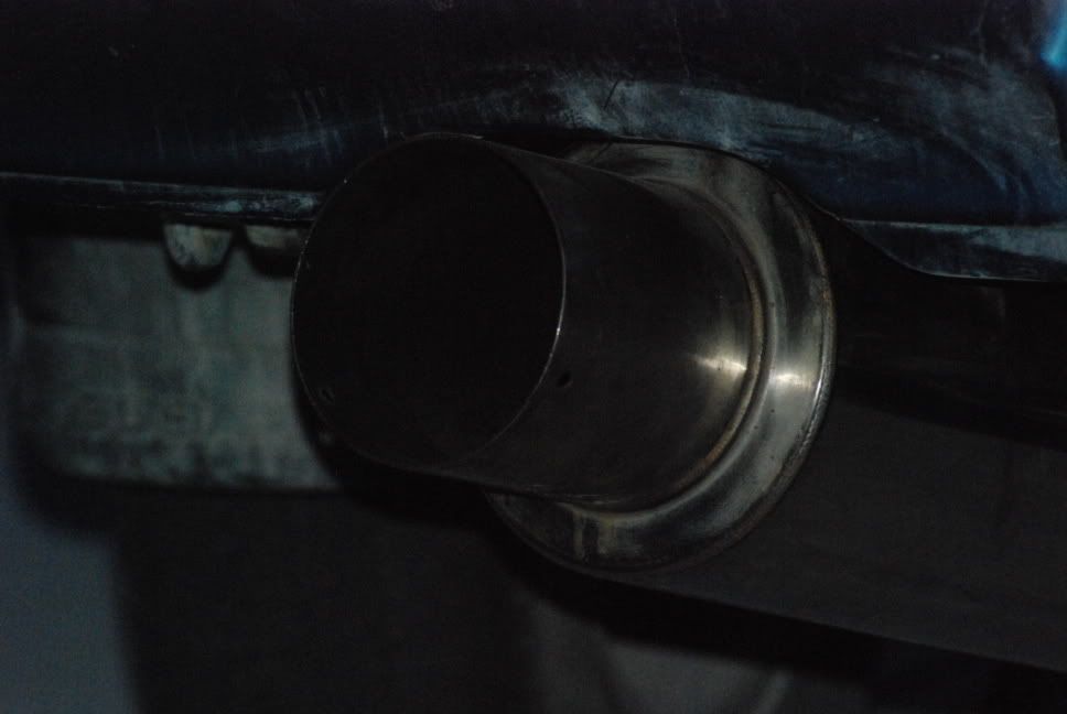

500HP exhaust on a....What HP car?
The Drive Axle boot twisted on the CV joint and snapped it, just my luck....

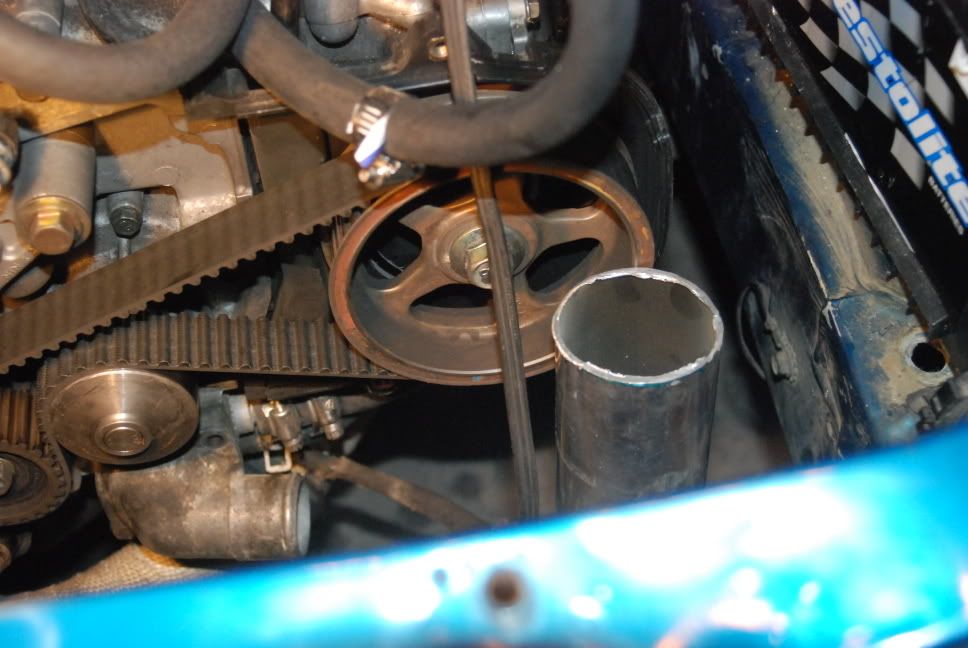

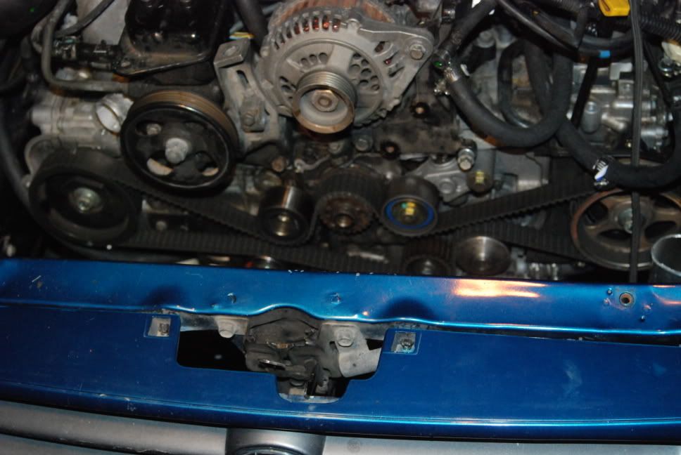

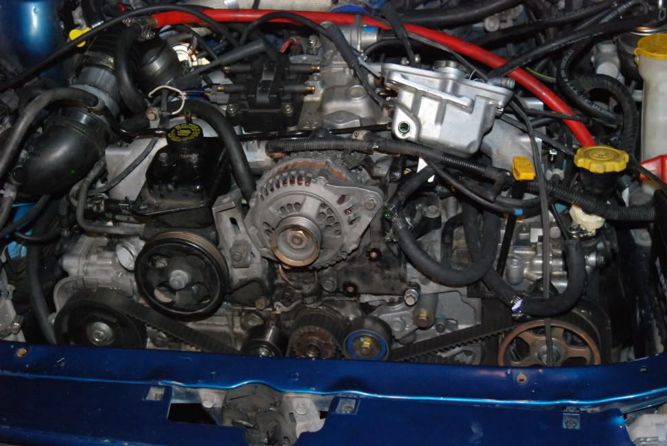

I would like to just give a BIG, BIG thanks to Stipro, He came over yesterday and taught me alot in the brief time i met him, We discussed what my best options were and he came to the conclusion that using my EJ22T Cam sprockets with the correct receiver lobes on the back for the cam gear sensor SHOULD fix my problem. Ive never dealt with timing belts before and have no idea what im about to do, although ive been given some good advice im going to try to do my best.

The sprockets were almost identical, there were slight diffrences we will try.

okay i fucked everything up i marked all the marks on the belt and i cant get it to fit, this is fucked!

SO Everything went back together, tryed to crank it, it spuddered a bit and did the same thing it did before.
The timing sounded and felt fine, im going to go to the scrap yard on monday for a cam gear sensor but other than that no more money for this hound dog.

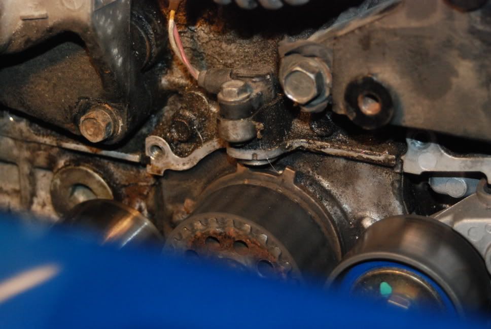

i'd check the relation of the key on the camshaft pulley to the timing marks as well. They may be off by enough that it's throwing the timing the computer is seeing off. You might also check for broken wires somewhere. Chase everything down. Follow the wires from the sensor to the ecu. Also you might search for anyone that's done the conversion to 25sohc heads on nasioc, you might find some tips

the key is that round peg on the back of the camshaft pulley that keeps it from moving around. You can see it in the picture above that you posted. it's like a little o that fits into the camshaft when you bolt the pulley on.

oh, when you do the timing belt, make sure you line up the mark on the back of the crankshaft pulley, on one of the teeth that triggers the sensor, and not the arrow on the front of the pulley which indicated TDC. This can trick people.
