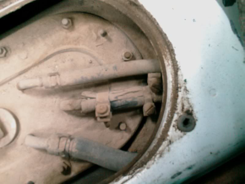

I decided that it was finally time to make sure I was going to have enough fuel, so I popped the fuel pump out with plans to install an STi pump I have here. The first surprise was when I removed the access cover, and it was a nasty one. Check out the pressure line...apparently the PO had replaced some line with NON-high pressure hose. Can you say SCARY?
At least I got a pleasant surprise when I got the old pump out. It had already been upgraded to a JECS unit from an older JDM WRX/Legacy, P/N A42-646055, and it is rated at a little more flow than a USDM STi pump. No bad thing there, so back in it went with some fresh rubber hose.

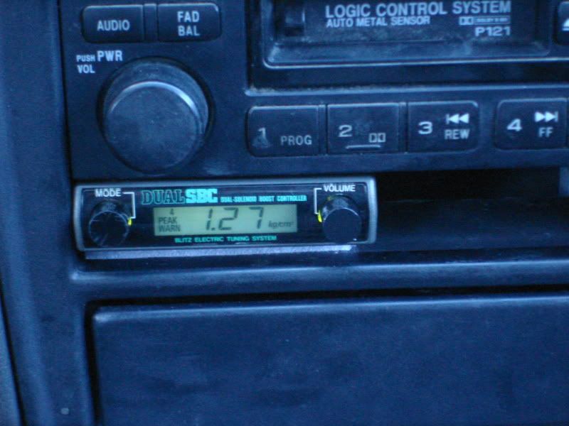

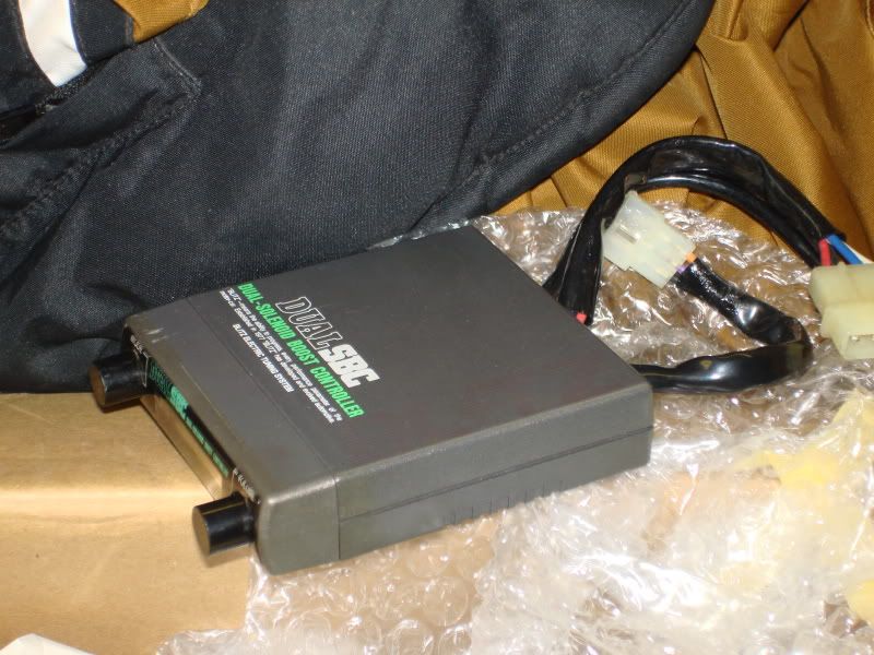

I also finally ditched my MBC for a Blitz Dual-SBC boost controller I got used on Ebay. It hooked up with 2 wires, has 4 programmable boost settings, W/G gain adjustment, overboost protection, scramble setting, peak recall, etc. Works perfectly, and the head unit fit right under my radio. (Forgive the filthy radio controls, I guess I never have cleaned it)

Other than that, the car's running great at 16 pounds of boost, epecially considering I still haven't replaced the Hitachi MAF with a Jecs yet, and the injectors nearing their limits. I'm planning on taking the car to the dragstrip tonight, & I'll report back with results!

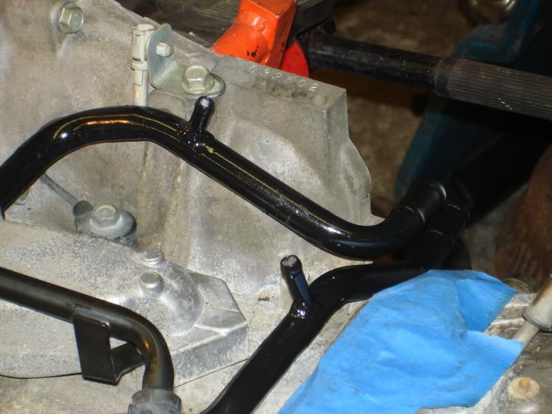

SLODRIVE wrote:I'm an idiot...as soon as I started looking at the intake, I realized that the IAC needs coolant to run through it...thus I need nipples on the heater pipes. So, I pulled them back off, cut two nipples off of some old pipes, drilled holes, welded and re-painted, bla bla bla...
Better now. :-D
These 2 nipples that feed coolant to the IAC and TB, Does it matter which nipple sends coolant and which nipple receives?
I'm doing a 20H head installation right now and i have a few small things to work on with my engine before it goes in.
Re: The SLODRIVE '92 SS Build (warning: UGLY pics!)
Yeah, isn't that lower pipe that goes straight across the block a return line from the heater core to the water pump? I think the other pipe off the crossover pipe sends coolant to the heater core. I could be wrong though.
