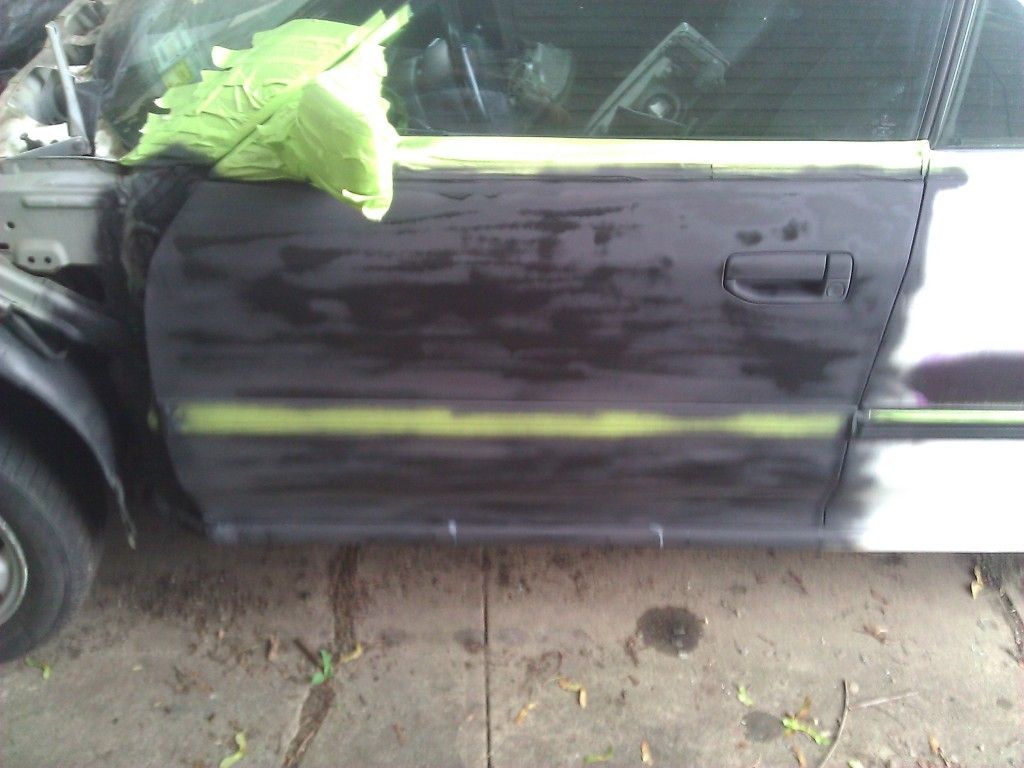

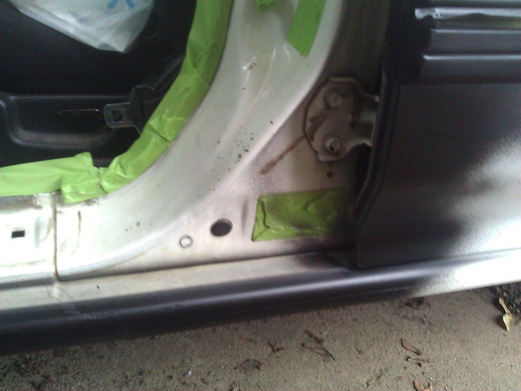

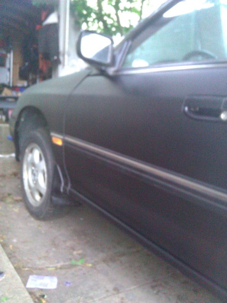

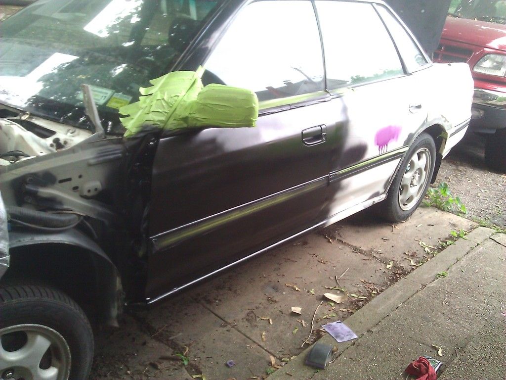

got around to some stuff recently

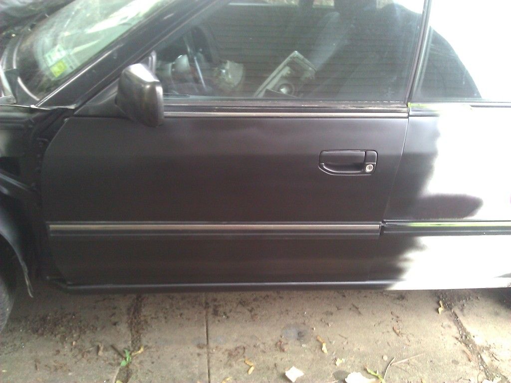

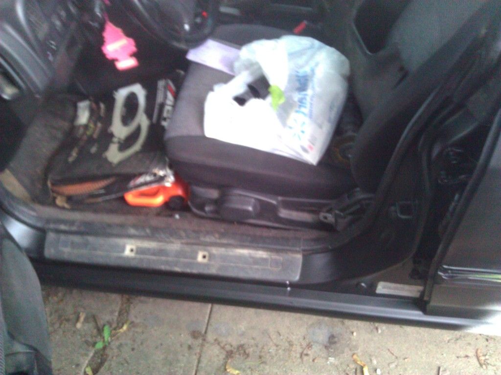

got the driver's door primed
painted

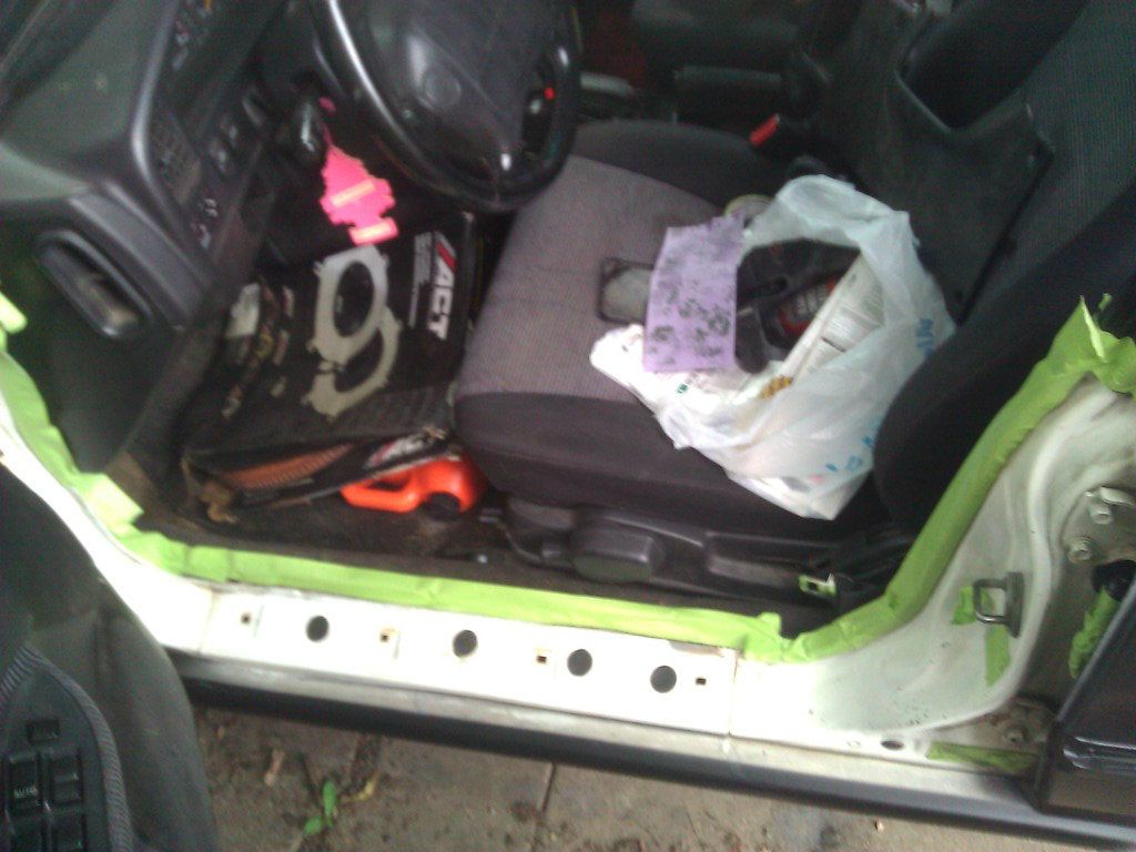

even went the extra mile to paint the door sills so you won't know it was originally a white car

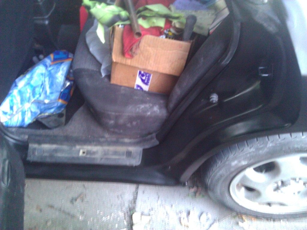

taped it all up nice nice
had to keep the details intact
looks like it is done here haha...I wish

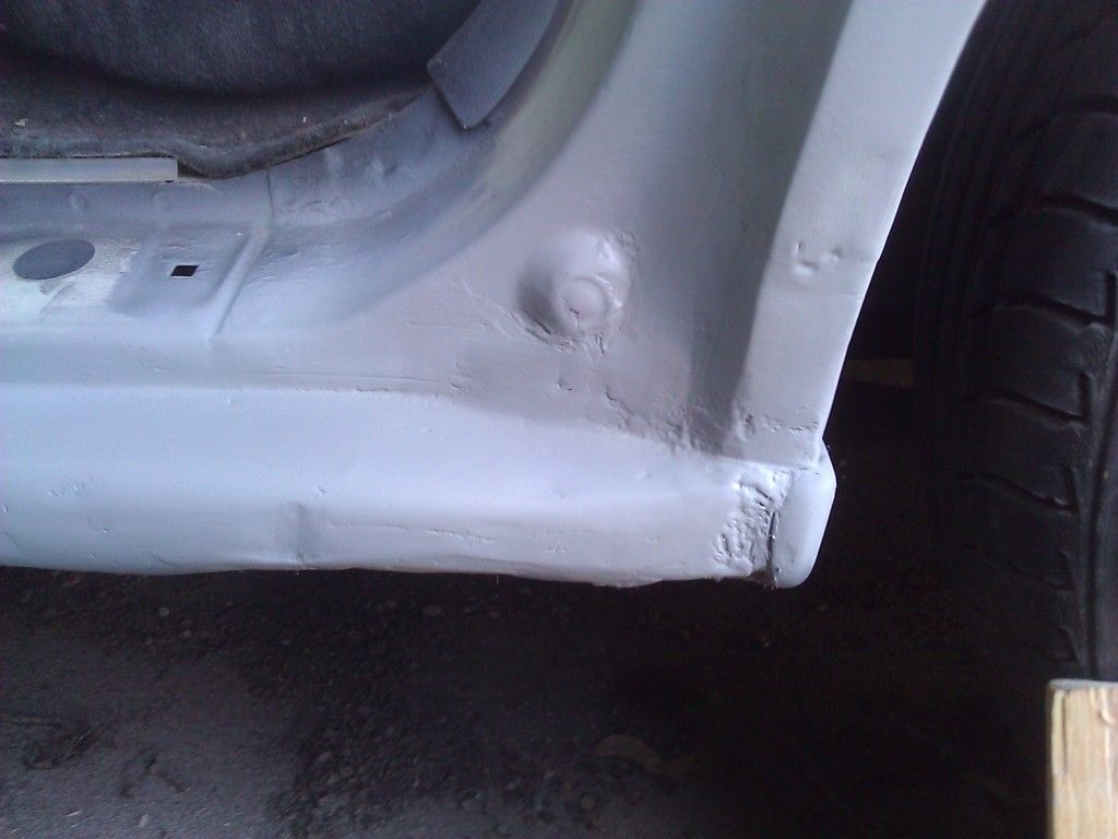

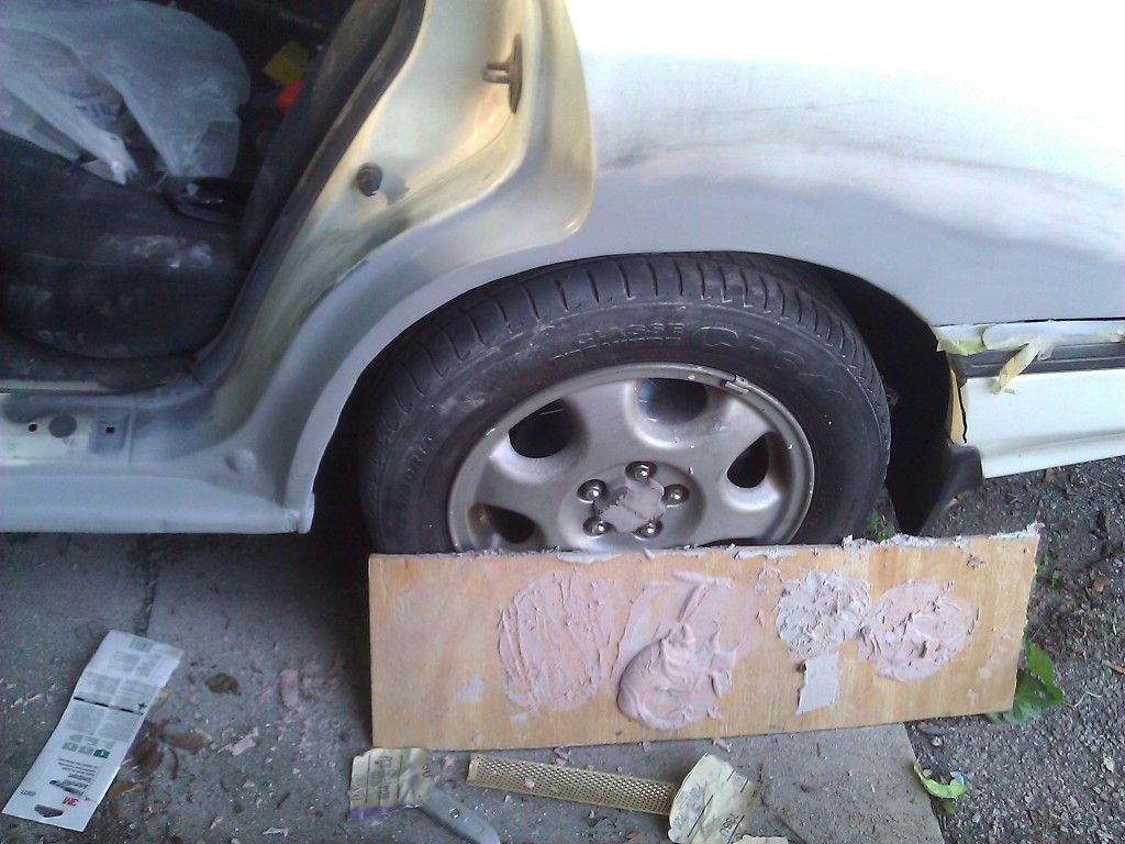

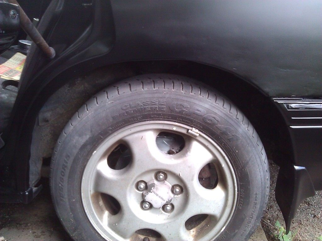

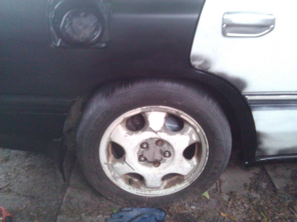

finished the last of the bondo work here, sorry about no step by step pics of this it was nearly 100 degrees outside
not the best but a million times better than the nothing that was there lol

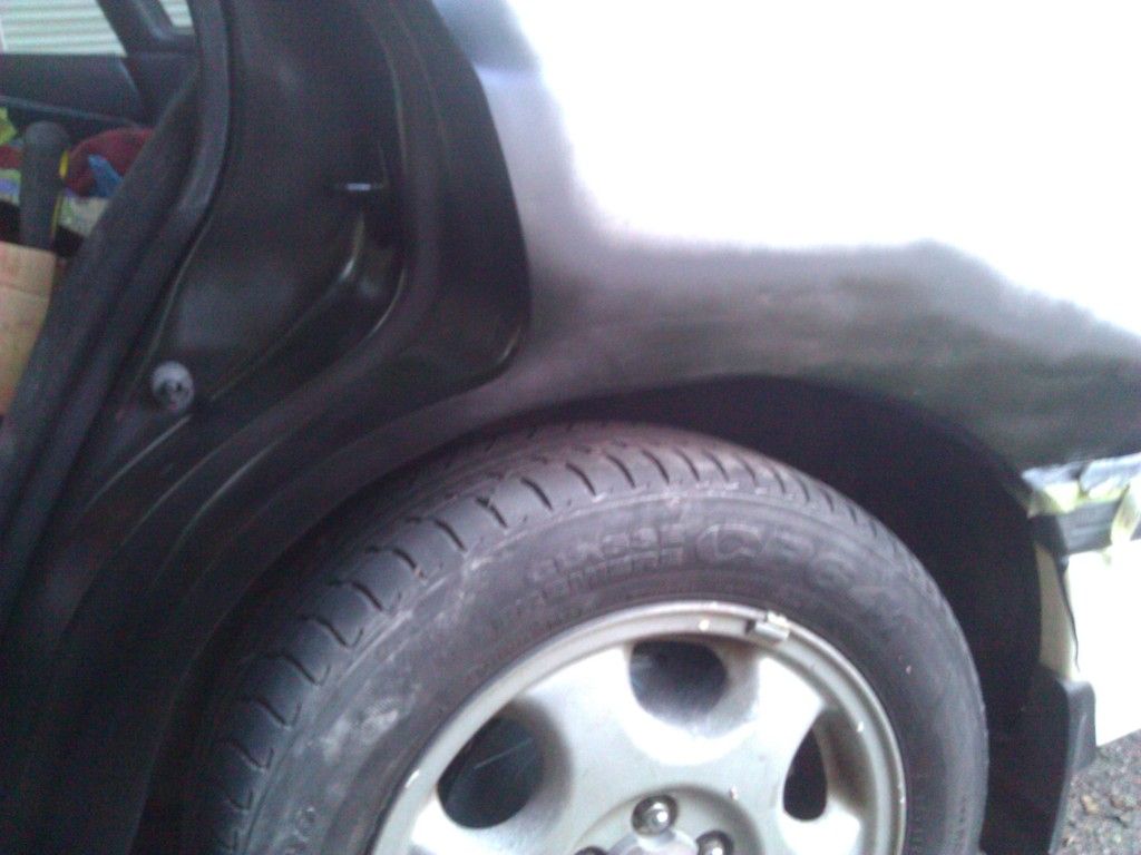

and painted
now to finish the drivers rear quarter and then jump to the other side and finally the roof.....hopefully it will go quickly as the PS pump on the RS is slowly crapping out on me, and I would much rather be driving the Legacy than the F150 again
painted
and painted

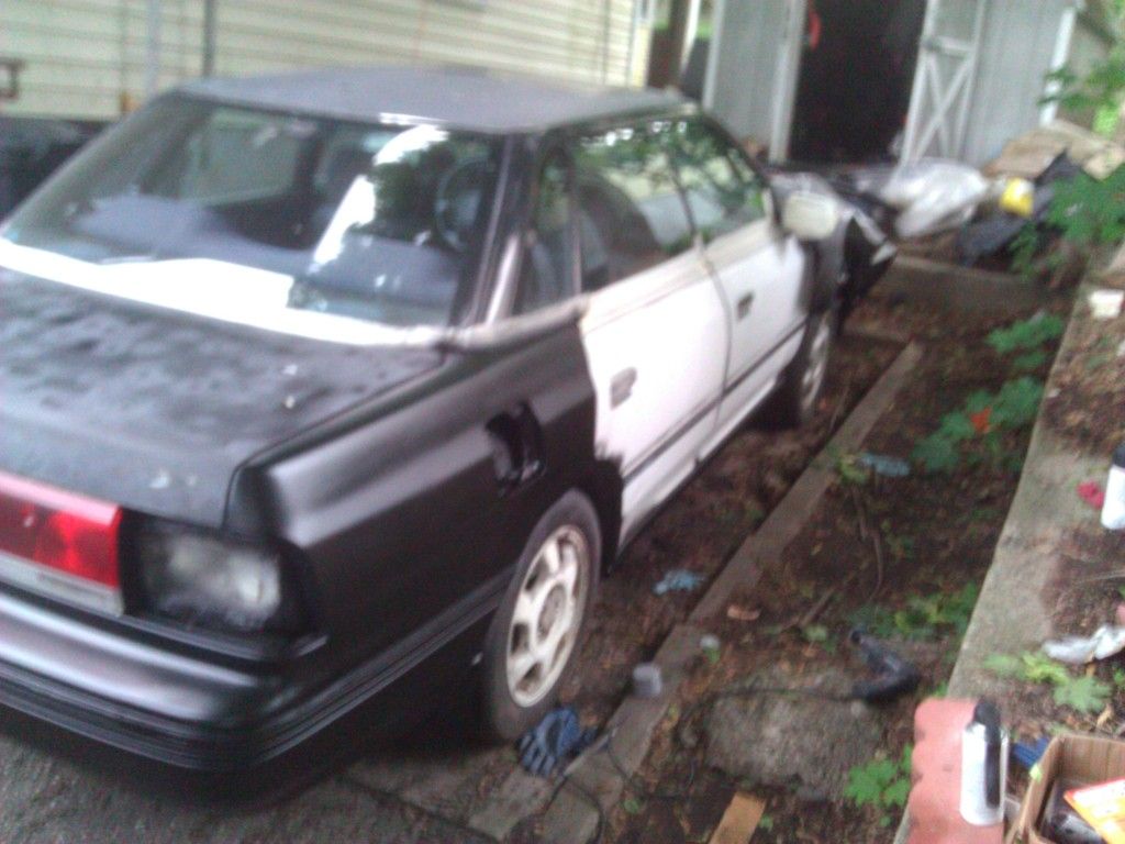

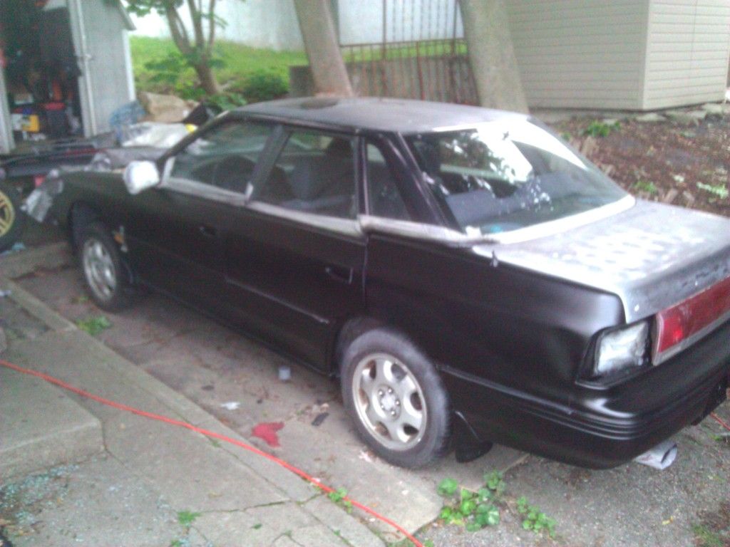

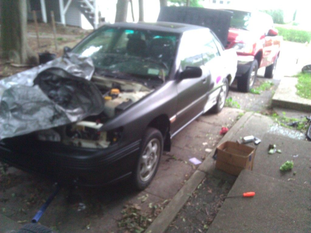

got some more done, in fact the only thing left to paint are the outsides of the 2 passenger doors and the hood. Check out some pics.
so got A LOT done today as I didn't have to watch the kiddo, bodywork is done and it will probably need one more coat after everything is painted just to make everything even and smooth, not much longer and this heap will be on the road!!

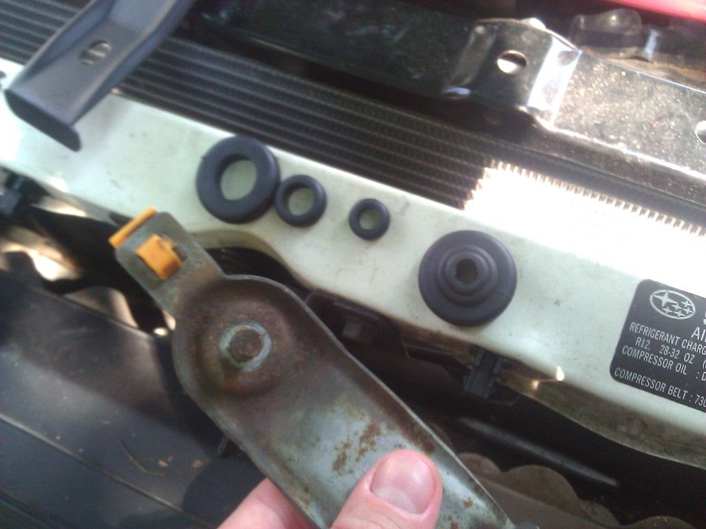

spend 2 hours out there trying to drill holes until I couldn't see anymore, managed to drill out the rad support bolts that broke...those fender bolts are a bitch though.....and I just realized I am too broke to buy theself tapping screws I need haha!
Also does anyone know where to get those ribber grommets for the radiator support brackets? they were just missing since I've had the car...doesn't seem to be any place that has that part, wondering if they are universal or something.
Re: Xise's 1993 Legacy Turbo
Are you talking about the ones in the lower radiator core support?
If so, you can buy them from Subaru. Part # is 45106AA020
nope the upper mounting ones that the hood prop rests on, the ones in the top holes of the rad, haha funny story, I saw a rubber grommet kit at harbor freight and just combined 3 different sizes to make it work...fits like a glove.

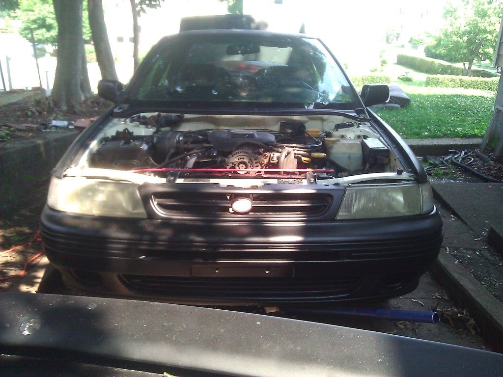

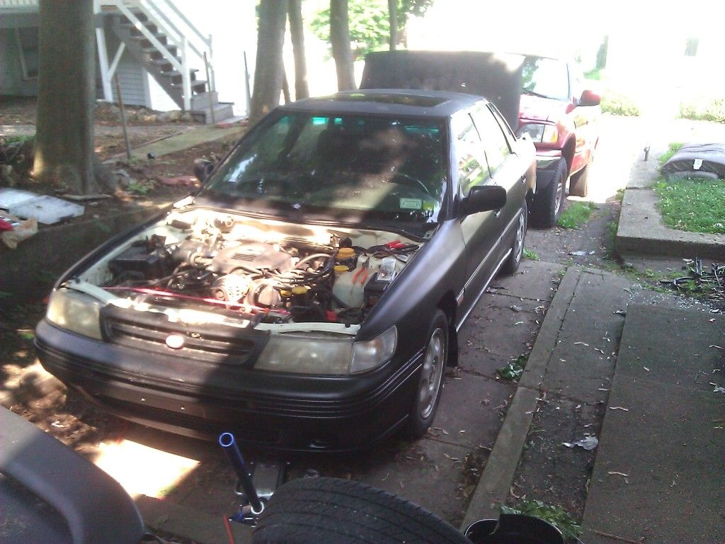

front end is all back together, still need to finish the hood and roof, I was too busy today, but I borrowed an angle grinder so I can get that worked out tomorrow.
now I just need a battery lol

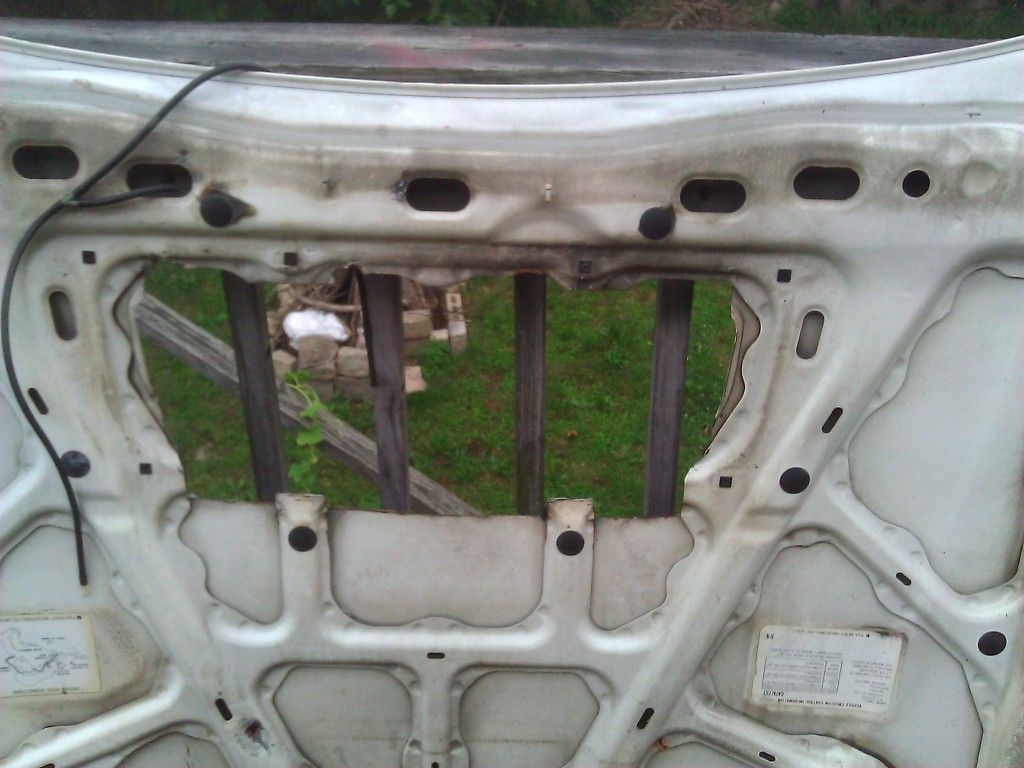

managed to get a tiny bit done before I got rained on so no painting today....

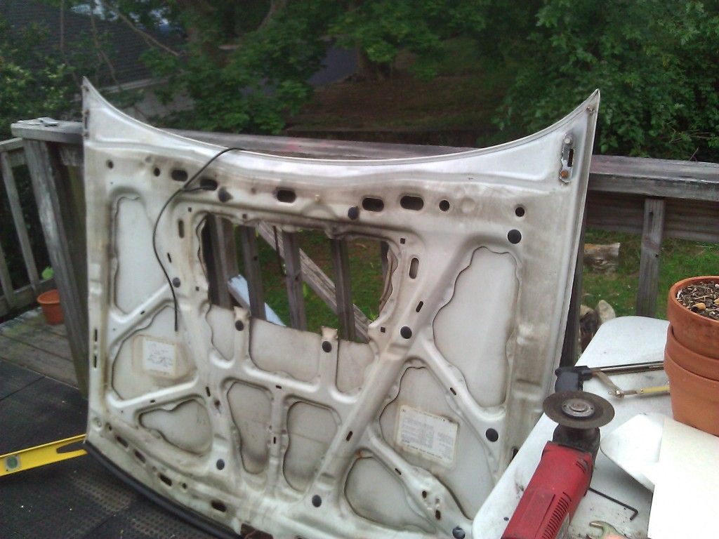

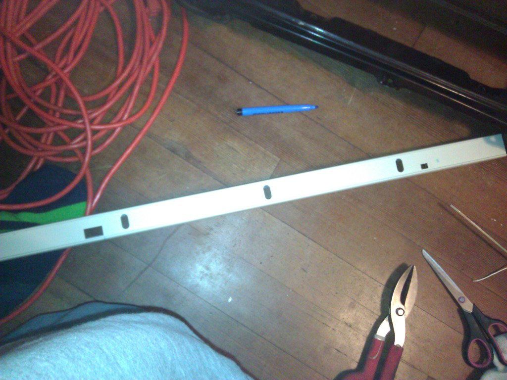

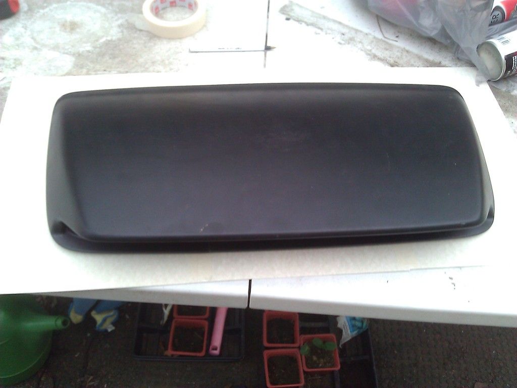

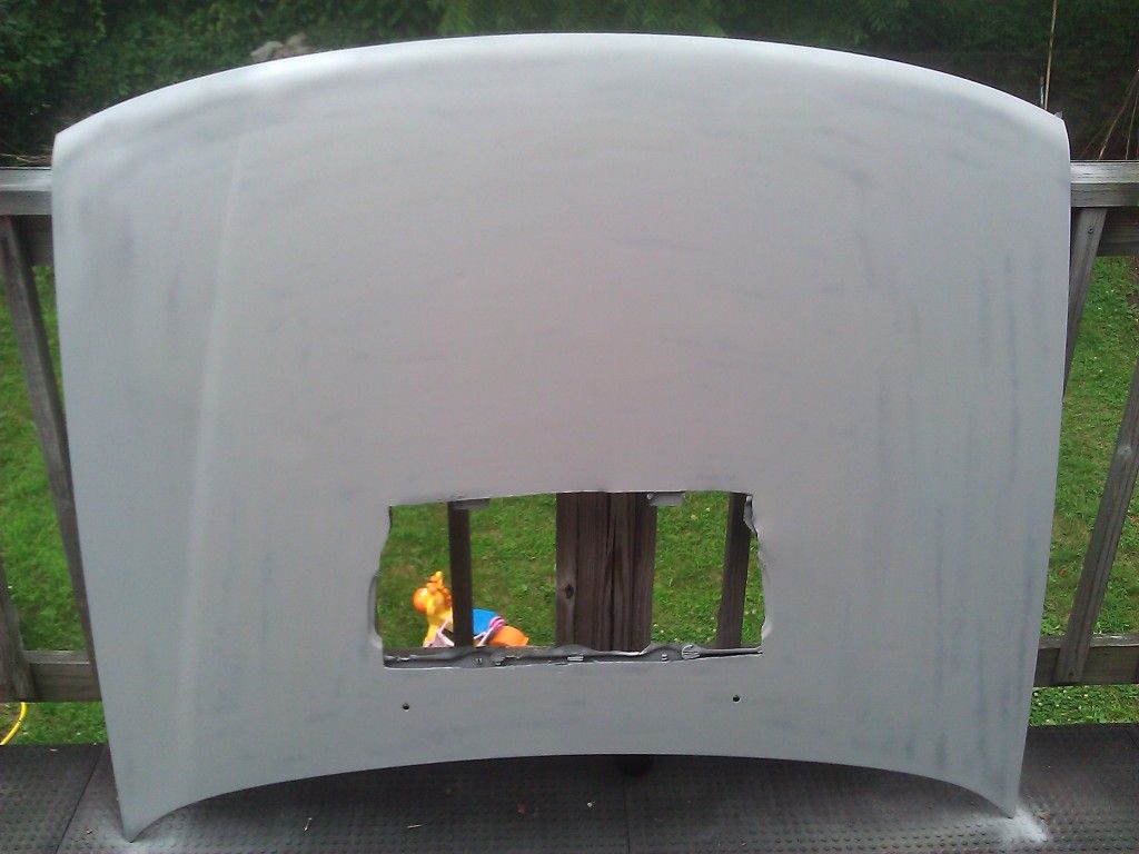

cut out the hole in the hood and filed the edges down

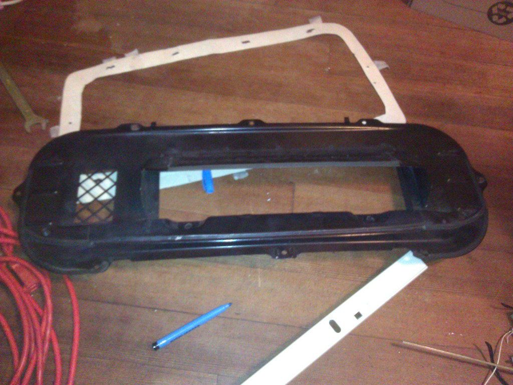

not sure how well you can see it but I am tracing out a stencil to make my sandwich plate/shroud for the scoop. this is probably going to be a pain but what hasn't been on this thing so far.

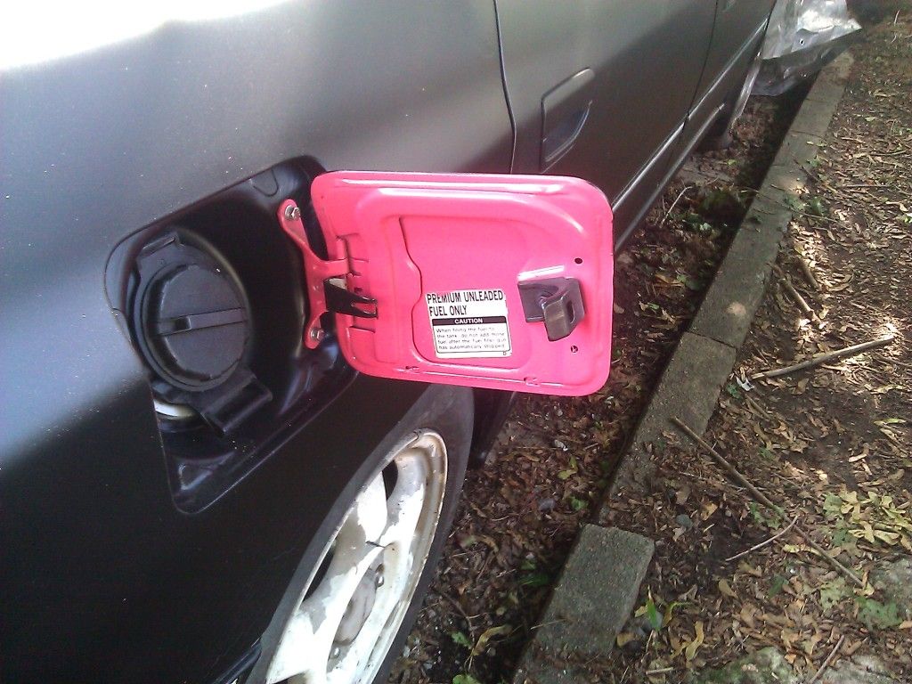

Still need to paint the gas door the hood and the rood. I might also repaint the scoop as birds shitting all over it while the paint was dry fucked it all up...I fucking have a whole new hatred for all that is avian.

thats whats awesome about flat black. sand it, repaint... good as new.
and ur last sentence had me laughing.

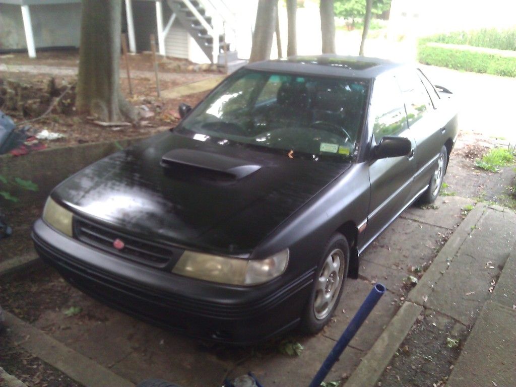

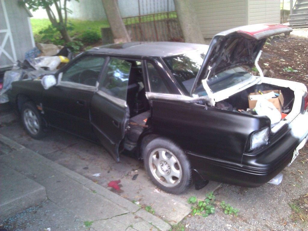

I was so close to finishing today...then I ran out of paint
well I did get somethnig done today
the hood is primed and ready
added a few accent's, there are some more just not pictured yet
all in all very close here, I am probably going to need some new tires as these ones are currently dry rotted and the front passenger' tire has a slow leak. Probably going to clean the rims up and hit em with some duplicolor gold

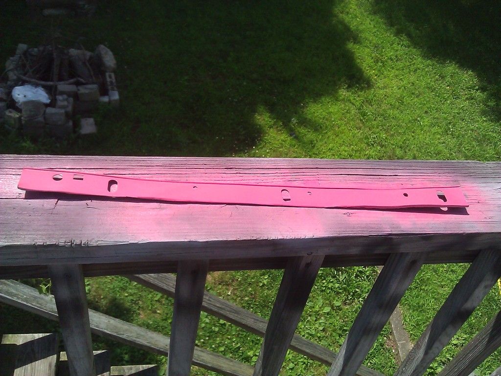

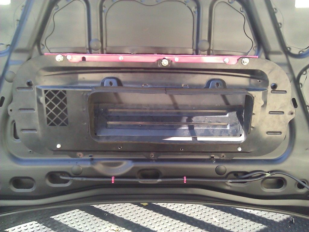

Ok so I needed to make a bracket or something to attach the hood scoop to the hood as all I have right now is a gaping hole in the hood.
So I have this hood shroud from an 02 WRX that I am going to use but I still need to make an adapter plate to make it fit right.
so I find an old mounting post for a set of window blinds and decide that will do
I cut it down drilled a few holes in and VIOLA done, a little paint and it is lookin rather shnazzy
FINALLY got it attached and lined up....let me tell you it was a humongous PITA but it is done and the end product looks pretty sweet

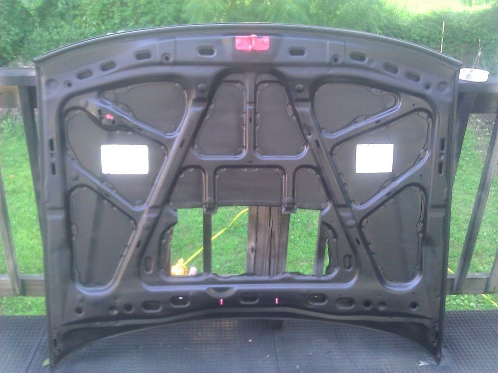

Got the hood on, and just like I thought even though I used the same paint and put the same amount of coats on because I did the hood in the blaring sun and the rest of the car was in the shade...it looks waaaaay too glossy for Satin Black...I didn't even realize you could make it that shinny with this black....looks out of place, but whatever I can always sand it down and repaint it again.
Also got the trunk on and switched lock cylinders over. Still need to paint the roof and redo the hood, but functionality is there now and once I get a battery it will be driveable!! w00t
the hood is really pissing me off though, I must say.
