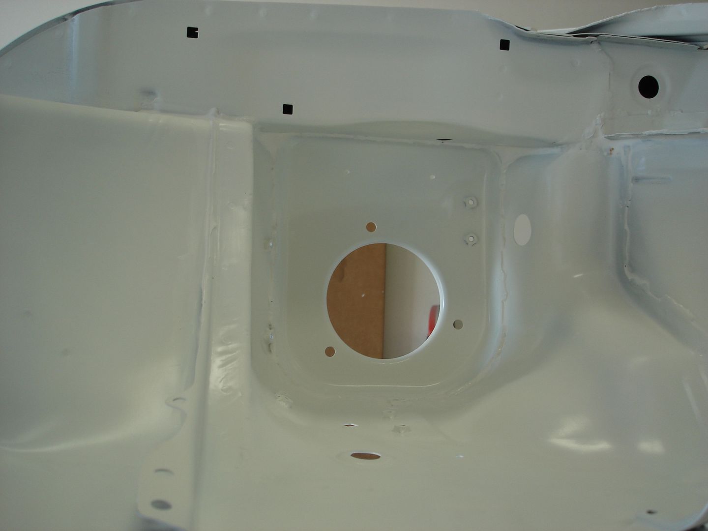

Is that a non-turbo shell? I thought that all the Japanese built cars (all turbos AFAIK) had the firewall pre-punched for the clutch master cylinder. Maybe it is and I can't see it through the shine?
This shell is a original 91 Legacy sport USDM market Turbo car with the 2.2 SOHC engine.

Yeah, it's a turbo shell, and the hole is pre-punched. It's just hard to see due to the paint.

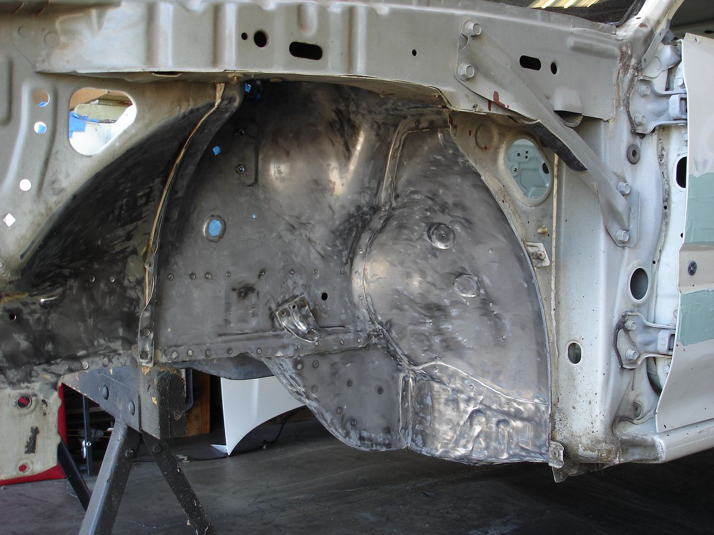

Project update......
One part of the project with this Legacy has been to rebuild all the parts that will not be going back on the car and sell them, It has added a significant amount of work to the project, however I hope that it will keep one or more Legacys out there running.

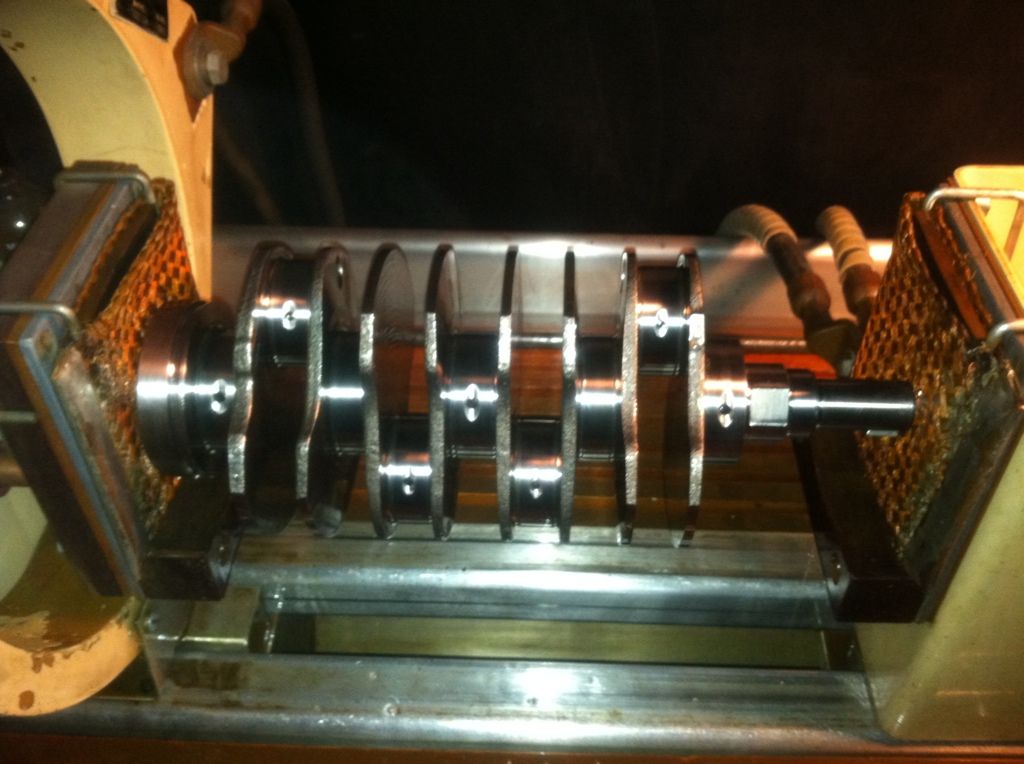

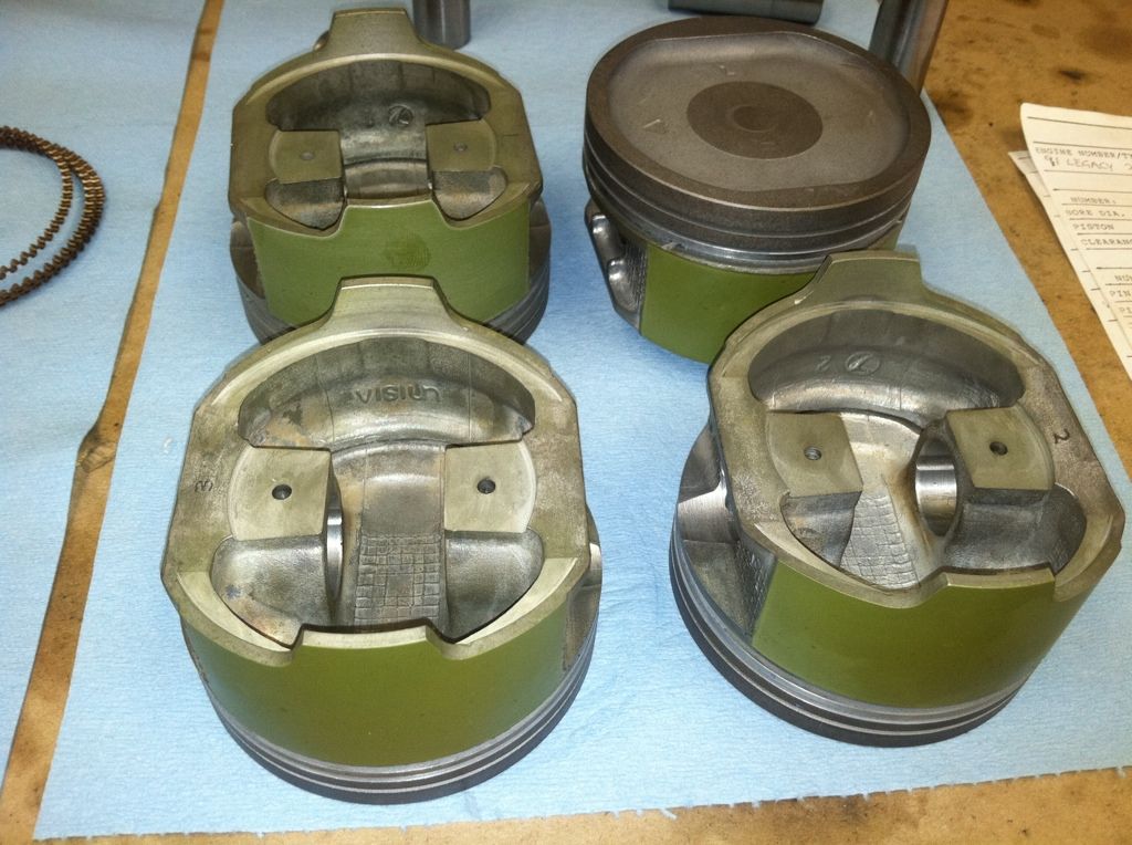

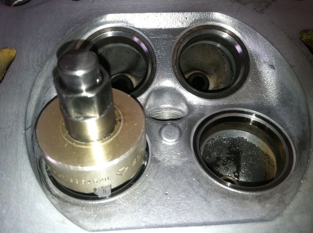

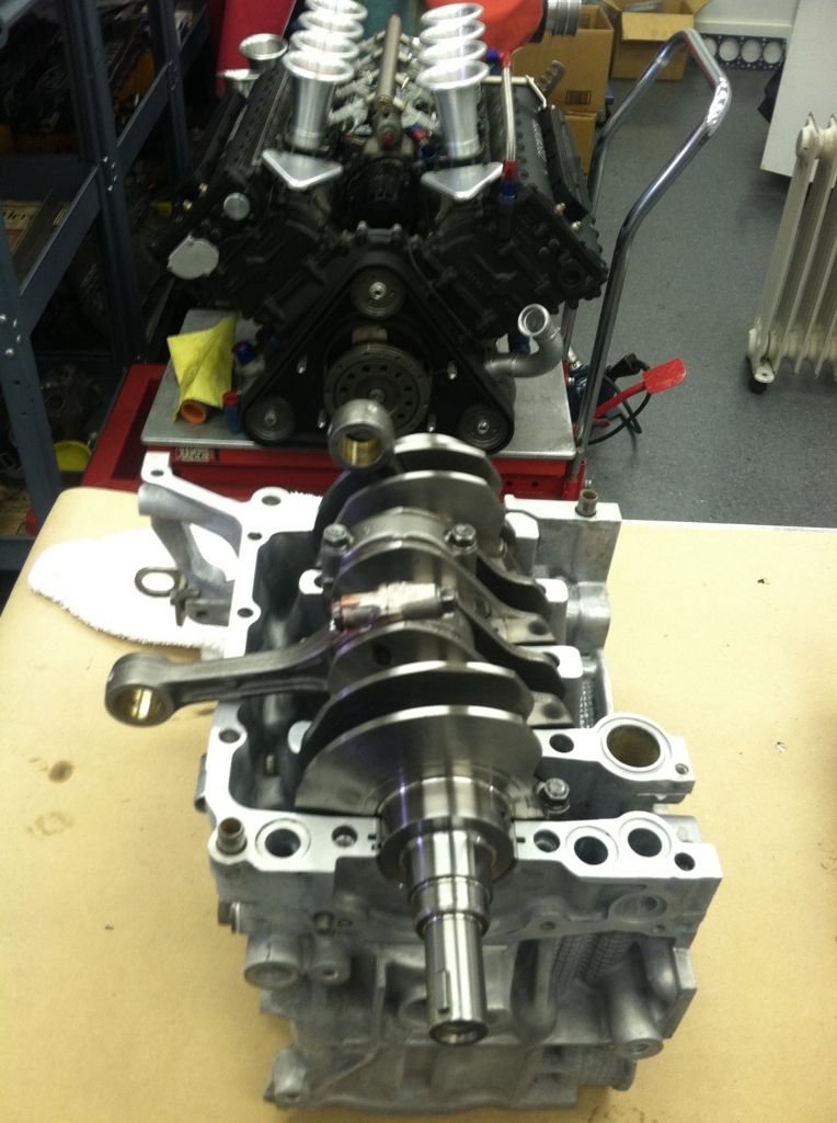

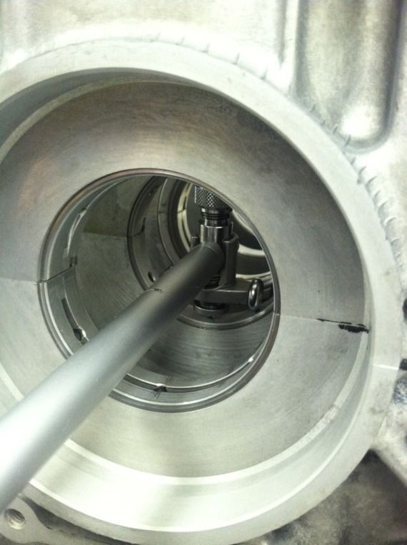

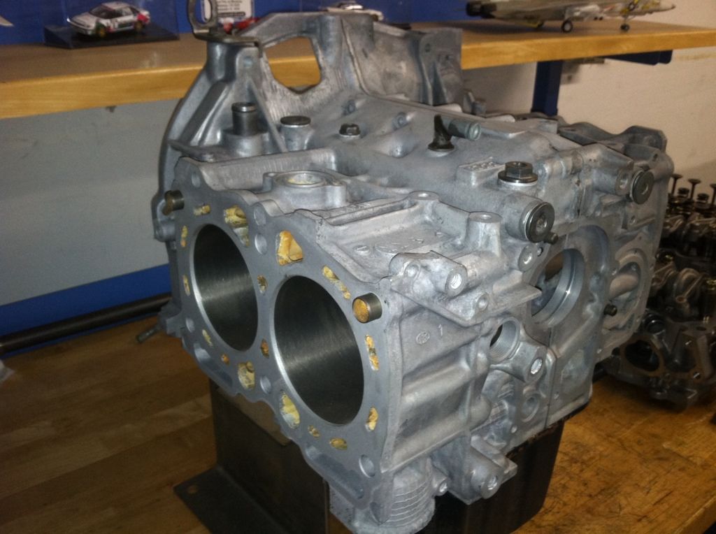

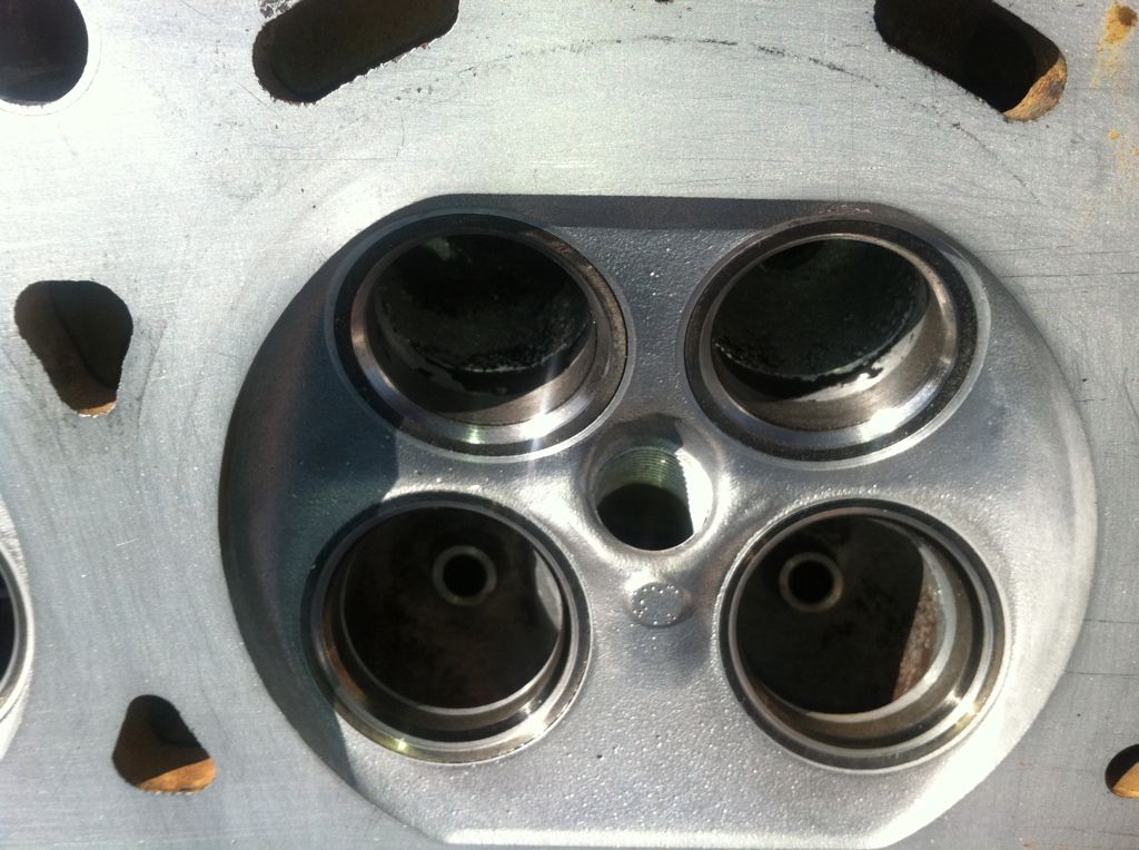

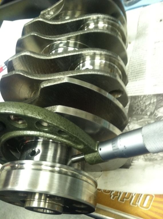

I am currently rebuilding the original 2.2 SOHC engine, last weekend I crack checked the crank, Cams, rods , pistons and pins and assembled block and measured bearing clearences

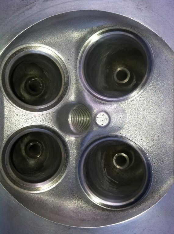

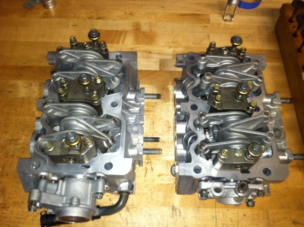

I also stripped and cleaned the heads and faced the valves and cut the seats, I think I will do a little clean up inlet and exhaust port work as the casting are very rough!

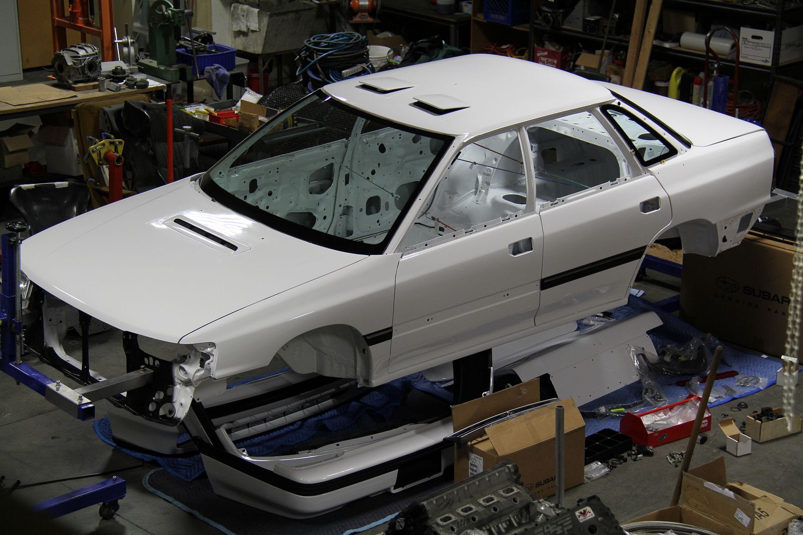

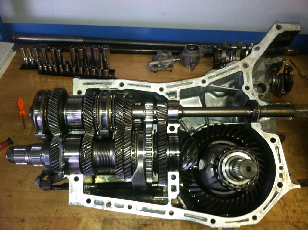

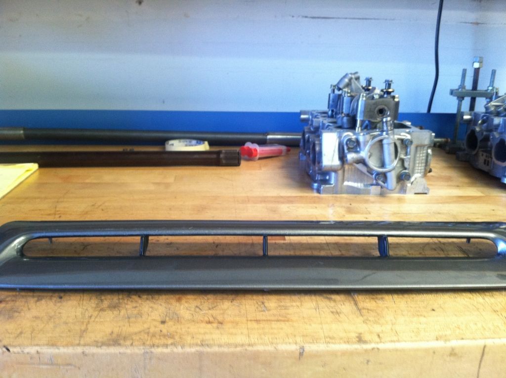

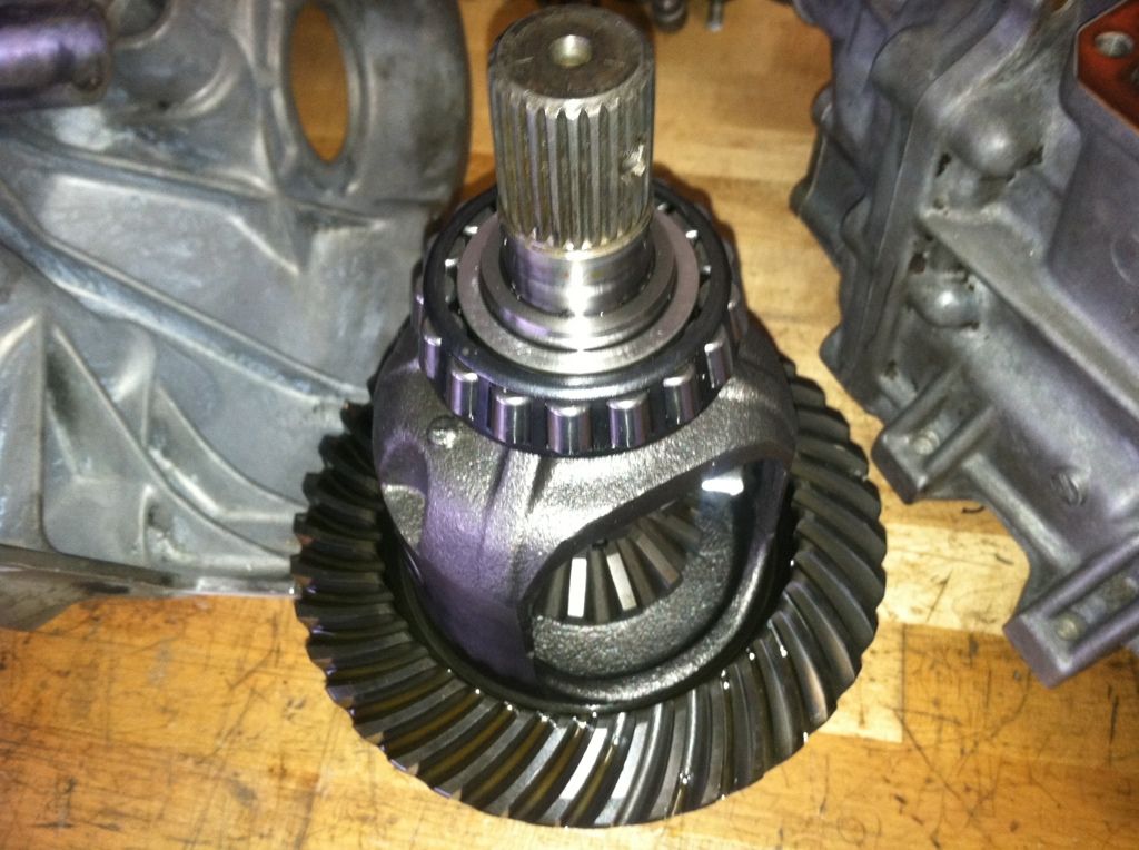

Today was a busy day, I modified a hood scoop to let more air into the engine bay and I plan on cutting luveurs into the panel on the inside of the hood to help lower temp of engine bay/intercooler. I also spent some time blending the ports on the original 2.2 cyl heads, they are very rough castings. Finally I stripped and inspected my original transmission, It looks in great shape so I will replace the seals and put it back together
I plan on doing more work in the area of reducing ambient temps in Eng bay.

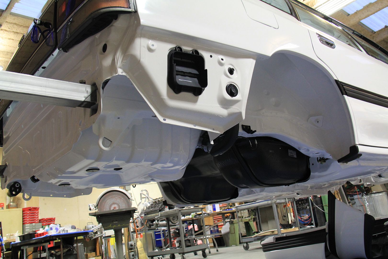

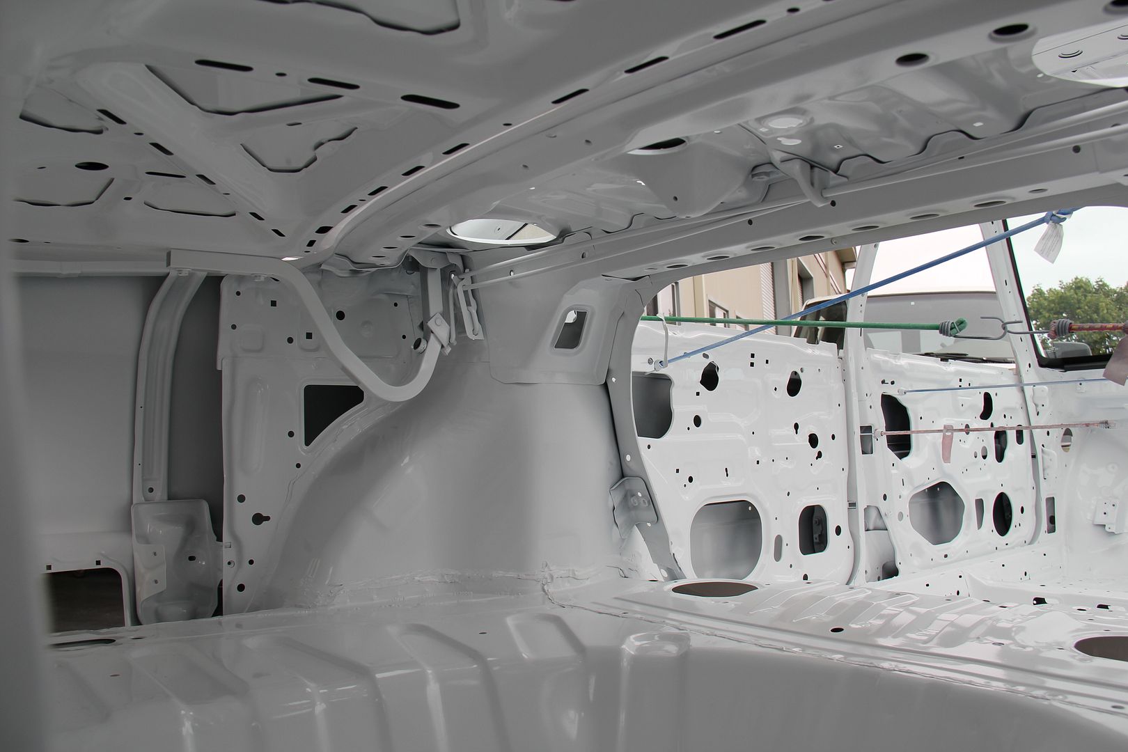

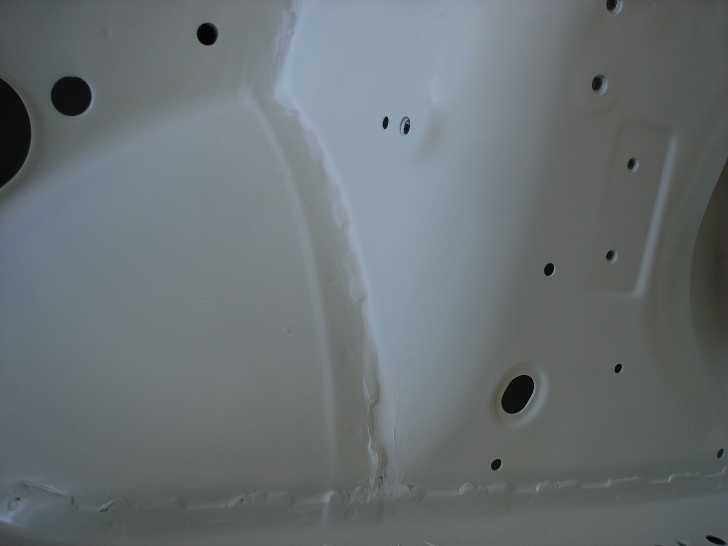

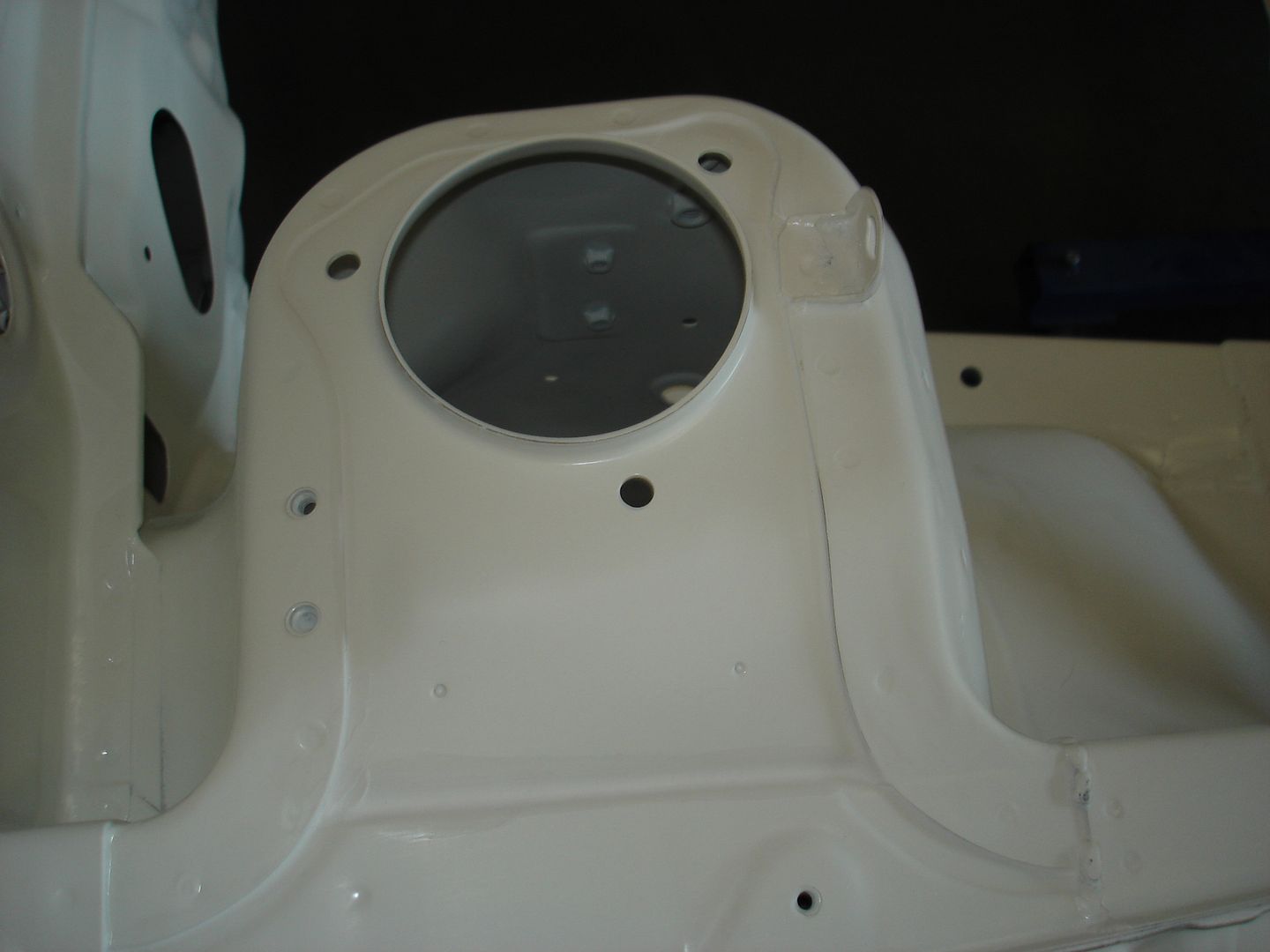

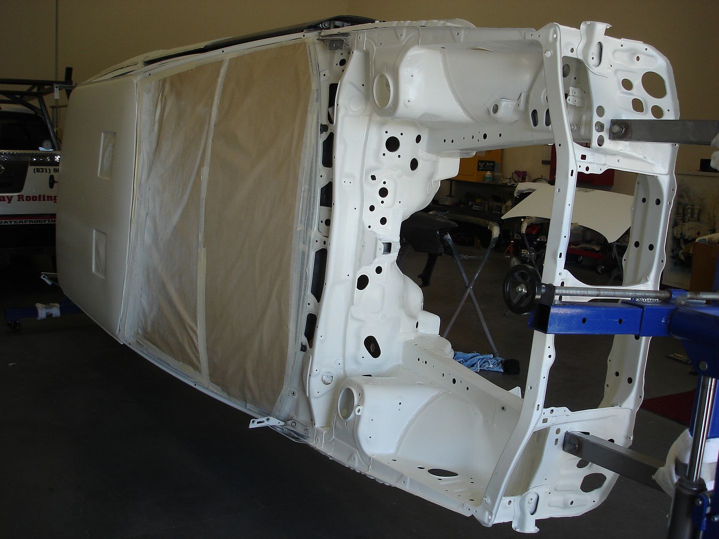

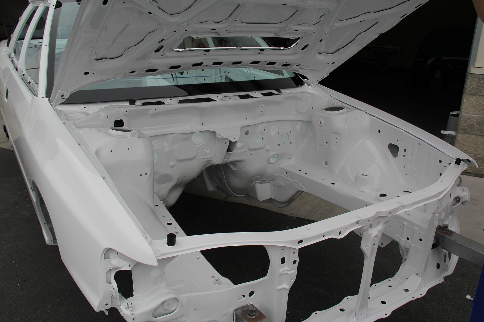

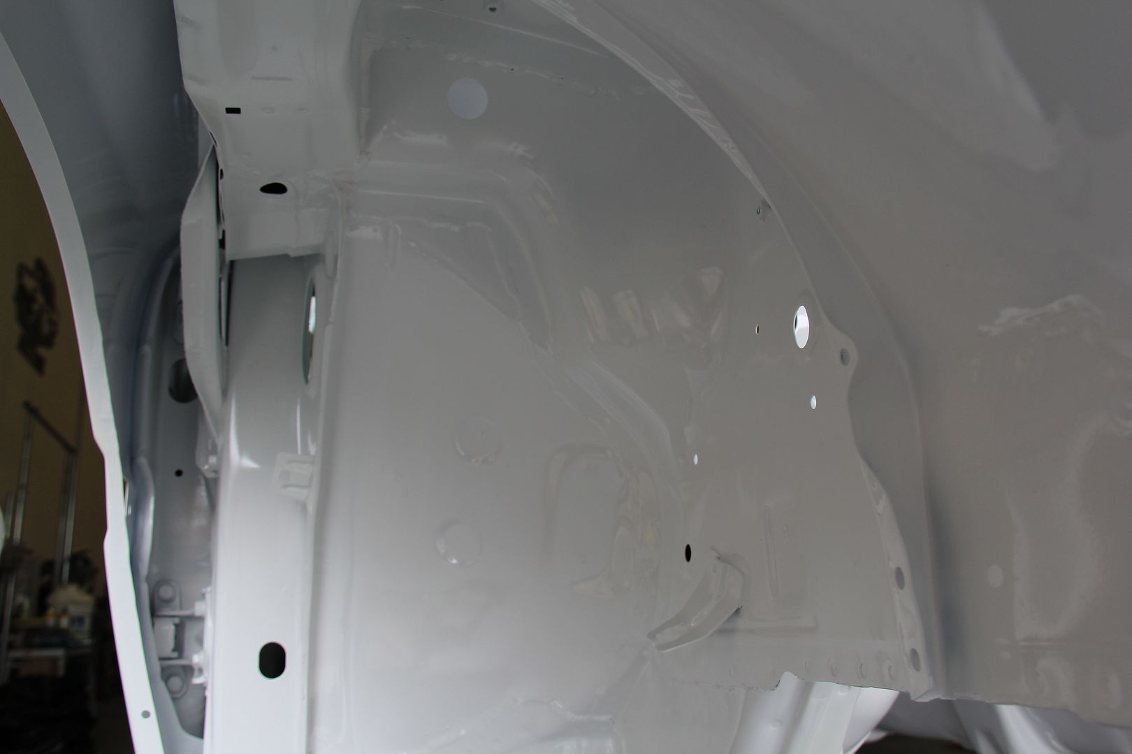

Today I caulked all the seams on the Legacy, it will be painted soon.

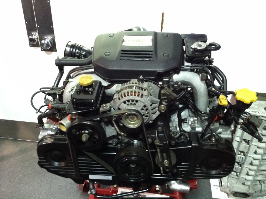

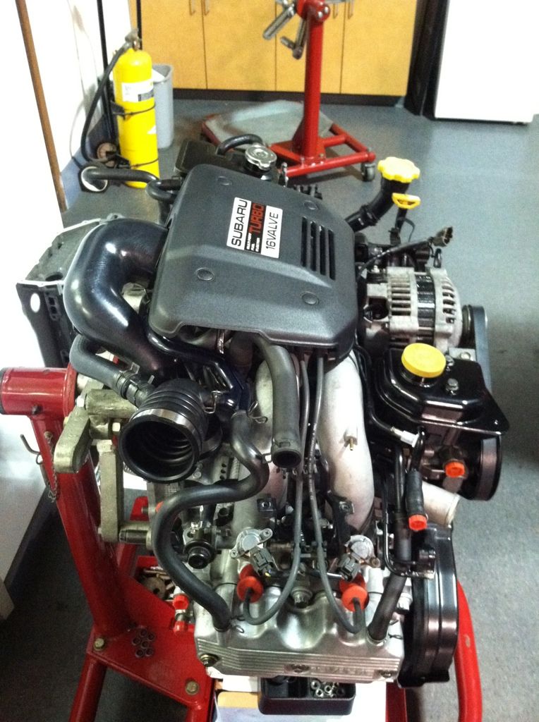

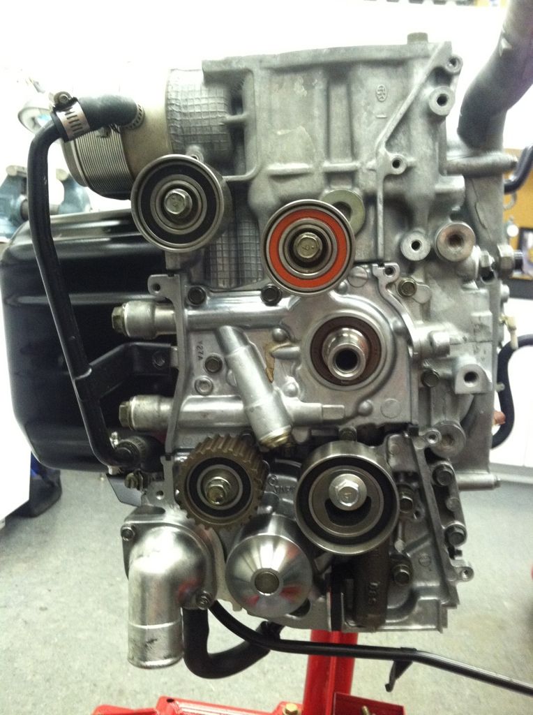

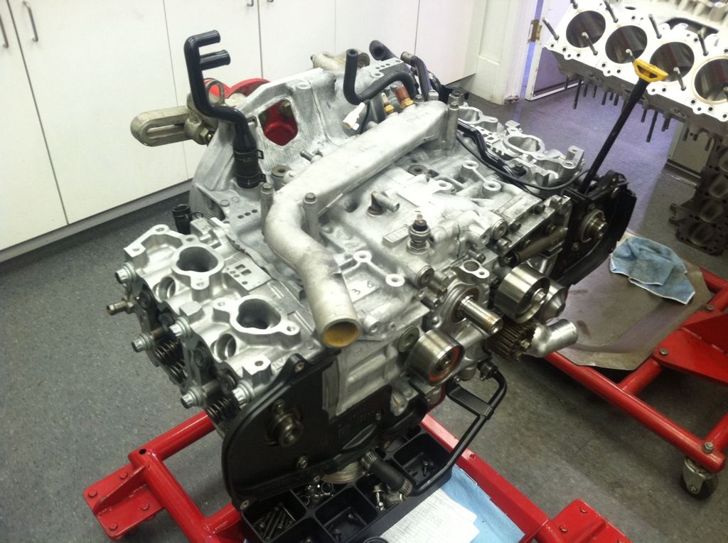

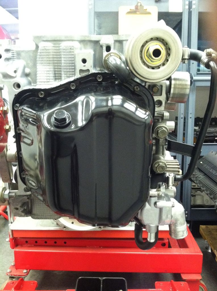

This is the original 2.2 now all rebuilt and ready to sell!

Nice, a rock solid factory rebuilt motor!

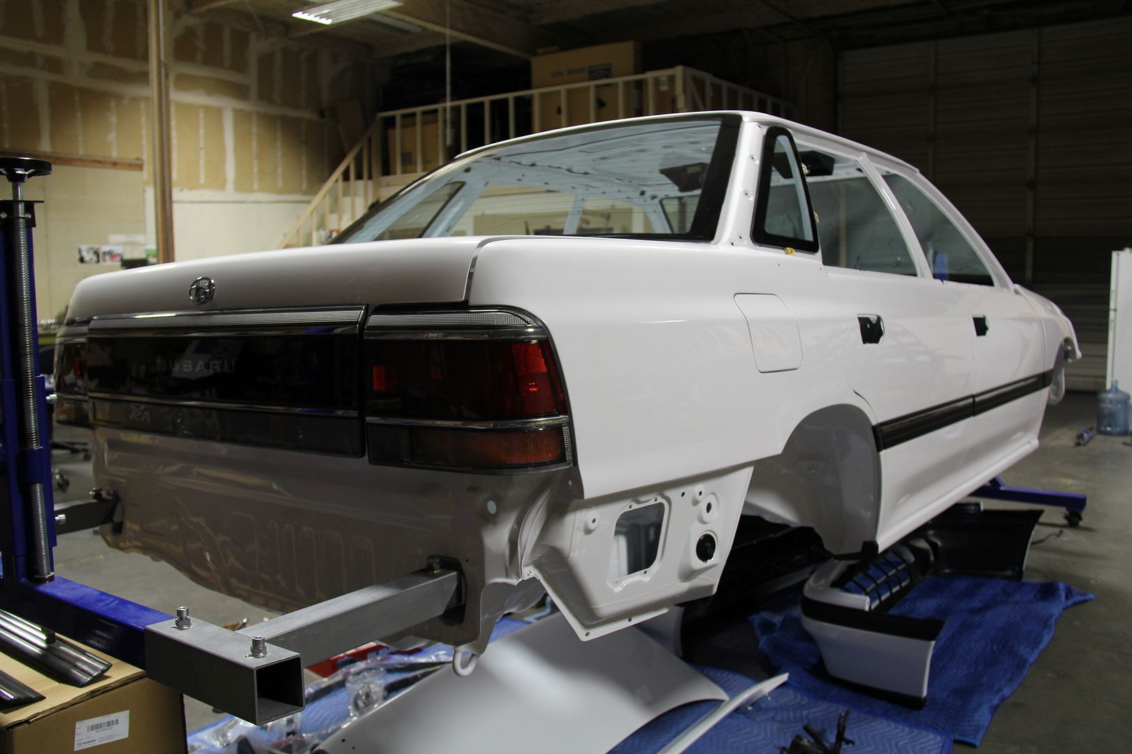

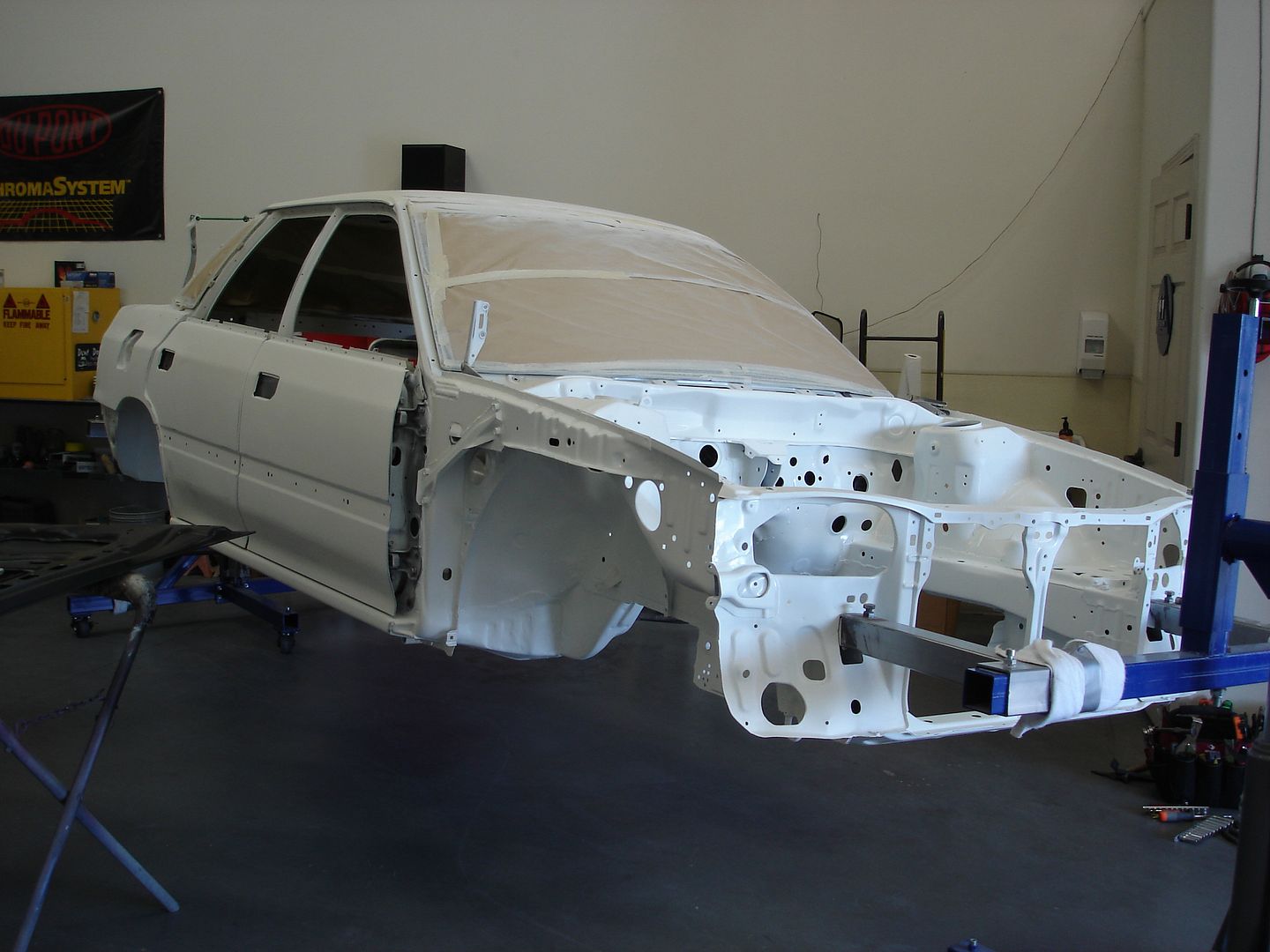

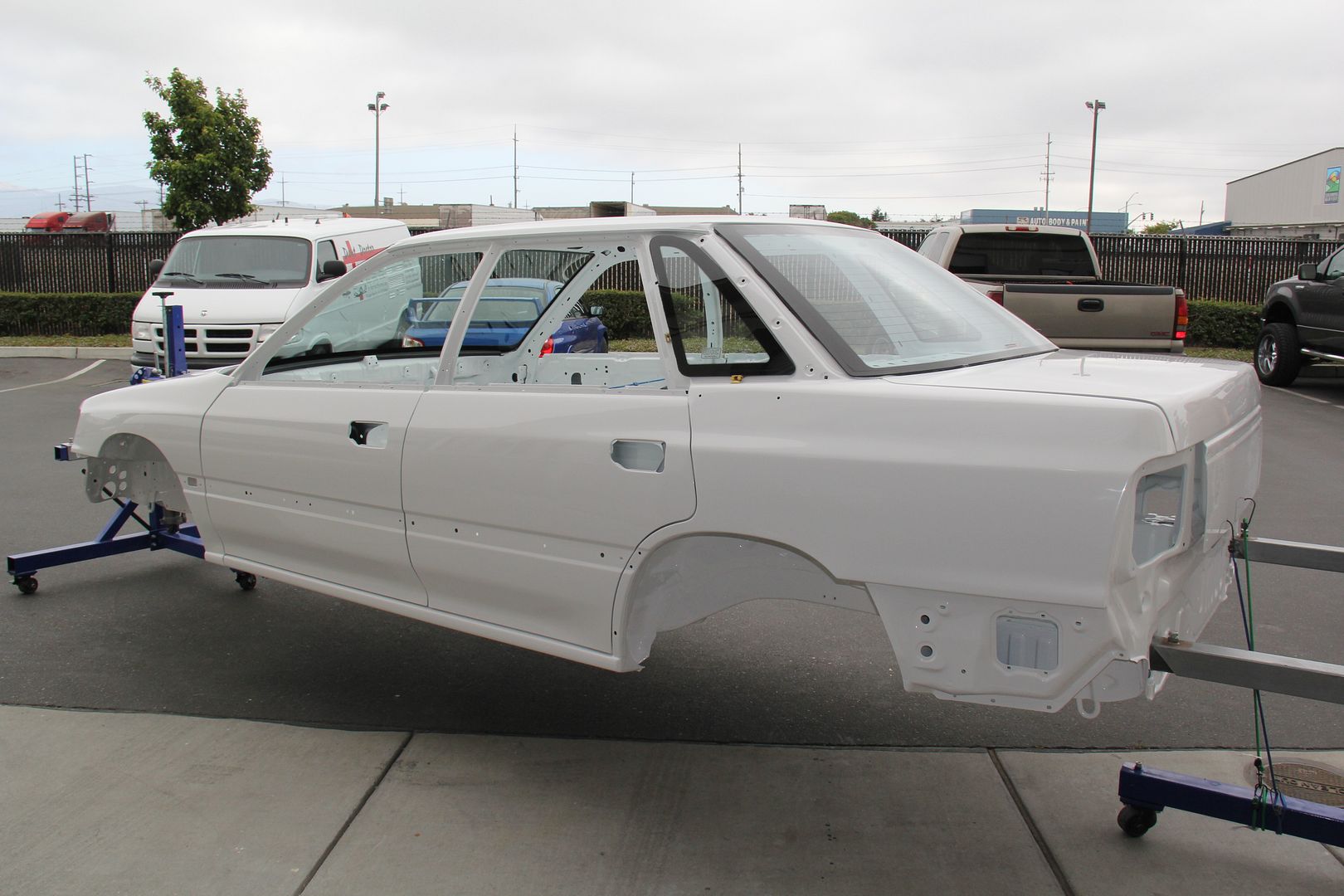

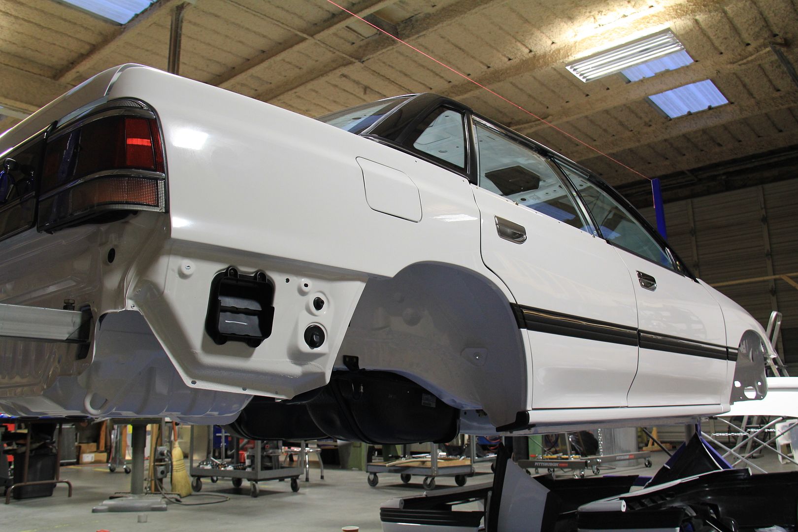

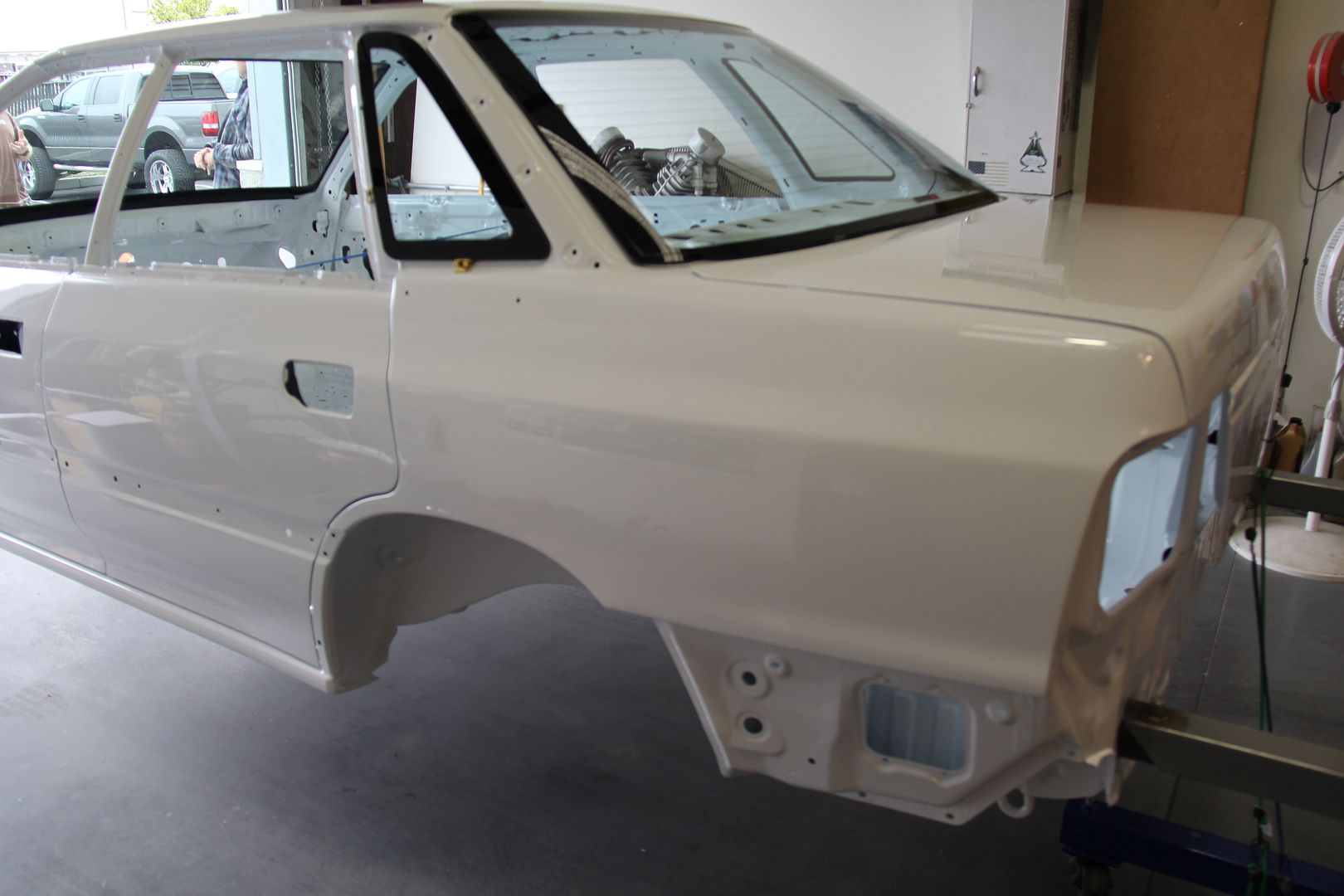

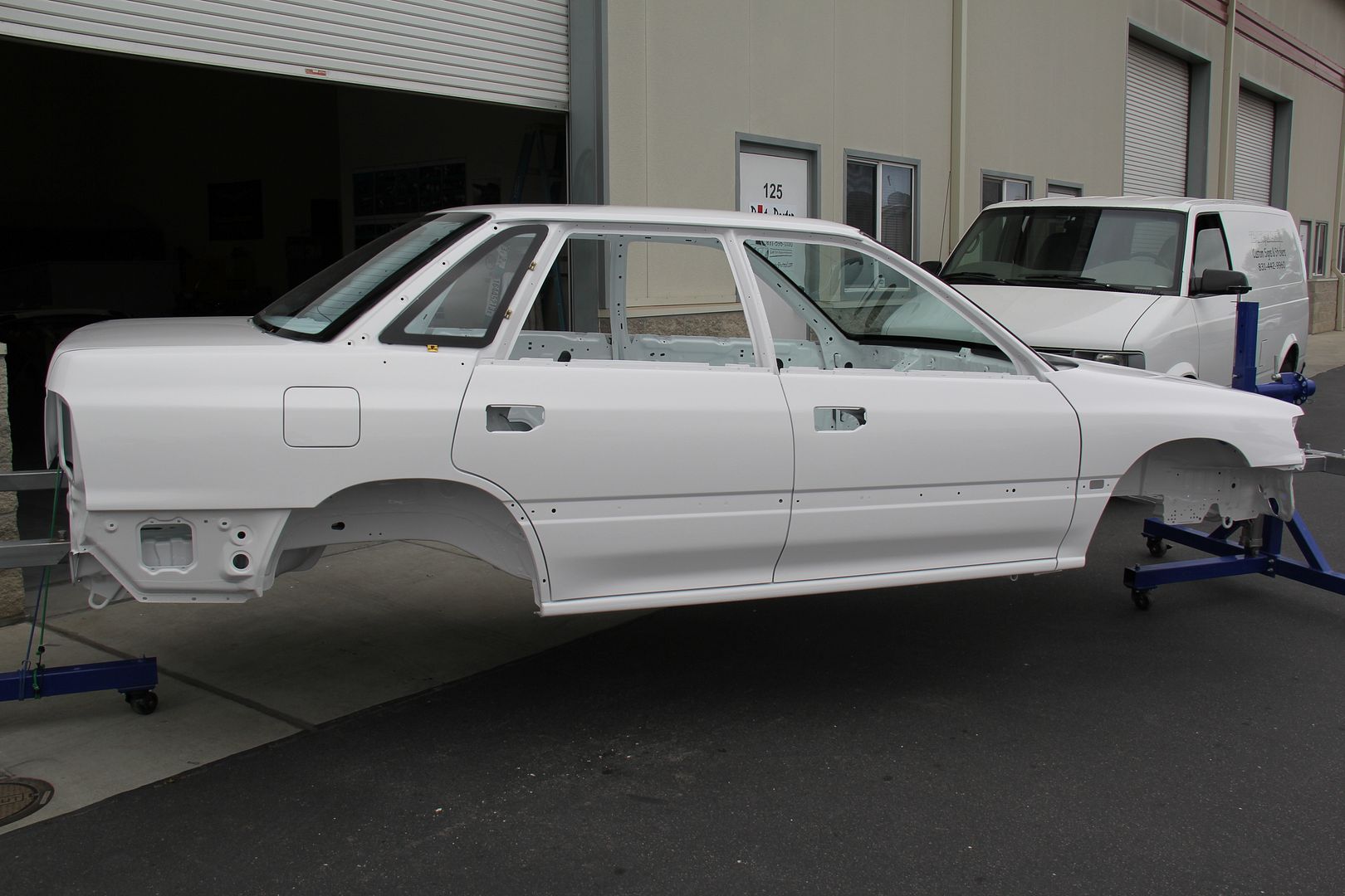

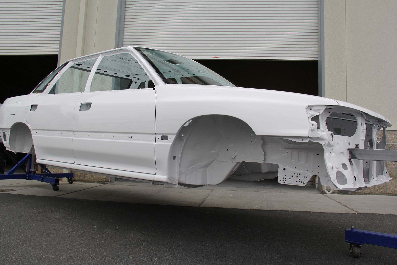

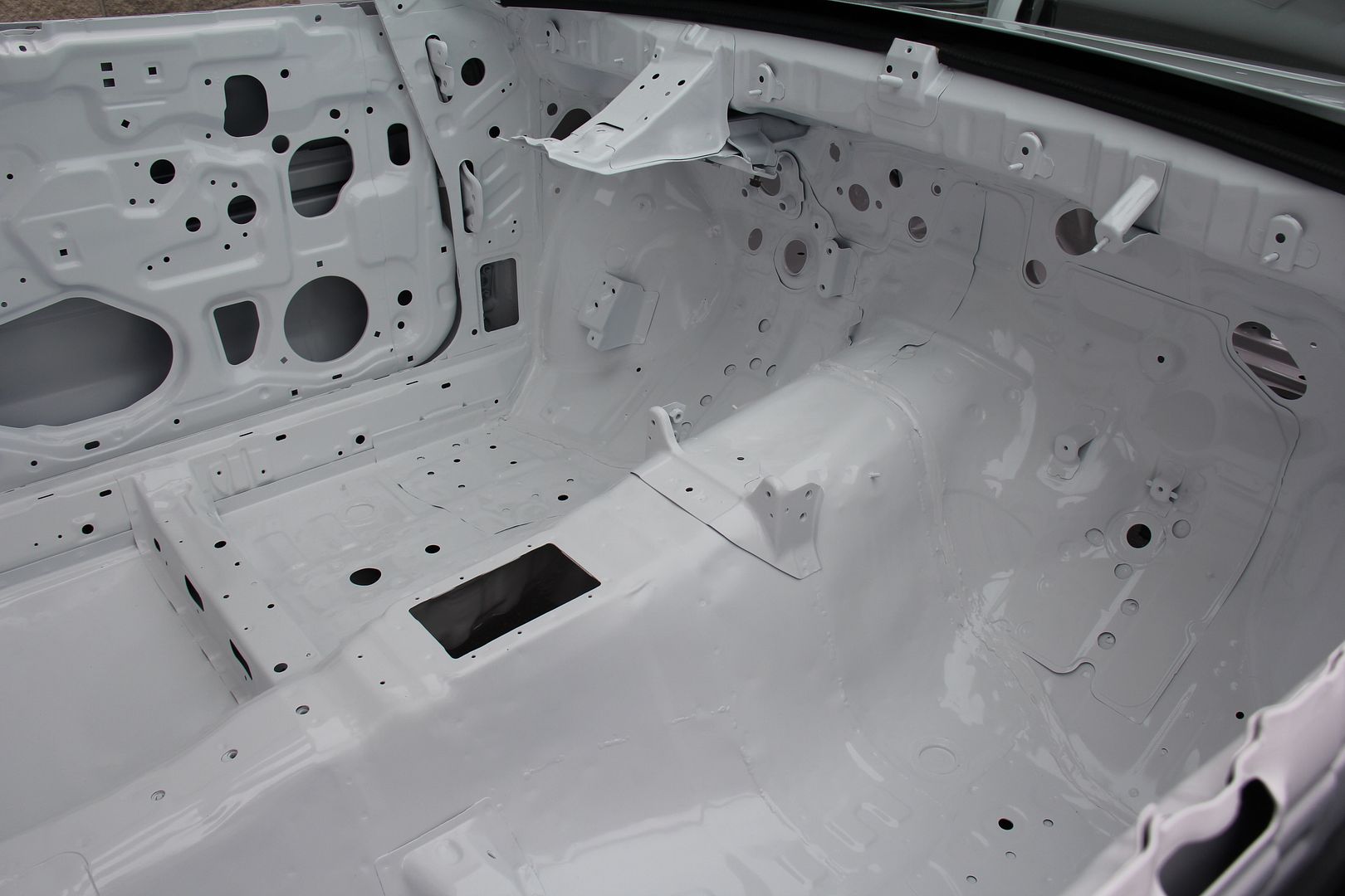

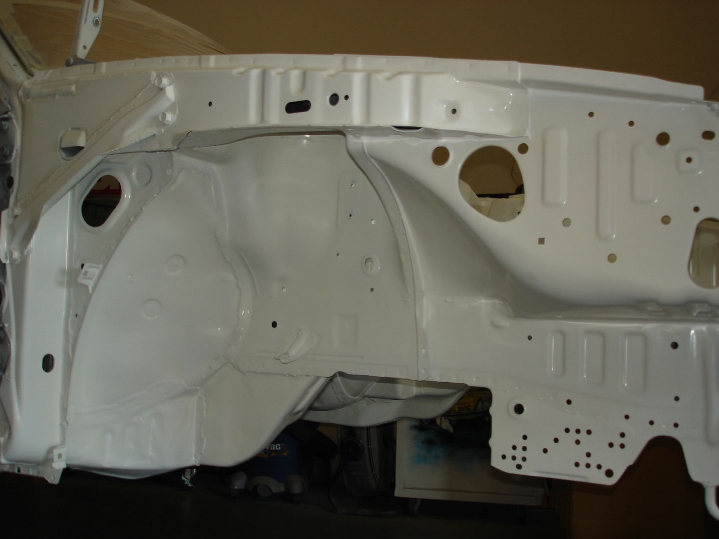

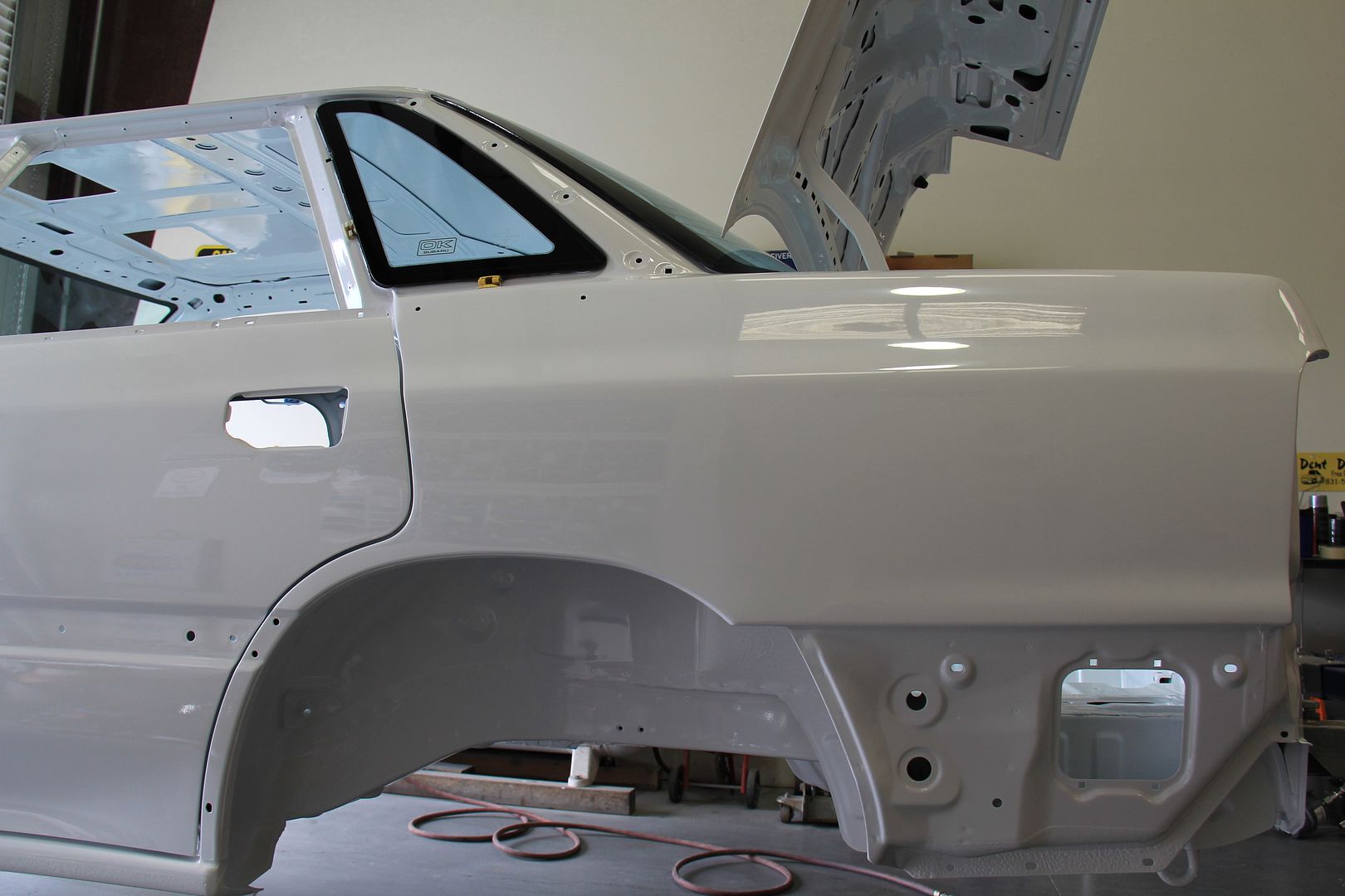

The legacy is now painted, it is awesome to see it now
Posts: 2763
Re: 91 SS to RSRA Spec bare shell complete restoration/build
Post by SILINC3R »
Wow, looks beautiful. So is there a Pearl in the paint or just white. And man I wish I could buy that motor from you!

The paint has no pearl in it, this is the same paint code as found on many of the Legacys, It is the color that the genuine RA was painted

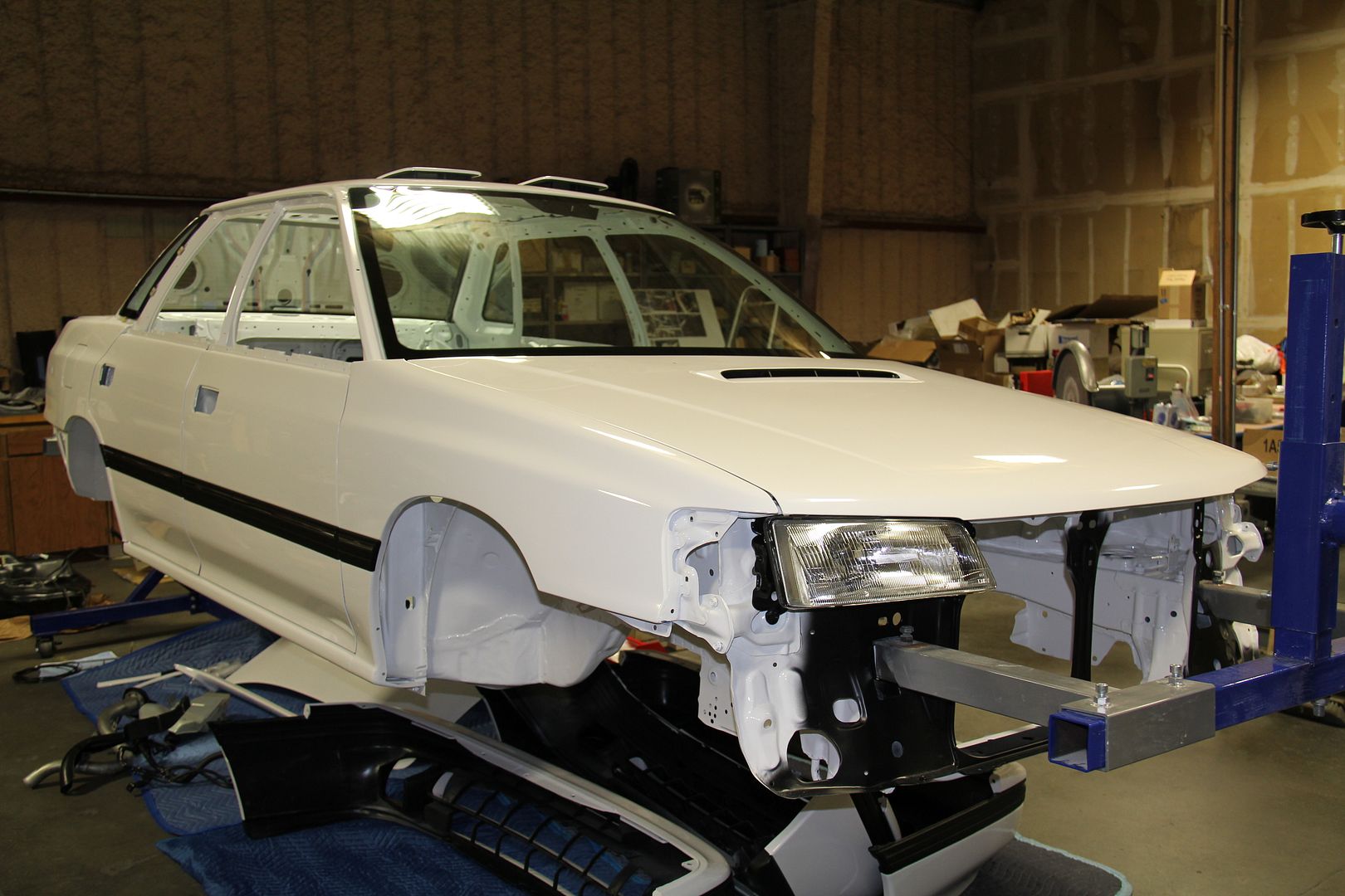

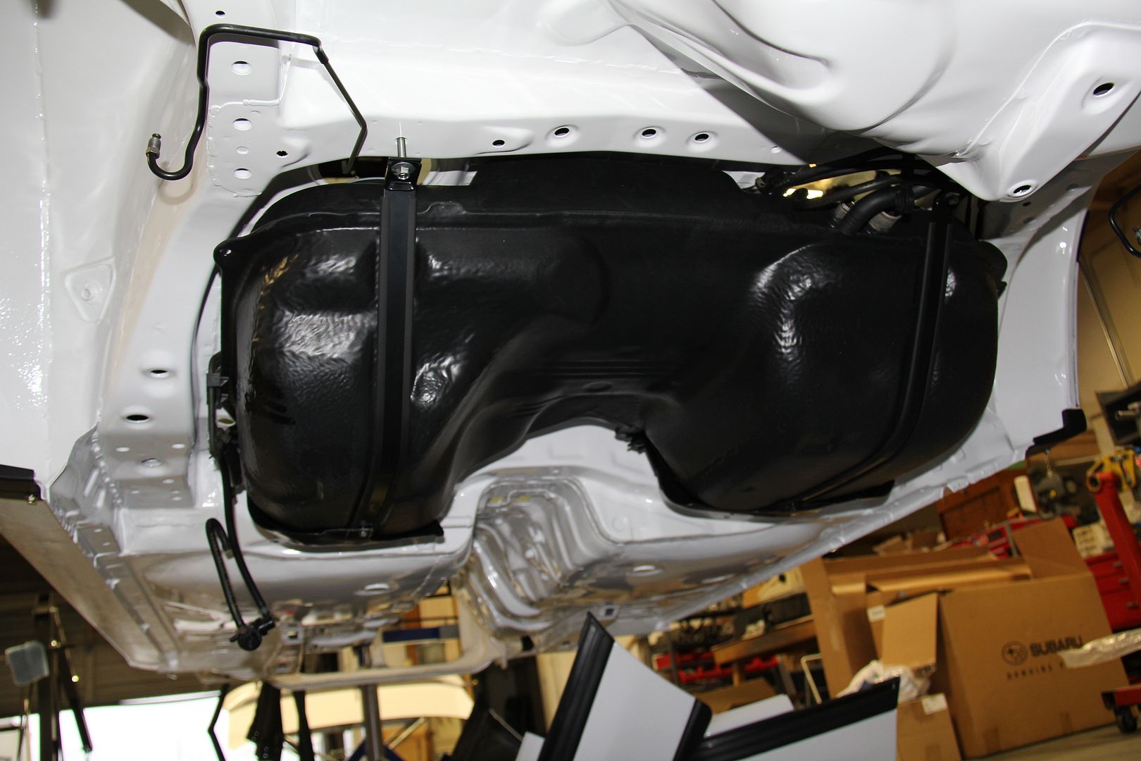

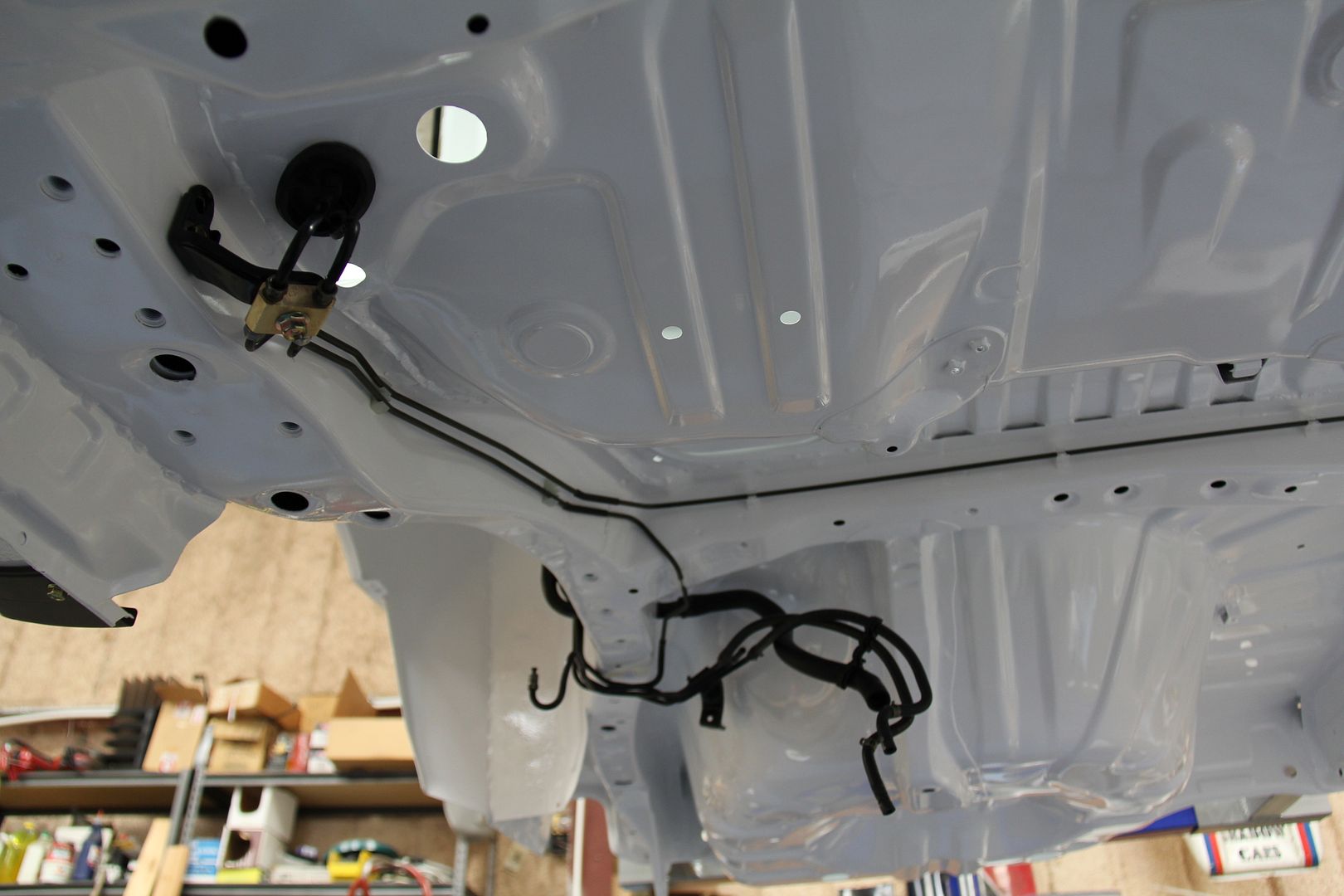

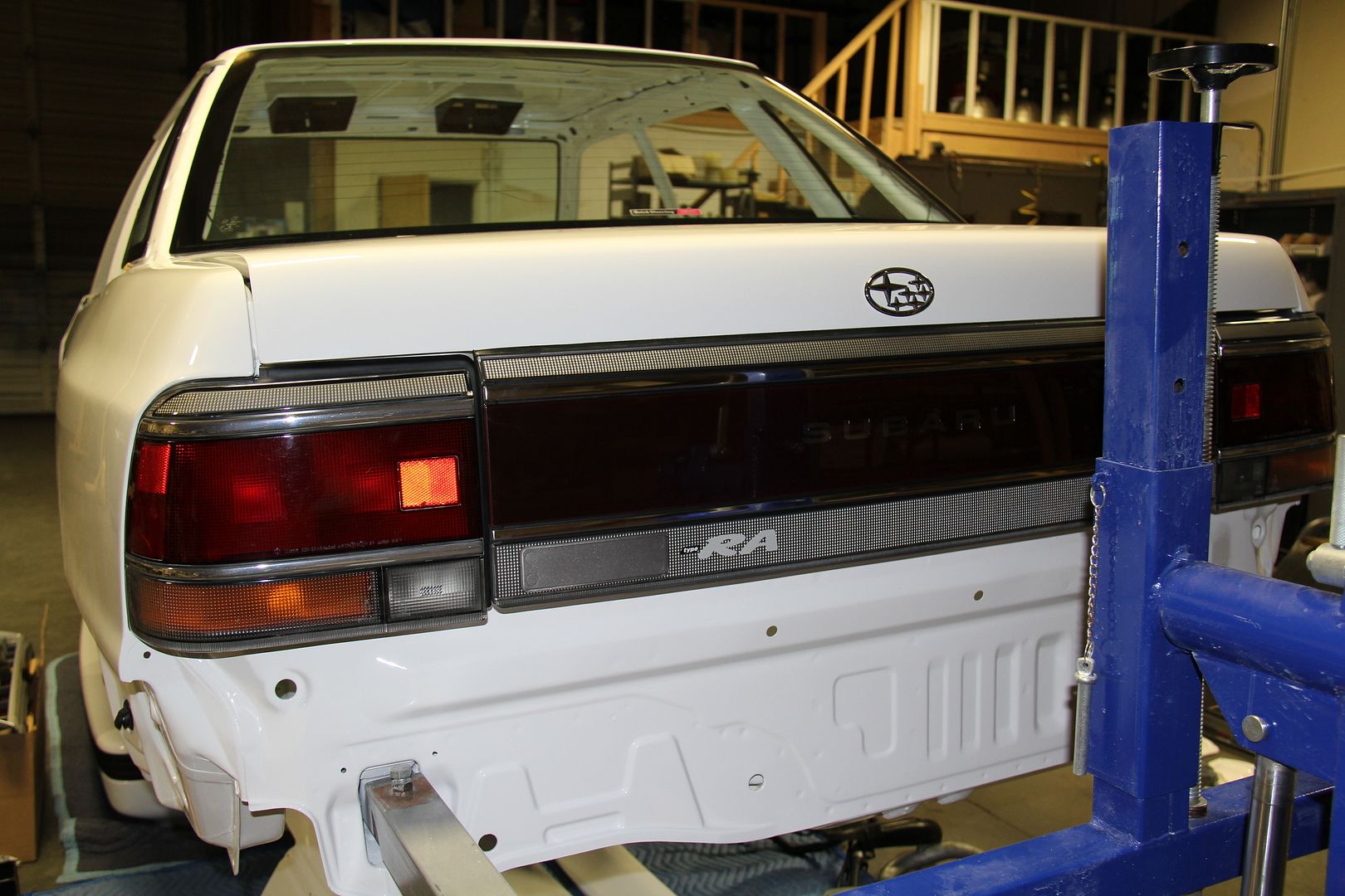

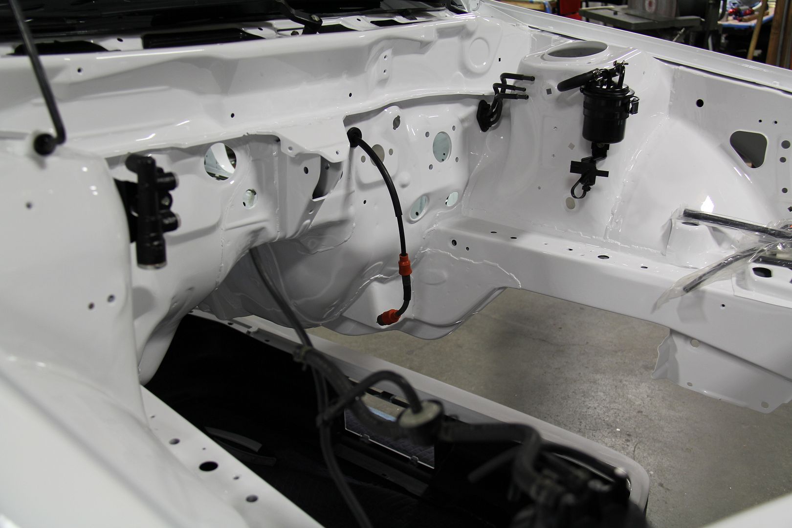

I am already well underway with the assembly of the trim and I have all the glass in the doors and manual window regulators in and the trunk assembled, I have the brake lines and fuel lines run through the car. I will post more pics soon, here's a few to give you all a glimps

You're going to have a brand spanking new Legacy :)

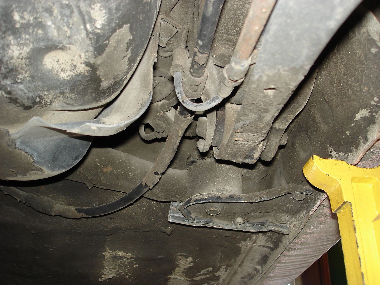

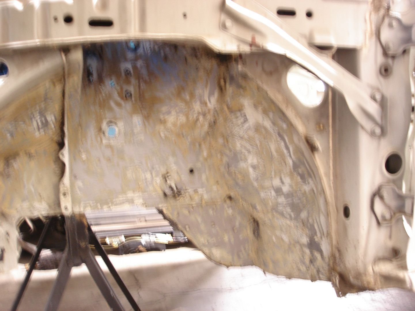

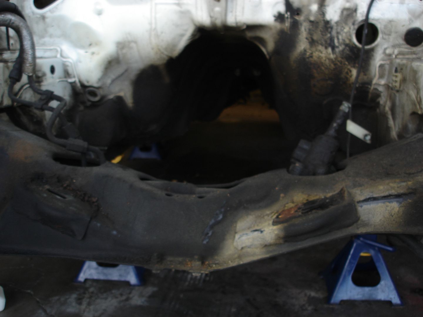

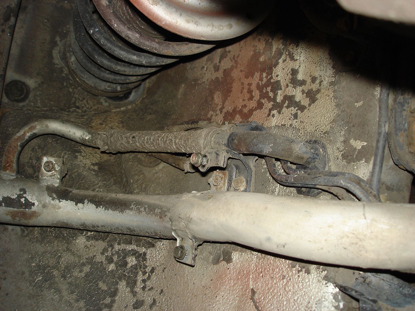

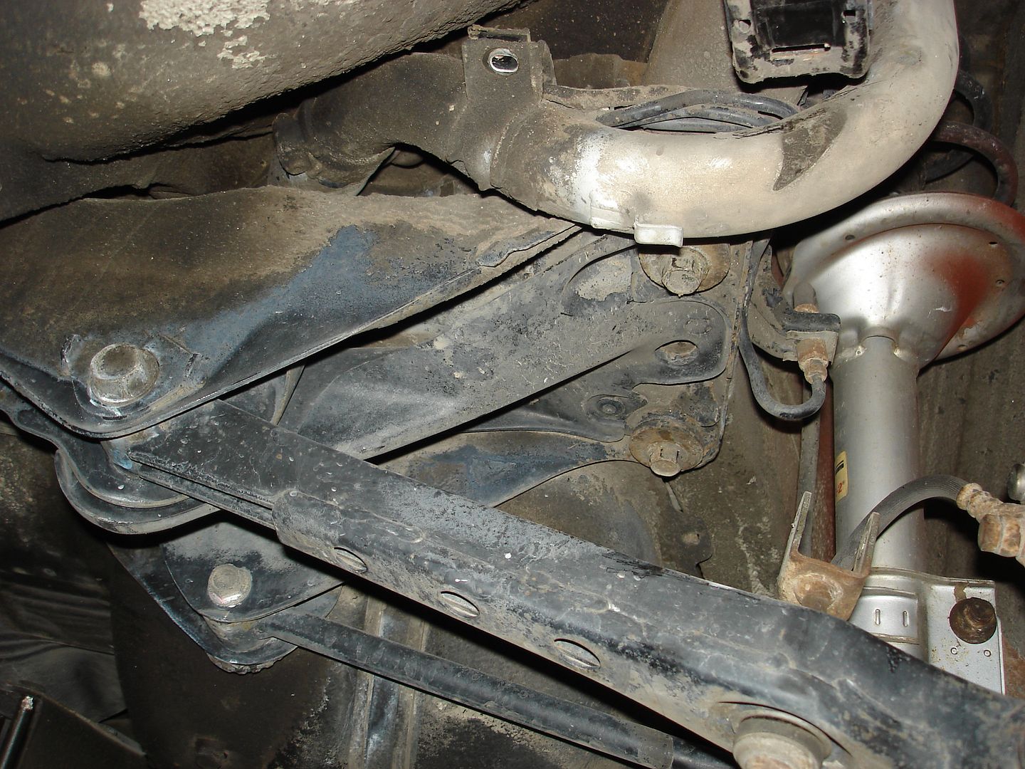

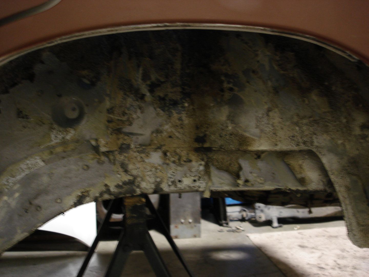

Here are a few pictures I have not posted, it shows just how bad the car was in a lot of areas, I did not actually want to post them because it looked so bad, however it shows what can be done with a massive effort and a huge amount of time :)

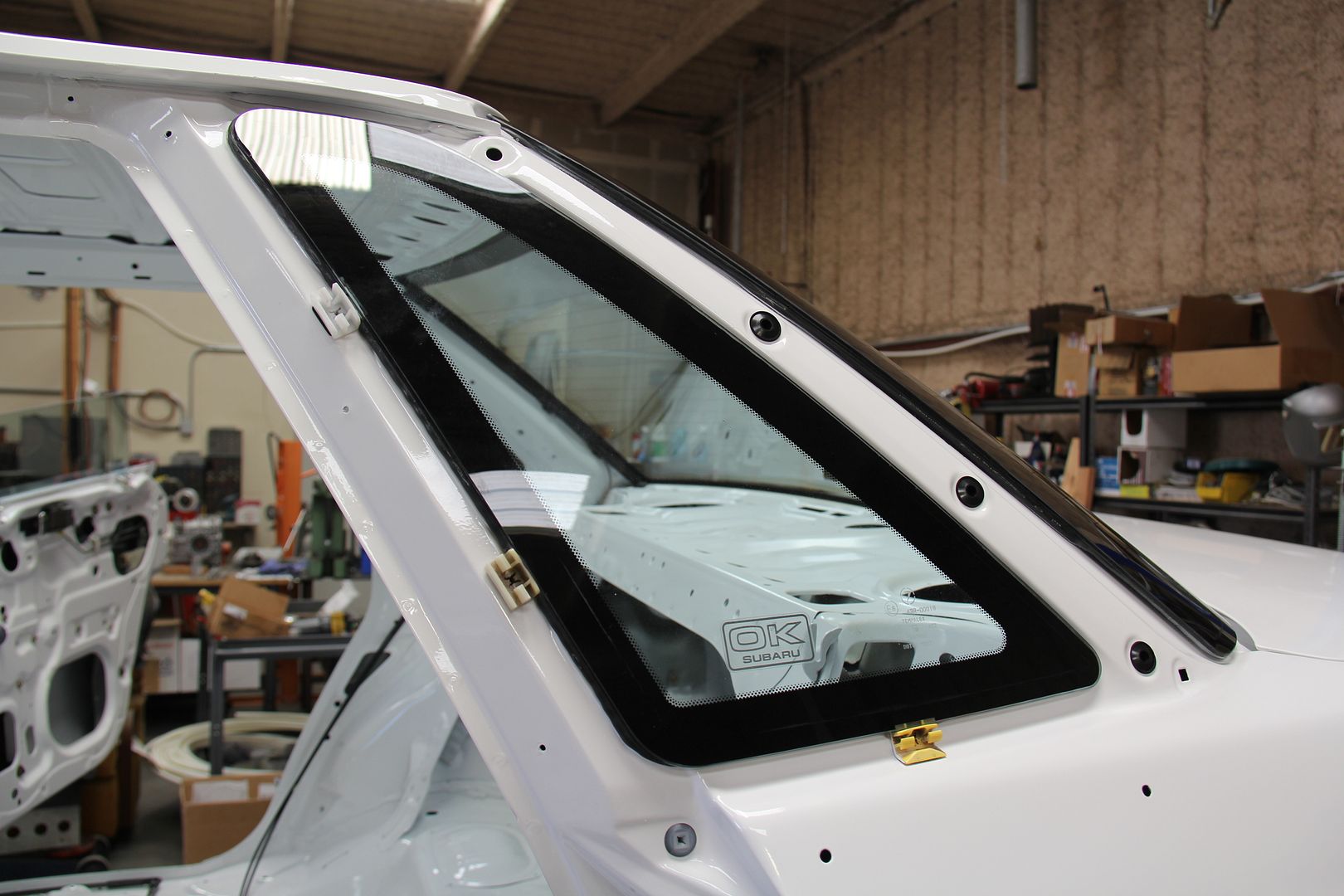

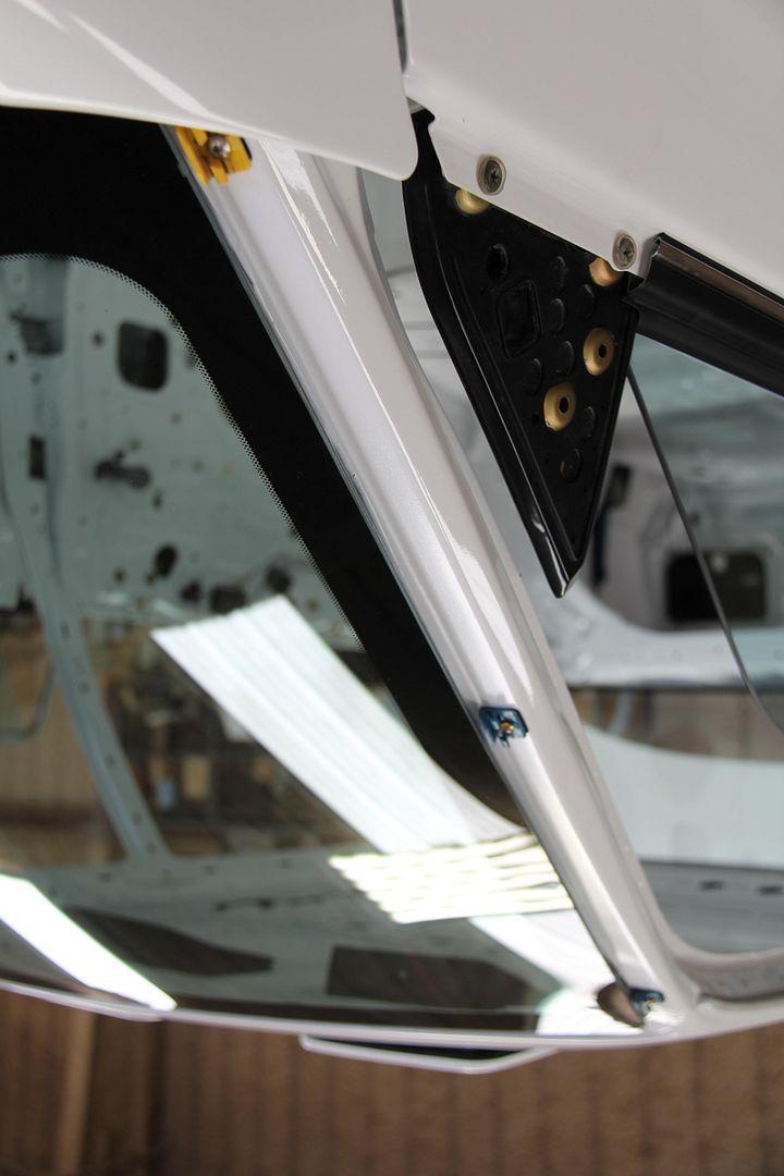

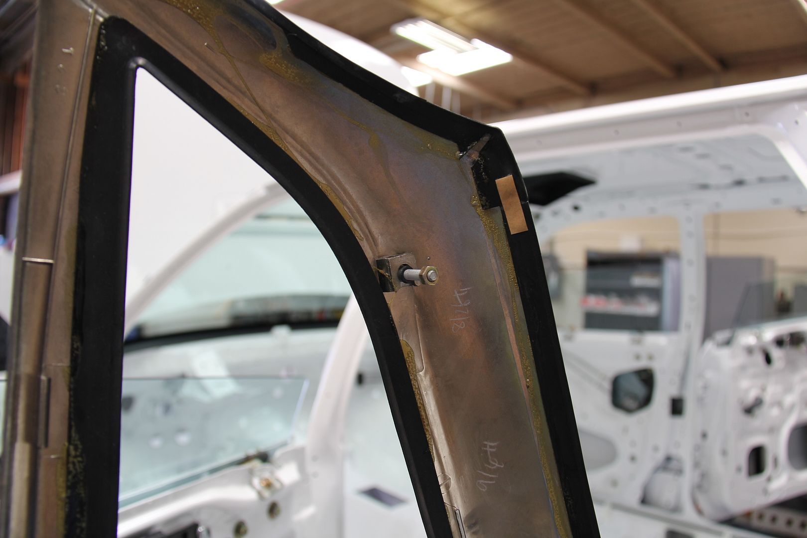

I have had a few people ask me about removing the trim so I will post a few photos that will show what holds the trim in place, once the rubber door seals are removed and the screws removed from the channel that retains the door seals, then the trim can be removed from the clips. There is a nut on the rear corner window trim that needs to be removed from the inside of the car, so the inside trim piece needs to be removed to get to it, I have taken a photo of that so it will make sence
The last photo shows the trim with the channel removed, you can see that the screws go through the trim !

I need a new right rear triangle trim piece because that triangle window was replaced and they broke the tabs and most likely the bolt.
Got any leads for a new or a used one in good shape?

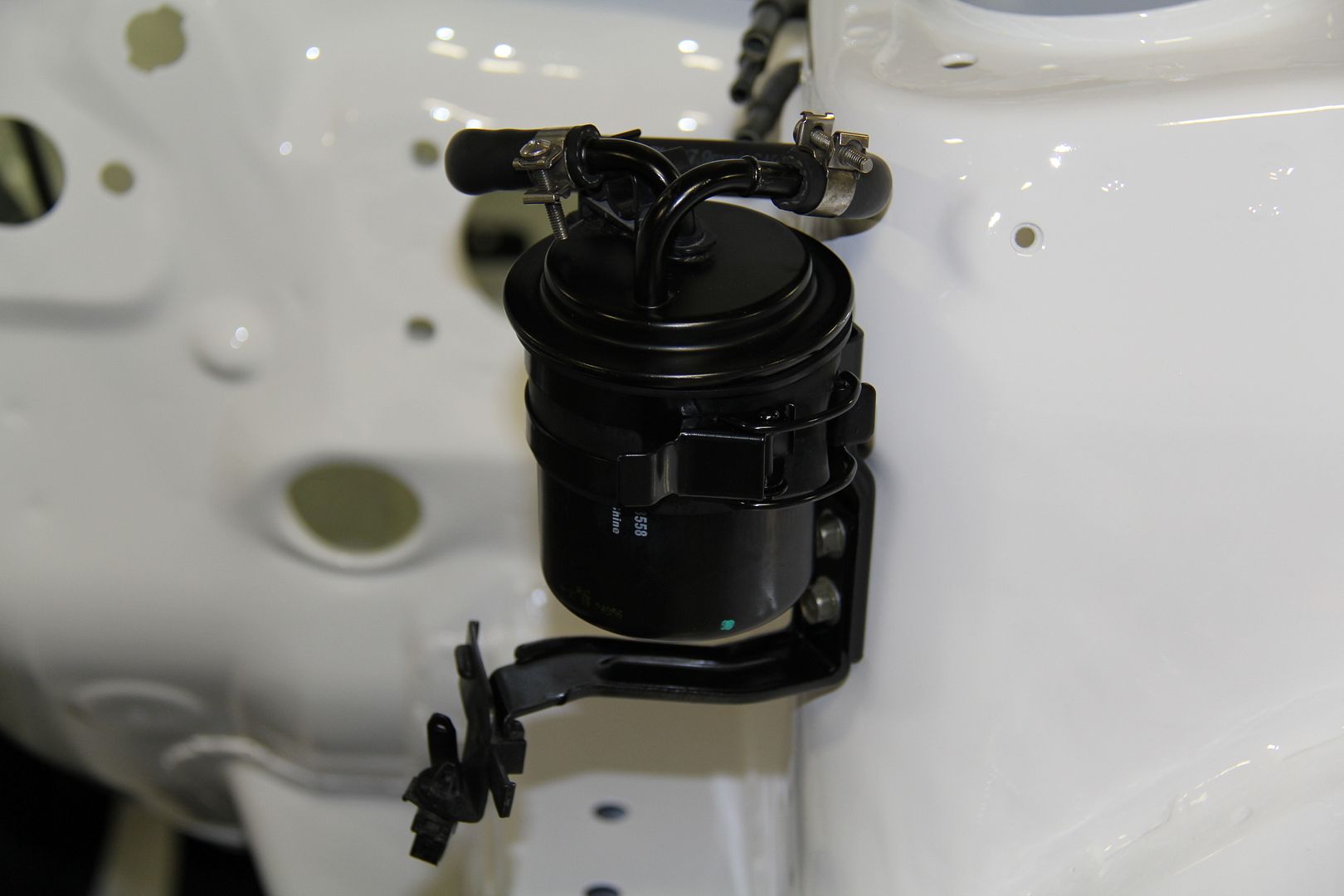

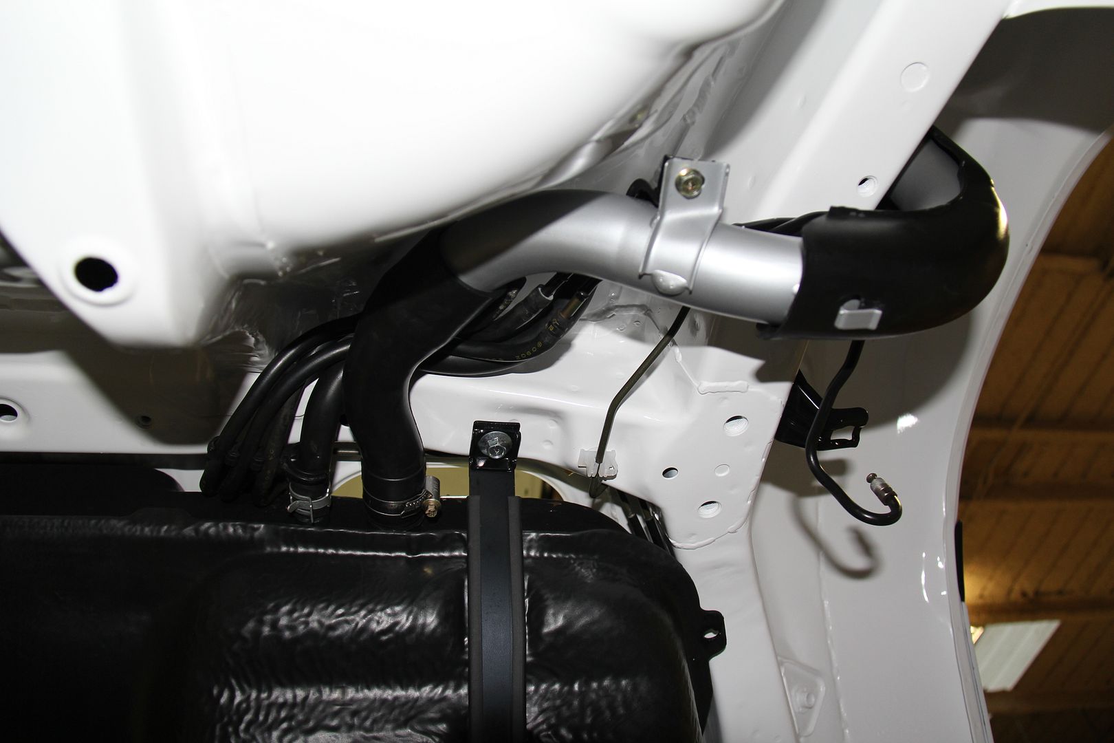

Now for a project update, I have fit most of the trim on the car, I am missing the trim on the left front door(center moulding) and both rear doors I need the trim that runs against the glass. I have most of the fuel system in except for needing a few clamps to finish the job. I have all the window regulators in and all the glass and door seals installed as well as the locking Mechanisims. I fit the window wiper mechanism back in place and all the lock mechanisim back in place in the trunk.
Here's the photos
