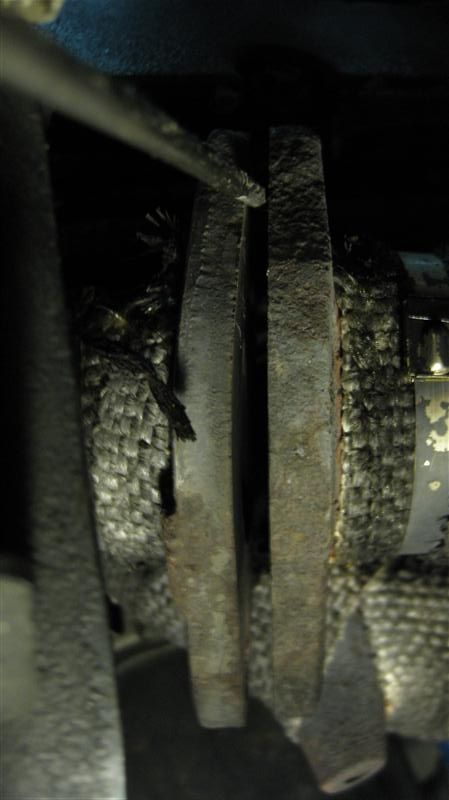

Then I unbolted the bottom of the up pipe and to my surprise I found out there wasn't even a gasket there! Nice. Fixed that.

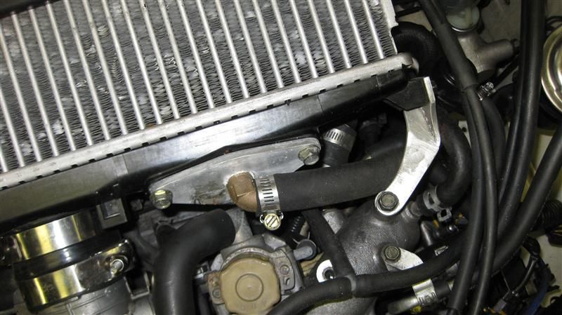

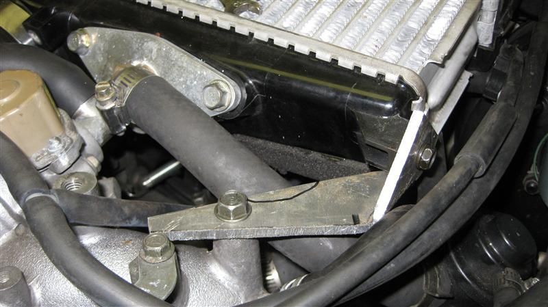

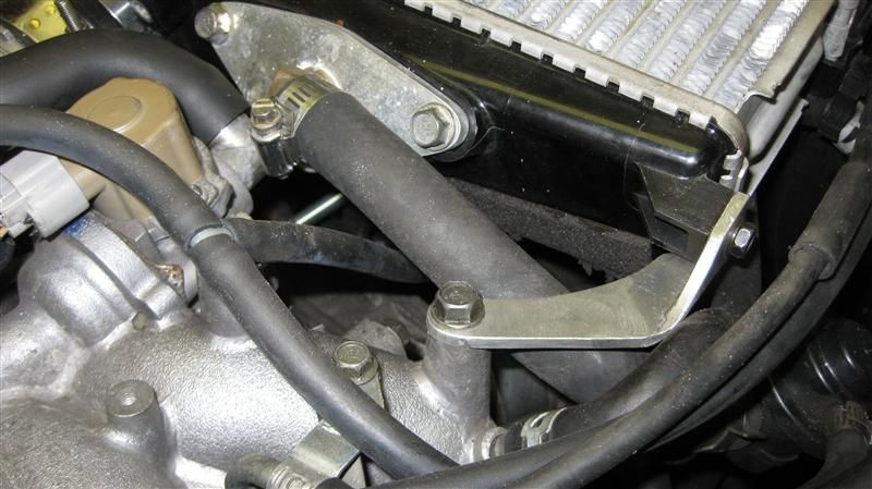

I decided I didn't like the BPV plate that I made rubbing up against the IAC vavle elbow so I grabbed some scrap aluminum plate and fabbed up an intercooler bracket. I like it a lot. No more play in the intercooler. That thing is solid.
First rough cut.
Final product and new gap between intercooler and IAC.

Nice job on the bracket. Looks factory.
Thanks. Belt sander, hack saw, drill, hammer, punch, file. I feel like I could design some pretty cool stuff if I had the tools. That would be an awesome job. Designing and building custom auto parts.
Does it run any better now?
Seems to be the same but it ran good before.

Mmm, brackets. Looks nice. Fore some reason i really like a good looking bracket haha

Thanks. Brackets are a great mix of form and function.

Bracket looks good!

Wow, you got a bend that clean and neat just by hammering the piece of scrap aluminum against a corner? Nice work!
Thanks guys. I put the aluminum in my vice before cutting it and I made sure it was in the vice right where I want the bend and then just beat it with my 3 lb hammer. Then I took it out and set it on the edge of the back of the vice and beat it to flatten it out nicely. Then I made several measurements and cuts and test fits and sanded it with a stationary sander and hand file.
I could have done a better job and I might sand it better later. There's still sand marks from the sander and I took off a little too much around the manifold bolt hole. I made that bpv plate too which looks a lot cleaner but I had more time to work with it and it was obviously less complex.

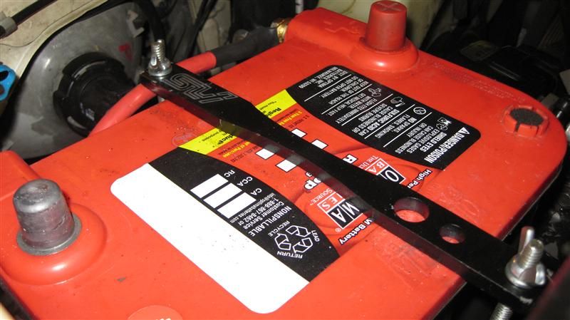

Found another 91 LS sedan in pretty decent shape. Inside of the trunk looked brand new. The tail lights were in awesome shape too. Bought my second multiswitch with intermittent adjustable wiper. Hopefully it works this time. I'll install it tomorrow probably.

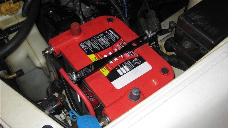

SLi battery tie down.

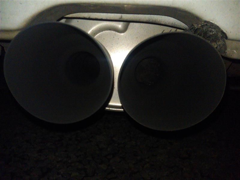

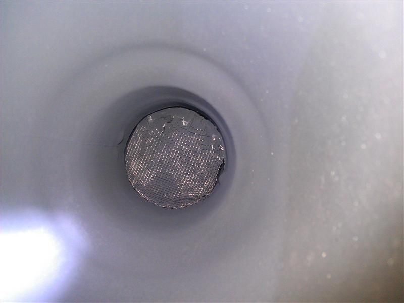

Last night I noticed my exhaust didn't sound right when I got out of the car to close the gate to my driveway. Sounded like an exhaust leak but coming out of the muffler which was strange. When I got up closer I could hear that it was only coming from one of the tips so I shined a flash light in side the muffler and found this.
Apparently my cheap $40 hi-flow cat from summit racing gave up on life and shit it's insides out, easily traveling through my 3" exhaust and even through my muffler only to get hung up in one of the tips which is probably only 2" inside the muffler at most; 2.5" at the exit.
I guess I have to remove my whole exhaust from the downpipe back and try to shake it out the mid pipe since it's all one piece after the downpipe.
Lesson learned. Don't buy cheap cats in an attempt to be green or pass emissions and certainly never run a pre-turbo cat of any kind.
As you can see from the picture its raising the temp of the right tip causing it to melt my bumper and that does not smell nice.
no bueno
Yeah pray to god I don't go up in flames.
Not gonna go up in flames now! I removed the chunk of catalyst. So glad that's not in there anymore. It was BAD. Must have been a massive restriction on my exhaust, it's not wonder it got pushed out of the cat. The one side of it is completely clogged with rock hard sediment! Between this and my up pipe missing gasket leak I must have really been robbed of power on that dyno run a few months ago.
