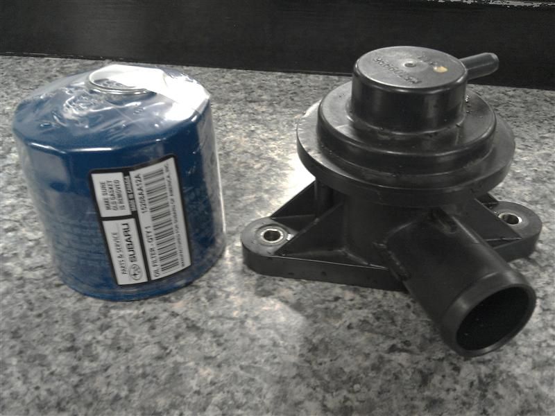

Picked up an 06 LGT BPV and found out the bolt pattern is different than my 06 WRX TMIC and I think the shape of the base also. Bummer. My BPV is too restrictive as well as the piping to it and it causes compressor surge and I want to fix that.

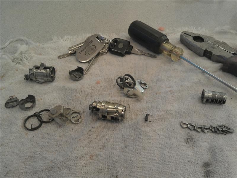

My driver's side lock cylinder snapped inside and the lock just turned for days and didn't work. I removed it today and grabbed one from a 91 wagon and I took them both apart and swapped the tumblers from my 91 SS lock into the 91. Cleaned it up and lubed it up and now it works better than ever. Awesome.
I forgot to get a picture for comparison but the 91 lock design was just slightly different in that they really beefed up the area that snapped off on my 91 SS lock. So I think it must have been from a newer car probably 92-94. Plus it was missing one of the springs for the tumblers so someone had taken it apart further supporting my theory that the locks had been replaced before. It's beefy enough that I don't think it could ever snap that way again.

Also is there a way to fix the locks so a worn key can't open them or is it just a poor lock design? A friend of mine opened my door with his key when my car was locked and that worries me because I know a lot of cars are stolen this way or broken into and robbed.
Posts: 27926
It's probably a function of the lock design. Short of getting a new lock cylinder with a different key, not sure what else you can do.

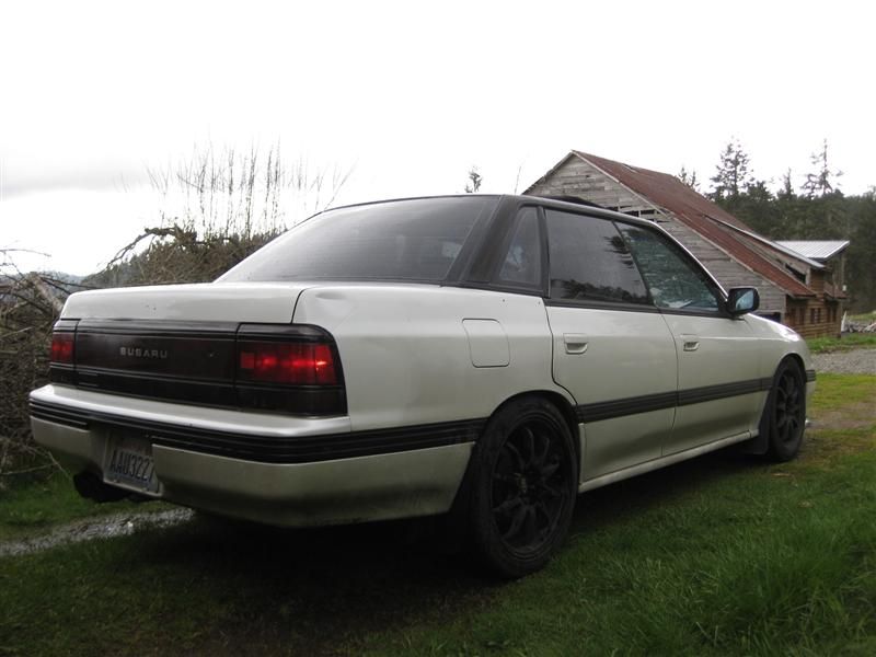

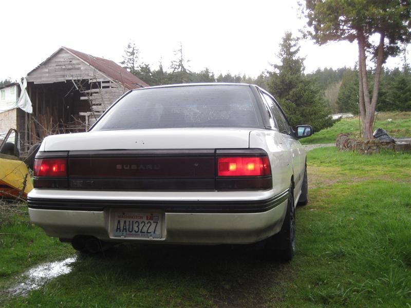

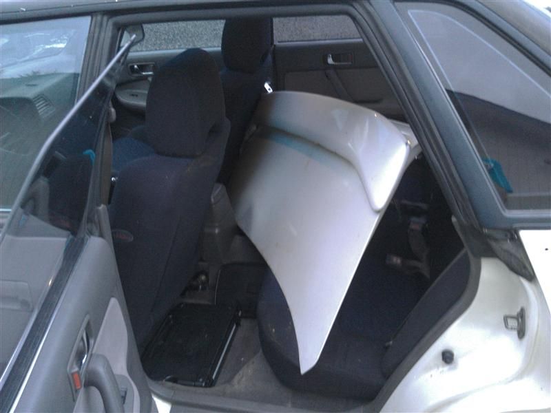

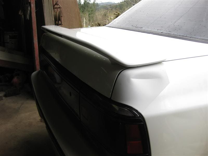

Scored a free trunk lid and spoiler. I thought about swapping the whole thing but it was too much work and more of a summer project when it's nice out. I washed the spoiler and polished and waxed it. My spoiler was badly chipped in several places and this one only has a few tiny chips.
I kind of like the wingless look though.
That is a score!
The wingless look is pretty smooth. It makes the front of the car look disproportionately larger than the rear, though. If that makes any sense.
I was thinking that as well. Especially with the front lip. Makes the back look small.

Not a big fan of wingless look. I think if you got the window rear spoiler thing it would work out though. Wish my car was as clean as your lol.
Meh its got dings and dents and the hood and trunk and door handles are different shades than the rest of the car. Busted windshield. Its in decent shape but looks better in pictures than in person.

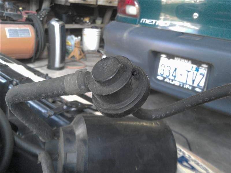

I tried installing a charcoal canister yesterday and was checking all my vacuum lines with the vacuum diagram and found out I have had a vacuum nipple open the entire time I've been driving my car. Well over 10,000 miles. Cool. It goes to the purge solenoid under the manifold. Which was routed to a vacuum nipple on top of the manifold. The reason I didn't know it was open was because my throttle body is mounted upside down so the throttle linkage doesn't hit the IAC and I didn't notice it because it's almost impossible to see it under there.
I have it hooked up to my purge solenoid now and I plugged that vacuum nipple on top of the manifold for now.
I wasn't able to hook up my charcoal canister because one of the nipples on this check valve is broken but I think mike-tracey is gonna send me one. It's bolted in place and all I have to do is connect the hoses one I get the check valve and I shouldn't have to worry about pressurizing my gas tank and all that jazz.

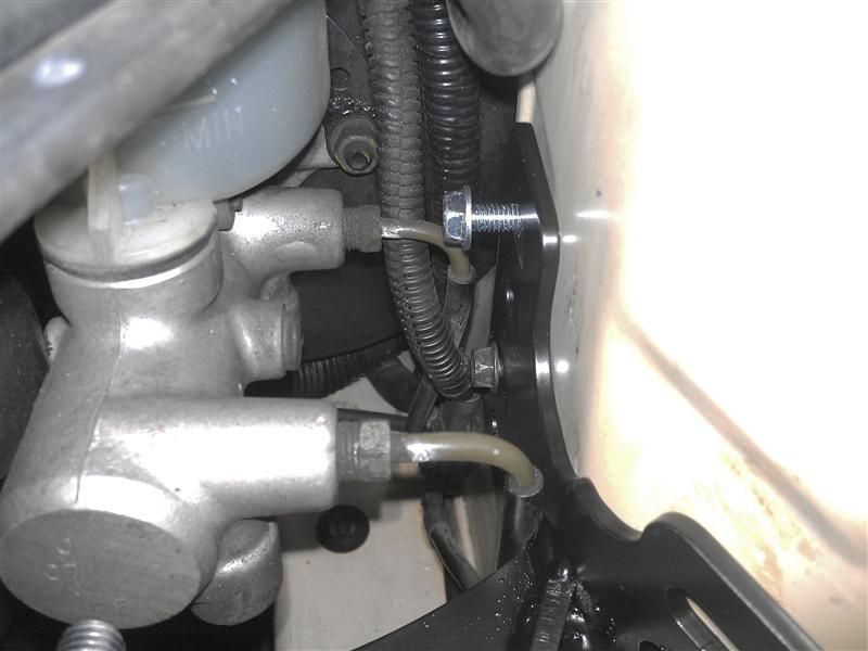

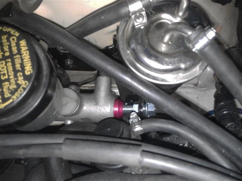

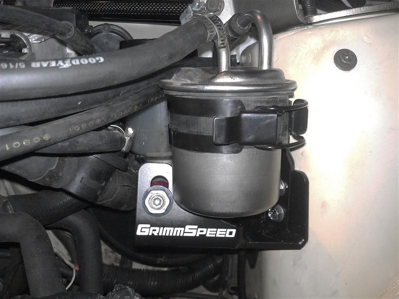

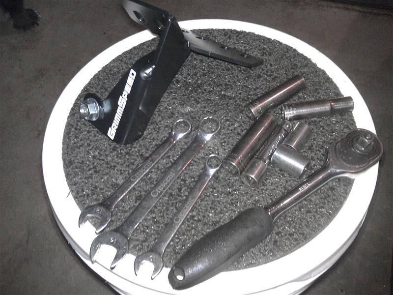

Installed my new GrimmSpeed master cylinder brace just now. About $88 shipped on ebay. Or $100+shipping and probably tax from GS's website. Pretty easy to do, especially if you have removed or relocated your washer reservoir which most haven't but I have.

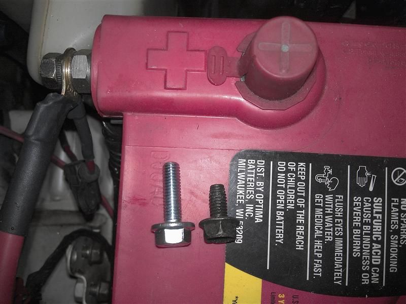

You'll need a 15mm (stupid) wrench, 10mm wrench, 5mm allen wrench and I used a pry bar to remove some plastic tab that was in the way and was serving no purpose. It looks like it was supposed to hold a brake line or something but nothing was there.
You have two options here. Use the supplied (way too long) bolts for the back of the bracket or you can use the short stock bolts that were previously holding the fuel filter bracket in place. It's a PITA to get in there to tighten them and the only thing that fits is a wrench so unless you have a nice ratcheting wrench (I lost mine) then I'd go with the stock bolts. It will save you time and frustration of turning a wrench 1/4 turn at a time on a long ass bolt. GrimmSpeed should have given shorter bolts unless there's something else on other cars that needs to be bolted on top of their bracket.
This brake line on the turbo legacy (pretty sure it's different on NA) had to be bent back towards the firewall a little. Maybe 1/4"-1/2" because it was in the way of the bracket. Obviously not designed for our cars specifically.
You can toss the bracket that used to hold the starter wire loom. The GrimmSpeed bracket has a hole to zip tie it to if you want but I've relocated that whole harness so I didn't need it anyway. Get the brace snug up against the MC and then turn 1/2 to 1 full turn on the inside night and tighten up the outside nut and put your fuel filter and bracket back together and you're finished. 30 mins tops.

Unless the nut is self locking, that's going to work itself loose fairly soon Kimo.
You need another nut on the opposite side of the plate to lock the assembly, if there is room. If there isn't room, you will need a longer bolt to add the locknut - or a shorter bolt to completely bottom out and lock with just the one nut.
How do the brakes feel?
You think? That's how grimmspeed said to install it. They're not locking nuts but they're pretty tight together. They also have those ridges on the inside face of them to help prevent them from coming loose.
I haven't really driven the car yet. I drove it 2 blocks down the road and back but didn't really notice any difference. I think I need to replace my fluid with new pads and rotors and bleed them. I also have some bleeder screws to install with the one day check valve in them that have been sitting in my garage for 3 years since I haven't done anything with my brakes yet.
