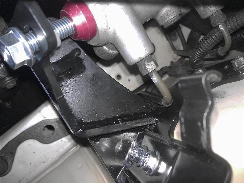

Jess, you did see there's a nut on each side of the bracket right?
I'm looking at this:
If that all gets tightned down together, I'm good.
Oh yeah it's tight. That picture was just to show the brake line that had to be bent a little to fit the bracket.
Hahahakimokalihi wrote:You'll need a 15mm (stupid) wrench...
kimokalihi wrote:This brake line on the turbo legacy (pretty sure it's different on NA) had to be bent back towards the firewall a little. Maybe 1/4"-1/2" because it was in the way of the bracket. Obviously not designed for our cars specifically.
There's no difference in the brake lines between turbo & non-turbo or even abs & non-abs. That line will get in the way. The MRT bracket doesn't have as much webbing there to interfere with the line. You could notch the bracket, but bending the lines isn't too hard.
Did you take any measurements of the MC movement before and after putting the brace on?
You probably won't notice a huge difference in how the brakes feel with the MC brace. From talking with a guy here in Houston, he had MUCH more flex in his WRX than I had in my Legacy, so I think it's more beneficial on those cars then ours.
Here's info on the measurements from my MC brace install
http://bbs.legacycentral.org/viewtopic. ... housandths
No I didn't take any measurements unfortunately although I guess it wouldn't be hard to back that threaded bolt out and measure it. What did you measure it with?
