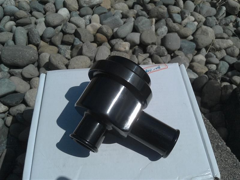

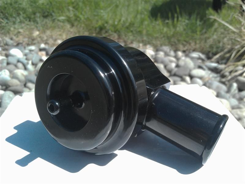

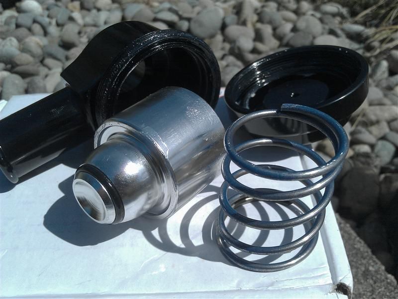

Got my eBay BPV in the mail today. Looks like pretty decent quality. Has 3 springs and washers to dial it in to fit your boost target. Haven't installed it though. Have to either refab the BPV plate/elbow I made with a larger diameter elbow (1" is the size of this BPV I believe and the elbow is 1/2" if I remember) or wait until I get my AWIC setup and figure it out then. I'm thinking I'll probably want to refab that plate sooner than I get the AWIC setup though.

Well this one has 3 different springs with different rates and has washers to dial it in perfect so it should work just fine. I don't know how well you'll be able to hear it though. You can barely hear my turbo with the factory airbox in place.
Reciculated BPV's aren't real loud, anyway.
