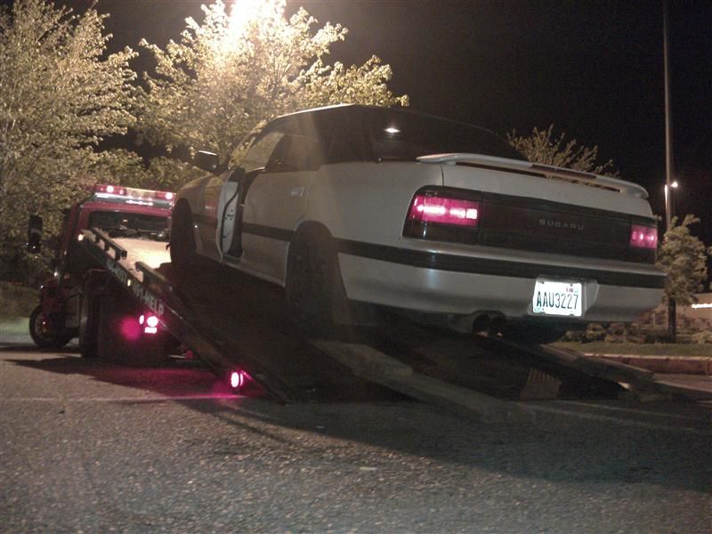

Soo....went to the bar after work and texted a friend who needed a ride to the bar. Went and picked him up 1 mile down the road and hit taco bell on the way back. Went to pull out of the intersection and heard a loud bang when I let off the clutch and the pedal stayed on the floor! I rolled backwards back into the parking lot and popped the hood. Removed the intercooler and starter and found out the clutch pivot dowel plug worked its way out (wasn't all the way tight before. Lesson learned.) and fell out and the pin came out. So I pounded the dowel pin back in to hold the clutch fork in place and that's when I tried the clutch again and it only comes halfway back up. I'm pretty sure the clutch itself broke. Also a large chunk of the transmission housing broke out right below the clutch fork boot. So we walked back to the bar and continued drinking until they closed and now were waiting for nationwide roadside assistance. 100 miles feee towing for only $20. A year.

Jesus Kimo. that sucks!
No doubt. Still sittin here waiting for nisqually towing. Big chunk of my tranny busted out.
Got the car back to my moms. Cost me nothing. Thanks to nationwide $20 a year 100 mile tow and roadside assistance. Now my metro is on the battery charger getting ready to go back on the road earlier than I had planned. Hurry up and charge little buddy. I'm sleepy.
Holy crap. Man Kimo, that's a bummer.
Hopefully you it's not as bad as it sounds.

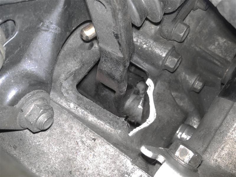

I believe the failure was due to my laziness but I won't know for sure until the trans is removed. When I put the engine in last time I had everything in and realized I forgot the plug that threads into the trans to hold the dowel pin in place for the clutch fork. I didn't want to pull the starter to get enough room to get an hex wrench in there so I just threaded it in by hand but it only went in about halway. Its gone now. Worked its way out and split town. The dowel pin was sticking out an inch and the clutch fork was pretty loose due to the other end of the dpwel pin not being in its hole inside the bellhousing. I believe this to have allowed far too much play side to side and up and down for the fork causing something to contact the spinning pressure plate and resulting in some type of failure but I can't see enough trough that tiny hole to determine was broke but it broke with enough force to punch a hole through the bellhousing directly above the dowel pin hole.
Kimo, IIRC the end of the clutch pivot pin has a slot. This is engaged on a pin or such at the far end of the bore. The reason for the slot is to keep the pin from spinning as the clutch is operated over time. If the pin spins, then it could theroetically spin the plug out if enough contact is made.
If the plug didn't go all the way in, then it's likely that the slot on the end of the pin wasn't lined up and the pin couldn't be seated.
If you need anything, just ask and I'll check the parts pile.
Oh I know what you're talking about. Makes sense. I need the plug unless it happened to fall on in the crossmember somewhere but as far as I can tell it's history. I will know if I need a new fork or anything else when I pull the engine. Or tranny. Haven't decided which yet. Might be a while.

Here's some pictures from last night.
It looks as thought the fork got slammed into the tranny housing and broke a big chunk out of it but I tapped the dowel pin back into place and put the slave piston back into the clutch fork and put the spring back on it and had my friend push the clutch in and it only comes maybe halfway back up (the pedal that is). It wasn't even pulling the fork back enough to hold pressure on the spring and the spring was so loose it just fell off again.

The part of the bellhousing that contains the pivot pin cracks when the pin gets sideways. Grab hold of the the throwout fork and try moving the entire thing forward and back (without pivoting it). This will let you know if there is play in the pivot pin and the housing is cracked.

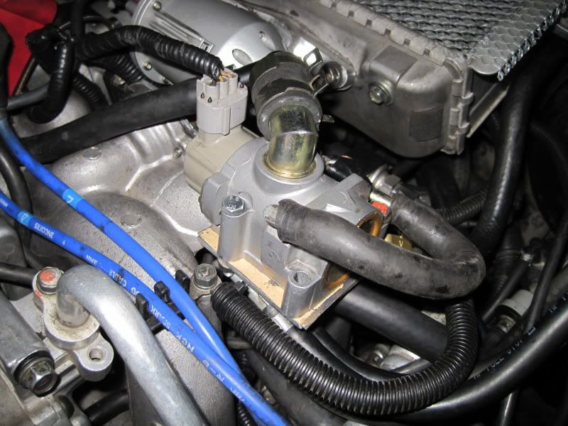

Looks like somebody on SLi figured out how to relocate the IAC so they could run a USDM intercooler with the BPV still in stock location on the intercooler with the JDM intake manifold.
Got a direct link to that thread ?
I would venture to guess it's this one.
http://www.sl-i.net/FORUM/viewtopic.php?f=6&t=13417
Searching Google with the Photobucket user name, this comes up from SL-I.
