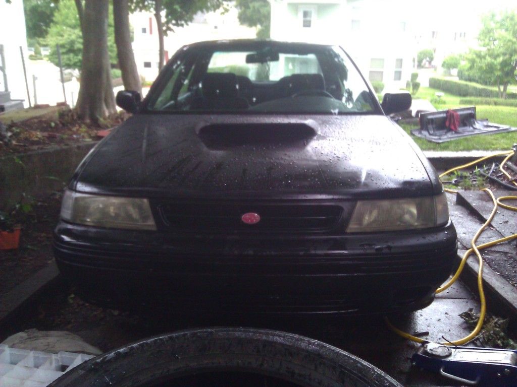

After a much needed wash....
got my owners emblem on there

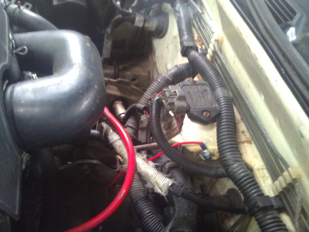

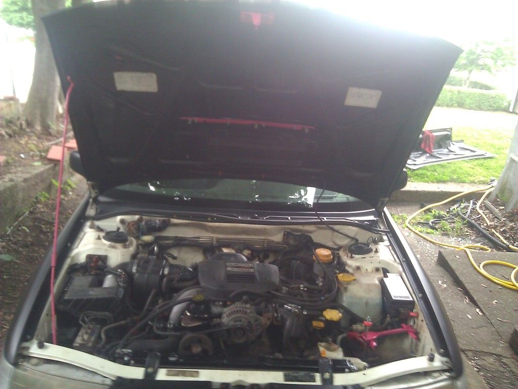

I also need to relocate this somewhere else, for the intercooler, where do you guys stick this thing?

My igniter is relocated to the bolt that you have the red wire coming from on the side of that bracket. Held on by one bolt. No issues.

Yeah I figured I could probably stick it anywhere, I haven't really looked to even see how much slack it actually has.Alphius wrote:My igniter is relocated to the bolt that you have the red wire coming from on the side of that bracket. Held on by one bolt. No issues.

what is that red 12 gauge wire bolted to the fire wall connected too
Re: Xise's 1993 Legacy Turbo
it is the ground for the transmission case

if it is broken or corroded i'd say replace it, it was causing my transmission circuit to not remain grounded. You can never have too many grounds

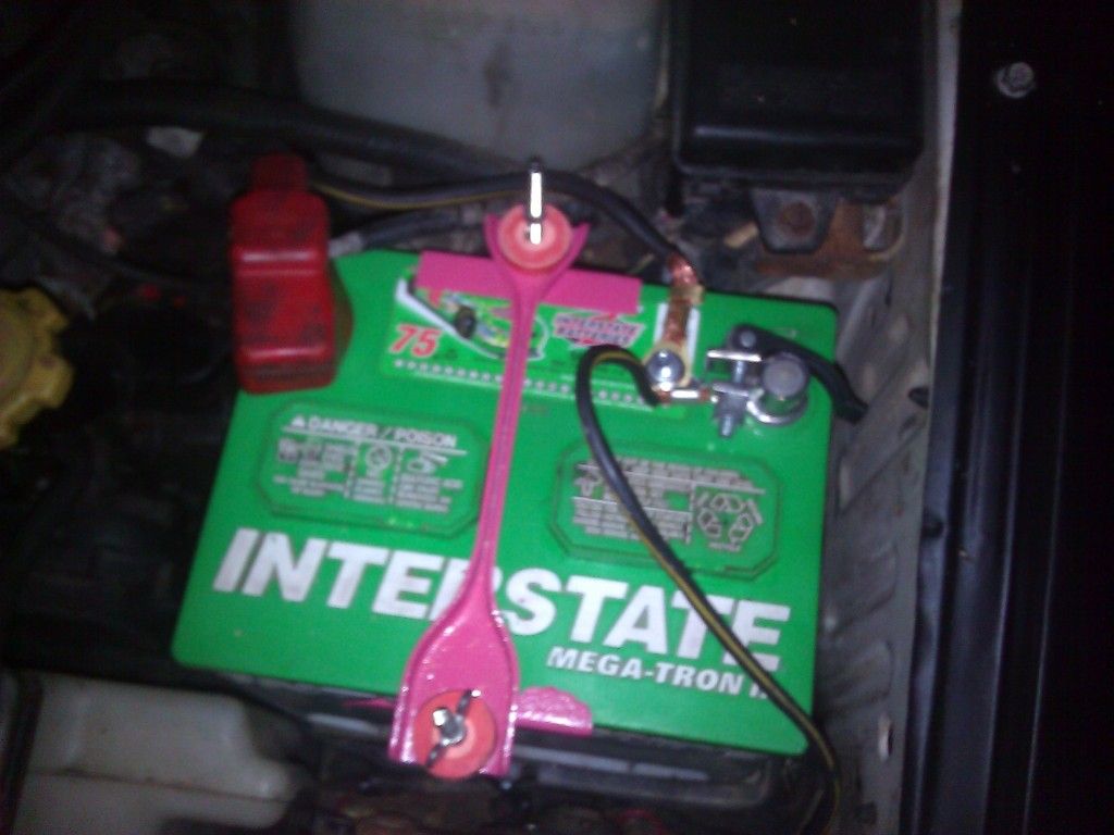

Finally got a battery Thanks to a local on RS25.com, helped him get his gas tank up for his RSTi swap he is doing and he gave me a battery...not too shabby.

The ABS light is from the wheel speed sensor wire being cut...looks like someone snipped it, nice clean cut. Right now it won't start, I am getting code 35 for the evap solenoid, and I could smell some gas...not sure how it would have gotten flooded or maybe because it is on a hill and the tank is low it doesn't have any fuel pressure...OR the battery might just be too weak to get the fuel pump going....

Just looked at the wiring diagram for the starter circuit, for the AT the only thing that could prevent the starter from getting power is the Inhibitor switch. Now I know the connector for this is on the trans..but is there also a relay for this that might be in the main fuse box under the hood?
No relay in the fuse box. You could try jumpering it at the B15 connector just to see if it'll start. If you do, just make sure you use large enough diameter wire.

i'll check for starter voltage before I go ghetto and hot-wire it right off the batter....although that would def get it to start and rule out the starter as the culprit...well sort of lol.

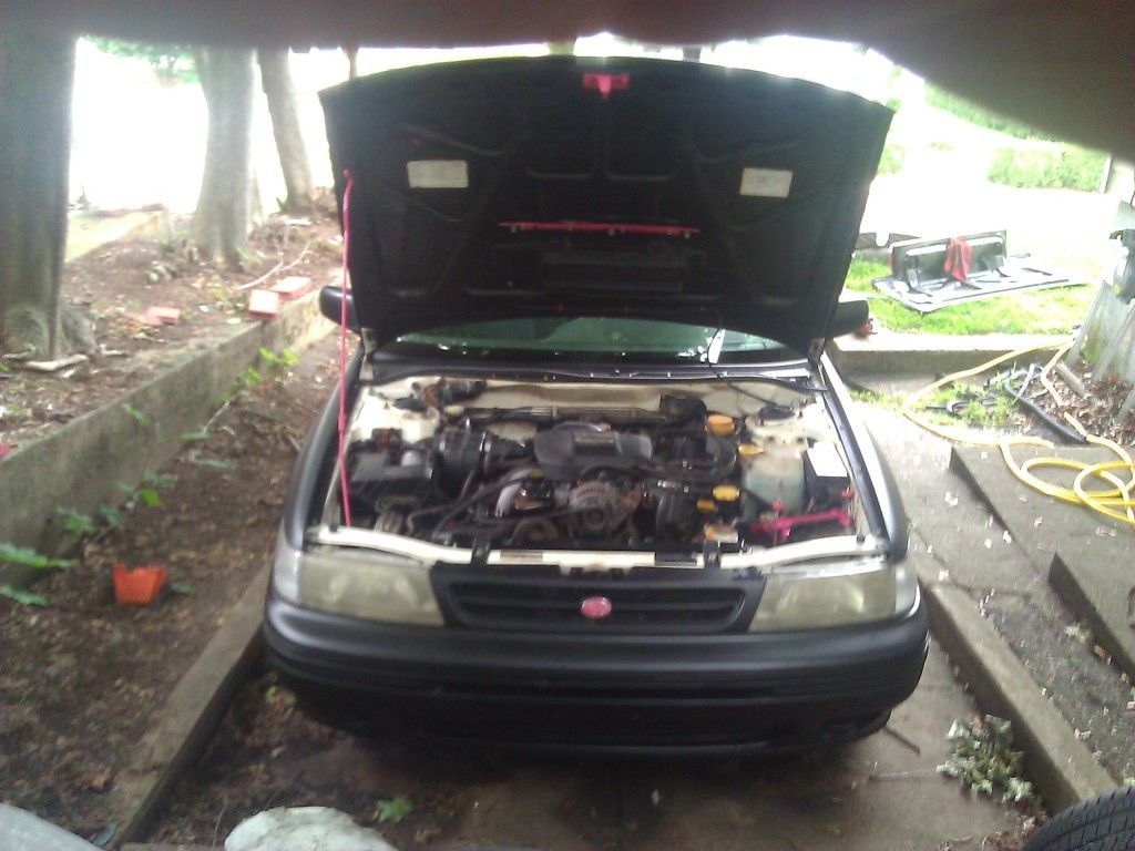

Got this beast started yesterday, turns out it was just the shitty Valucrap battery.....started to take a video but my ADD kicked in and well...you can just watch it lol.
Thanks to Mykul for the battery, if it weren't for him I never would have taken the time to swap my RS' battery into it and get it running for a little while...
So yeah, I got a bit of smoke from oil seepage, the thing sat for a long time while I did body work so, really with leaky gaskets it should have been A LOT more smoke from oil seepage so I guess they aren'y leaking too badly. Either way all I need are a few things like brake calipers, I am sure new ebrake hardware is in order also so I'll be getting that too.

OK brought the battery back to the dude that gave it to me and he let me have this interstate battery, dropped it in and it fired right up no problem!
