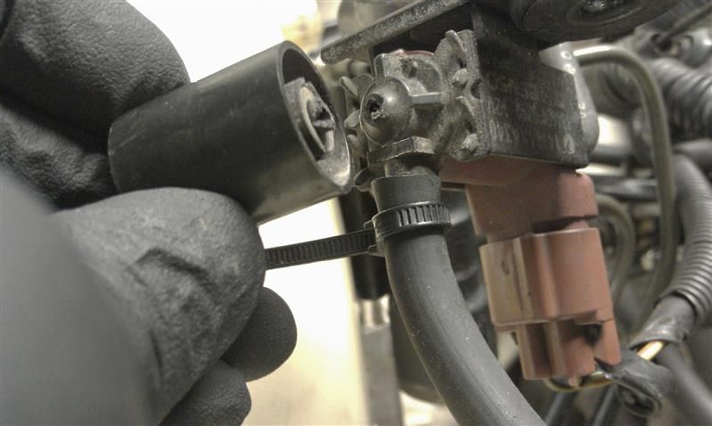

kimokalihi wrote:Somehow in the process I accidently snapped this guy off. Just how important is this piece and what the hell does it do? I imagine it's some type of one day diaphragm and therefore probably pretty important? Anybody got one of these sensors for sale?
That is the pressure exchange solenoid. That cap is more or less a filter. The ECU switches between intake vacuum/pressure and atmosphere to measure ambient pressure to correct fueling for changes in altitude. Leaving that open should have no affect on how the MAP sensor does this, but it could allow for dirt to get in the solenoid and possibly in the MAP sensor.
The mid 90's subarus use the same damn pressure exchange solenoids, so you can probably find one off a mid to late 90's Impreza or Legacy. I'm not sure what they cost new.
