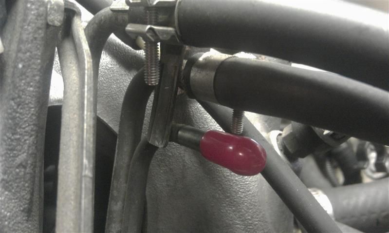

Why complicate things? Just vent it. If you're that worried about a minuscule amount of hydrocarbon emissions, leave the stock setup in there. There's a reason the manufacturers did it that way. If you're worried about a cluttered engine bay, relocate the stupid canister into the fenderwell and hook it up like stock.
Here's the thing:
Tank pressure or vacuum = bad
Unmetered air into intake = bad
Unburned fuel in the intake tube = bad
Stock setup = a little cluttered, functional
Open tank vent = a little emission-y, still functional (keep in mind millions of cars for decades ran simple vented systems like this and were just fine)
Ive had my vent open under the hood for atleast 5 years no canister. Yes I have some vac in the tank but ive never noticed a problem fuel wise.
Edit, I probably do about 150-200 miles a week.
The fender is a goog option. I hate complicated things when I can make them simpler. I also hate things that don't work or work inefficiently. This is one of those things. Ill probably put it in the fender like I did the washer resevoir. That works for me.
Seems like a good option. But why do you worry about it? Doesn't your 20g ecu not have the purge solenoid?
Beats me. If it doesn't, that's explains why there's still pressure buildup in the tank when the system is hooked up. I've heard that before though. If it doesn't have the purge solenoid overseas, how do they not have any problems with tank pressure or vacuum?

Stock JDM cars without purge solenoid control use a system back by the tank that does not require ECU intervention to vent the tank.

Yep, that would do it. Yours was running EDM code so it had the PCS stuff enabled, the JDM code that Rob uses as his base has no PCS control because all the early JDM WRX EJ20g engines had no PCS.
So hooking it up won't do me any good anyway? If so that explains why it didn't improve when I finally hooked it up. Can I get the tank vent setup on my tank?
With the purge solenoid plumbed up and no signal from the ecu to open it, venting that pipe won't do any good, will it? Can I just drill a small hole in my gas cap? Haha
kimokalihi wrote:With the purge solenoid plumbed up and no signal from the ecu to open it, venting that pipe won't do any good, will it? Can I just drill a small hole in my gas cap? Haha

Just leave the vent line open with a small filter on it under the hood. Done.
That doesn't address the solenoid. Is the solenoid giong to keep the vent line closed anyway? Should I remove the solenoid? Or maybe there isn't a solenoid...Also, what type of filter and where do I get one?
Alphius
Posts: 1204
Location: Rochester, WA
Post by Alphius »
Take the solenoid off.
Just go to the auto parts store and buy the smallest filter you can and put it on the vent line where the rubber hose connects to it behind the fuel filter.
Alrighty. Is it just to keep debris out or does it actually filter the fuel vapors out?

The solenoid is on the manifold. The line coming from the tank shouldn't have anything in it, so as Alphius mentioned, just put a filter on it. You can test this by unscrewing the gas cap and blowing through the vent line.
I left the solenoid on there for now. Might remove it later. I installed a fuel filter on the line that I believe to be the vent line. You can see it in the pictures. It was the smaller of the three lines and it was only secured with pinch clamps whereas the other two were adjustable bolted clamps for higher pressure.

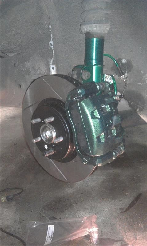

I got the front brakes and SS braided TechnaFit hoses on tonight. Here's how they'll look inside my wheels.
I don't know whether I need 91 SS rear parking brake shoes or 05 LGT shoes. Autozone had different part numbers for both and only had the 05 LGT in stock so I picked those up and ordered the 91 shoes too just in case.
The brakes, struts and hoses match! I really need some of those nice coil over sleeves that keeps your springs, piston and threads clean. Ewww.
