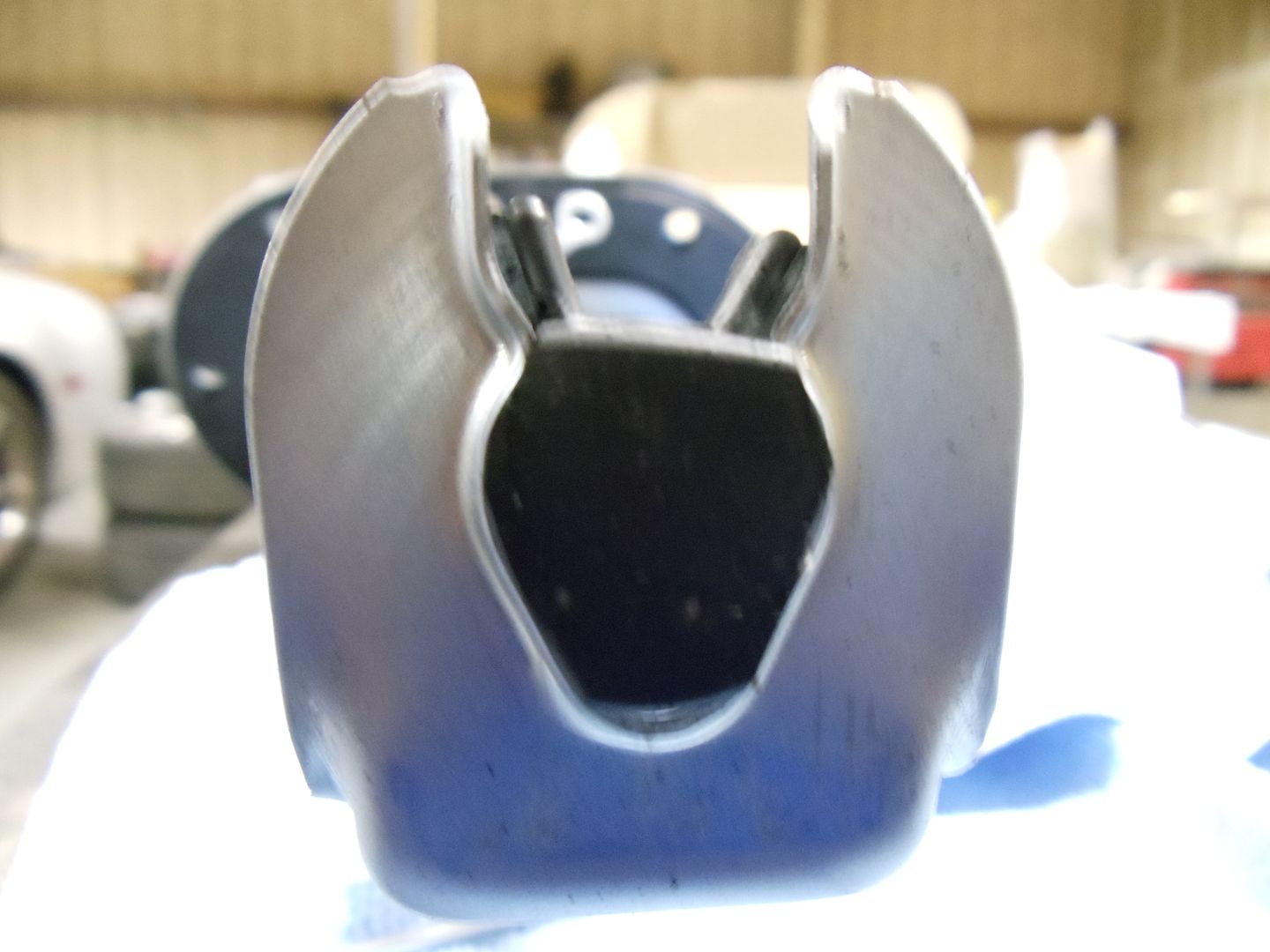

Here is a picture of the control arms he made for a friend of mine if that helps:

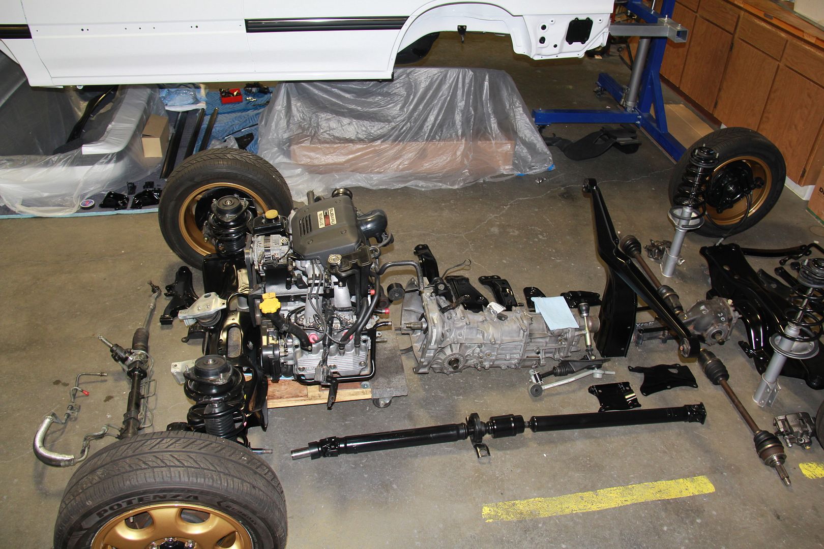

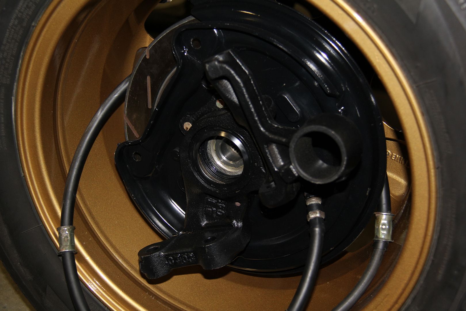

The second part of this project is nearly finished. I have slowly been going through all the original parts and rebuilding them. I hope that someone will be interested in buying them to rebuild another Legacy back to it's former glory. Here is what I had in mind, I have to paint the diff housing which has rusted a lot just sitting around and go through the steering rack and fit bushings to lateral links and trailing arms and then this project is finished !

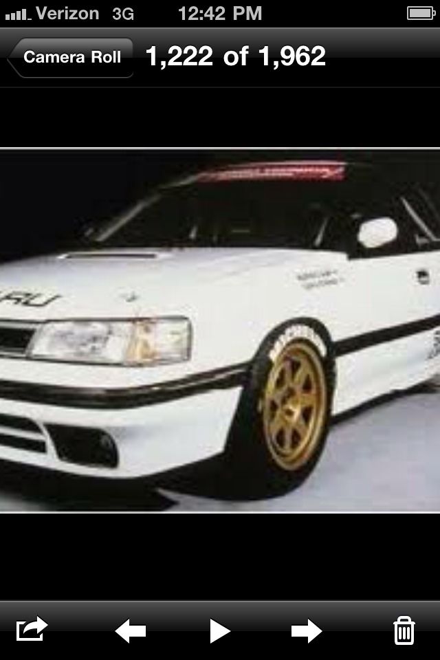

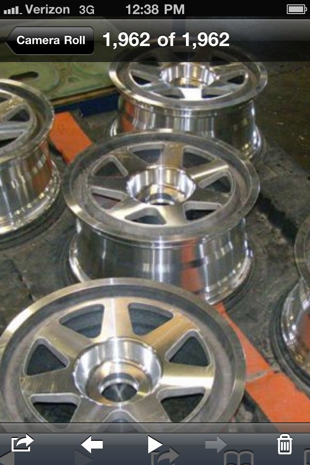

Here's something I had not posted, It was going to be a surprise but I have found someone that has original style prodrive wheels, he has cast new wheels, actually he built the original wheels as a worker for the original manufacturer.
I can have them machined as required
Front seats I intend to find and purchase and fit to car

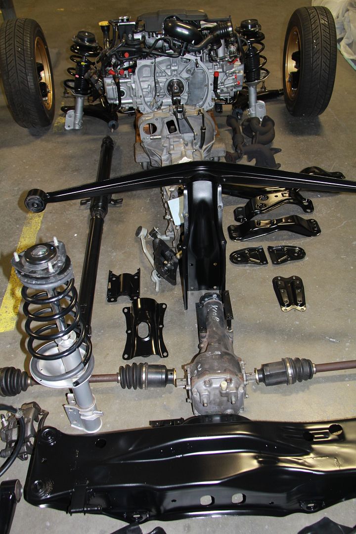

There are a few things that I consider very important to this project, The Front and rear Sub Frames which are hand made and done by a true craftsman and fabricator, his welding is a work of art.

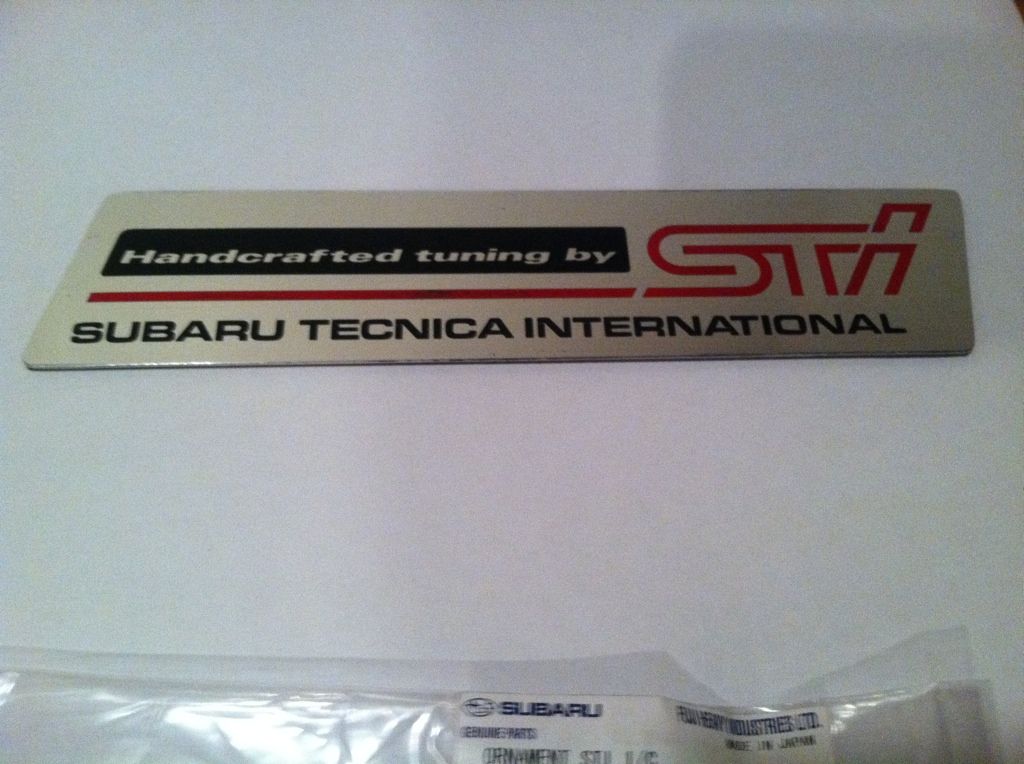

Then one of the members on here helped my significantly by finding this new badge for my intercooler as found on the RA Legacy, so a very special thanks to him. It is a very special find as they are no longer available, I have purchased the last turbo hood here in the USA as well as many other items that were the Last available and it makes it really awesome to know that many of the new parts used to build this car can't be found now.
Here is a picture of the badge

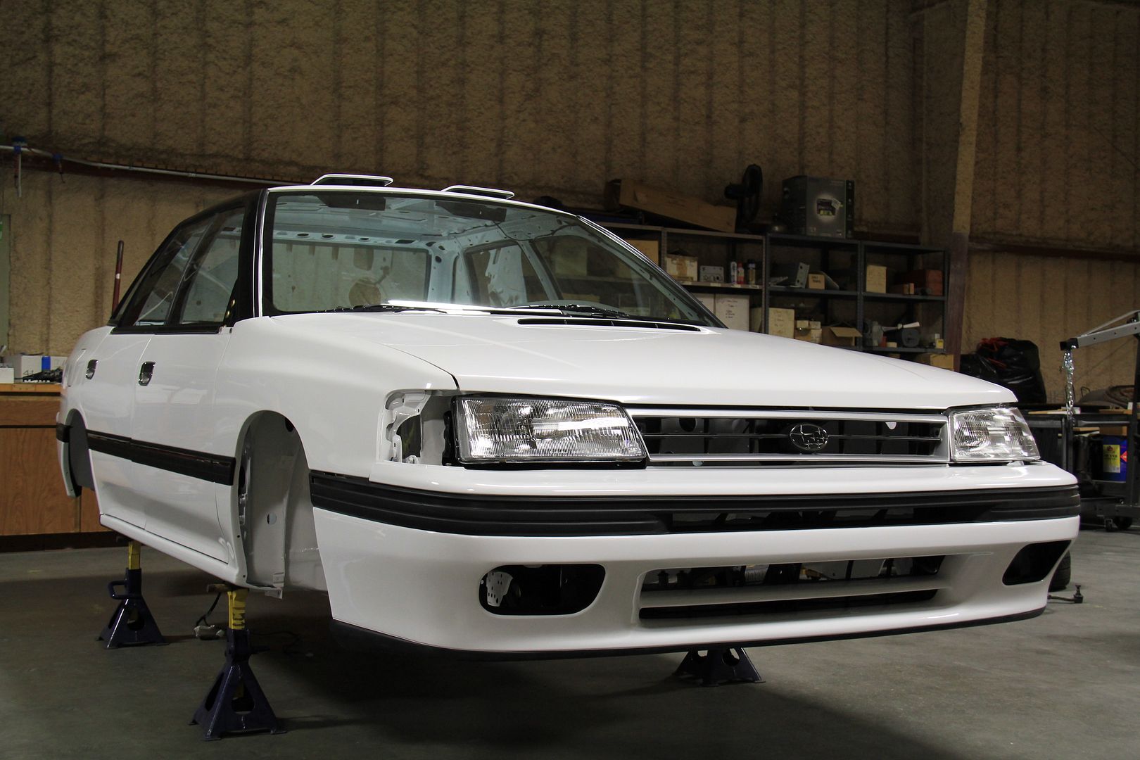

There is another part of the project that is amazing and that was the work done to remove the Sunroof and fit the filler panel. This was also done by a true craftsman
Bruce at Specialtymetalfabrication.com did this part of the project. The Possum Bourne roof vents are also another special part of the project specially having the opportunity to work with him on Several occasions thanks to Trevor Crowe running the Legacy. Here are some photos of the roof
Possum Bourne Motorsports vents

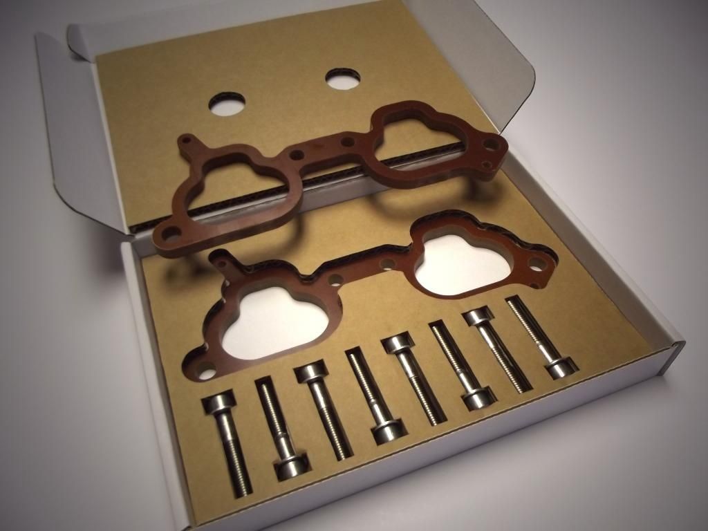

Here is a kit for the intake manifold that I also plan to get, it's basically a thermal spacer that replaces the factory gasket and helps prevent heat soak into the Manifold!

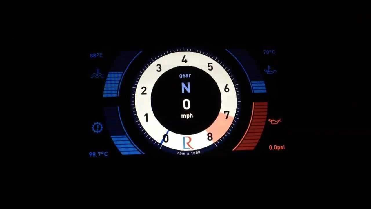

Wow nick ! even the wheels you got now sweet baby Jesus !.... I take it we are going to see some amazing rally spindles also coming ???
What are your plans for ecu ? Life racing is the newest and best one out there controls everything in one unit complete... The dash is out of this world, my friend Franz@dieboldautosprt just set up a handle full of cars on them. I'll dig up a video you got to see how nice this stuff is if your going stand alone stuff.

I will be using Mitch Pederson at MP Tuning, he has done work for us before and he will be Tuning the car and also involved with modifiying the wiring loom I believe it is AEM that he will use, he was the one involved in its development. I need to confirm this yet, however I already agreed to go with his ecu.NICO wrote:Wow nick ! even the wheels you got now sweet baby Jesus !.... I take it we are going to see some amazing rally spindles also coming ???

Do you happen to know which model? Their new ecu is called the infinity, and then they do model specific ones so he could be using something an older wrx or an EMS-4. Either way they all work pretty well and he tends to know what he's doing.BC622B05STI wrote:I will be using Mitch Pederson at MP Tuning, he has done work for us before and he will be Tuning the car and also involved with modifiying the wiring loom I believe it is AEM that he will use, he was the one involved in its development. I need to confirm this yet, however I already agreed to go with his ecu.

Nico, that is a pretty cool dash setup! I wonder if it would work with my Link.

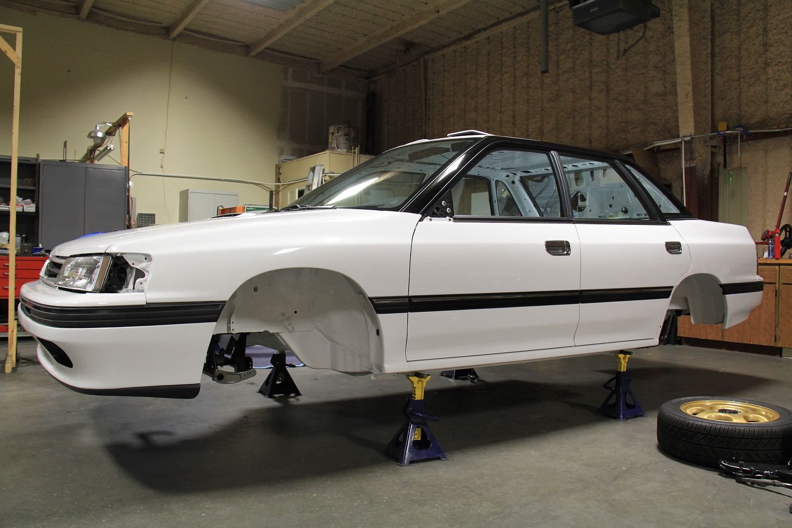

The stands arrived from England today so I went and put the car on them after work
I have to say these things are a work of art !

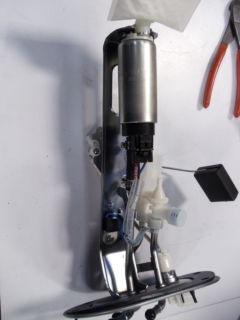

I have done very little with the Legacy in my time off from traveling but I did get to fit the
walbro 255 LPH in tank fuel pump, I did not follow the instructions as I did not like the way they wanted to mount the pump, I modified the base mount which was rubber and I was able to fit it just as the factory had with the original.
This pump will easily support the 350 hp that I hope to make from this engine
this is the original pump next to the new pump to be fitted
The instructions called to wrap the body of the pump in supplied foam and tywrap to the mount
I modified rubber base mount to fit as the factory pump was
the finished pump install just as the original pump was mounted
