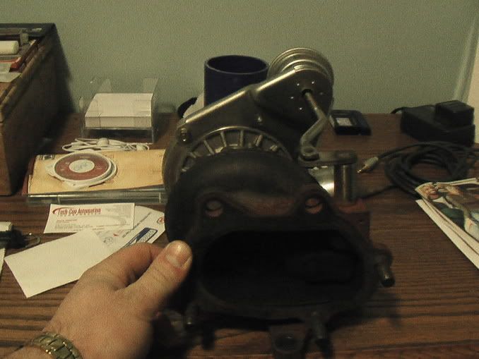

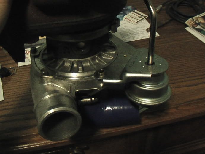

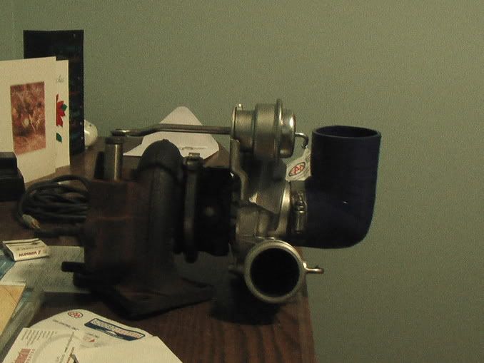

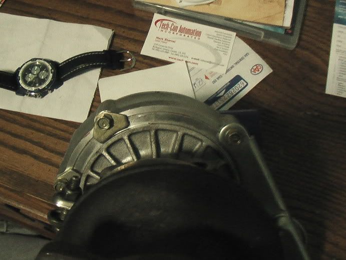

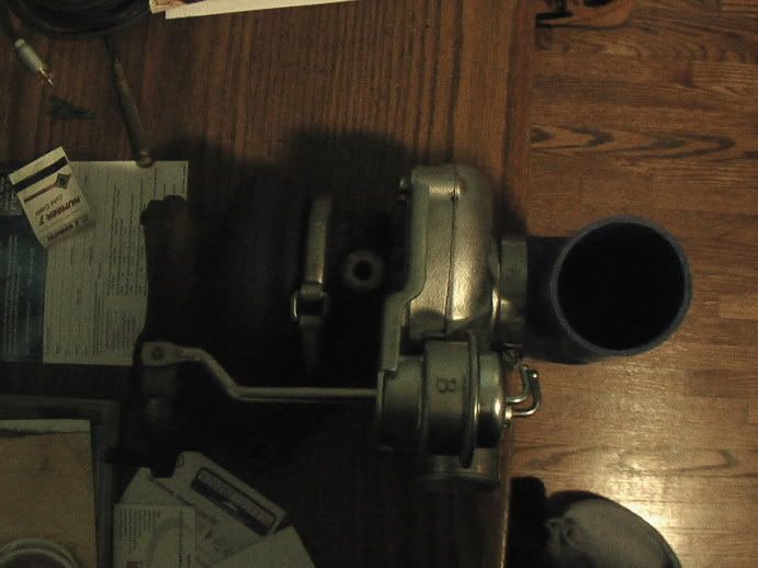

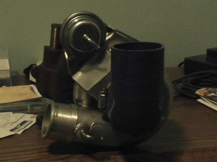

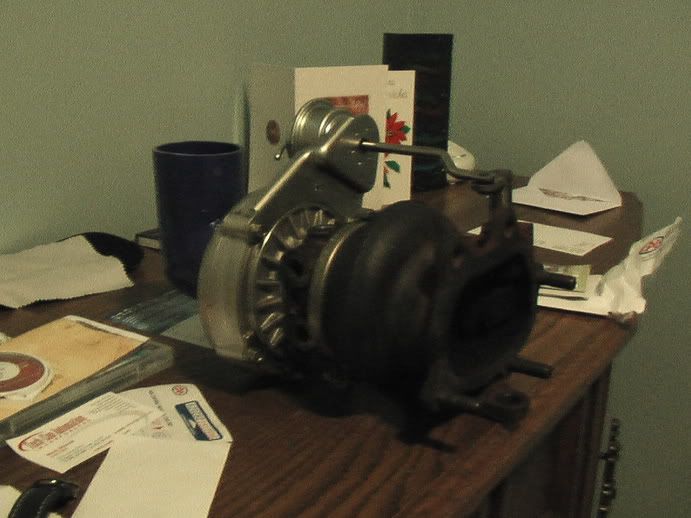

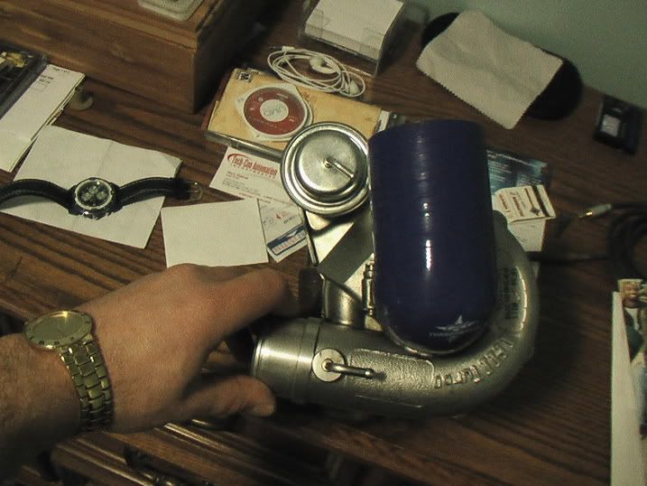

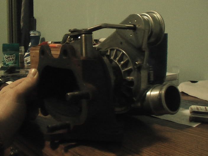

here is the car and the turbo that is going in the car this friday vf34 clocked for my set up with a front mount intercooler
see how the houseing has all those tabs with bolts holding the front compreser on, all you do is losen them up and spin the turbo any way you want. next i will show you when i put it in.
