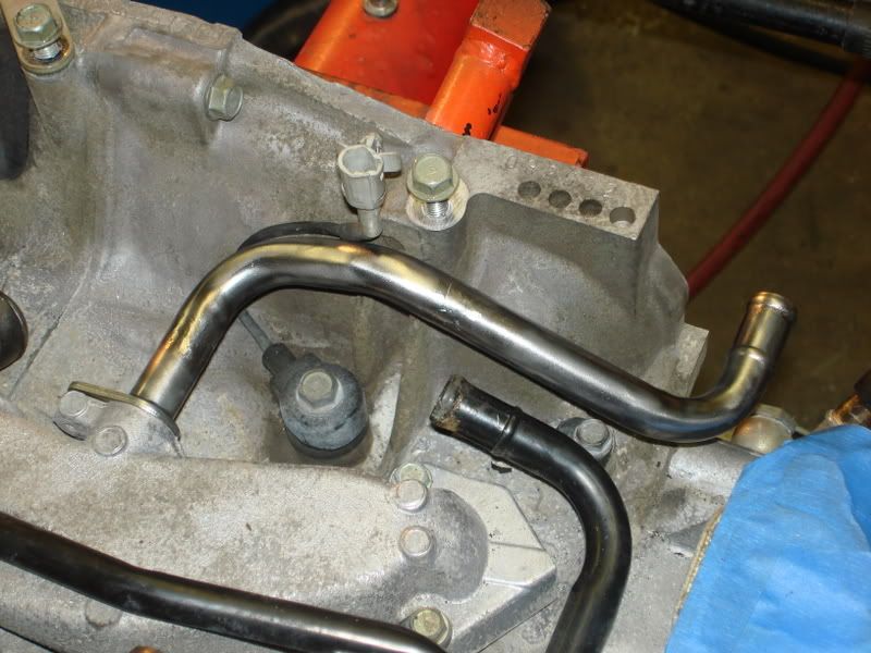

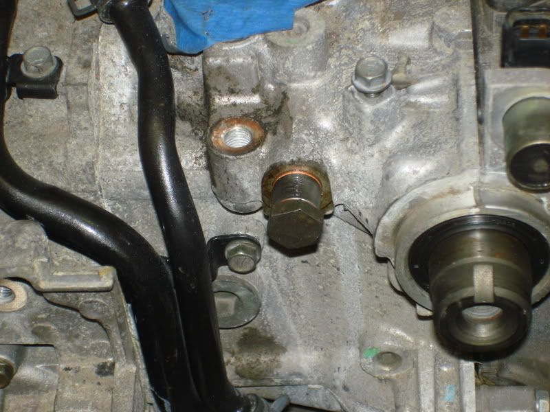

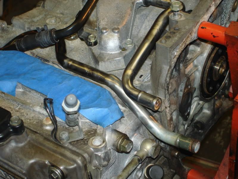

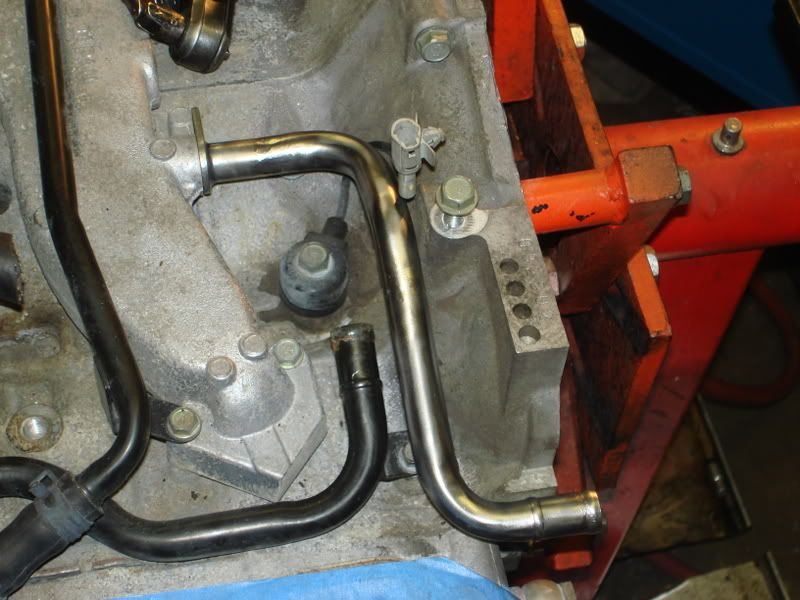

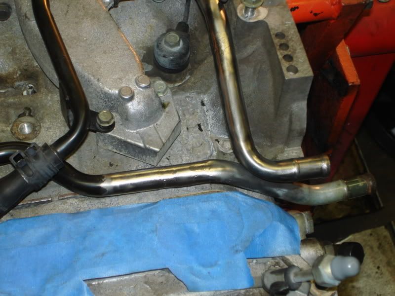

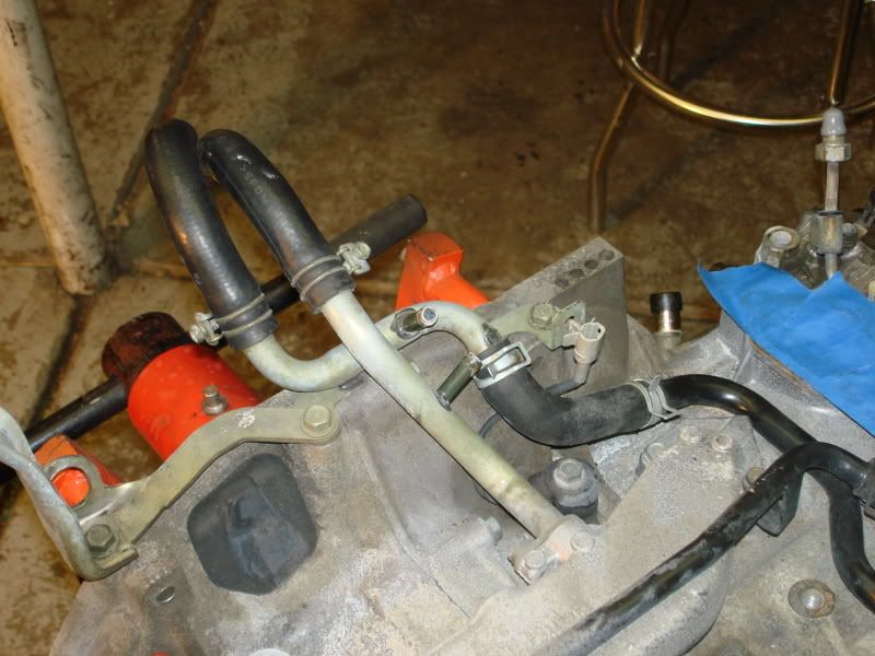

There's plenty to do even without parts, so this morning I started re-routing the heater pipes. They just won't work where they are...
I didn't want to use the EJ22 coolant crossover since the coolant pipe to the water tank wouldn't mount correctly on it. So, I removed the pipe from the EJ20H crossover, dug up the old EJ22 coolant pipe from the water pump, and started measuring, marking, eyeballing, cutting and welding.
A little later...(Look closely, you can see two welds)

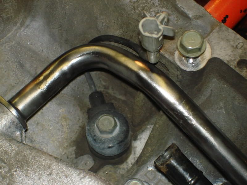

I can even still get to the knock sensor, as luck would have it:
I decided not to weld on the nipples to feed the throttle body since I won't be running coolant through it. I'll have the other pipe done by later this afternoon.

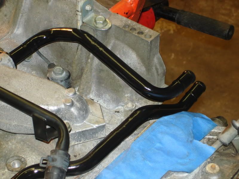

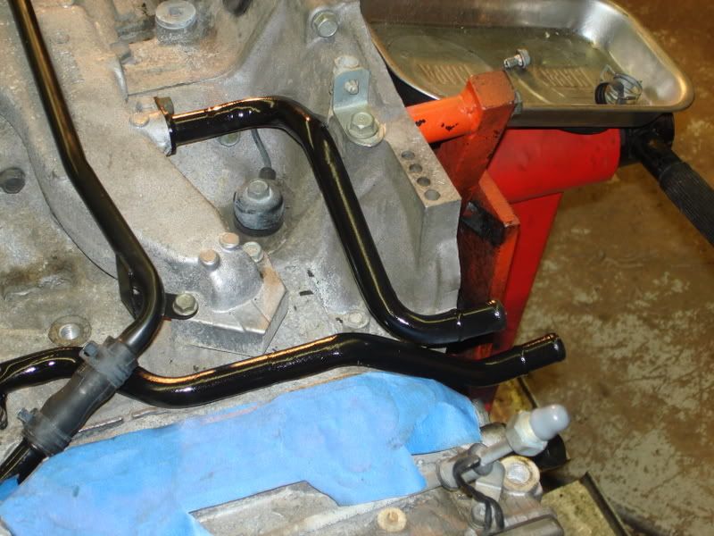

And here we are, a little chopping and splicing later:
Painted and ready to go...
One problem out of the way...Time to play with the intake manifolds.

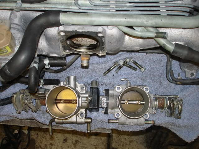

I did some more fiddling around in my spare time this week:

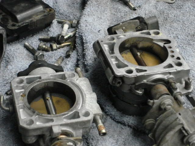

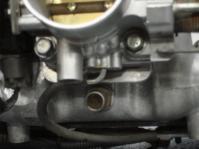

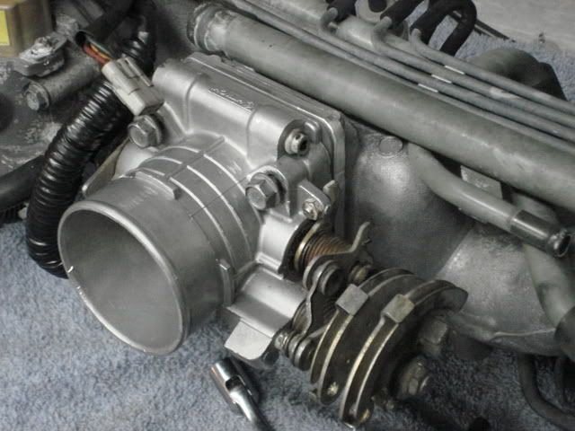

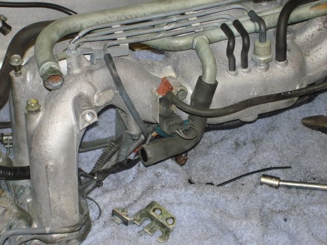

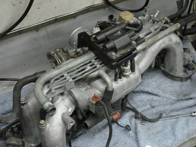

I finally got to work on the intake manifold. First thing I did was strip the wiring harness off and install the EJ22 harness which was no problem. I also found a spot for the purge solenoid.

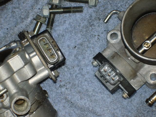

My biggest challenge so far has been getting a throttle body to work with this setup. First, note the difference in inner diameter: the EJ20H TB on the right has an ID of about 54mm; the EJ22 TB on the left, about 60mm. Big difference! The hole in the intake plenum matches the larger unit though.
The EJ22 TB rotates in the opposite direction of the EJ20H TB and thus the linkage won't directly work, since I'll have to flip the EJ22 one 180 degrees to clear the IAC. However, the EJ20H unit (on the right) has a totally different TPS setup which I can't see easily adapting to the EJ22 ECU and harness. See below:
To make matters worse, the EJ22 throttle body has a large vacuum port on the backside that would be uncovered when mounted upside down. Also, the TPS and the linkage both hit the intake. AGH!
After some reading, I found the solution on NASIOC, from one of Douglas Vincent's posts no less! The next day, I scored a piece of 1/4" aluminum, traced the TB gasket out, and then used a hole saw, the drill press, and the sawzall to make this spacer.
I then made two new throttle body gaskets, since nobody had any locally.
With the spacer, the linkage and TPS now clear the manifold, and the port on the back is sealed up. Still room for the PCV and the line to the evap solenoid. I still have to figure out what I want to do with the throttle cable, but that shouldn't be too bad. I also cut the coolant pipes off of the TB.

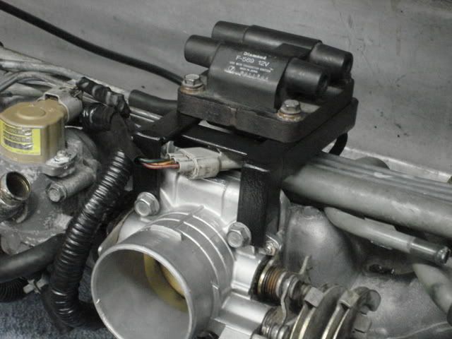

Next item...a coil bracket. All I had was some angle iron at that moment, but it welded up okay I guess. It mounts with the TB bolts and rests on top of the metal lines. It may be ugly, but it's solid as hell!

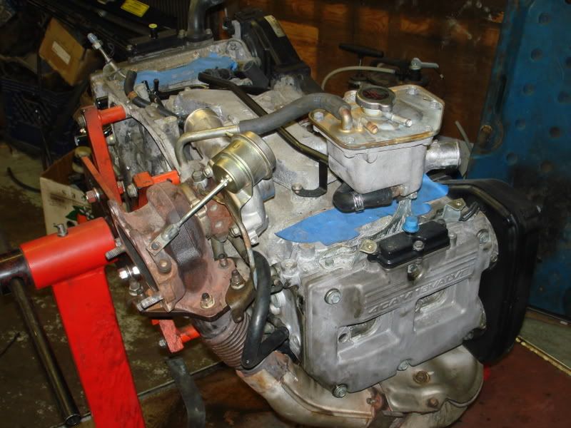

That's OK...I'll show you the mock-up.
I used the manifold and up-pipe from the '04 STi, which incidentally are IDENTICAL to the '92 parts...they were just cleaner, lol. Between the two manifolds and the TT manifold, I managed to get a whole set of heat shields as well. I cut the upper shield from the up-pipe because it was loose. I also cut a tab off of the EJ22T up-pipe bracket to clear the head.
At this point I'm using this TD04 from a USDM WRX ($50 on Craigslist) that seems to be in great shape. The oil feed line from the EJ20H's RH turbo fits perfectly, but I did have to swap the oil return pipe on the head for the EJ22T unit, which lines up with the TD04 perfectly. The turbo coolant lines are all plumbed up in these shots, up to where the coolant tank sits.

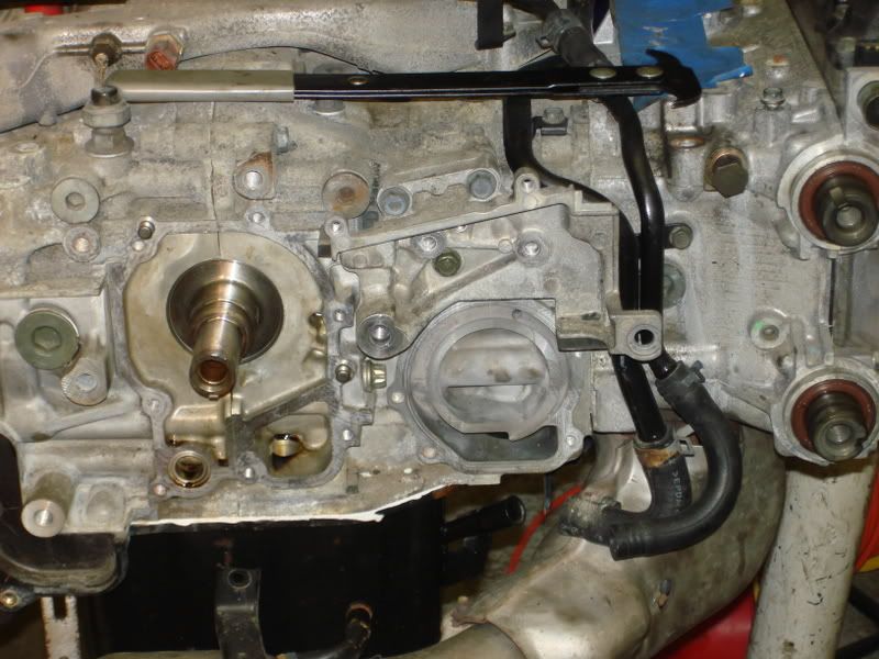

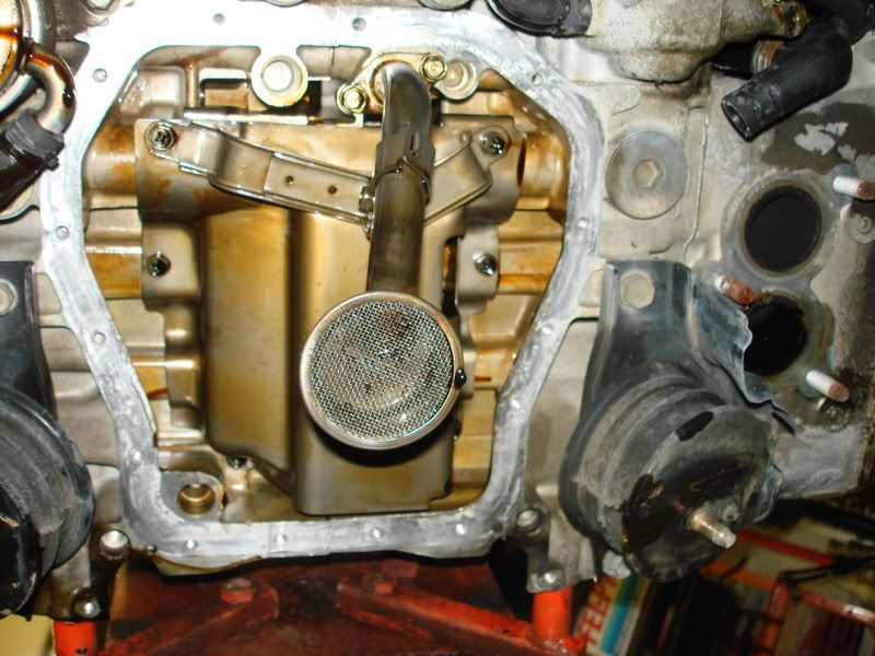

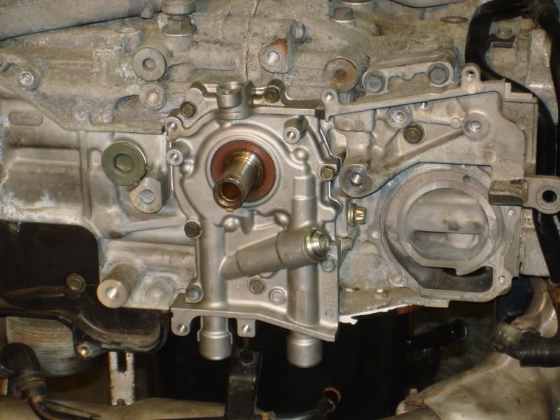

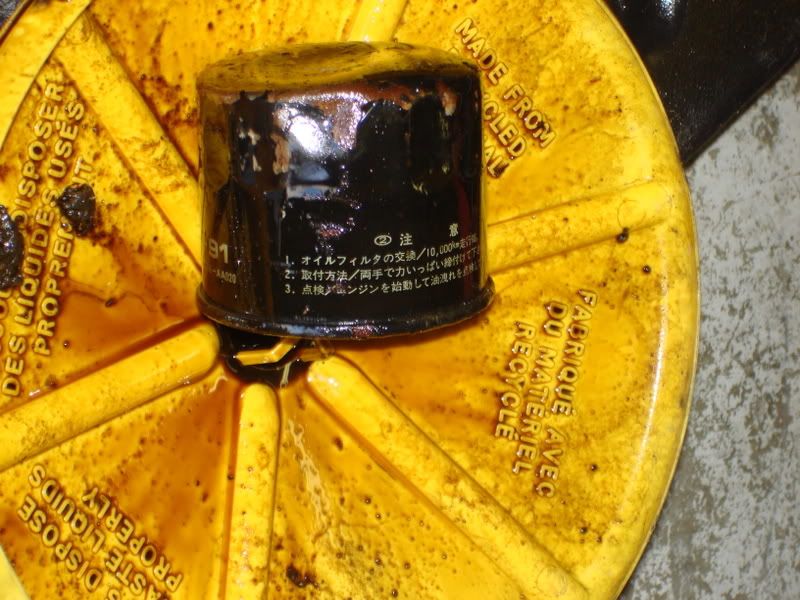

Before I bolted the exhaust manifold on, I pulled the oil pan with crossed fingers...this would be the make-or-break point on whether we run with this long-block. I was pleased to find that everything was nice and clean, and no debris in the pan. That's just droplets of oil in the pickup. I Three-Bond'ed it back on and continued.
Random shot...JDM oil filter, yo!

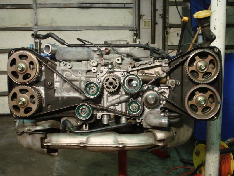

Once the bottom of the engine was ready, I moved to the front.

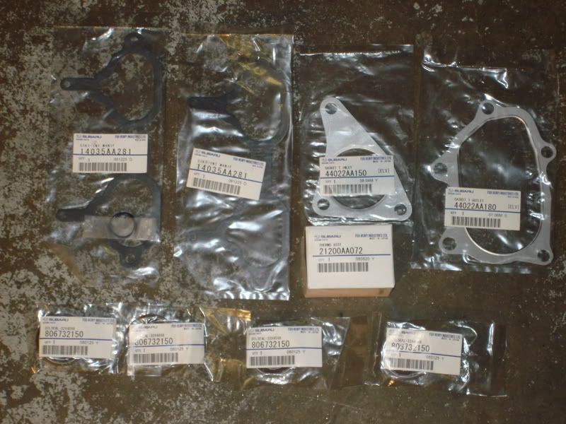

I got some parts from the dealer:cam seals, oil pump o-ring, intake gaskets, t-stat, and turbo gaskets. I looked up everything as an early '96 EJ25 (except turbo gaskets, duh!) and all the parts were spot-on. I already had the crank seal, waster pump gasket and other misc. stuff as leftovers from the STi build.

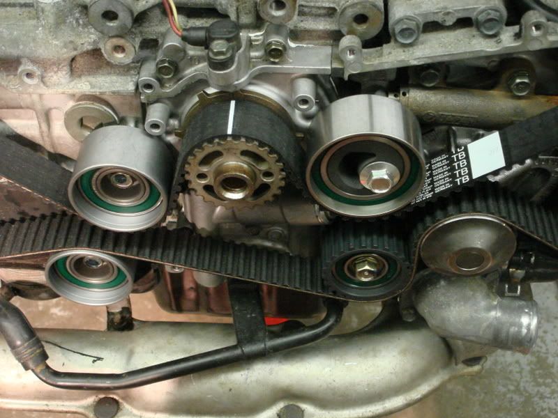

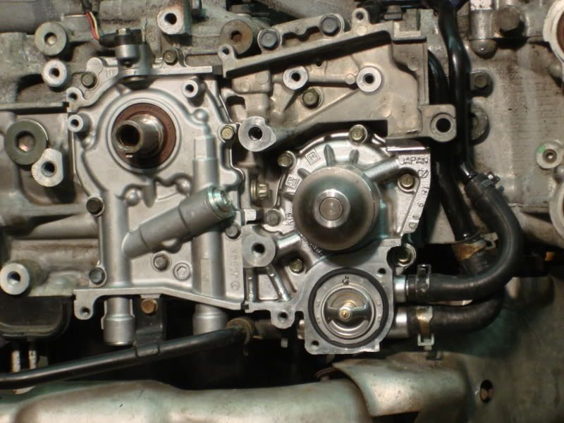

First I removed all the timing components, inner timing covers, and cam seals. At the same time I plugged the hole for the turbo oil feed line at the front of the LH head. I was feeling lazy, so I just used a steel spacer with the old banjo bolt and new washers.
After replacing all 4 cam seals, I then removed the oil and water pumps and cleaned the surfaces. No debris or other unpleasant surprises here.
I re-used the 10mm oil pump from Rob's STi. It was from a Cosworth long block with well under 15k miles, so I disassembled it to check it, cleaned and bolted it on.
Same story with the water pump...low-mileage EJ257 unit in great shape. (When the EJ22T shortblock's done, it'll get all new stuff...this stuff I'm using now only has to live for a few months, I hope.) here it is installed with the new t-stat, about to get a water outlet.

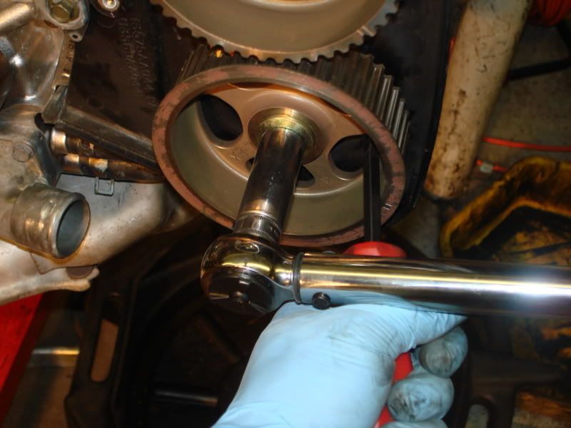

Installing the cam sprockets after bolting on the inner covers and dipstick...I'm digging these metal gears right now. Makes it easy to torque the bolts.
For the timing kit, I went Ebay and got a great deal. The bearings are all GMB, which have done okay for me in the past. The belt came in an Armor-Mark box...I have no clue who made it. At least it's German made, so maybe it's a Continental. Either way, it'll live for a few thousand miles until I put a proper Gates belt on the EJ22.
Timing kit, etc. all installed, ready to cover up:

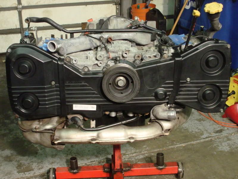

...And there we are, front of the motor done!
Installing the intake manifold will be next. This part had been bothering me for a little while. There isn't much room behind the intake runners for a 90 degree turbo inlet, so I started looking at a WRX-style inlet under the manifold. The problem with the USDM inlets are that there's no good provision for the IAC hose...hmmm. I was stumped to the point where I was about to hack/splice/ghetto my own setup from the EJ20H inlet, and who knows what.
Then I found exactly what I needed from an Ebay store located in China. Unbelievably, It only took three days to get this, the only aftermarket part so far...
...a silicone inlet for a '96-98 WRX EJ20K. The elbow near the front will line up perfectly with the IAC pipe in top of the intake, and I also got a connector for the MAF. Both items came in at under $120 shipped, and are 4-ply reinforced to boot. Also nice was that they're available in black...I'm not a fan of bling, especially on this ugly turd.
Stay tuned for more fun!
