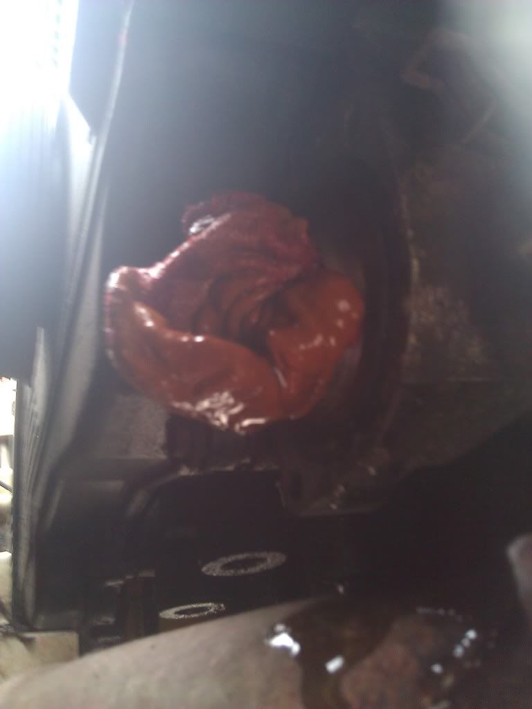

Surprisingly no!, I was shocked to see all that water/crap in there. I did at one point wash the engine bay, which took out my TPS sensor the first time....Legacy777 wrote:Did the car sputter with all that water in there? Or did you just wash the engine bay? That's bad!

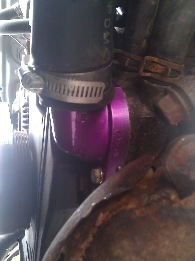

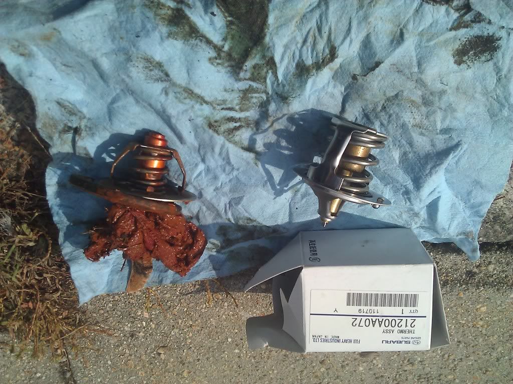

but that was a while agoNew thermostat all ready to go, I take the housing off and....WTF!?!?
I think I see the problem....
cleaned/painted the housing and bolted it down

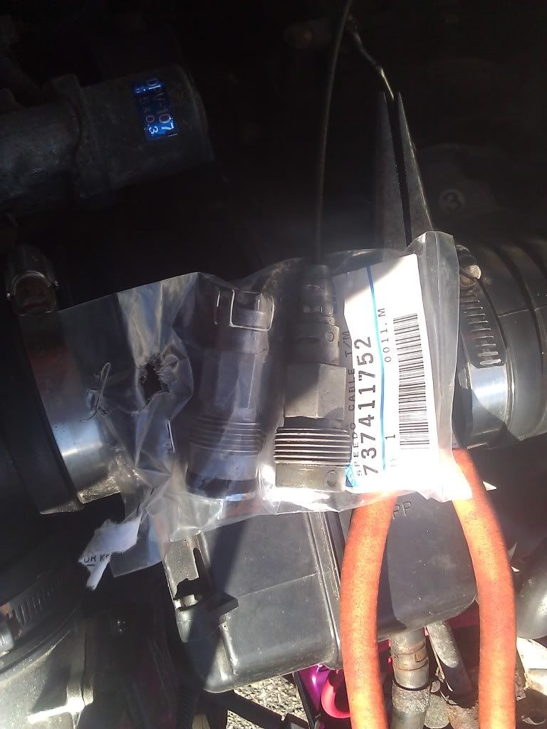

Well I got myself that speed cable adapter for the trans and got that hooked up to the speedo, so that works.
This was a bitch to get the other end back in the gauge cluster

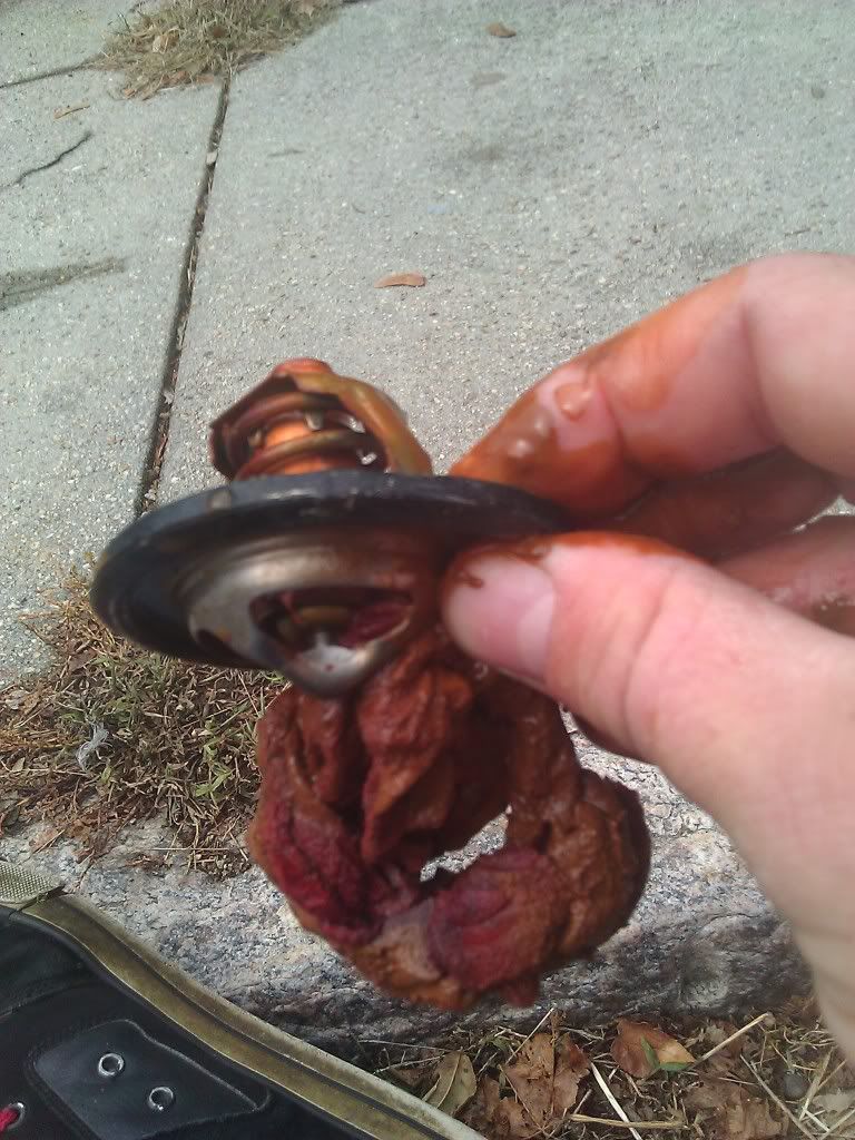

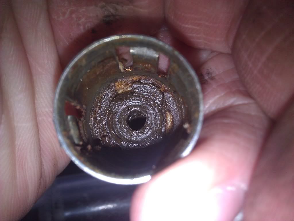

Definitely looks like the wrong thermostat and I'm assuming that's your rag and not one you found in the thermostat housing?
Re: Xise's 1993 Legacy Turbo
nope I found it pinched inside the valve of the tstat itself, not sure how exactly that got in there....but it was...and assuredly fuking up my cooling system royally.

I'm baffled how someone could pull that off? That'll do it. I'm surprised your car didn't overheat worse!
Me too, I was really surprised to see that, oh yeah FYI this one did have a jiggle pin in the tstat I removed, but the spring was WAY smaller than the OEM one. It is unconfirmed if the gates one works, because of the obvious ridiculous obstruction lol, if anything it supports that it might be a good tstat to use.

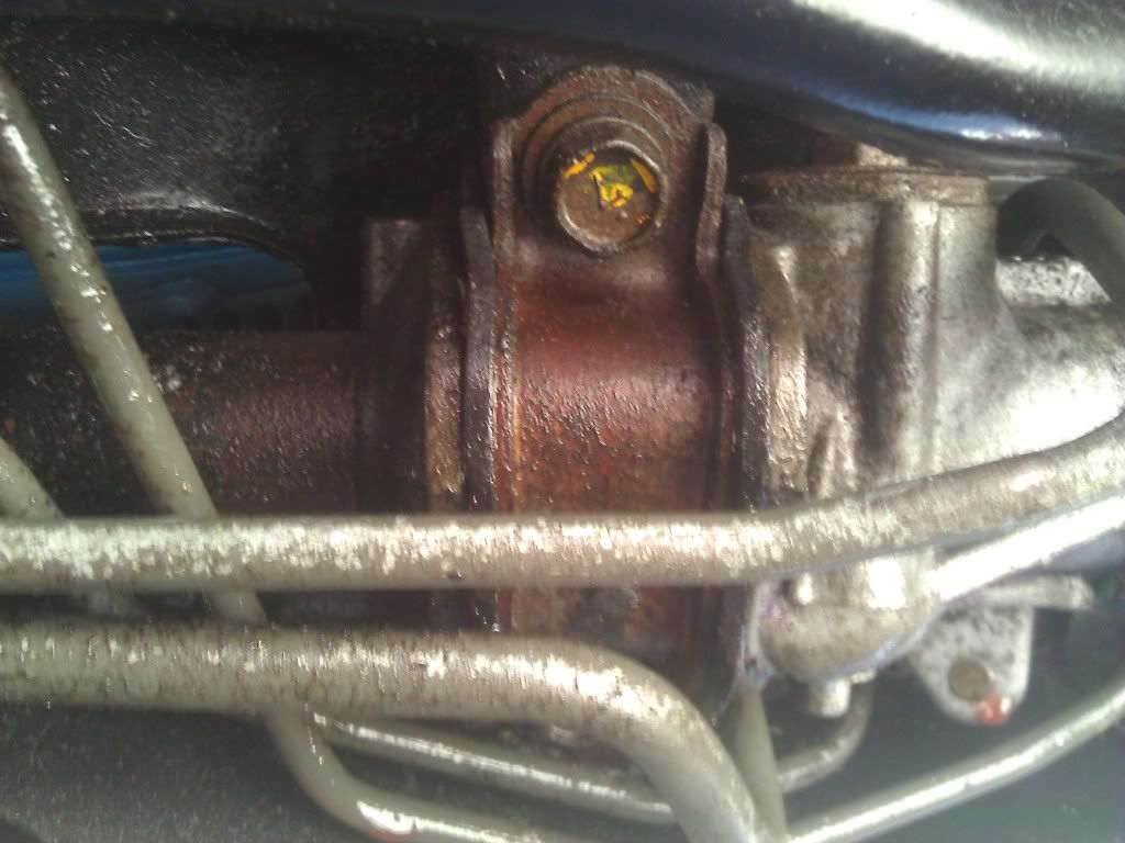

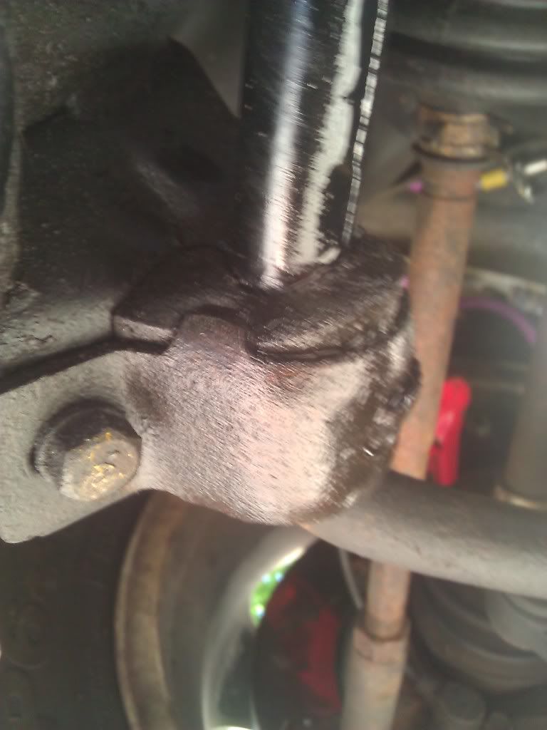

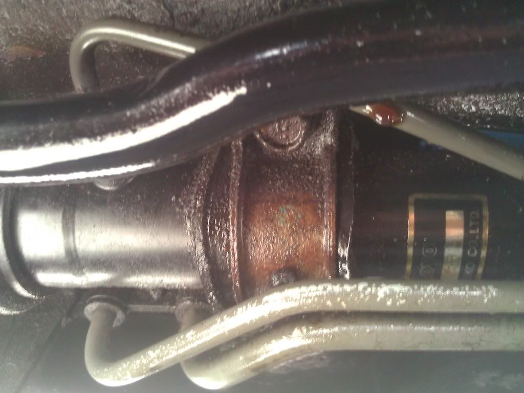

anyway while I was under there I noticed my steering rack and sway bar bushings are all oil soaked and basically ruined, once I get these fluid leaks under control i'll be getting all new bushings.
