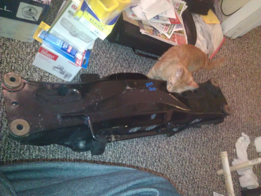

just figured I'd ask before spending some money here, does anyone here know for sure if a 2011 STi rear subframe would fit Sex Panther? I don't see any reason why it wouldn't they all look the same, at least as far as the mounting holes are concerned...
If anyone knows for sure it will not fit please let me know, there is a killer deal I want to jump on :)
Posts: 27943
Re: Xise's 1993 Legacy Turbo
No, it probably won't. The newer body style imprezas have a completely different rear suspension setup, and also likely have a different rear subframe. 07 is probably the last year they would be compatible.
That would be pretty cool if you could make it work tho...
xise
Posts: 576
Location: Rhode Island
Post by xise »
i'd rather not take the chance, I want to get something that will fit fore sure so I am going to grab an 05 STi rear subframe with the solid mounts, shouldn't clunk at all after that .... it is actually less for the 05 one I found :)

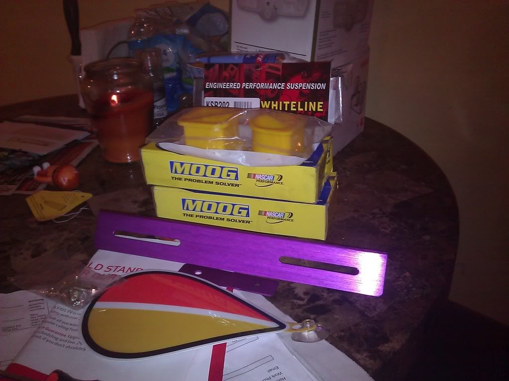

Ordered my starwheel ajusters finally, crossmember came in along with a few other goodies that were baldy needed.
the cat is inspecting it for any bent or dented areas...this apparently requires him to lick it a few times...you know, just to be sure....lol
steering rack bushings, tie rod ends and a licence plate holder, I got pulled over for having the plate in the window, and the mounting plastic sqaures fell out of the bumper so I needed it. It came with this jdm driver thing...not sure what exactly it means.....if anyone knows feel free to chime in.
Aside from all the issues that I need to fix my wife loves the car, she is still afraid to really get on it though....lol
