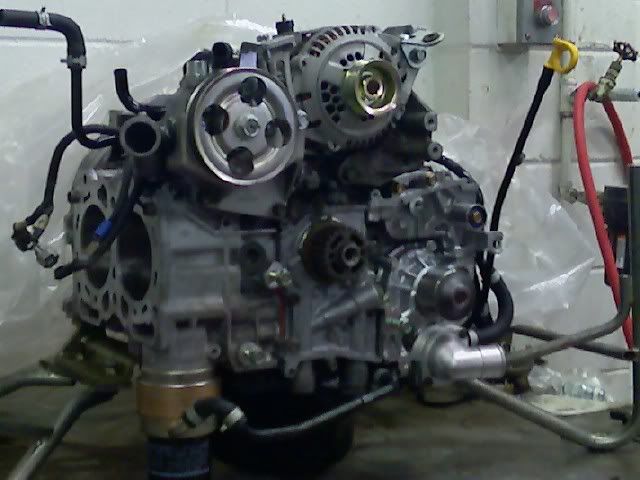

If your so worried about rods, spend the bucks and step up to billet. It might save you money and rebuild later, and you'll have the peace of mind.
I am worried about the rods but not as much anymore. Looking more into this, on setups with thesame turbo I am finding modded and tuned 2.5 Sti's pushing 18 PSI making 350whp and Version 8 2.0 Sti's maxing out at like 301whp, again pushing about 18psi. Both of these cars are taking full advantadge of ACVS for the twinscroll setup, which I don't have. My ecu will also only allot me about 14psi. SO I think I will be making less power than I first thought/hoped, and it should be lower than the level people are seeing these rods pop. That is hopefully... I am still trying to stock up on karma and all that good stuff right now.
This is my first built motor and I am kinda using it to learn. There are a few things I would have like to have done in the first place that I may do if I decide I do want (unlikely) more power, ie lightened crank, 9.0+ compression, different oiling system, different cams, acvs, water injection etc. But I figured I need to start off some where and learn.
Besides my original goal is usable power. I posted fastest time (vs cars w/ street tires, [and not PAX times either]) in every autocross we had last year in a mostly stock RS. How much power is enough till I start heading backwards? Or how much till I kill myself on a mountain pass or gravel road somewhere between billings and denver.
I have gotten power hungry a few times and had to step back. I want a light-ish, well handling, responsive, AWD car that does as well in winter, auto-x as it would driving to work.
My mentallity toward my car my be obscure to some people but... take my grill, thats the closest thing to a body kit I will ever get. I got the RS bumper to house lights so I can see. And instead of painting the car, I am having the lower doors/kick panels Rhyno lined.
SO the next time I bitch about rods, slap me. Unless I blow one then You can all line up to give me one good debilitating shot to the berries and an " I told you so." Sound fair?

I am trying to decide what headgaskets to go with. Granted the stock ecu is about 14psi and depending on how much control I will have with the F-con, I might see 17psi maybe... So I have a stock set at work and have been looking at cometic. Cobb can get the cometic with the gas rings...but that might be over kill.
anyhow here is a pic of the complete short block

My new theory is over build it and it's less likely to fail...bmxpunk wrote:Cobb can get the cometic with the gas rings...but that might be over kill.
Just had my '98 LGT over heat on me again after rebuilding/regasketing the motor 2 months ago. *sigh* Merry Christmas to me eh?
Jason
Dropfocus - I do not think the H/G issue was a mistake/lack of build by you as everyone I know with a DOHC 2.5 Legacy has had repeated H/G problems.
That motor is one to be avoided in my book...
BMX - your build looks GOOD.
I thought the STi RA ECU ('95) had a 16psi target, it should not matter with a FCD as I run 18psi tapering to 16psi on a stock LSS ECU'd EJ20G + ALKY.

Thanks for the boost of confidence Carlos.
I'm either looking at going full EJ205 swap, but I'd truely love to go with another built-up EJ22T (hard to come by in my Subaru infested area). The wife enjoys speed as much as I do. I just can't wait for my LSS build to be done & also the warm weather to arrive once again (diehard old-school sportbiker).
...and yes, BMXPUNK's build is coming along very nicely.

Well its not too hard. THis motor came out and apart in an hour and a half in mid-march 2005. Since then I have lived in 3 different places, had 3 different jobs and 4 different storage facilities, friends have robbed things be cars their cars "run," and the car has been stored 2 seperate places. THis stupid thing will cost me probably $350 in hardware.dropdfocus wrote:Simply asked: "How does someone manage to lose pulleys?"
That being said... I am just that good too!!
I love being at a stand still too. I am sitting here at work today trying to find SOMETHING to do to move it closer to getting finished.

Ok well i am also trying to make some pretty substantial changes and if I am where I want to be by August, I will no longer have the resource that I currently have for doing my car.
Needless to say plans have to drastically change since outside of the tools I have aquired in the last few months, I won't be able to major work.
SO I have decided to go back through and do my best to make sure that I don't have to have an unneccesary teardown for the next ...assume 6 years
So The motor is coming apart and getting torn doawn and new connecting rods will be installed. If anyone out there has a suggestion that would be great. My first question is has anyone had experiecncewith Eagle rods, and are Pauters really worth 2X the price.
Nevertheless I will be without my car for probably another month on top of its current lag time
Also for the time being to get the car up and running I have decided to go with an 07 wrx intercooler (or forester intercooler) as it is narrower and I can still run the 22t throttle body with slight modification. Then I can work out getting a new shaft machined for the ej20H throttle body so that it works with the 22t/20G tps. then I can upgrade the intercooler.
THe only other update that I have is I received a flange from IA performance that I can use to mate to any Bellmouth downpipe to my twinscroll turbo
