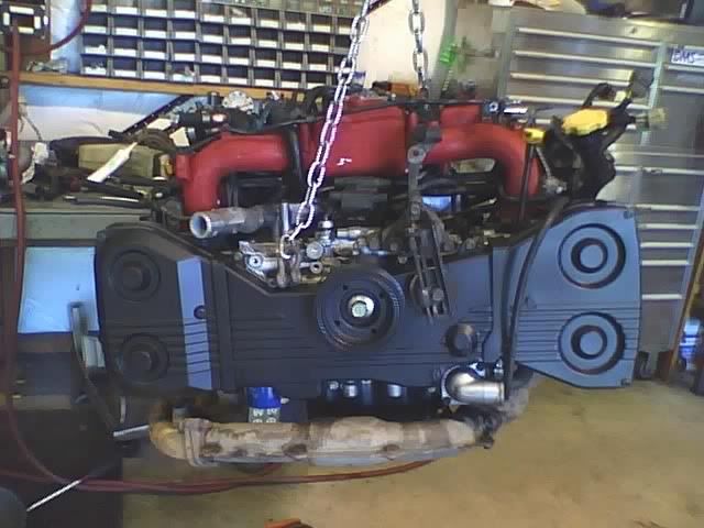

And here is a pic just before it was lowered into the car.
