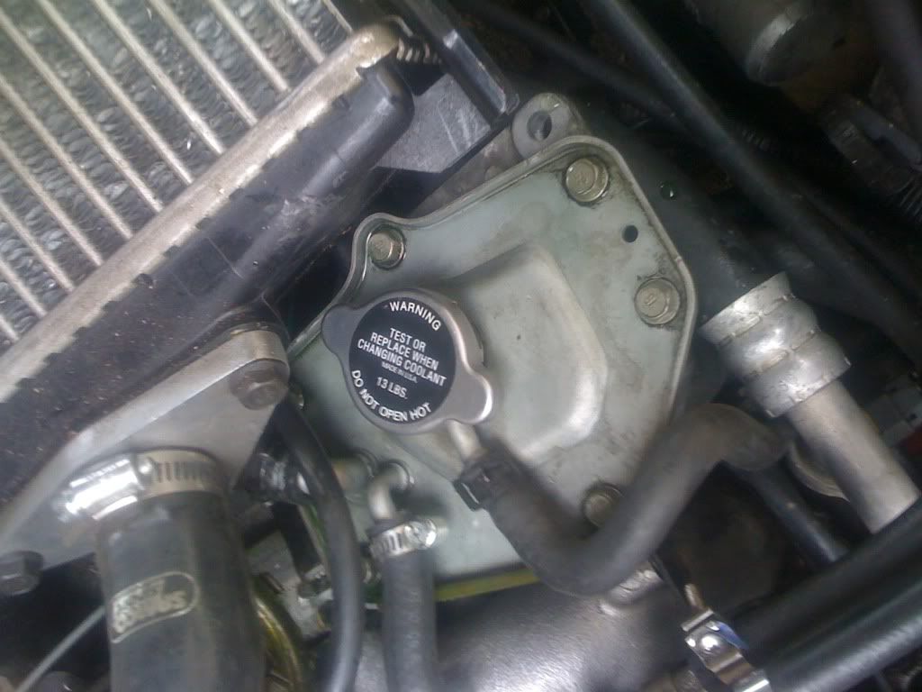

pic update, WRX coolant tank install!

We gotta see some more engine bay shots :)
