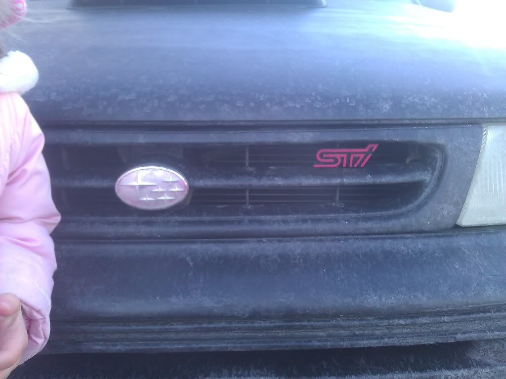

Today I got my STi grille badge in the mail, so I took the opportunity to put it on.
Also forgot to upload the pic of the boost gauge, here she be.
20 inHg @ idle and I am guessing around 7 PSi @ WOT, that sound about right to you?

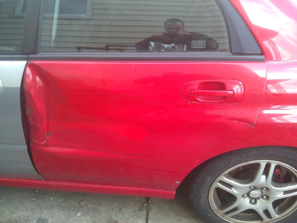

I was going to grab some cheap coilovers or a temp set of struts so I have no down time, but instead I am getting the RS registered and I am waiting on a new door, I am going to do the gas tank, rear xmember and all the trimmings while I have it up there. Snagged a nice STi gas tank with pump and sending unit...thing looks brandy fucking new :D should be fine, and plus one more STi part to go on the legacy. I figure when I am done it will be a real "STi legacy" I never saw anyone really STi-out a first gen although I am sure i'm not the first.

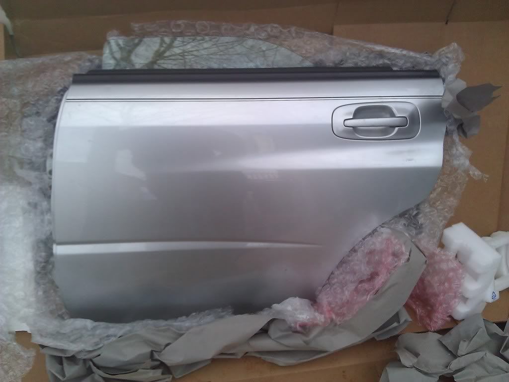

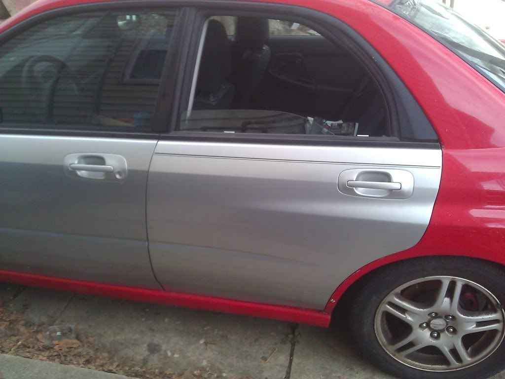

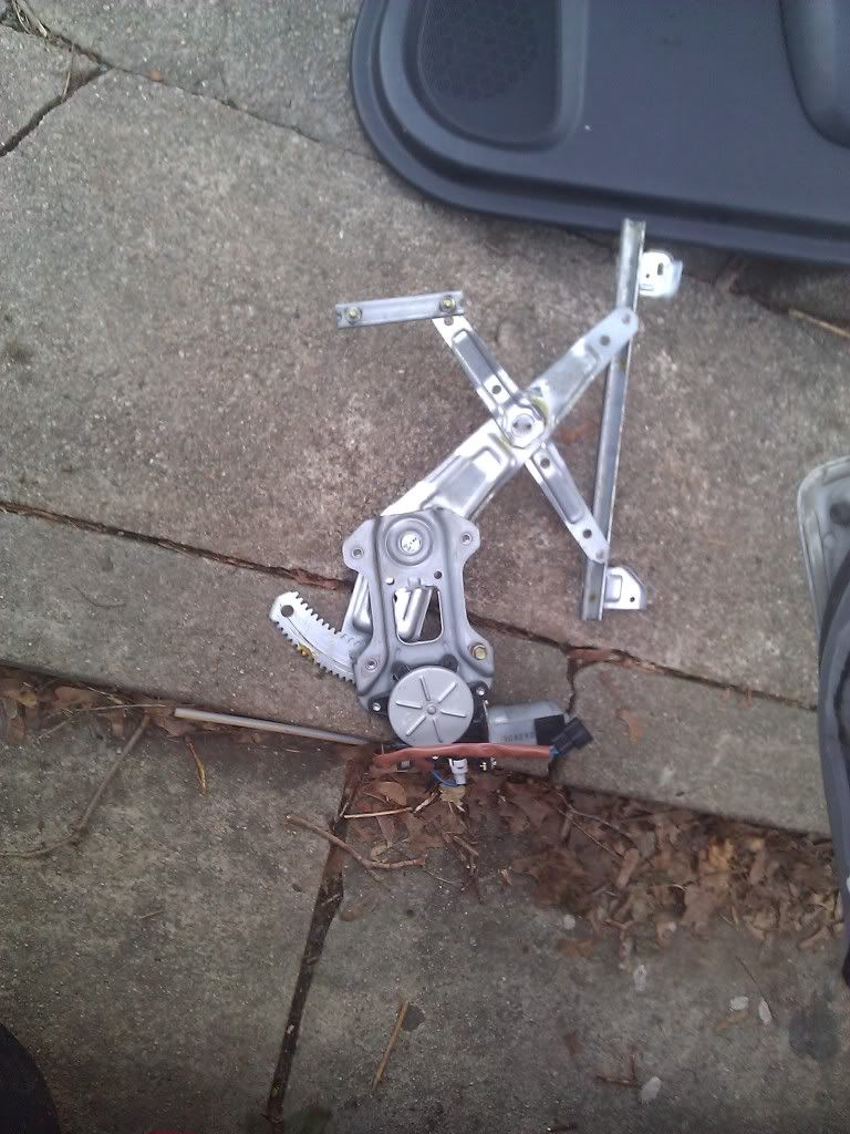

On a side note I got the "new" door installed on the RS, still need to adjust the window itself, if up all the way, when you go to close the door it goes under the weather striping and can't close...like it needs to be tilted. I am guessing the arm inside is a little adjustable for that reason...
The new specimen

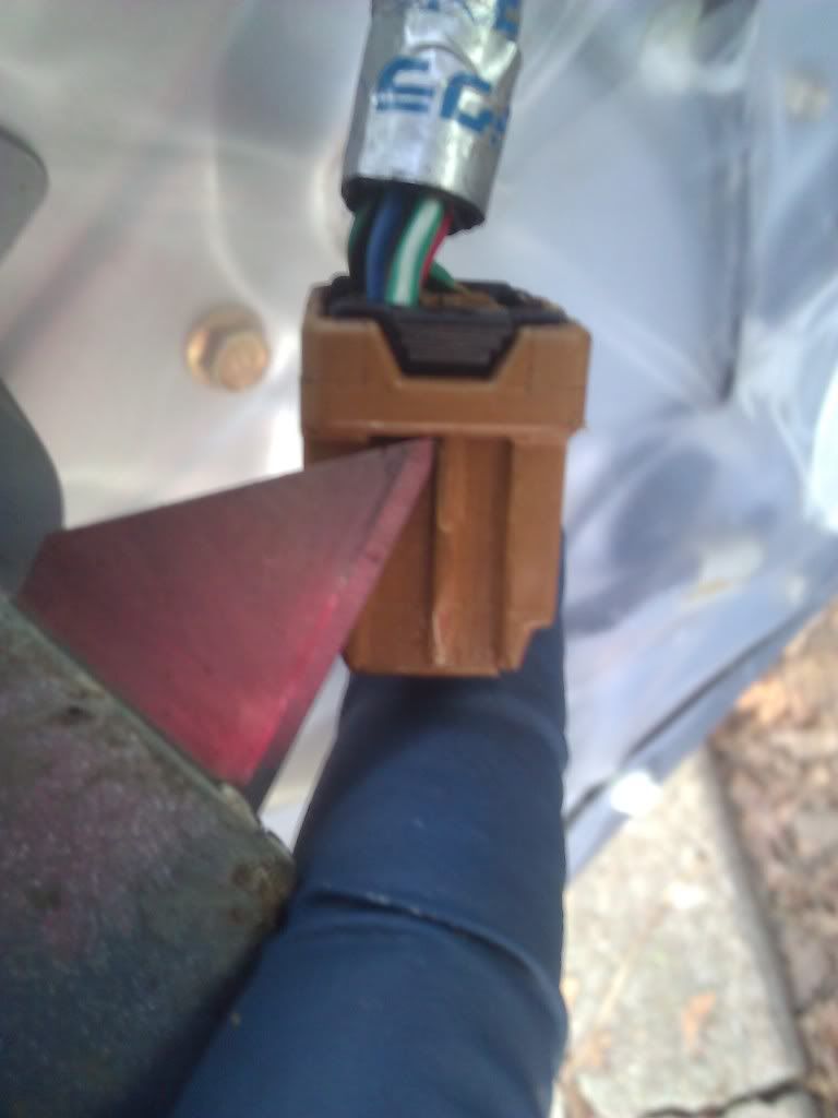

The new connector from the silver door had these slats that had to come off to fit into the door switch PITA #1
Then after I got everything almost done I notice the window will not move :unamused:
so I take everything apart and find out the gear band was bent and not hitting the sprocket on the window motor...so I pull the one out of the red door, PITA #2
