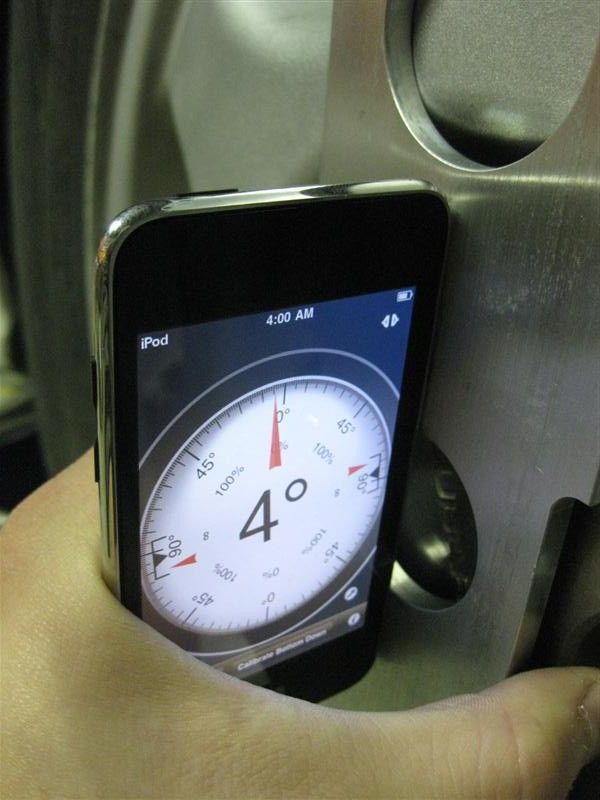

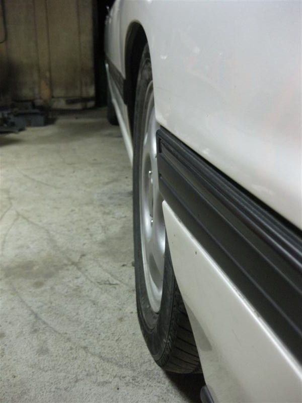

I bought and downloaded an app for my ipod touch called Clinometer. It allows you to calculate the angle of an object relative to another object. In this case, the camber of my wheels. The program is pretty cool. It's nice and simple and easy to use. No instructions needed really, I figured it out in about 10 seconds.
Front Driver Side -2 degrees with the strut all the way out in the camber plate. I left this one the way it was and checked out the other side.
It's actually pretty accurate it seems. That ipod can sense the slightest change in angle. The red arrows on the sides show you how much of a degree you are to the next degree. You can even lay it on a flat surface and the image changes to an air bubble floating in fluid and gives degrees on 2 axis's.
The front passenger wheel had tons of negative camber. The strut was sitting more towards the inside than the outside of the camber plate and it was at about negative 4.75 degrees.
I pushed the strut all the way out on that side to match the other side and now they're both at -2 degrees. I'll leave the like that for now because I had a more important issue to deal with. The rears were both right about -1 degree.

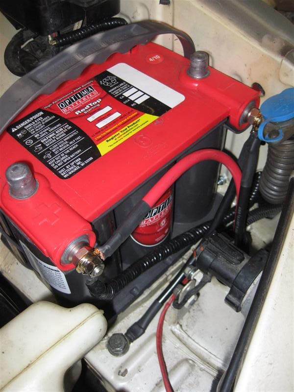

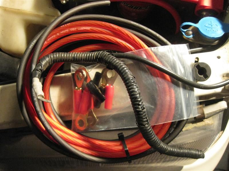

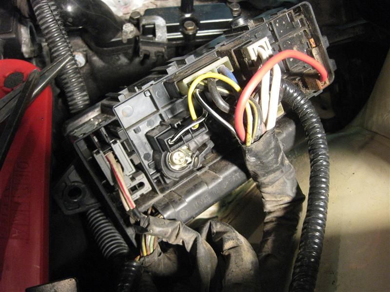

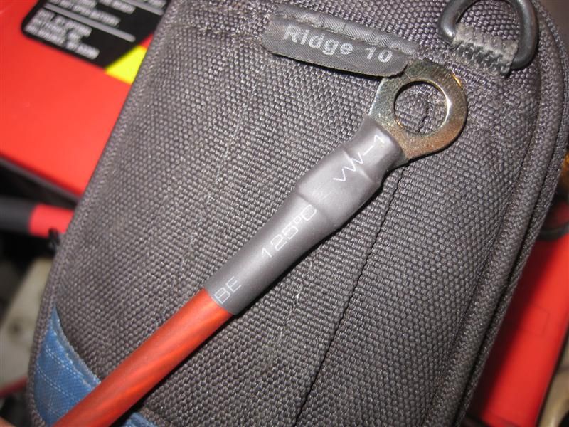

Got my battery terminal clamps and side posts yesterday and just got back from installing them and replacing the main power wire from the battery to the fuse box.
Didn't end up using the batter terminals. Probably won't use them but I don't know. My GF needs some. I bought her some but haven't installed them yet. They're just basic ones from autozone but I might put these on if I don't use them. They're really nice, I have them on my metro.
Fuse box unbolted to replace the main power wire here.
All wire loomed, taped, routed and bolted into the fuse box.
Of course, routed through the fender to keep the engine bay uncluttered. :P
Everything hooked up. Nice and tidy just need to find a rubber boot or something to cover the positive side post and top post.

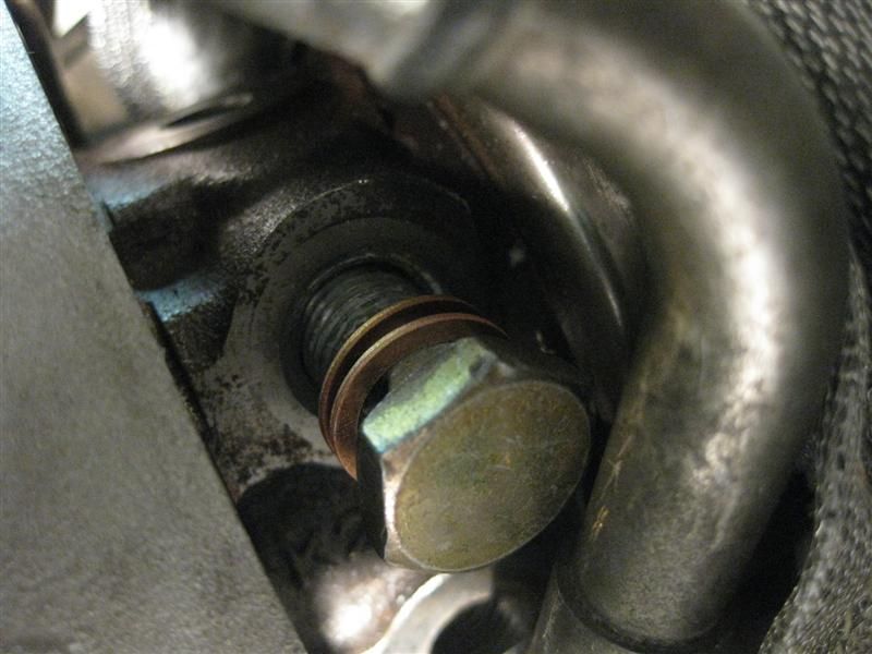

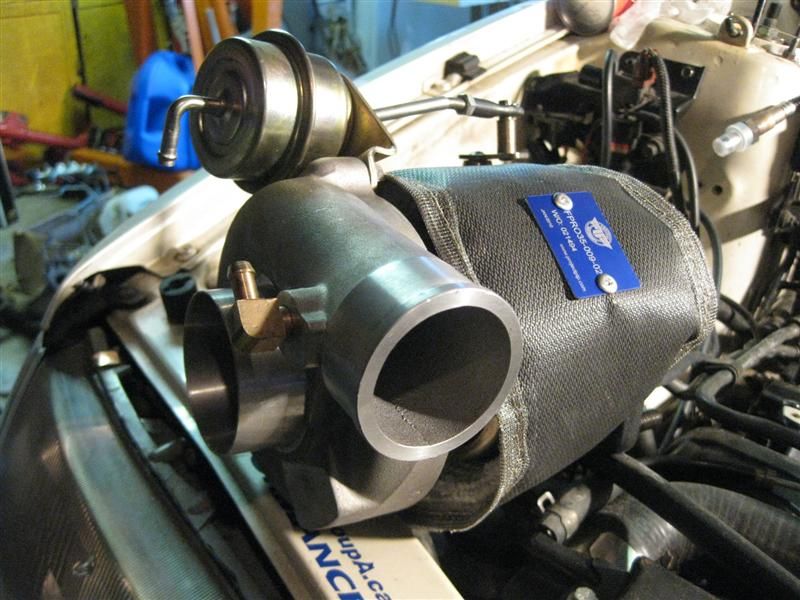

Picture of the TD04 coolant bolt in the bolt hole. It's hard to tell but the bolt is loose and hanging there.
TD05-16g with PTP heat blanket.
