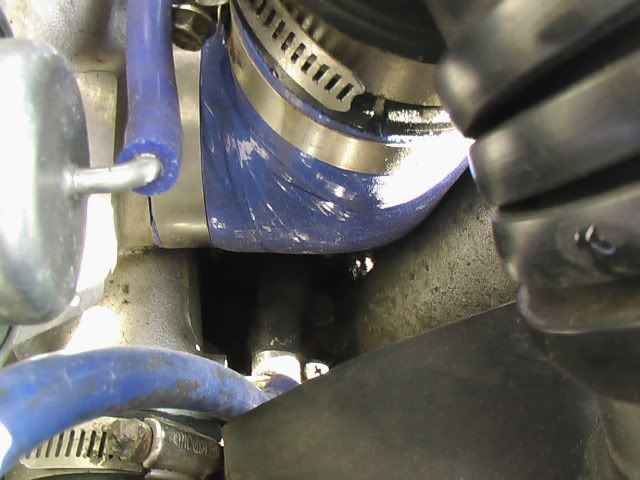

vf34 on a ej22t motor, clocking turbo pics.

thats why im just buying the td05h 16g with the 90 deg...
NICO
Posts: 2013
Post by NICO »
it took me 5mintues to put a rubber 90 hose on cut it a little bit and done, you can get the tdo5h-16g thats what i was going to do but then your stuck with that turbo and you cant get a bigger turbo or angle the 90. the way you want it.
now i have the 90, i am all ready changeing it to a vf22 i can mix and match to see what gives me my best power.

Post by Threshld1 »
yeah but for the first major upgrade after having the car a month, along with injectors and tmic i think a $400 big 16g with <20k on it will do just fine for atleast a little while :-D

Post by NICO »
400 bucks wow thats a good deal, my buddy has a ej20g with a tdo5h-16g its a little little bit smaller then the vf22 i am going to put on.

Post by NICO »
vf34 in with lots of room to spare.

Post by Splinter »
Looks good
How does your MAF handle that turbulent airflow?

Post by NICO »
splinter no clue how it does, but its the best set up i ever did for the air filter. smooth air no back pressure or rev down pull. in the summer i take that cardboard out and more gets in, its -20 where i live so i had to put that cover there.

Post by stipro »
NICO I WRX U wrote:well i got the turbo its mint condition good deal, now i clocked the houseing for my front mount set up and it all good even with the wastegate actuater.
now i got to get a rubber 90 elbow for the inlet of the turbo. i cant find one in canada. should i just weld on a 90?
If it helps I am in Canada and I got one. I live in Calgary and there is a shop here that sells them.
NICO
Posts: 2013
Post by NICO »
^^^ thanks stipro, i found one after it cost me 100bucks there crazy, but i need it to make it all work. where is this shop web page? or not.

Post by stipro »
This is the web site:
http://www.monsterhorsepower.com
I see you bought a silicone 90, I just bought a HKS rubber 90, $22 dollars. That is all you need for the intake part of the turbo, although Reg told me it could hold 15 psi without reinforcement. on the compressor side of course. :D
