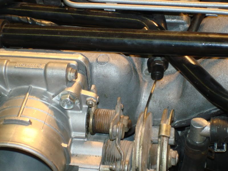

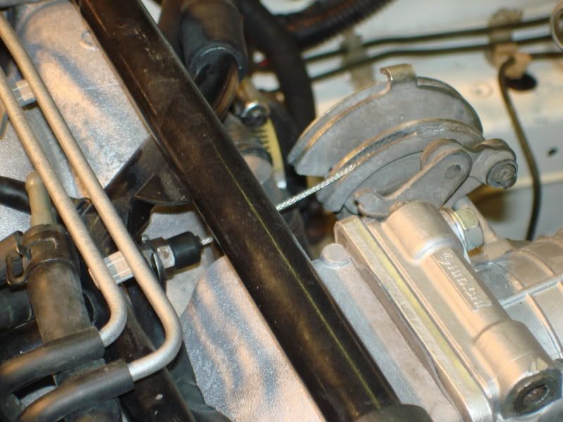

The throttle cable bracket was a success...I have full throttle! The cable lays just under the coil bracket, you have to look closely in the third pic.

Nice bracket. I will be making my own saturday. The thing i was worried about was the cable falling out of the side of the pulley after cutting off that tab.

Very clean with the throttle cable, I love how it's tucked away.

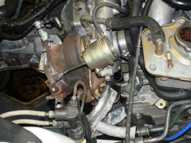

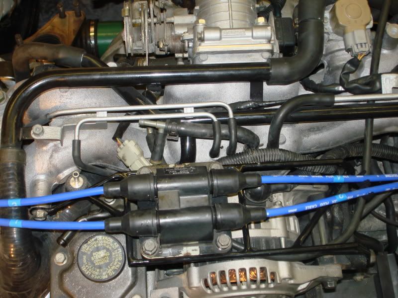

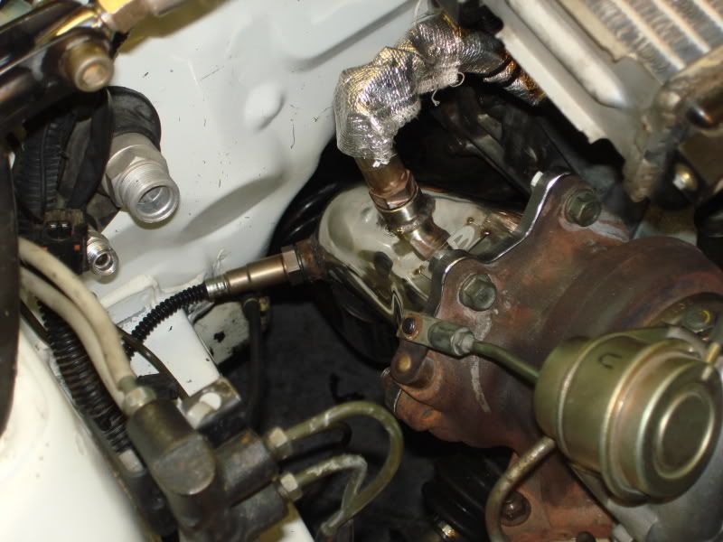

Making more progress...all vacuum lines are connected now, including the charcoal canister. I also got the power steering lines all sorted out and mounted.
The turbo is now mounted and completely plumbed. Note the DIY downpipe bracket and various heat sleeves.
I also deleted the clutch hydraulic dampener...it was really easy. I just took the hose from the master off and ran it to the slave cylinder. The clutch feels MUCH better now.
More coming soon!

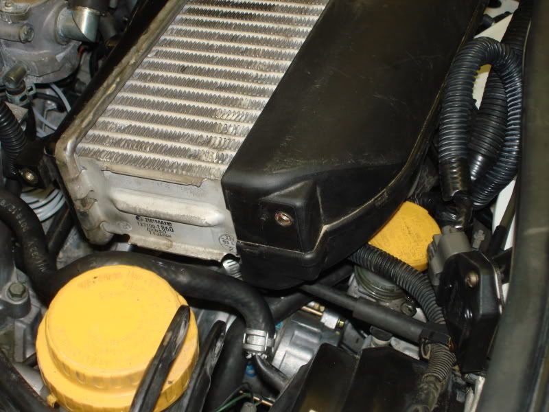

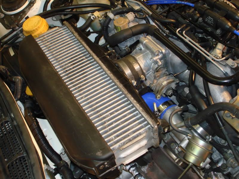

I mounted the intercooler for real. No clearance issues after I shortened the nipple on the brake booster a tad.
Next came the downpipe. I was a little worried that it might not fit for whatever reason, but it sat perfectly on the hanger down at the trans, and left plenty of room all around. I welded in another bung for the wideband and bolted it to the turbo.
Last but not least...I finished things up in the front. I added a second cooling fan after modding it to fit the taller turbo radiator, and hooked up the hoses and wires.

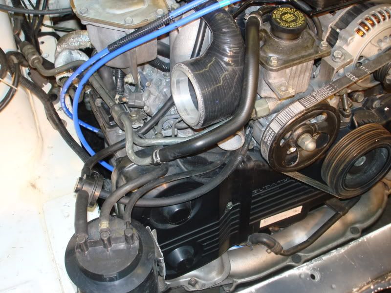

The intake's all trimmed, tightened down and ready to go...I like how it turned out. I'm going to run the Hitachi MAF at first, just to make sure everything works okay. After that, I'll switch to a JECS MAF I have here and wire in the piggyback.

I like the filter too. I wonder if you could get another silicone piece and put the filter inside the fender? It looks so clean without the ABS pump there!
-Doug Wilson

GodSquadMandrake wrote:I like the filter too. I wonder if you could get another silicone piece and put the filter inside the fender? It looks so clean without the ABS pump there!
No way am I going to put the filter in the fender...this car's going to spend a lot of time in the dirt. I want to make an insulated box around the filter later on though.

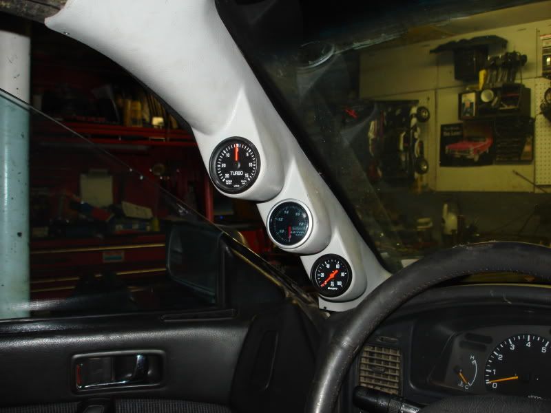

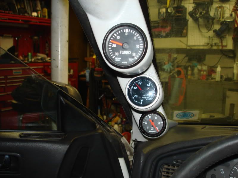

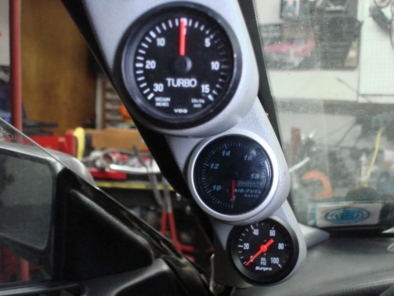

After the Easter fun ended today, I went under the dash to clean things up and wire in all the gauges. I was greeted with more horror...the fusebox and the ECU were dangling loose, along with a bunch of harnesses. Worse yet, it looked like the PO attempted to hook up a FCD and failed. The signal and ground wires for the MAP sensor had been hacked right at the ECU plug, and repaired by twisting bare wires together. Even better, I pulled the plug to find that the pin for the MAP's power wire was bent over. Not my kind of FCD! :x
After some soldering, splicing and cussing, all was well. I wired up the wideband, and hooked up an oil pressure gauge, an air/fuel gauge, and a boost gauge. I put them all in an old WRX triple pod I scored for free...it fit pretty well after some very minor trimming.
Here's my motley assortment of gauges. The boost gauge is actually an ancient German-made VDO manufactured in 1984. My UPS guy gave it to me over 10 years ago, believe it or not. I have a matching EGT (AU made in 1985!) that'll go under the radio later. The air/fuel came with the LC-1 wideband, and the oil pressure is a Suntune mechanical I picked up for $17 at Advance Auto Parts. They don't match at all, but who cares? The car looks like ass anyways, lolzzz!

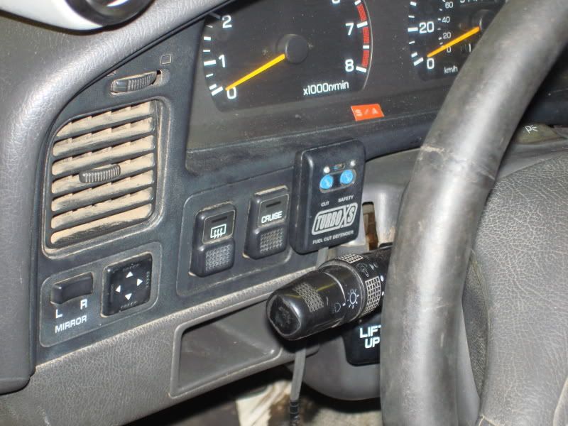

While repairing the MAP wiring, I installed the TurboXS FCD that came with the car, but was never correctly installed (see above :roll: )
Whew...What's next, you ask? I dunno, I'm tired. Check back soon!

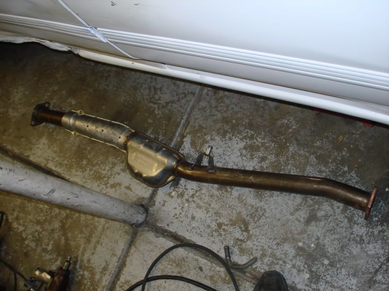

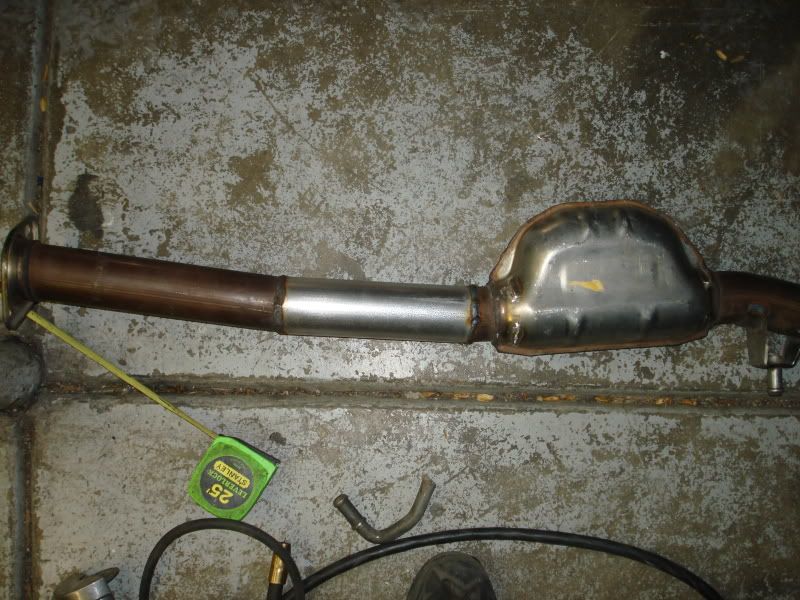

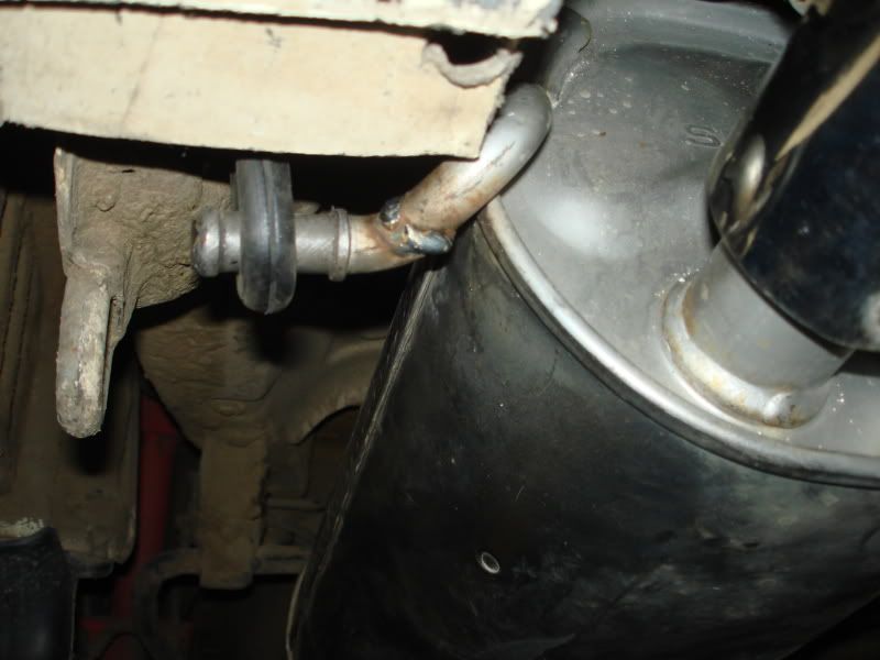

I went in the garage today and remembered what was next...exhaust. The original exhaust system was totally wasted, but no worries-I already have a stock WRX cat-back that looks nearly brand new. (Another freebie :-D ) It took a little modding, but nothing too awful...I guess.
Starting with the muffler, I cut off the front hanger and cut/re-welded the left rear hanger to look like the right side. Fits perfectly. Please excuse the giant welding bead, lol.
Then I went to the midpipe. I have heard a lot of people say that a WRX system is about 3" too long, but that wasn't the case at all for me-it was almost 8 inches too short. Heh. Whatever-I chopped it in front of the cat, bolted each section to the flanges, and fired up the Millermatic again.
Pipe with extension welded on:
Just for giggles, I re-attached the heat shield to hide my silliness. Oh yeah, if you look closely, you can see that I had to move the hanger almost 4 inches to the front.
Yeah, I know my cat-back is less than optimal, but (a)it was free, (b)it fits perfectly, and (c)it'll be quiet and look OEM. There'll be something a little bigger under there another time.

Looking good as usual. I think that exhaust is fine, who cares if it's cut and modified? Yeah the pillar gauge looks really modern but it sticks out. It isn't matched to the rest of the interior and the gauges don't match. I mean that old VDO gauge is cool though. I guess it doesn't matter though, the car isn't for looks it's for speed right? All your going to run is 15 pounds of boost?

The motor was also throwing codes, so I removed the FCD (one code was for the MAP) and re-set the ECU. It soon threw a code 24 for the IAC, and the idle goes scary lean when it conks out. I may try the EJ22T IAC among other things. Not too sure whats going on...but I'll figure it out. I hope :-)
