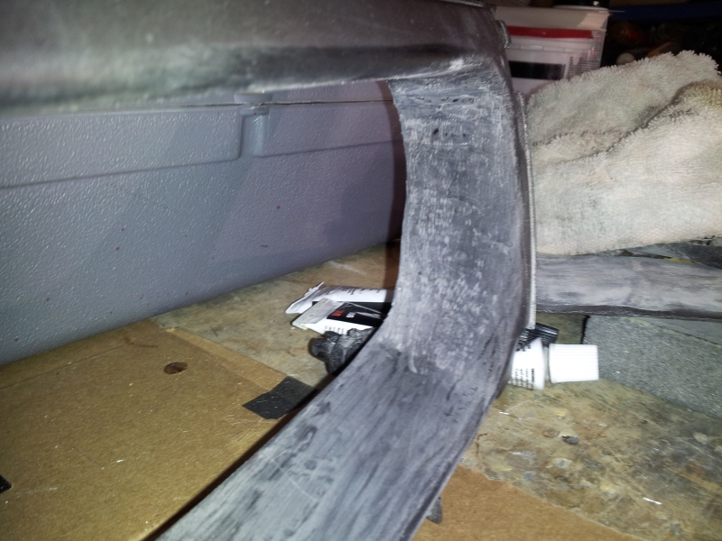

				originalcyn
 - Posts: 1627
 - Location: Everett, WA
Re: Custom Grille v3.0
CJ, that bumper repair kit seems like where it's at. I'm hoping that it's pretty durable too. Here's the progress so far:
First Coat:
Second Coat:
Third Coat:
Rough Sanding:
Finish Sanding:
But that's only on that side, i'll have to repeat the process on the other side.
						First Coat:
Second Coat:
Third Coat:
Rough Sanding:
Finish Sanding:
