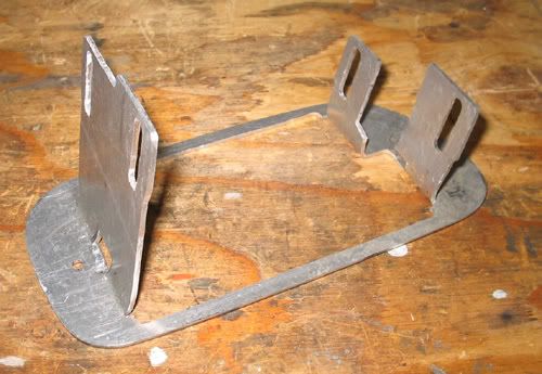

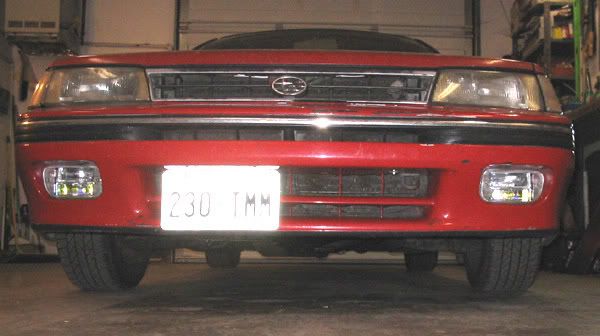

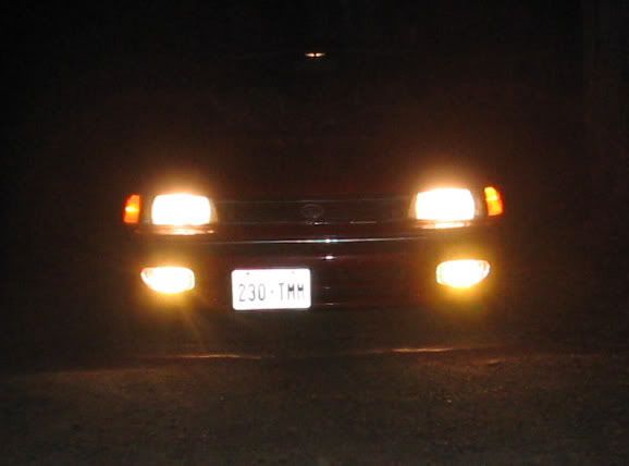

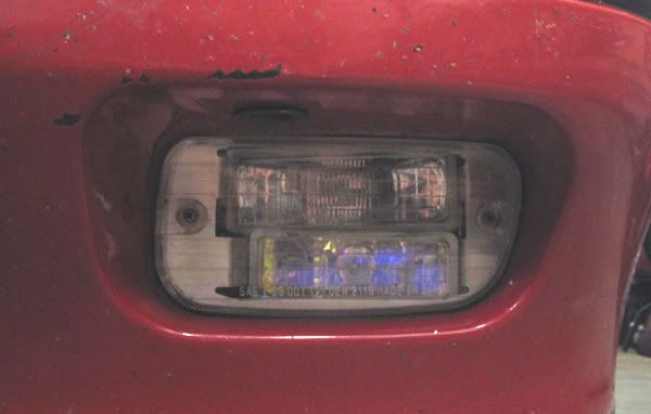

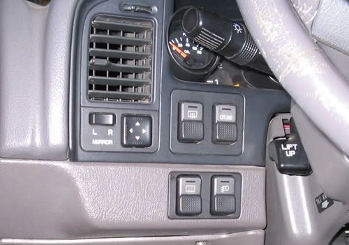

Lower set are fogs, upper are driving, the mounting position is pretty low for driving lights but I'm just looking for some fill and down low they will give less glare back in the fog and snow. I made the brackets from aluminum sheet, pic bellow in the first version, second round came out much better. I cut the diffuser out of the stock lens and cleared them (wet sand and polish method). I had to open up the holes in the bumper quite a bit to get things to fit. I had one factiory fog light switch and a spare defroster switch is working for now (anybody got a fog light switch they wanna sell?) Fuses and relays are under the hood above the left headlight. Patterns look good but I'll have to wait for some nasty weather before I'll know if the focus needs any tweeking. I've got way to much time into this setup, space was tight, but I'm very pleased with the results, best way to describe the project is... Craming 10 pounds or shit into a 5 pound bag.
